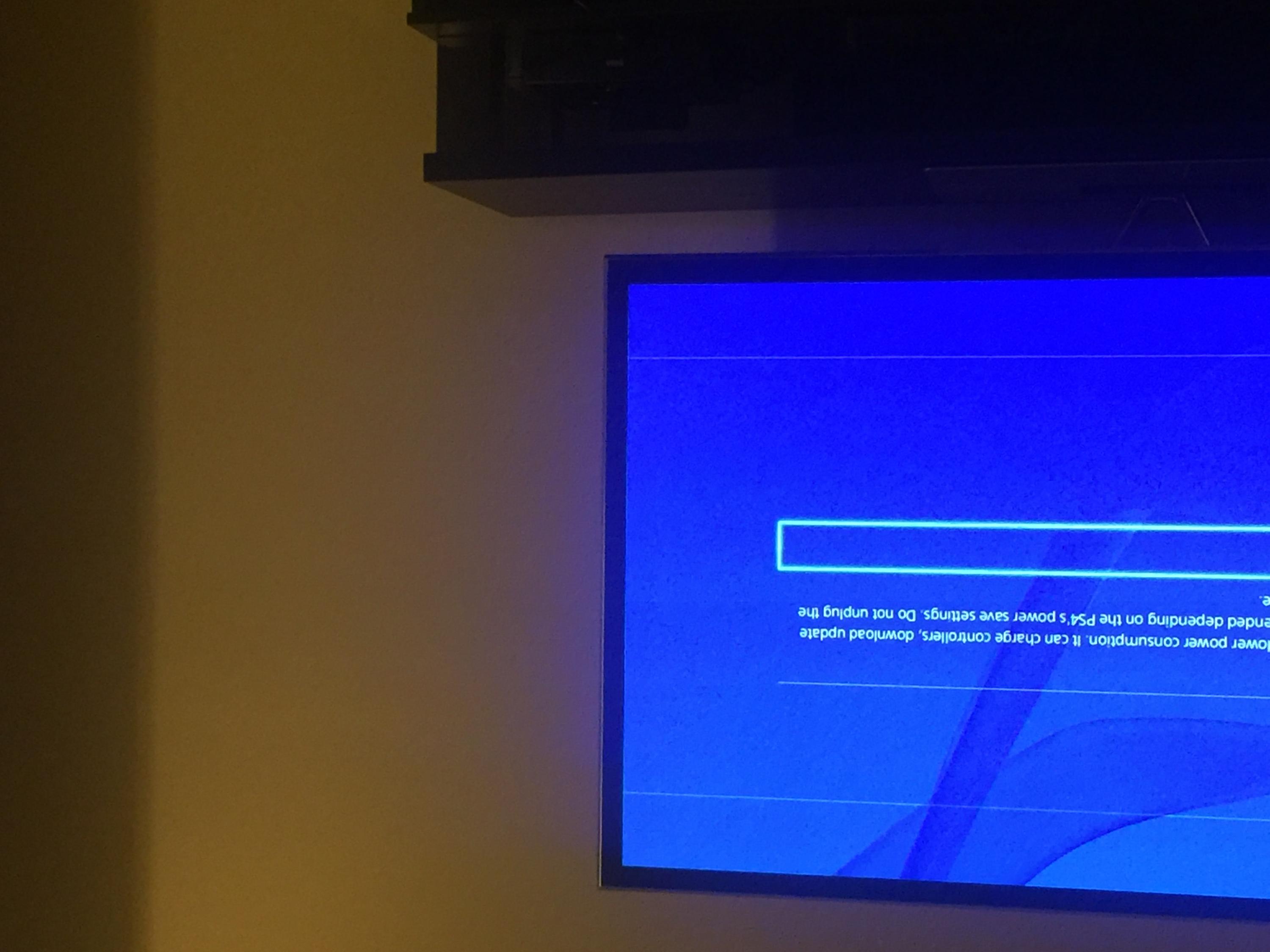

    I'm curious as to an off colored greyish vertical stripe that I have on the very far right of the ZT60's screen. I really only notice it during my hockey games. It's like 95% of the screen is a nice clean white ice and then that last far right of the screen is an off colored greyish looking dirty ice. It's a thin 1" vertical strip. My friends and family can't notice it but I do and it bugs me. Could it be burn in from the previous owner? Wondering if this is a board / ribbon issue or the plasma display issue? And what are the possible solutions?

    Re: Panasonic ZT60 - 1" Off Colored Vertical Stripe On Right Side Of Screen
    Doesn't sound good. Have you an image ?
                  Originally posted by ReeceyBurger123
                  Images have not uploaded, please upload using the attachment tool in the advanced post section.
                  Pictures now attached! You can see a faint 1" darker area on the edge.
                    Hmm you got closer images can see it ?

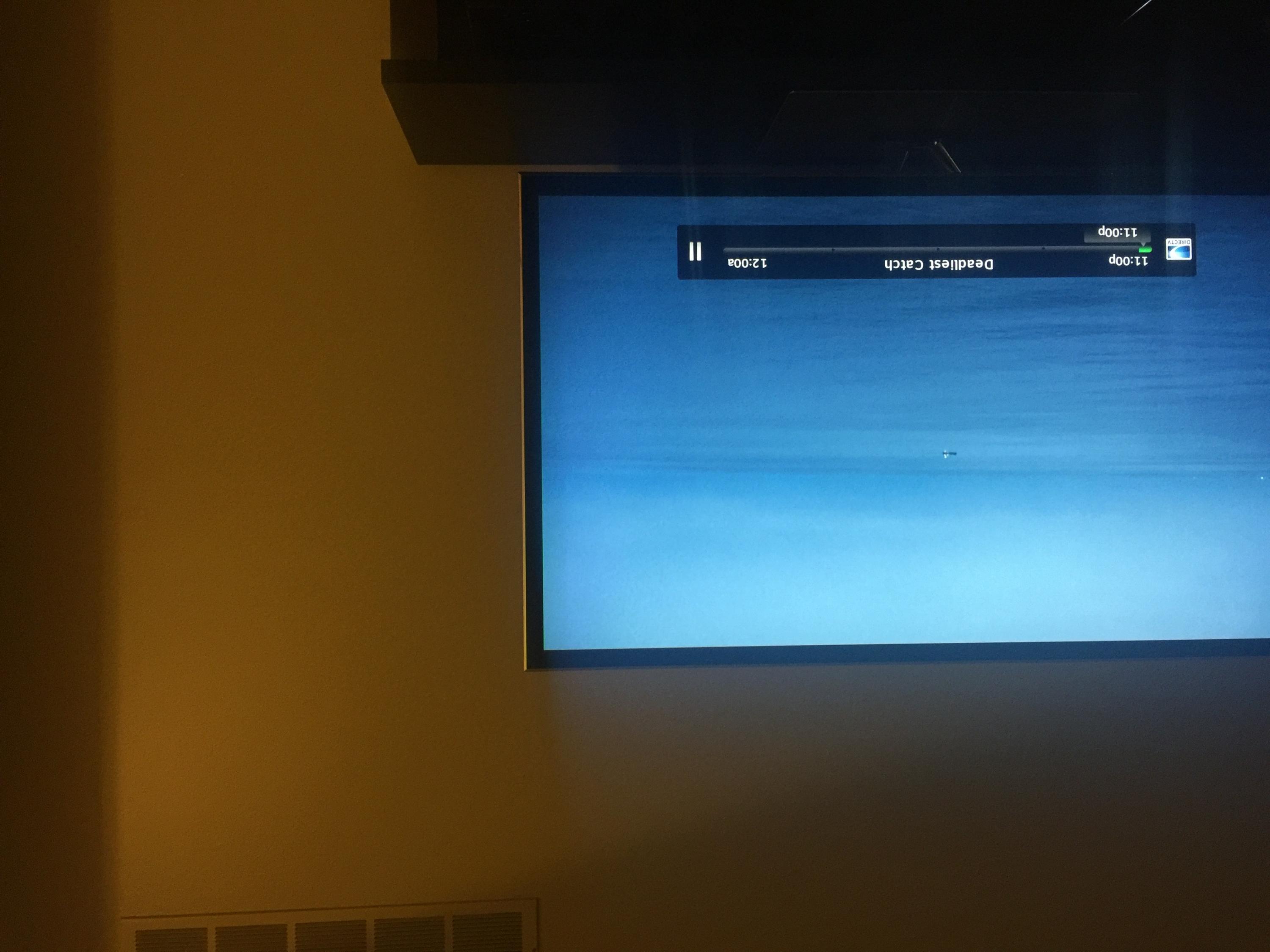

                      Unfortunately the closer you get the harder it is to see the vertical stripe. I'll try again tonight though. If you look at the left side of picture #1 you can see an off colored dirty blue about an inch thick and goes all the way from top to bottom.
                        Looks to me like image burn or possibly ine of the Cof address drivers has a lose connection going to the panel so possibly try reseating them.
