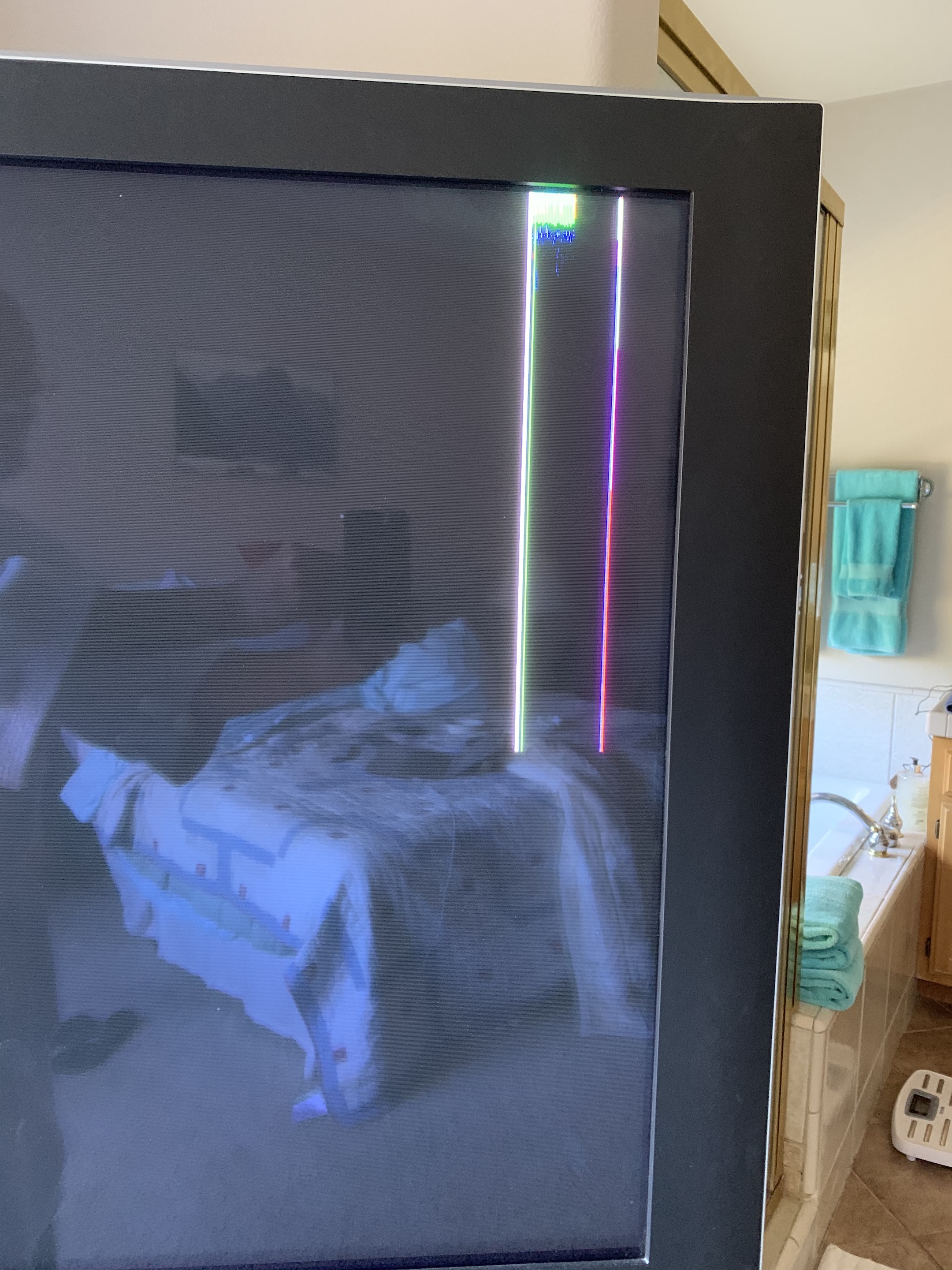

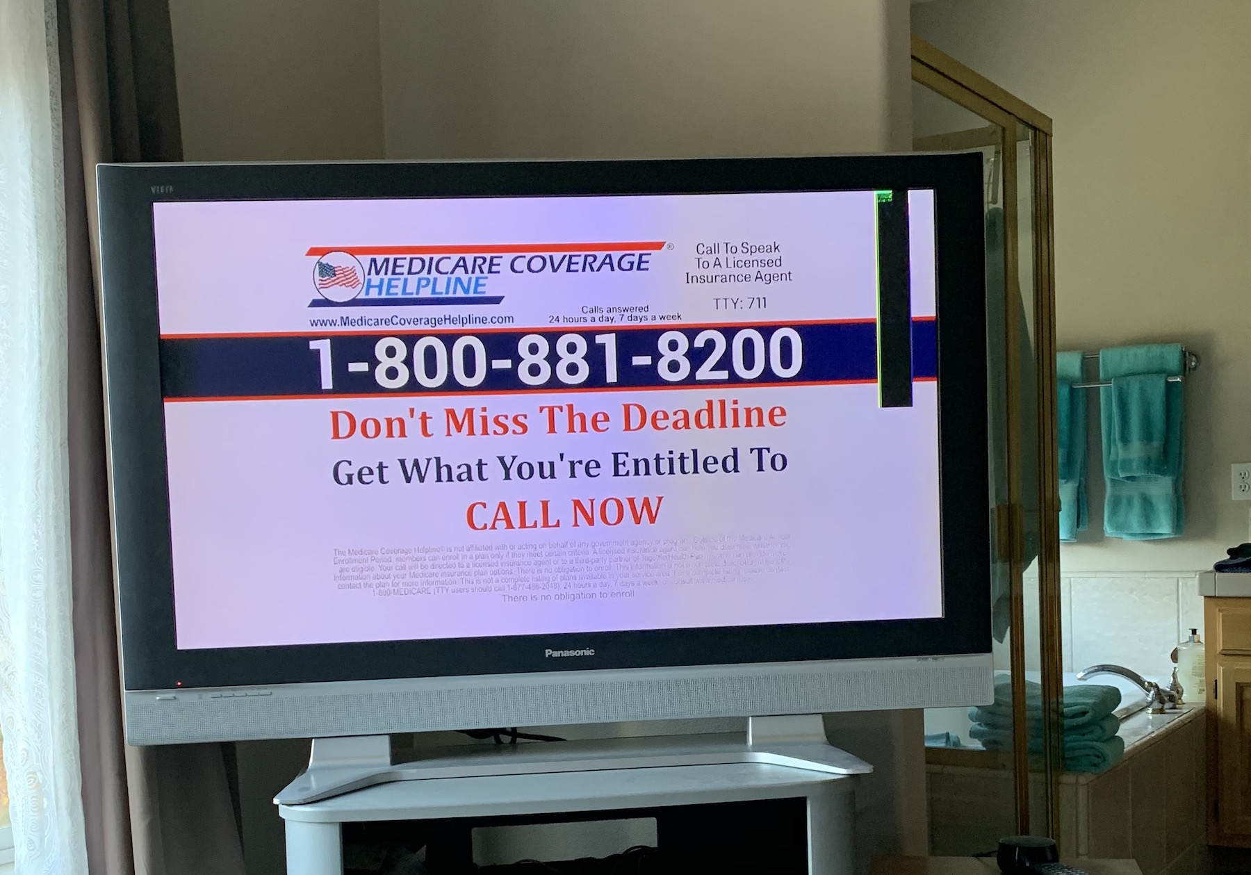

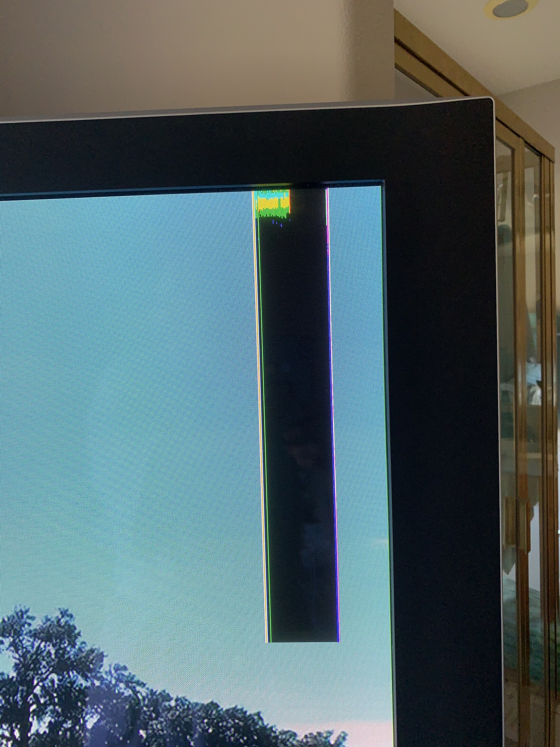

    panasonic th-50px-50u black vertical stripe
    Hoping to figure out if the panel is done. A week or so ago this stripe appeared on right side of display. It is there with all inputs. Pictures attached. the picture and audio are not affected. I tried disconnecting ribbon from buffer to panel and it does not change. Disconnecting the ribbon next to it yields the expected white stripe. There are vertical buffers on top and bottom therefore the 1/2 screen stripe.
    There are green and yellow lines on top and left side of stripe and multi-color lines on right side.
    My suspicion is that the panel is the cause because there is no change with buffer ribbon disconnected but I would welcome any experience or thoughts. I know it is old but it has a great picture and all.
    Thanks,
    Greg

    Another close image
