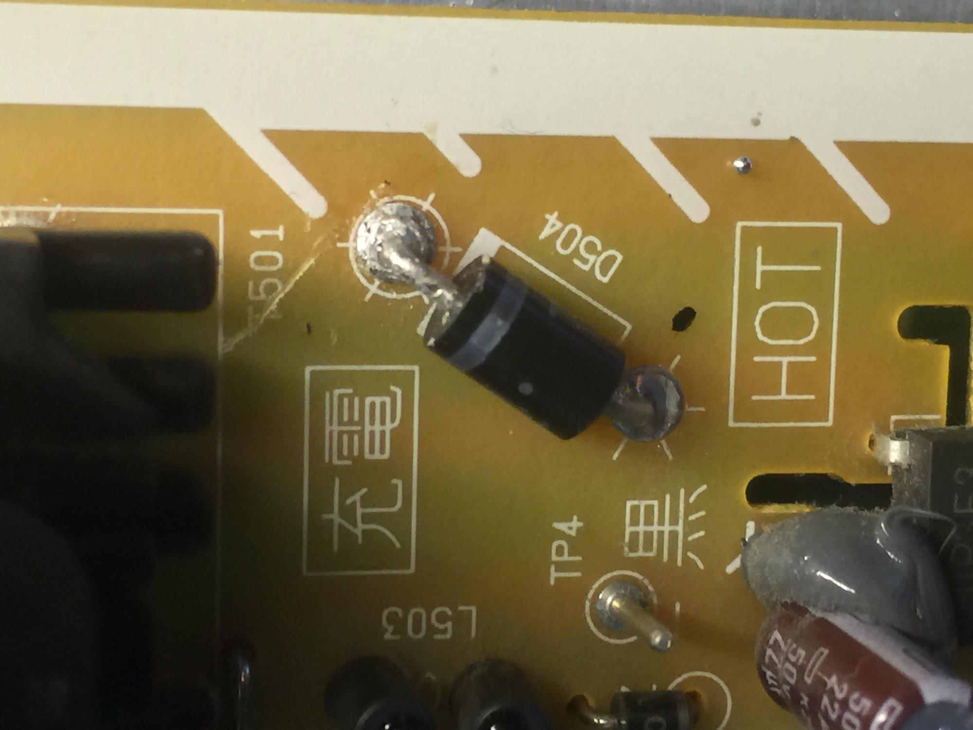

              Re: Panasonic TH-42PZ80BA. 10 blinks
              This Diode D054 is reading as shorted , on the PCb
              Could this be the lone culprit
                Thats a snubber diode for the tarfo it should show shorted.

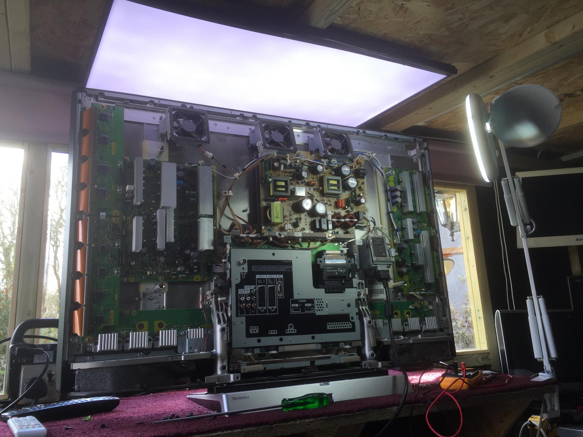

                              Try freezing them Ics and the 1uf ceramic caps for them also check the thermal fuse that can fail too causing non intermittent 10 blinks. Also like the lighting set up haha
