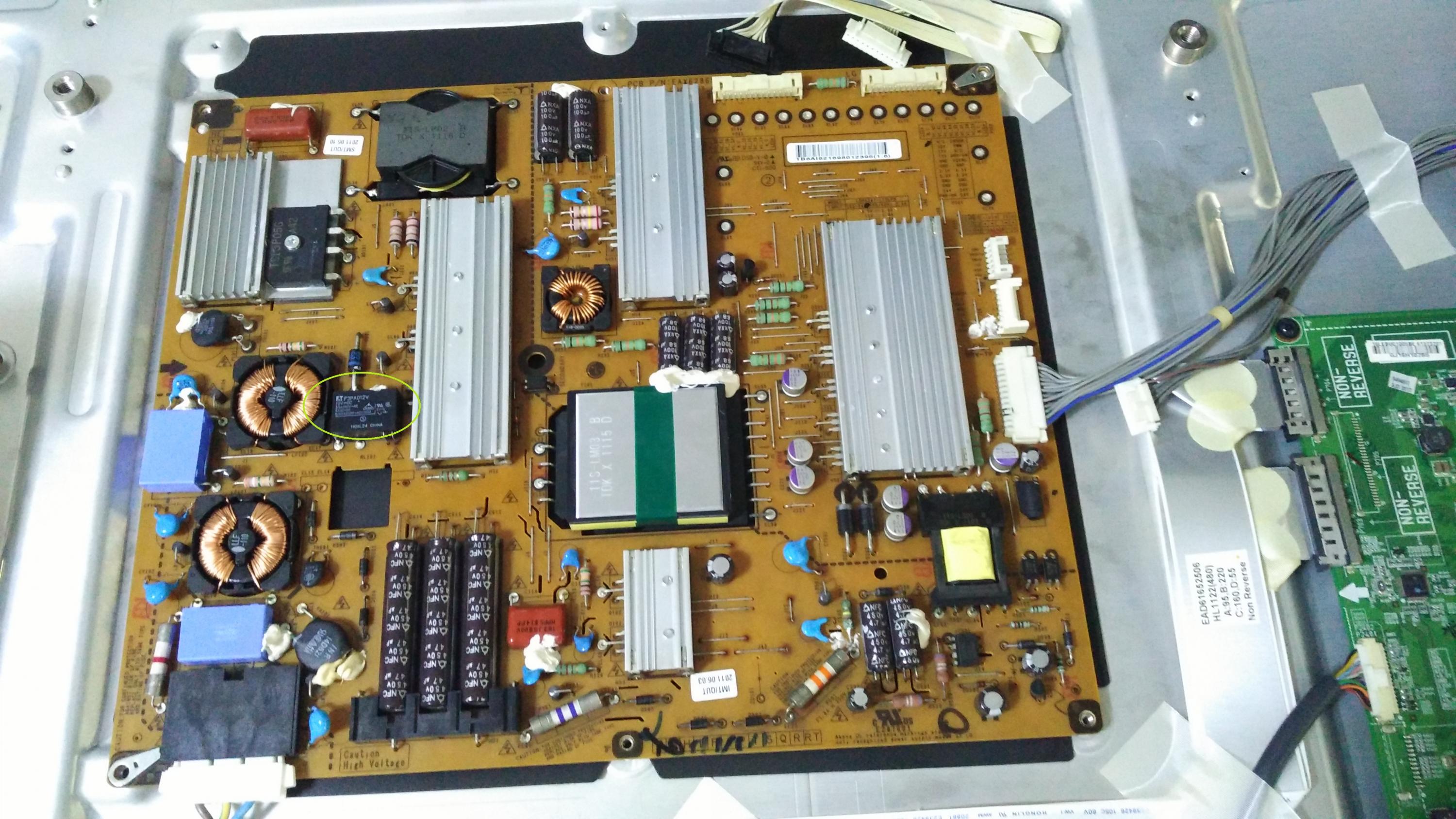

    LG 42LW4500 no power
    My LG 42LW4500 no power at all, no led lights. First suspect is power board issue. All fuses are OK, AC voltages are going into the board. ac voltages did not reach the rectifier. And cannot detect ac voltage after the relay.
    I cannot find the board schematic on web. So cannot see where n how to turn on the relay.
    Power board - EAX62865401/8
    4 pins Relay is 12V - F3PA012V (yellow circle in pic)
    any help from the experts, will be appreciated.
    thanks !

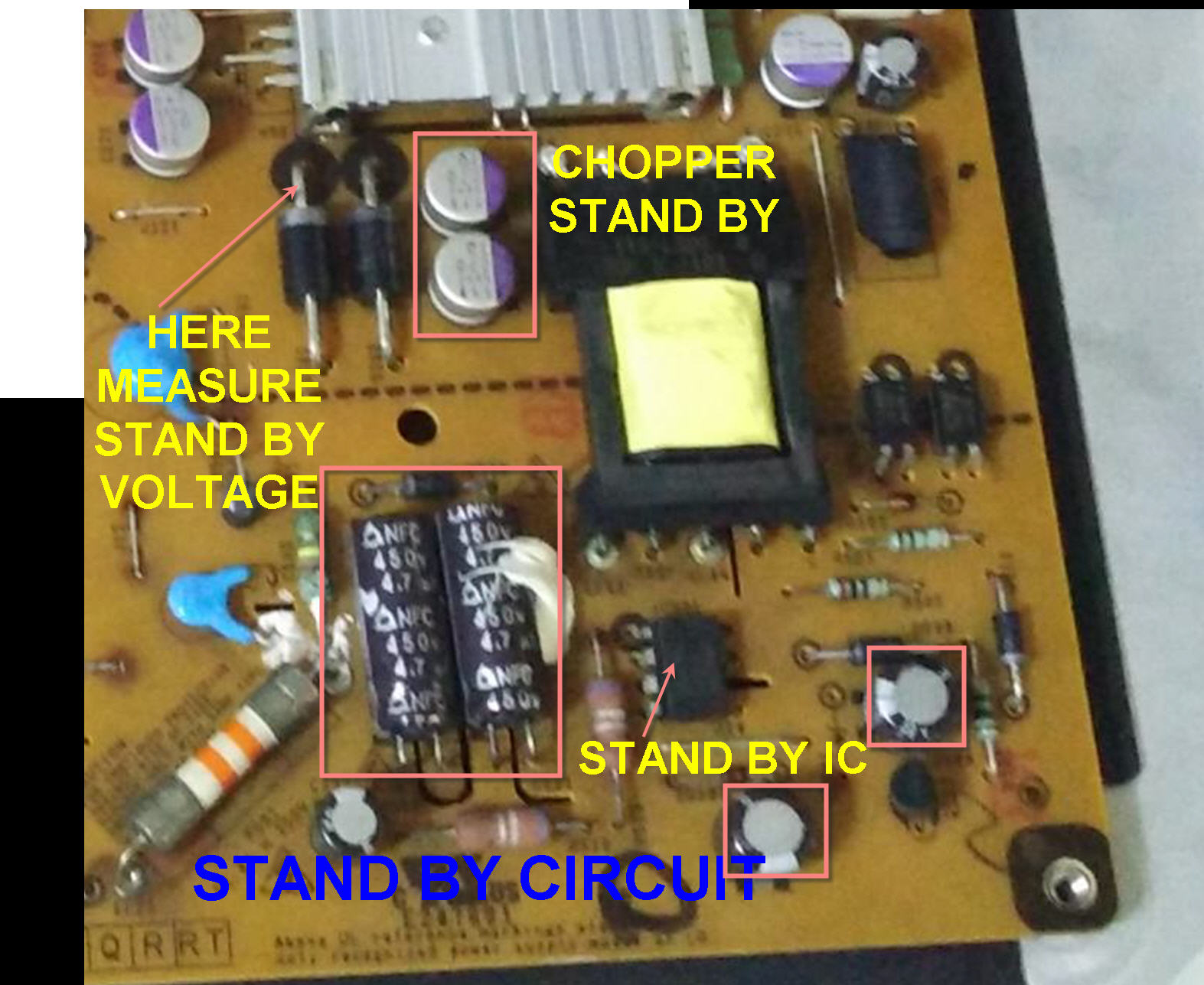

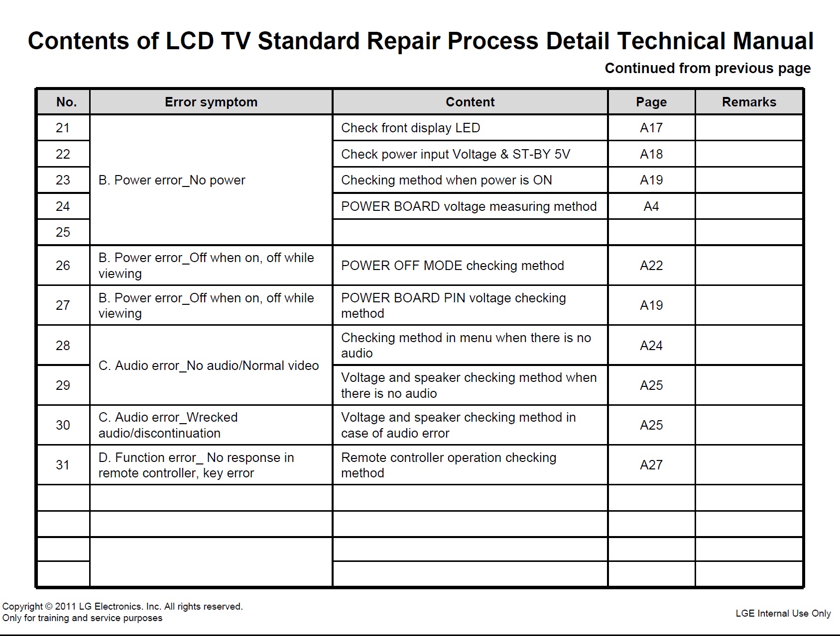

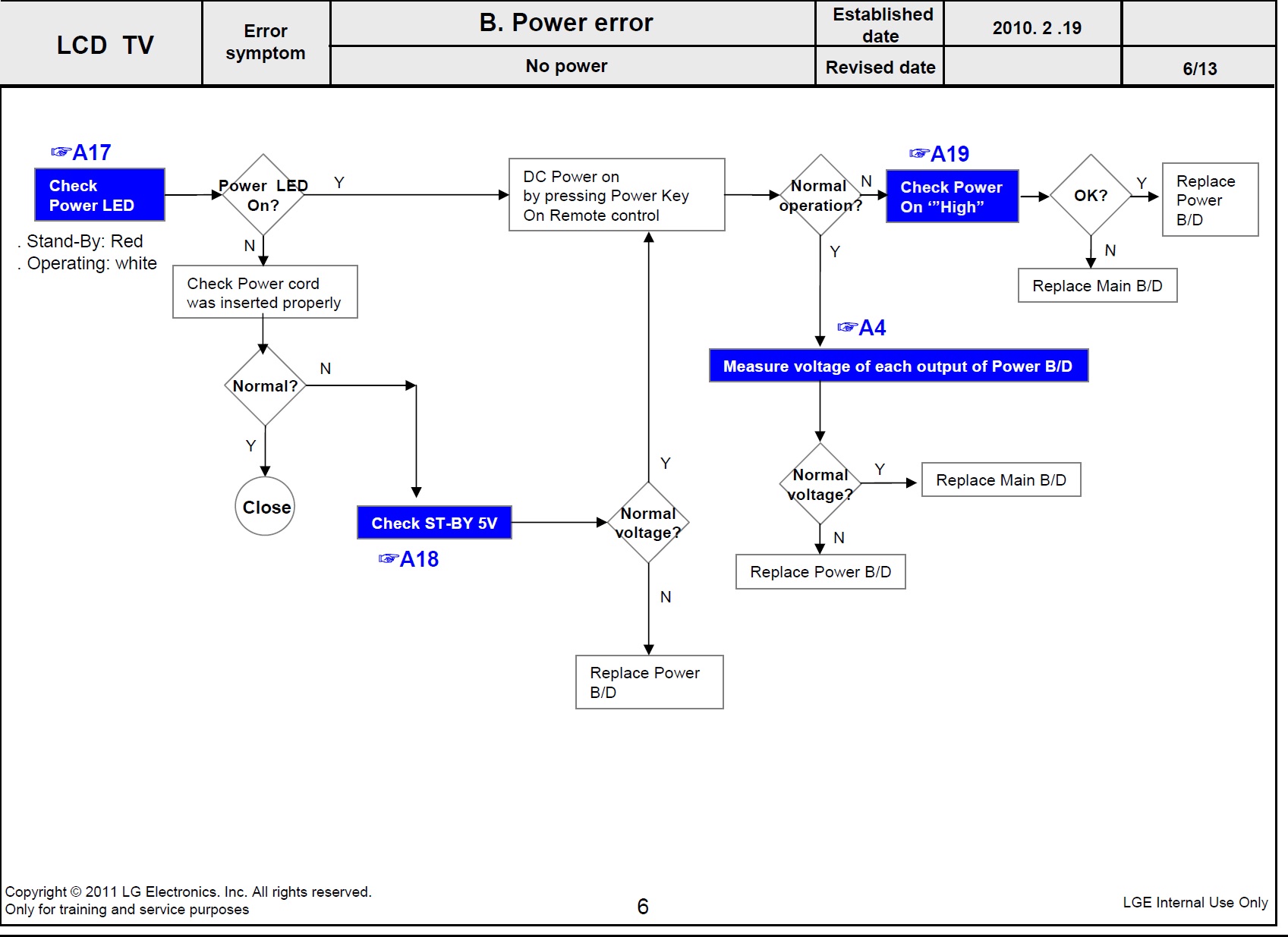

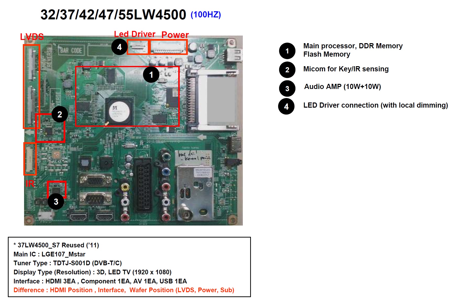

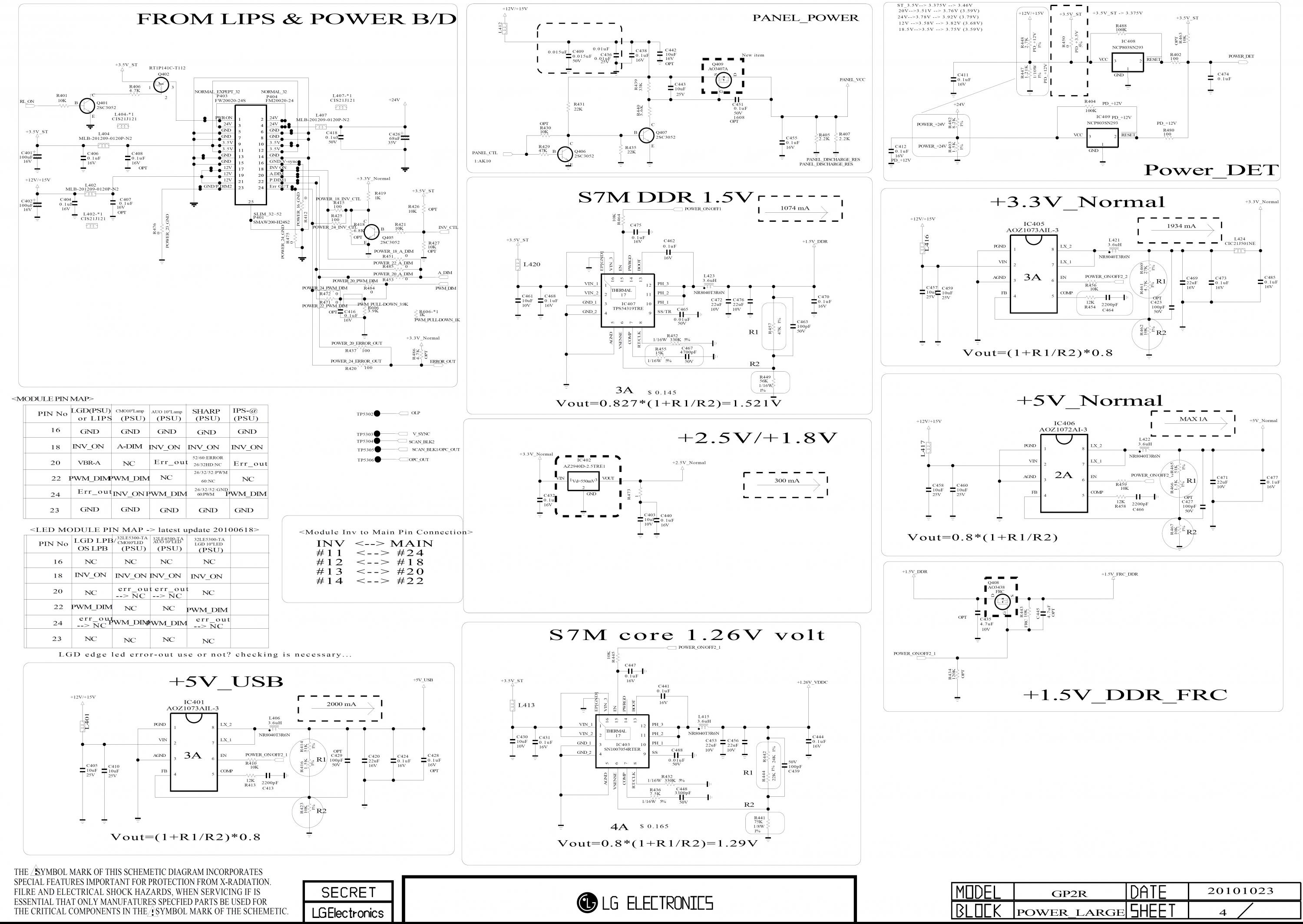

        Re: LG 42LW4500 no power
        HI
        Please take voltages on socket ps to the MB .
        and tell us about hearing the relay click if happend it means MB proccesor is acting .
        if nothing happened please be sure of stand by voltage (+5v ) .
        then measure regulators in the pic below . tell us what happened .
        service manual also found .
        thanks

            thanks for the pdf.
            but it only have diagrams for the main board, they didnt provide the power supply board diagram.
            No click and no 3.5v
              HALLO
              here is the stand by circuit on the output two diodes measure 5v if not found the whole stand by cir not working ( that means IC/ CONDENCERS/NO DC ON IC/OPEN RESISTOR...) .
              IF VOLTAGE OK ON THE DIODES FROM THE DIODES TO POWER SUPPLY SOKET MEASURE THE PATH .
              THANKS

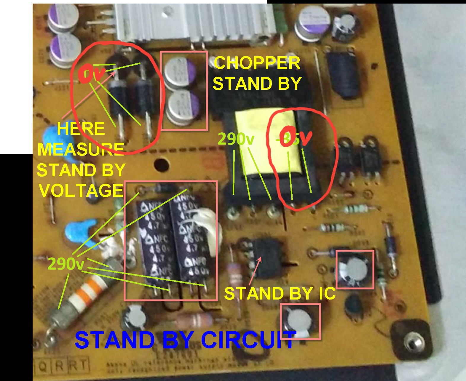

                      everyone thanks for the suggestions.
                      these are voltages on the standby circuit sides, in the picture.
                      DC voltage taken against the hot side ground. except the 2 big diodes on the sec side.
                        Can you please verify the P/N as printed on top of that SMPS IC? A6095 does not come up with anything with SMPS.
                        All the numbers as printed on top of the IC. Or good closed up pictures.
                        Those two rectifiers D201, 202 are OK?

                          my mistake, typo error - its A6059h.
                          i pull out the 2 big diodes, they are 2 different marking. what is the difference ?
                          Diode 1) -SB560 SSG11033 - shorted
                          Diode 2) -SB560 SSG11022 - ok
                          intend to replace them.
                            Those two diodes are the same, SB560, they are connected in parallel so when you tested them while they are still soldered to the board, if one is shorted out then both of them should show as shorted circuit. You should remove them and retest, if one is shorted out then I would replace both of them.
                              yes indeed, have pulled them out of circuit, one shorted.
                              i was wondering why marking is different. will see if i can get some from local store.
                              hopefully i can get back the 3.5v
                              will update later, thanks all
                                The other numbers may be for date code, factory code, etc.
                                • spintop
                                  • Feb 2011
                                  • 132
                                  success !!
                                  replaced 2 diodes, got the power led light, switch on can hear the click sound.
                                  tv up and running.
                                  Thanks budm and everyone who have offered suggestions and information.
