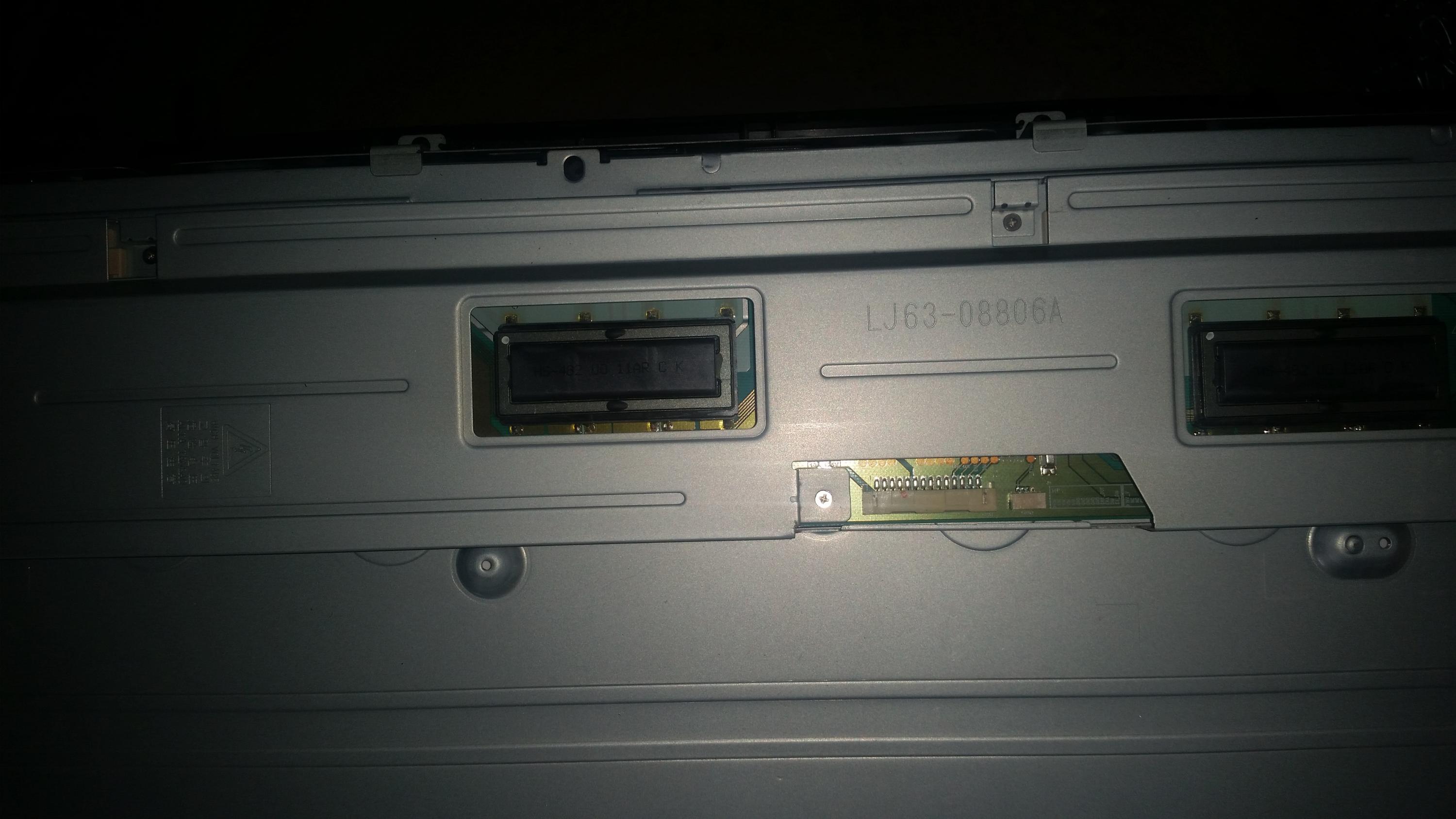

      Re: coby TFTV4025 POWER SUPPLY 24V NOT PRESENT
      What inverter does it use ?
      • hmendez86
        • Jun 2015
        • 344
        • united states
        inverter

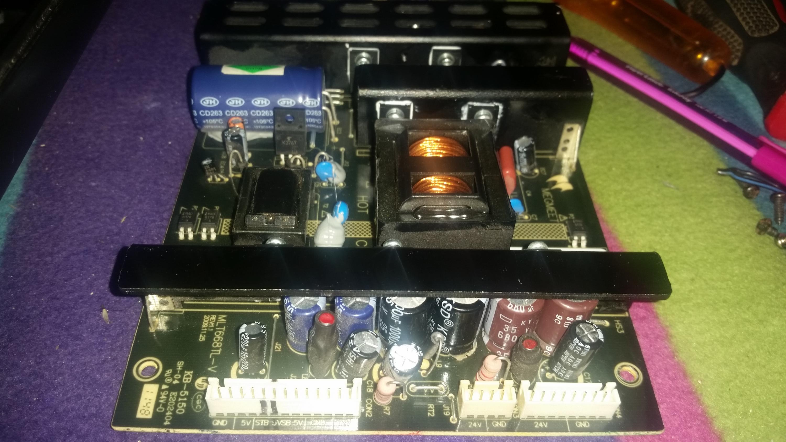

          I marked 2 blck lines on the stby voltage that's were I jump to self start power.....and it just give me 5v and 0 on 12v and 24v...
            Is this the your board? Please loo at the numbers as printed on the barcode sticker.
            Coby MLT668TL-G Power Supply for TFTV4025
            http://www.shopjimmy.com/coby-mlt668...pply-unit.htm#
            Do you have about 400vdc between the two legs of the main filter cap when you force on the power supply?
            Do you get the 24V if the inverter board is not connected to the power supply board?
                  MLT668TL-v
                    Next you need to find out if you do have the 400VDC between the two legs of the main filter cap or not because the 24V PS needs that boosted Voltage to run.
                      It is a 450v 120uf the big cap that's were u point to it......I replace it with a 450v and 150uf and same thing
                        Again, We need the DCV readings between the two legs to find out if you have PFC Voltage boosted Voltage or not.
                          One led -1.344 dcv second leg 8.45dcv... am I right how I tested or need to put probes to both legs at DC voltage...
                            We want to measure the DCV between the two legs of the cap, red probe on the positive leg, Black probe on the negative leg.
                              Ok 347 dcv
                                Is that with the Tv on ?
                                • CapLeaker
                                  Leaking Member
                                  • Dec 2014
                                  • 8138
                                  kinda low for boosted voltage. The TV has to be on... other than that he would only get rectified mains at 170VDC.
                                    I jump start the power with the stanby voltage
                                    • hmendez86
                                      • Jun 2015
                                      • 344
                                      • united states
                                      Cap leaker)) so that's means ??? So 347dcv should be ??? And what is causing this problem.......rectifier, resistor, or cap
                                        What is the P/N as printed on top of the IC1?
