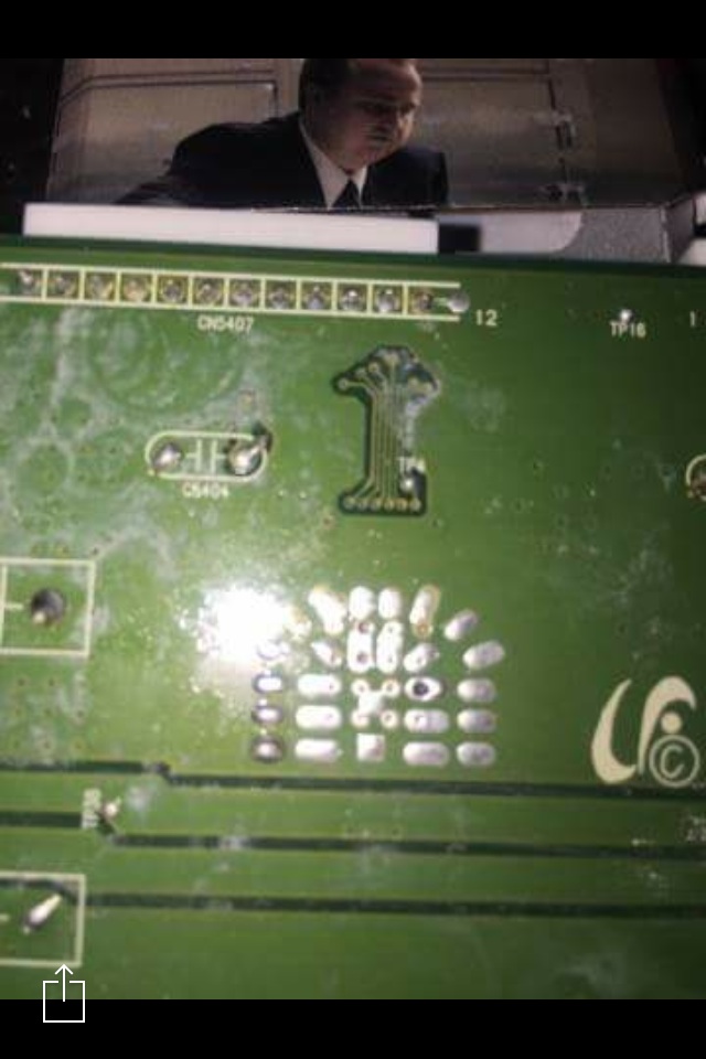

              Model PN60E6500E This is the underside of my upper Y Buffer Board. As you can see the solder has melted away and left holes underneath where the IC's are. I re-soldered all the holes and put it back in. The initial problem was the tv power cycling on and off with the Samsung logo showing briefly onscreen. Now the set stays on but I am getting VS & Va's ramping up then dropping off, I have all the ribbon cables to the screen and X drivers disconnected. Is it possible that because the panel is not calling for power from the boards that the logic board is telling it to shutdown? Any and all advice would be appriciated thanks.
              • Logen1
                • Mar 2017
                • 32
                Re: Samsung PN60E6500EF blinking red light
                It was the main board that was at fault, I used solder paste (Paste-It) from Lowes and used a heat gun with a custom made end and fixed the Y Buffers set is up and running but the Y Sus is making a rather loud humming noise? I can't really here it when the back cover is I. Though?

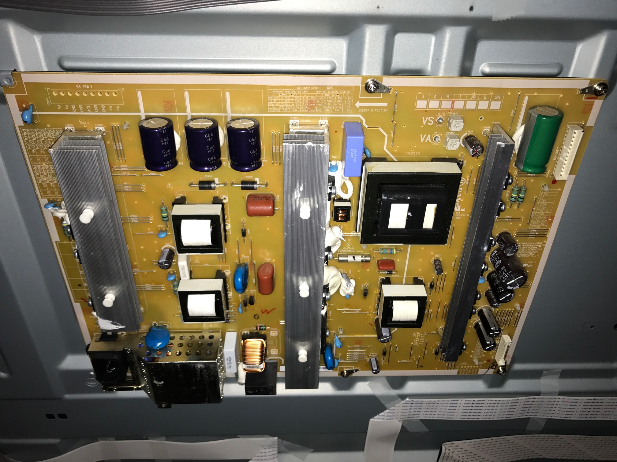

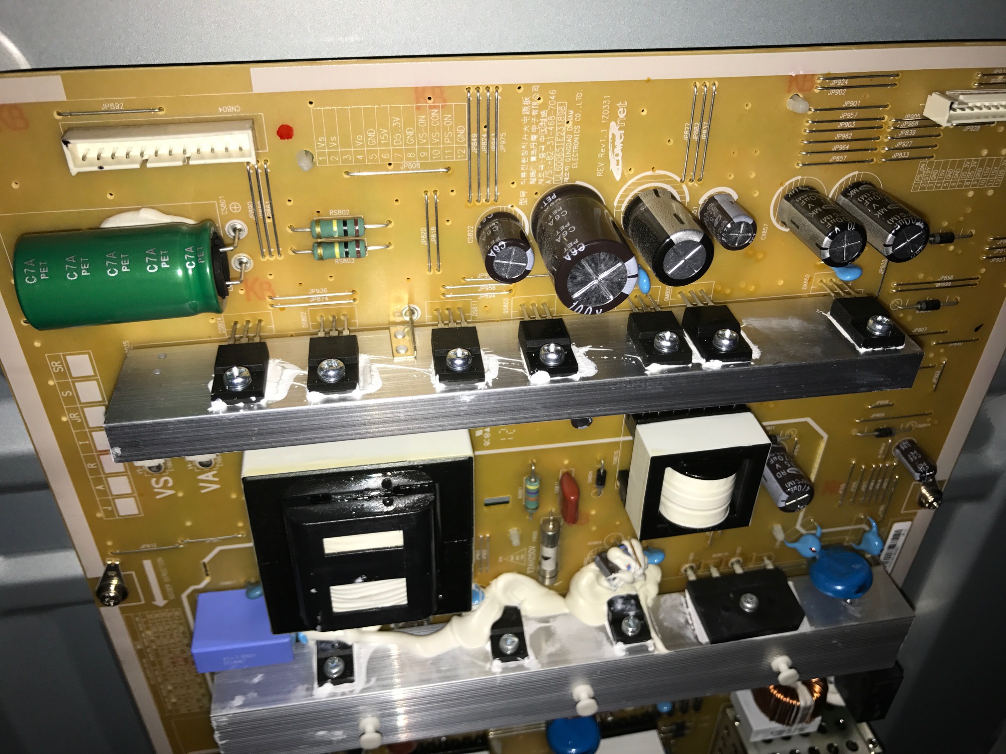

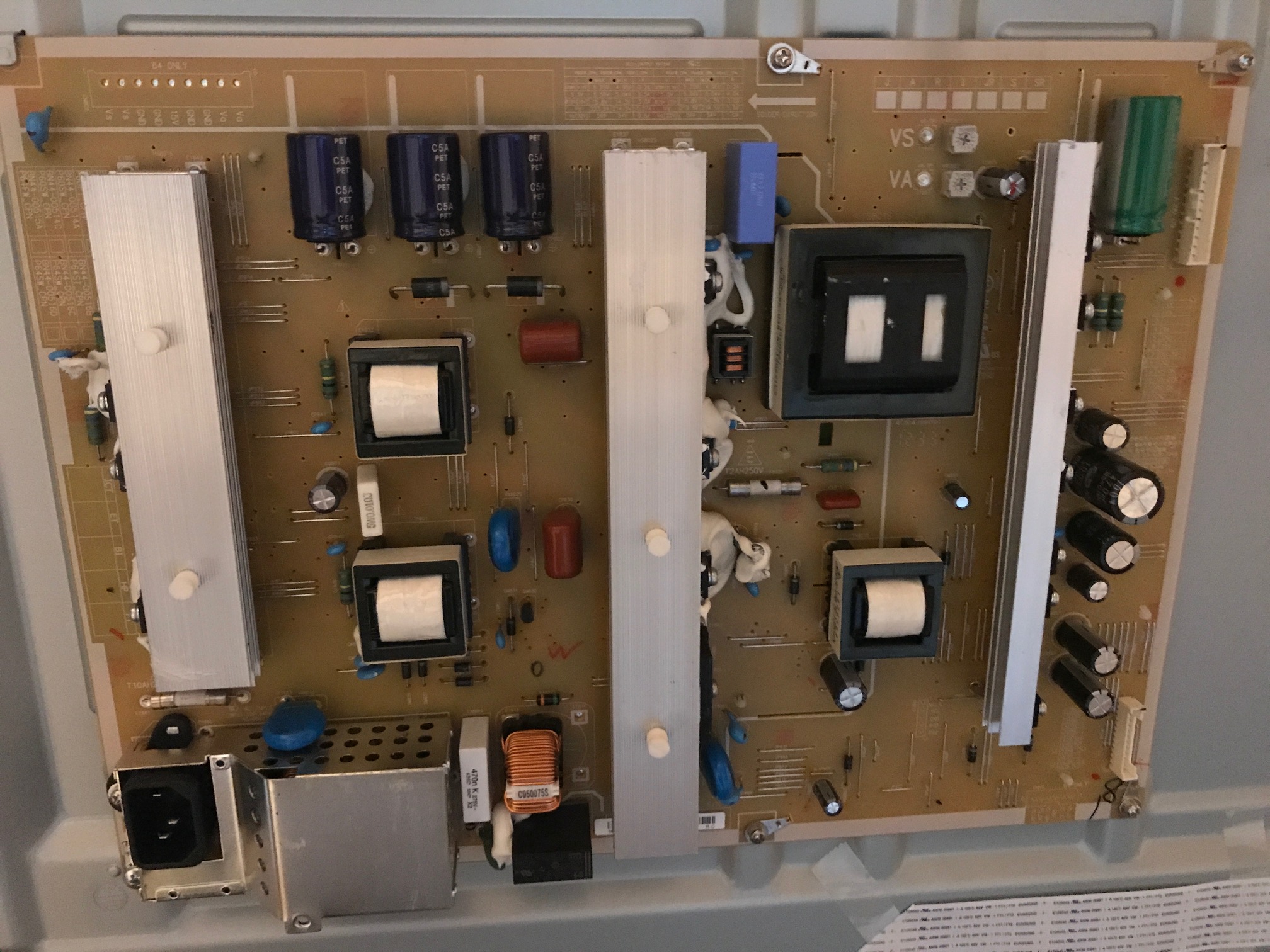

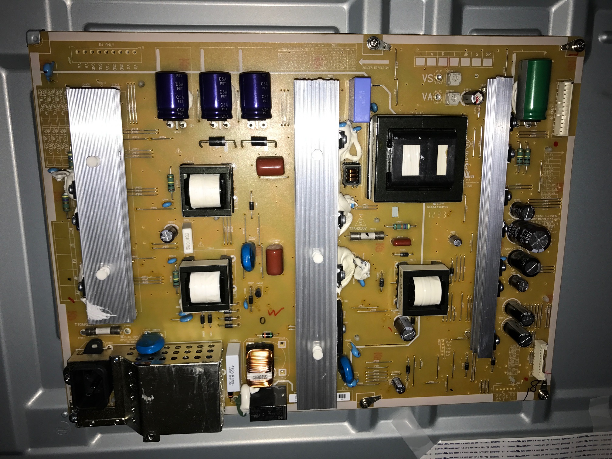

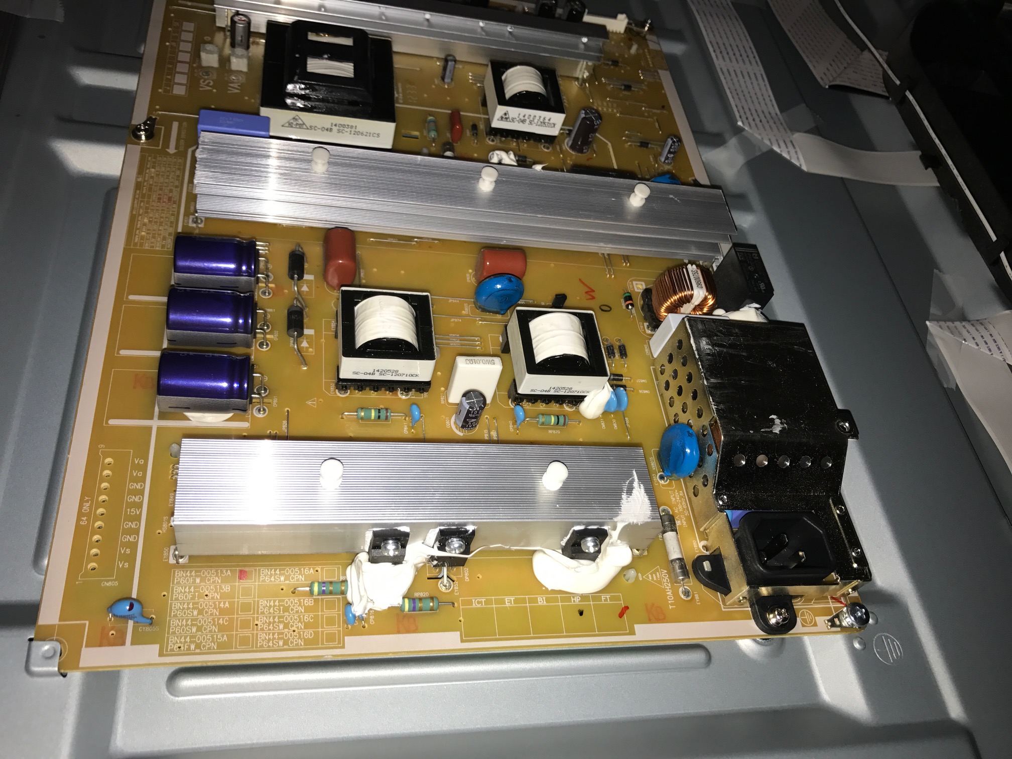

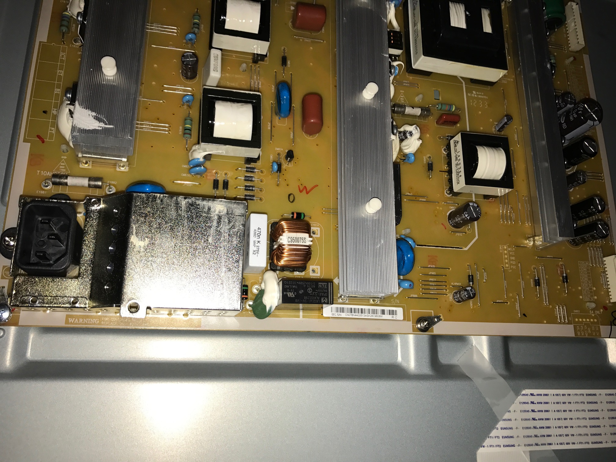

                              Attached are pics of my powerboard. I don't see any bad caps (noticeably) on this board or any of the others. Interesting to me that right now when the TV is plugged in there no standby light on, when I blow a hair dryer on the lower left hand quadrant of the power board for less than 30 seconds it powers right on... I basically blew the air on the metal piece to the right of where the power supply cord coming from the wall plugs into the power board.
                              i can't make this stuff up
                                Are you talking about the metal box with the holes in it? Can you see what's inside the box? Could be a bad cap or bad solder joint. How about some straight down shots of the bottom of the power supply?
                                  if you have no standby and it starts up when you apply heat, you will most likely just have to change out the stby cap. they regularly fail without any visual sign.
                                      Can you point out the stby cap in my picture? is it on the power board or elsewhere? Sounds like that might be a possibility as that exactly whats happening. Would like to try and replace it if I can. Also, just to elaborate, after applying the heat the stby light comes on and I can power on the TV briefly but then it starts power cycling... turning on/off repeatedly.
