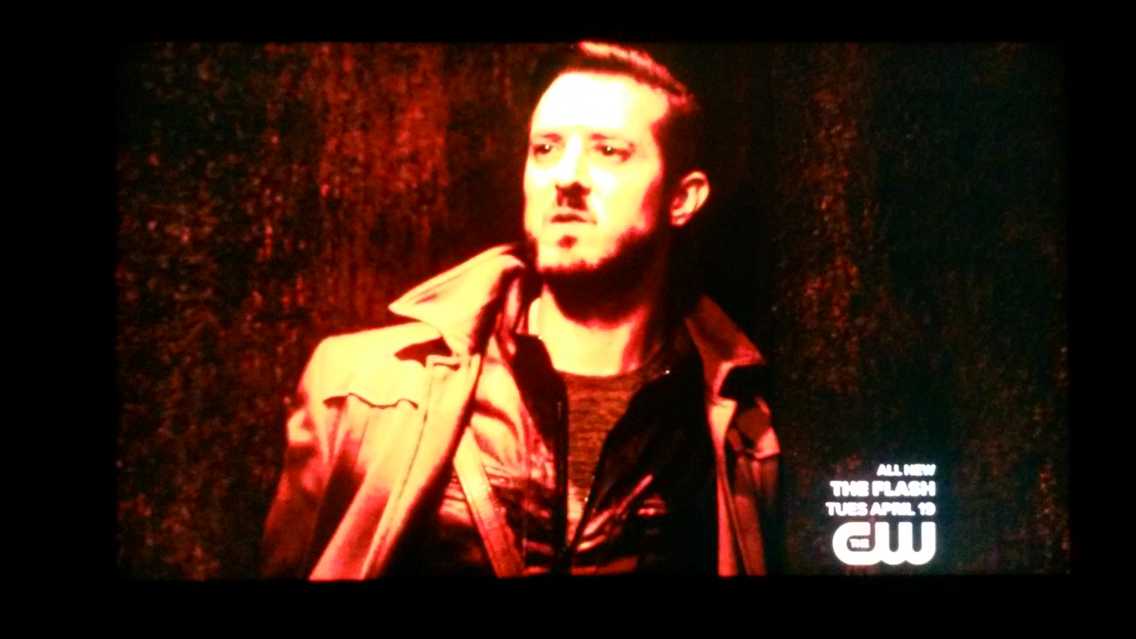

    Hello hopefully some of you can help or guide me...
    My Samsung LN40A530P tv randomly colorized faces and light colors when I was watching a movie. After some online researching I think its solarization even though mine is not as bad as most ive seen. My menus all seem fine and most colors are fine even though some get extremely dark

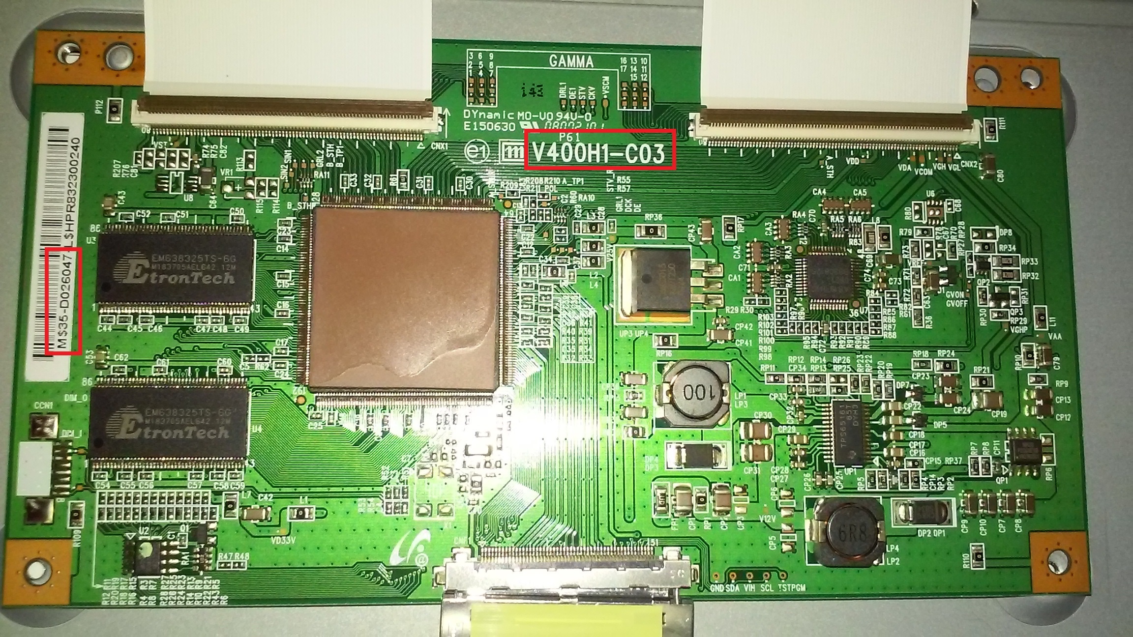

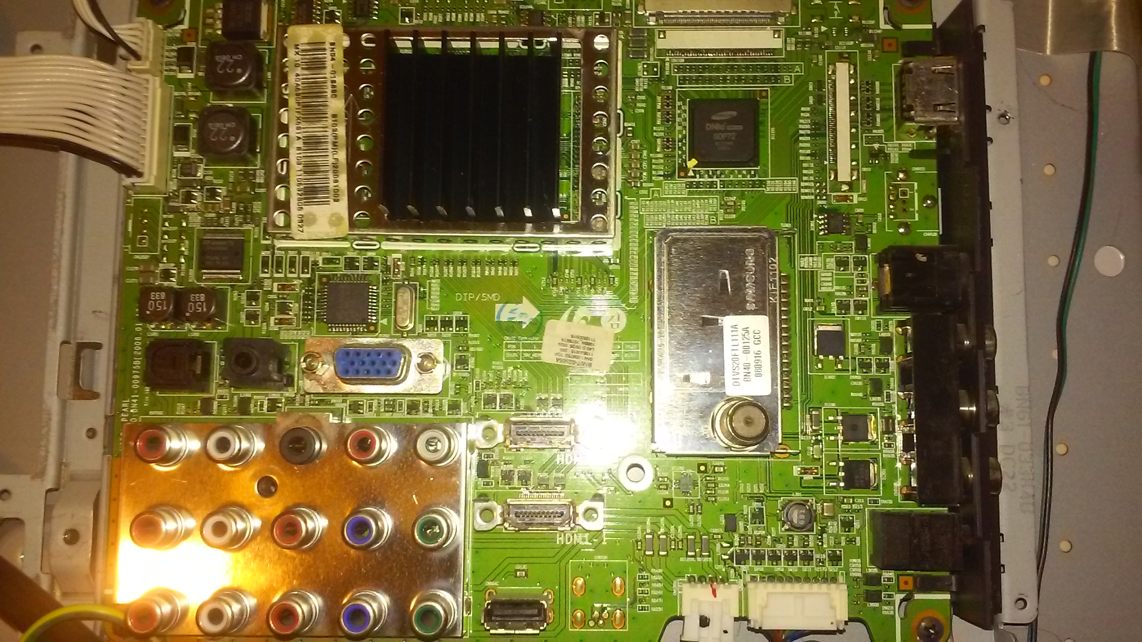

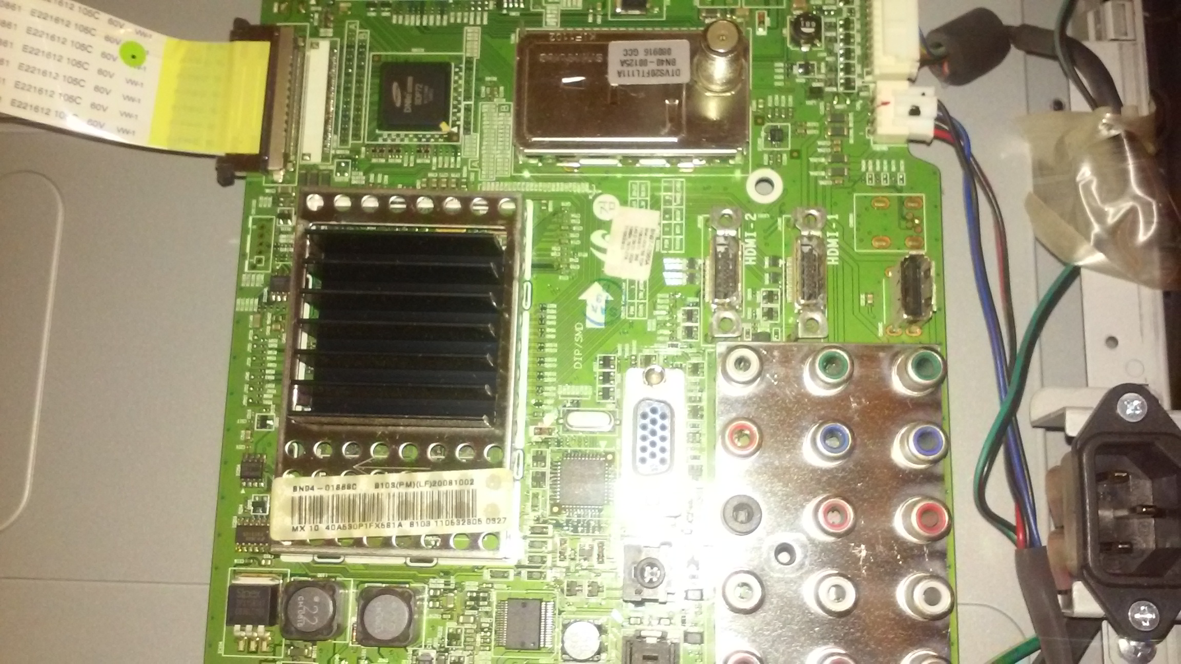

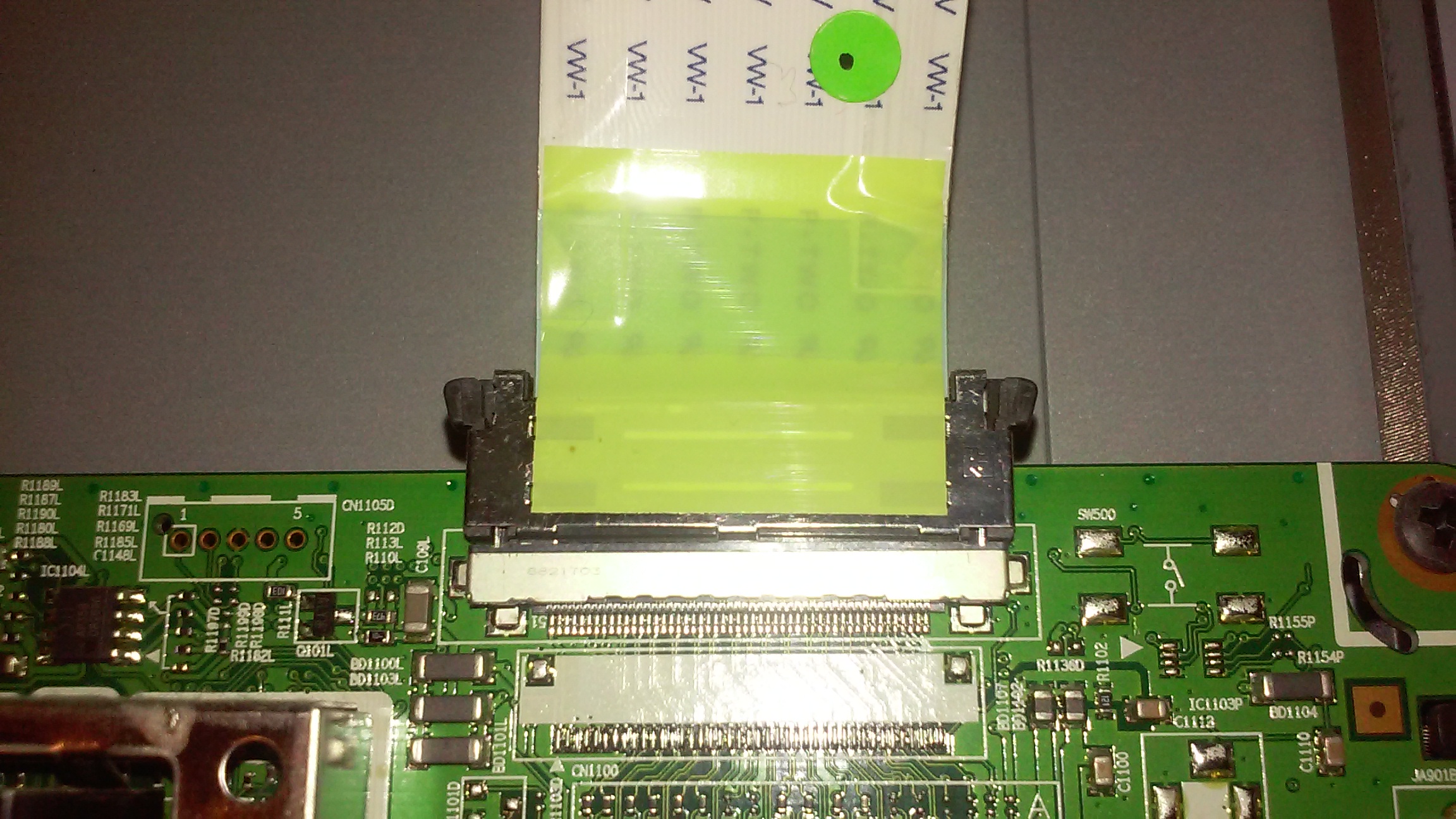

    Posting pictures of the back of your tv showing the boards with clear pictures may help you more with fixing your problem

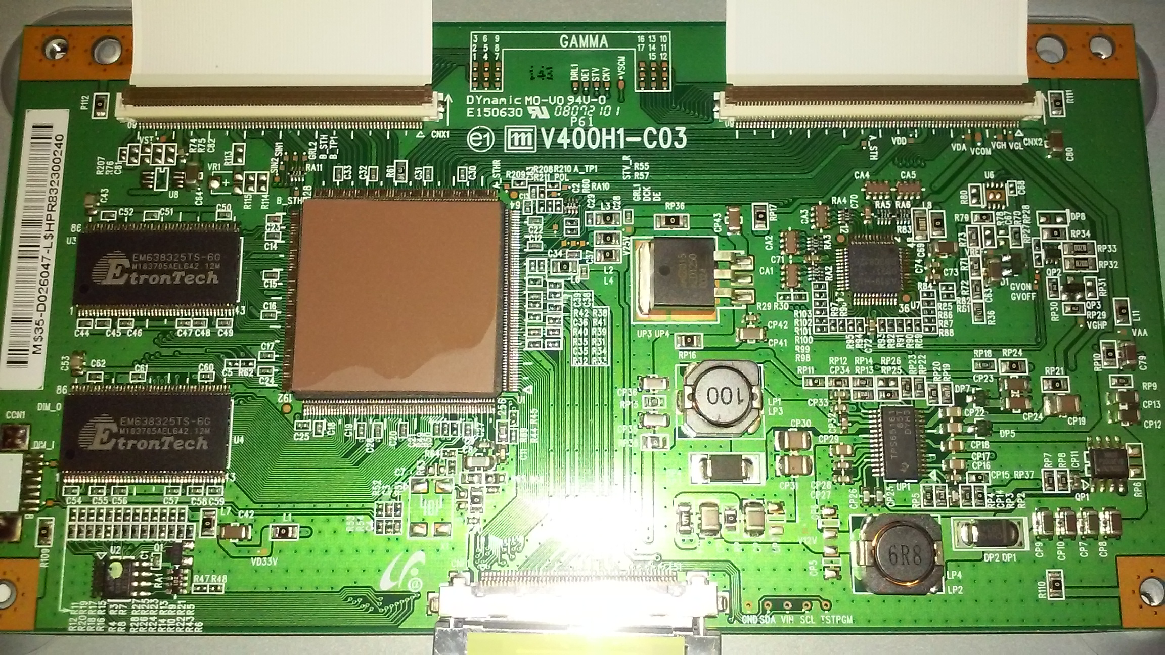

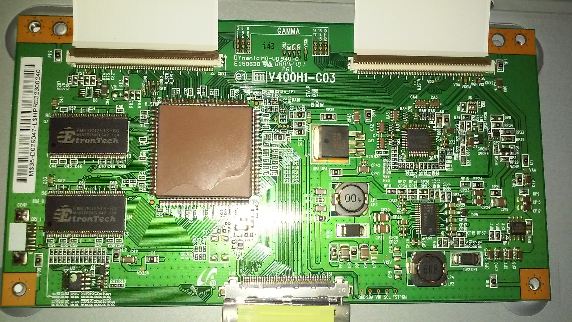

      post a good hi res picture of the Tcon board. See if there is a AS-15 chip on it.

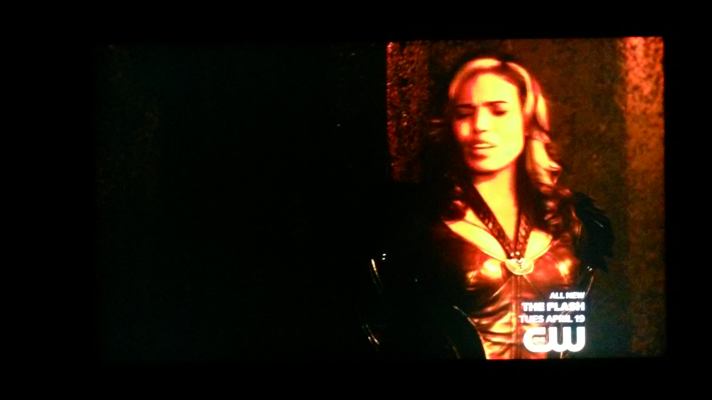

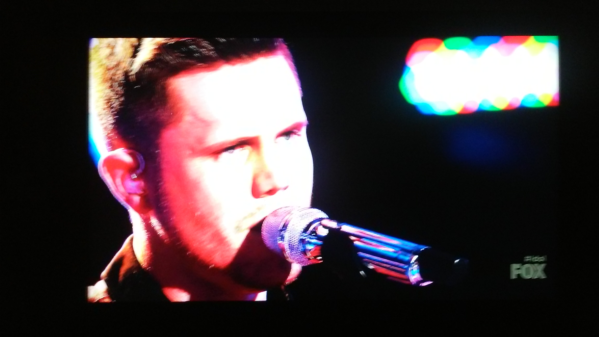

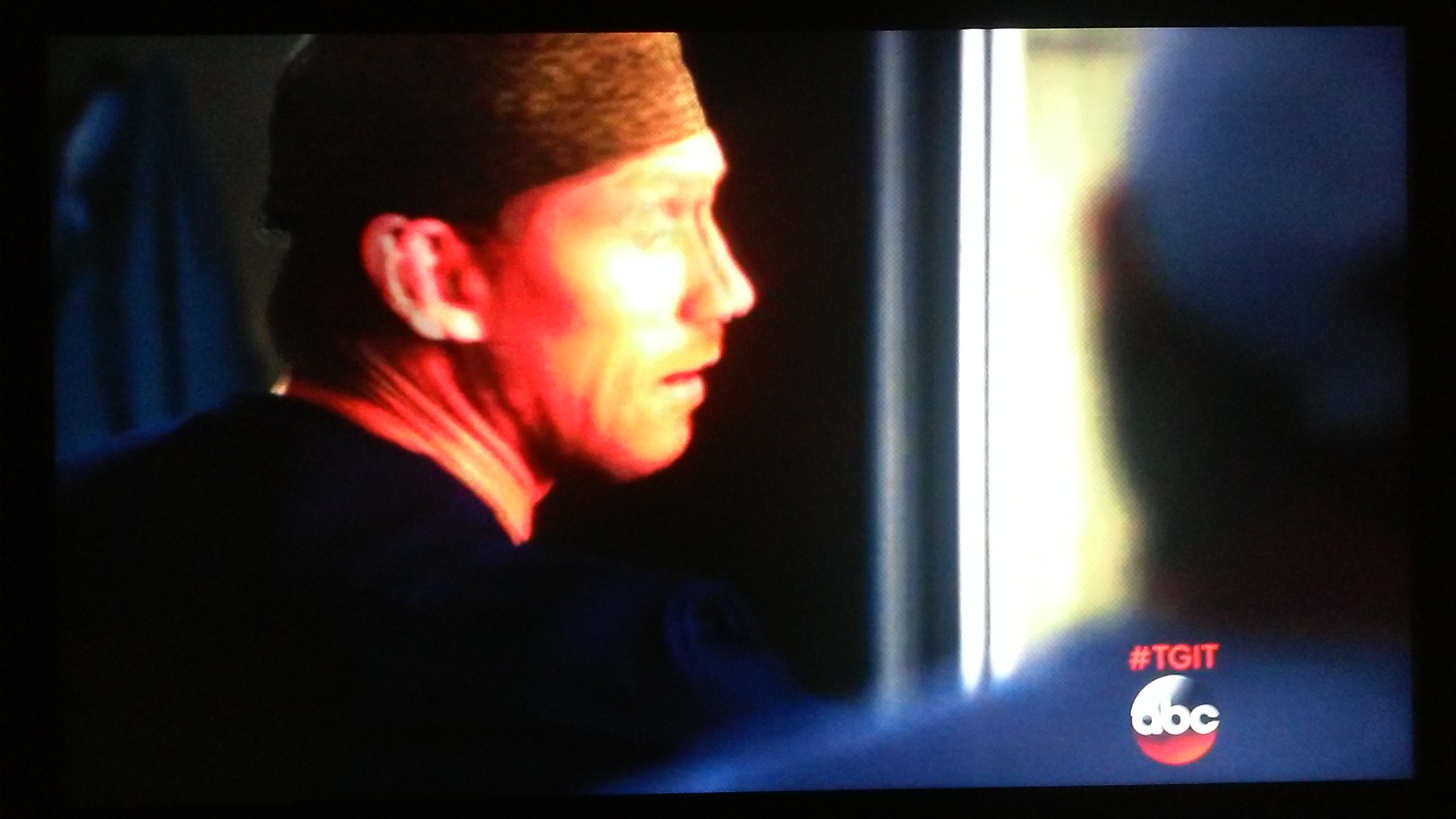

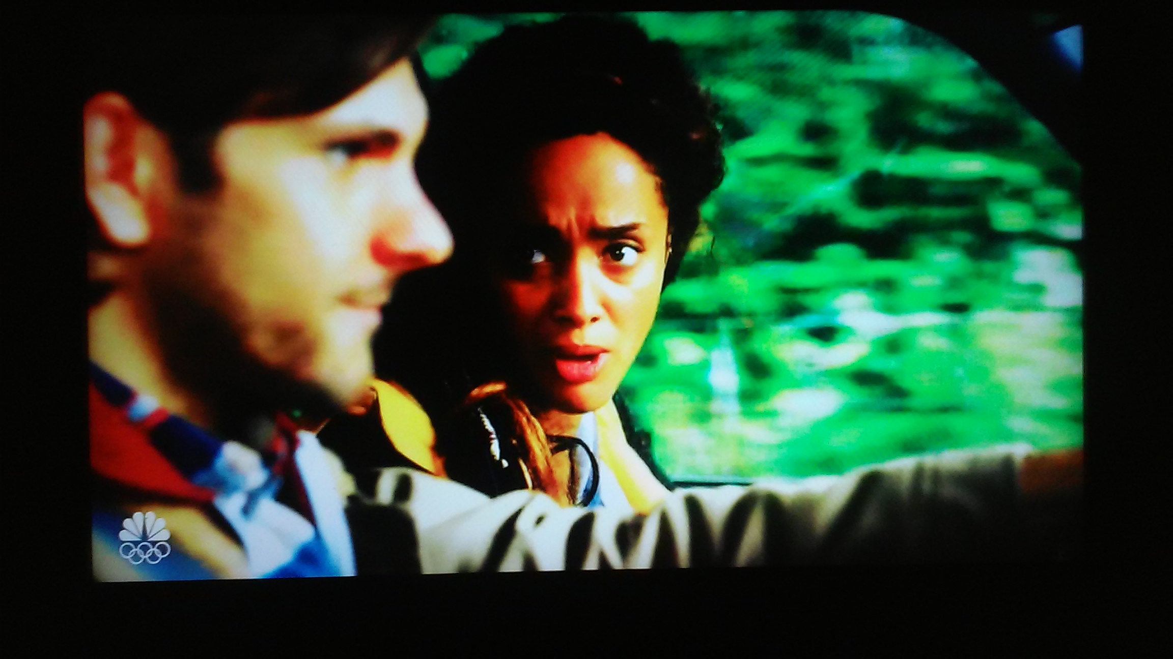

        Screen shot of the images on the screen also.

          Thanks for the quick replies, attached are pictures. thanks again
            Re: Light Solarization on Faces on Samsung TV
            It looks like it has slightly off Gamma Voltages, I see AS15/or AS19 GAMMA Vref IC on that T-con board.
            You can test the GAMMA dcV on those GAMMA testpoints on the board.

              I think it's a AS19, picture isn't that clear.

                Sorry about the bad pic, Yes it does say AS19

                  It looks like a replacement Tcon is required. Can you or do you know anyone who could replace the AS19 IC. If you order a replacement you need to match up the numbers shown in the photo.

                    You can also use a V400H1-C01 board in that TV. The AS19 chip is much more difficult to swap than the AS15. It has a ground plate / heat sink on the bottom that is soldered to the board. I consider myself quite good with swapping small surface mount chips and getting one of these back on straight is beyond my skill lever for sure. And that's with a nice $350 hot air rework station.

                      Changed the tcon board as changing the chip would have been impossible for me and this worked.
