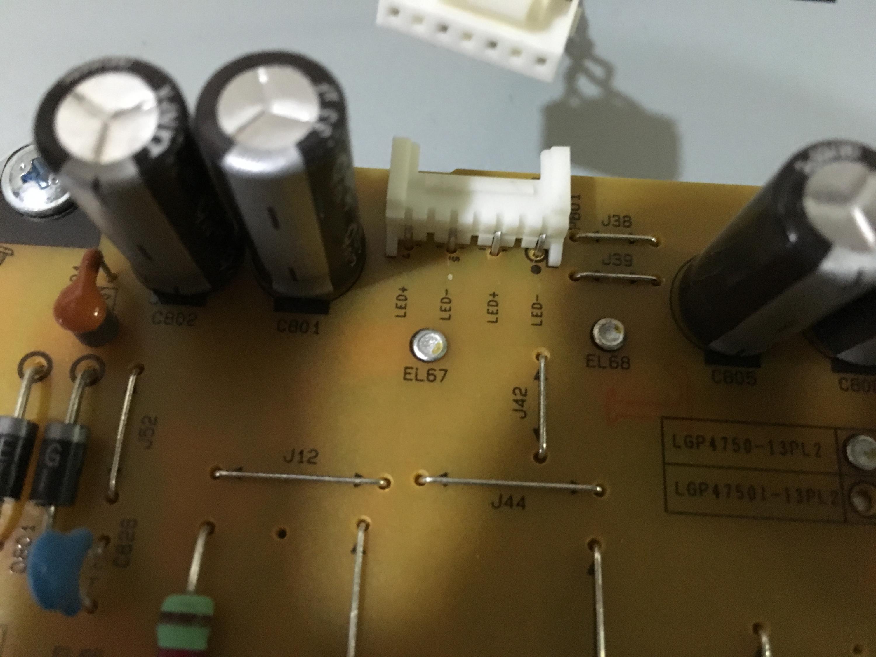

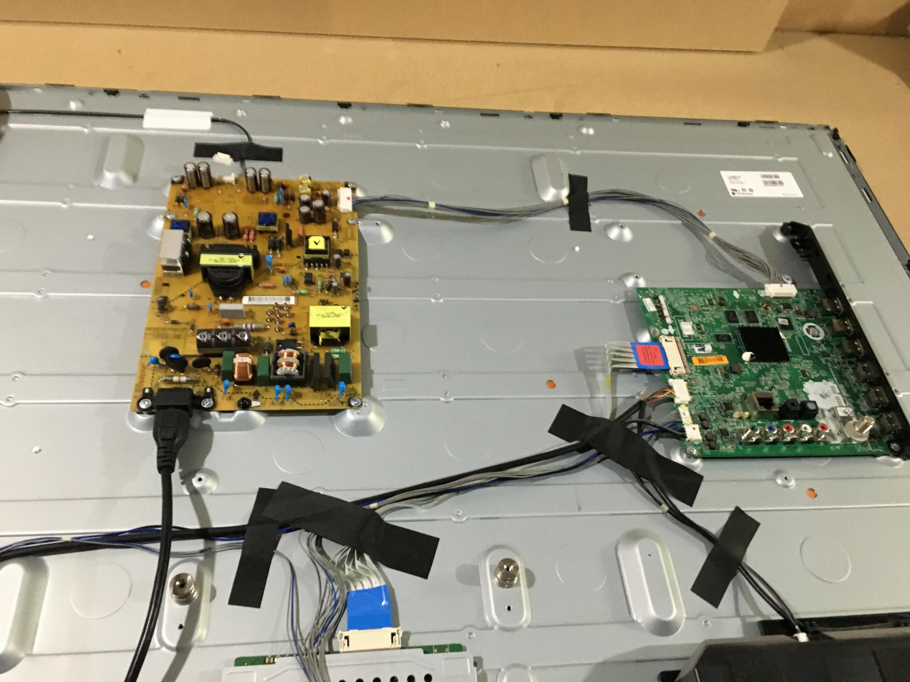

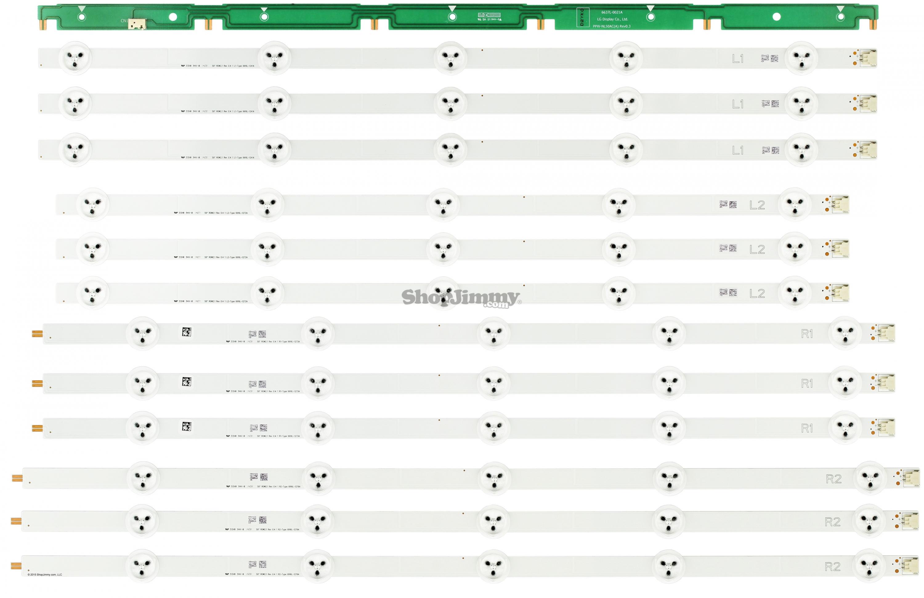

This LED TV has the LG logo come up for a second or two then goes dark. I usually assume its a bad LED strip. I tested the LED connector, and the voltage jumps up to 170V, then quickly drops back and settles at 79V. I removed the LED connector from the p/s and tested the voltages again on the connector. They still momentarily jump to 170V then drop right away.
Is this a board problem or a bad LED on one of the LED strips?
