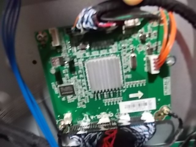

                    THere are only three other boards on this tv, T-con, main board, and another small board that I don't know the name, but I know the eprom and microprocessor is on this board. Back when they were all one board, I would have replaced the main board, but i don't know which one to replace. I pulled the ribbon cables one by one, all the ones I could pull, and no signs of life. I unplugged the LED cables one at a time and still nothing. I don't see know it could be the LCD panel or the backlight LED's and work for hours and hours with no issues. I think its a eprom, or main board. What do you guys think?

                          Unfortunately the RCA is a in home service call. I forgot to take pictures. However, I think you will understand my question. There are pictures of the westinghouse boards.
                          The square board seems to have the eprom and the processor on it. Am I right about that? So the board that your thinking I need to replace is the one with the eprom, right?

                            The RCA tv has the same configuration of boards. What I would call the main board on the right. I don't know what that square board is called. However it looks like the main processor right in the middle, and the eprom just off the top left corner of the heat sink.

                                You do need a better camera. The first pic is a FRC (Frame Rate Converter) board. The second pic is the main board.
                                There are a few different versions of the main board available and I have no idea which one you have. Anyhow... SJ lists a EEPROM for it. So freeze UL2 (it sits top left right above the main IC and under the connector. Can't miss it. Freeze that UL2 IC and turn the set on. Make exact notes and pictures of the boards. Also make measurements of PSon and BLon signal when the TV is going nuts.

                                  Yes, I am real unhappy with this camera. Its a Nikon, and I will never by
                                  another, the focus is terrible. Thanks for clearing up my confusion on where the eprom was located. I will order a main board.
