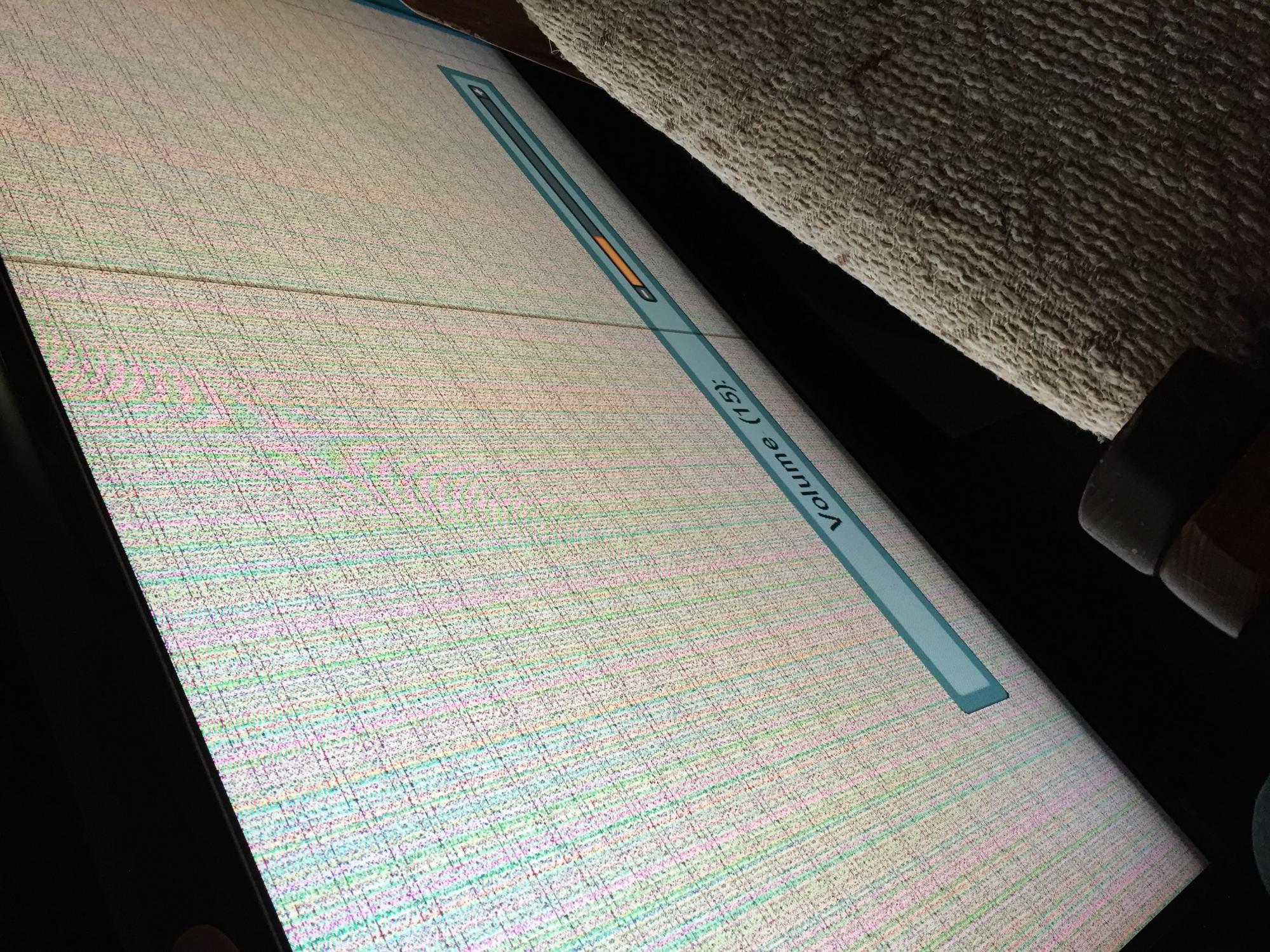

    Mitsubishi LT-52148 LCD - white picture with lines
    This happened out of no where. Wondering if it's a panel issue? Before I dive in and take it apart

    Re: Mitsubishi LT-52148 LCD - white picture with lines
    Hmm possibly mainboard fault here. Take it apart and get some images
        It does have sound, no remote for it to tell
          check the LVDS with an oscilloscope and turn the menu on and off all the time. If you see changes on your scope, it's not the main board.
            Don't have an oscilloscope but it only shows a distorted picture with an input. The menu displays crystal clear even volume, input source etc. Would that mean it's a tcon issue or?
              Ok this has a "system reset" button so I tried pressing it to see what would happen and now it's displaying a picture normal.
              What's up with that? It does have some random lines going down as shown in that pic. Not sure if that indicates a panel fault?
