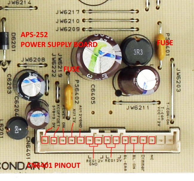

      Here is the board and I measured on the connector at the bottom left.
      P.S. I checked the white use near the input and the two yellow ones near the bottom left connector.

        Could you list the Pin names and voltages on those pins

          And if you can remove the connectors and take the pictures of the connectors so we can see the labels for each pin of the connectors that will be a big help, right now the wires are in the way.

                    Are you sure the top 2 pins which you give the voltage for are correct. I see STBY3.3V and ACOFFDET as the top two pins?

                      Re: Sony KDL-32BX300 wont turn on
                      See the pin outs.
                        Thanks budm for the confirmation that the top two pins are Stby3.3V and ACOffdet.
                        Rodville have you checked the two fuses alongside.

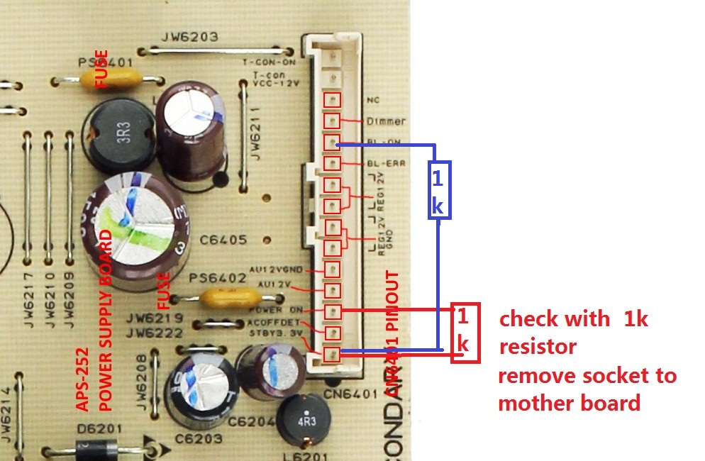

                          remove socket to mother board and make a jumper at backside pcb with 1 k resistor as picture, (pin 1 to 3) stby to pwr_on
                          same way you can check back light on at jumper from stby to bl_on. (pin to pin 11}
                          check all voltage.

                            anmol What do I look for with this jumper?

                              What is going to happen with the two forced on resistors installed is that when you apply the main AC to the TV BACKLIGHTS should come on and stay on, and the DCV Between the legs of the main filter cap in the hot side should be closed to 400VDC.
                              The cable between the main board and the power supply board must not be connected for testing this forced on condition.

                                Sorry it took me longer to find the resistors than I thought it would.
                                Yes the backlight comes on and stays on.
