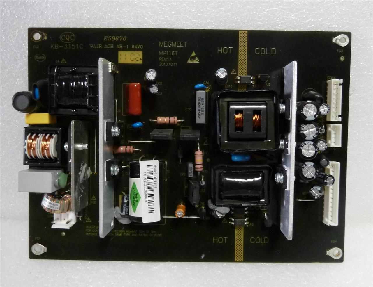

    hi
    i have this vidao cheap lcd tv model 32A60
    it powers on....green power light comes on
    however there is no backlight and did flashlight test and has no picture
    i tested some of the voltages and i get
    12v pin= 6v
    24v pin= 6v
    5v pin= 5v
    pson pin= 4.4v
    i tested the 5 caps near these pins 1000uf and 470 uf using a esr meter and in circuit they seem to test and look ok
    the only thing i could see otherwise is the large 450v 16uf cap in the center of the board is bulged on top
    could this be the issue?
    here is a photo of the power supply board
    thanks

    Re: Vidao 32 inch lcd tv powers on but no backlight or picture
    Previous thread which may be of some help to you:-
    I replaced one switching Transistor 2n4401 (Q8) which is connected to the opto-isolaters and it works great now.
    https://www.badcaps.net/forum/showthread.php?t=40142

              one question i have though....the large 450v cap is bulged ....is this an issue or not really?
                I don't know if anyone can tell from the photograph but if you can see that it that it has bulged, then it should be changed.
                  thank you
                  it is definitely bulged
                  the photo i posted is generic photo
                  one questionb....how long do i have to wait until i can desolder the large cap safely to replace...i want to swap from another board
                  without getting zapped...
                  thanks
                    Measure the voltage across the two pins and when it is near to 0V it is safe to do so.
                      Update I replaced the 450v cap and q8 and no change still get low voltages
                      Same readings as before
                      Any ideas?
                        Are you getting close to 400VDC between the two legs of that main filter cap? If the PFC Voltage booster is not working the 12v/24V SMPS will not function correctly.
                        BTW, the cap is only 16uF? Not 160uF?
                          sorry its 68uf not 16uf
                          and i have not checked for 400v while in circuit
                          is that something i can do safely in circuit?
                          the cap i replaced was bulged....i replaced it with another cap from spare duplicate board i had
                            You should at least plug what ever you are working on into GFCI outlet at the very least.
                            Just have to be careful and not touching anything on the board with your hands or body.
                              If the boosted Voltage is present, then you should check the capacitance of that gray rectangular cap off the board, and if that checked out OK, then we need to find out if the SMPS IC for the 12V/24V has VCC to run.
