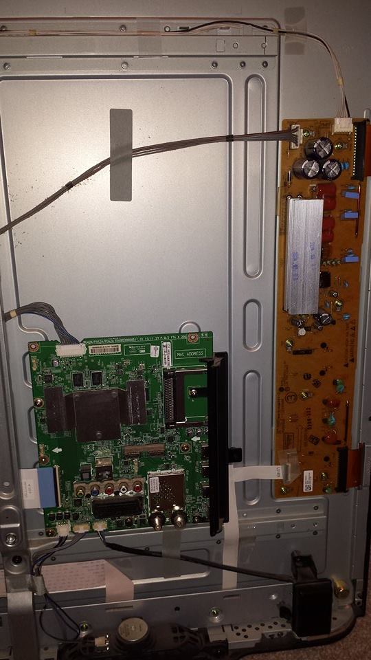

    Hi guys this one has me stumped i have checked theres no image, turns on and off with remote, report was pic went off but still had sound, i replaced all boards except for lower buffer boards, (the replacement boards were from a smashed screen tv same model etc), there is no activity on the led on the controller board, and i noticed that the red light in the digital out is not lighting either, 5v standby is there, i have checked VS = 207 VA = 55/4 va changes from 55 to 54v constantly panel states 207v and 55v i disconnect lower buffers and the 55v returns steady, but no 18v line present between y sus and z sus
    many thanks

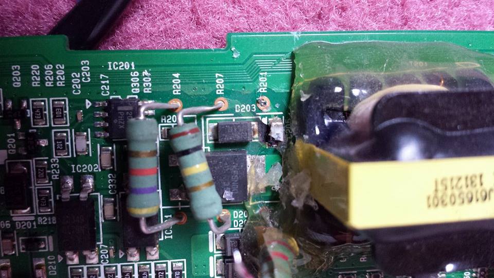

                  sorted it it was a burnt out cap between the yellow transformer and the nearest heatsink on the ysus cap was C205 checked fet and diode close by and they checked out ok
                  replaced it and now the set is working and got the 18v back on the z sus

                        Re: Lg 50pb690v-zc
                        Originally posted by martino
                        So was that on your old or new y board?
                        both Martino,
                        one the cap was blown and fet and diode was ok
                        one the cap was ok and the fet and diode were short
                        i could smell a faint burning smell
                        i think the tv with a smashed screen either went wrong and then he lost his temper with it and smashed it or the screen getting broken caused something that took the cap out
