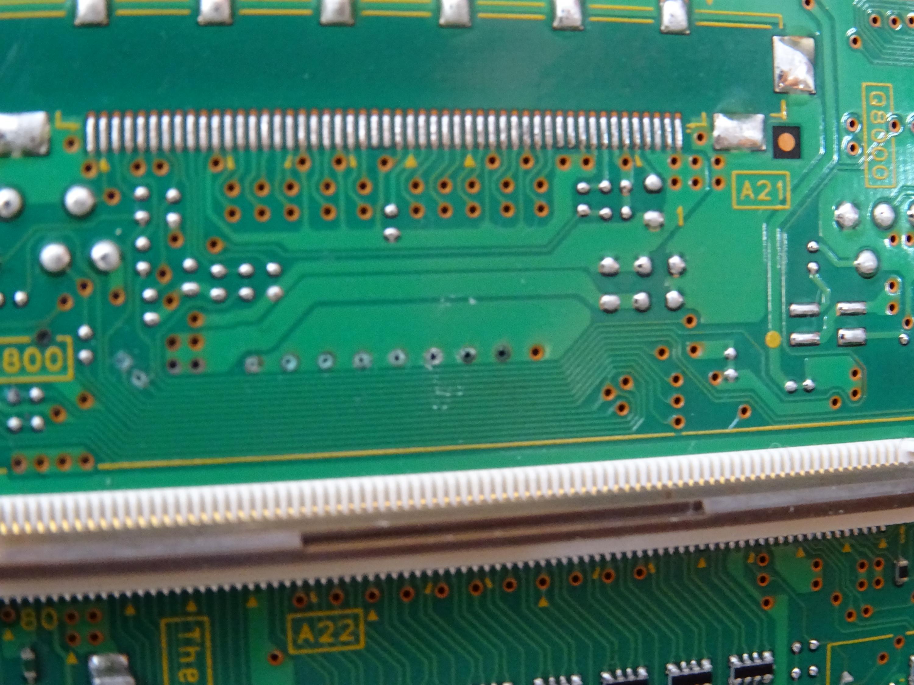

                    Re: Panasonic Viera TC-L32U22 no picture
                    Check if you have 12 volts on each side of the tcon fuse, may have to look closely, the fuse should be labeled starting with Fxxx.
                    • Redrum
                      • May 2015
                      • 19
                      #30
                      thanks for the tip. But, I am not finding a tcon fuse. The only fuse I see is on the line. I have attached a snapshot of the block diagram for the service manual which show tcon12v being sourced by DTV12.
                      See attachment, am I looking in the right spot? P board or A Board?

                        #31
                        Not exactly sure, I'm not too familiar with the integrated tcons.

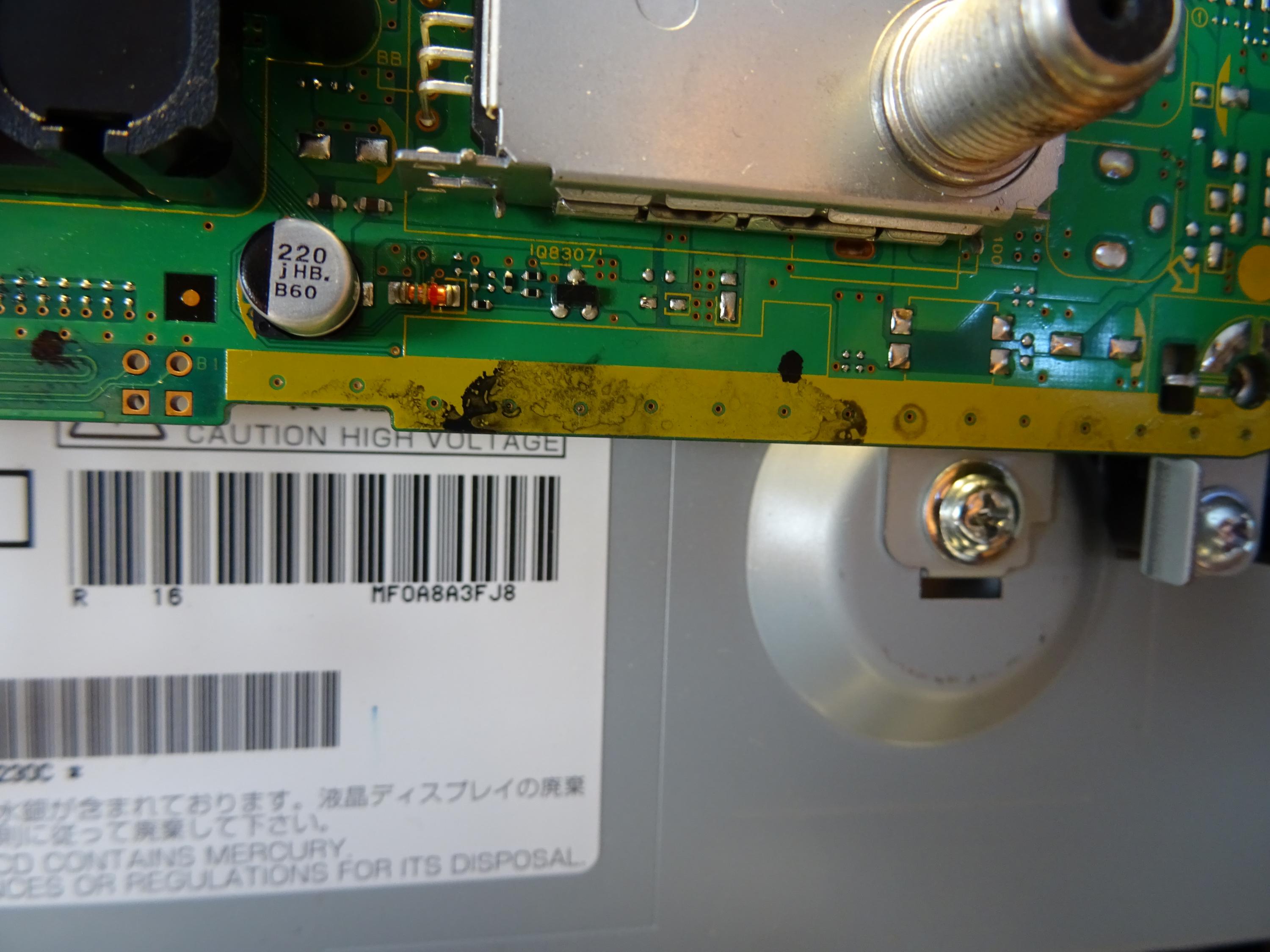

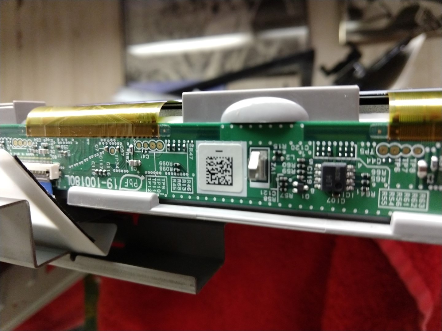

                          #32
                          You should show us the pictures of the T-CON board which means you have to remove the metal frames on the LCD panel to get to that integrated T-CON.
                          • Redrum
                            • May 2015
                            • 19
                            #33
                            thank you, please see the pictures. Is this what I am looking for? The second picture just shows the portion of the board where the ribbon from the A board connects.
                            I'll look the board over next, but if you have any guidance, that would be great
                            Jim
                              #34
                              Pictures are too blur to be able to identify anything on the board.
                              https://www.badcaps.net/forum/attach...5&d=1544124298
                              The fuse looks to be to the right of that LVDS connector.

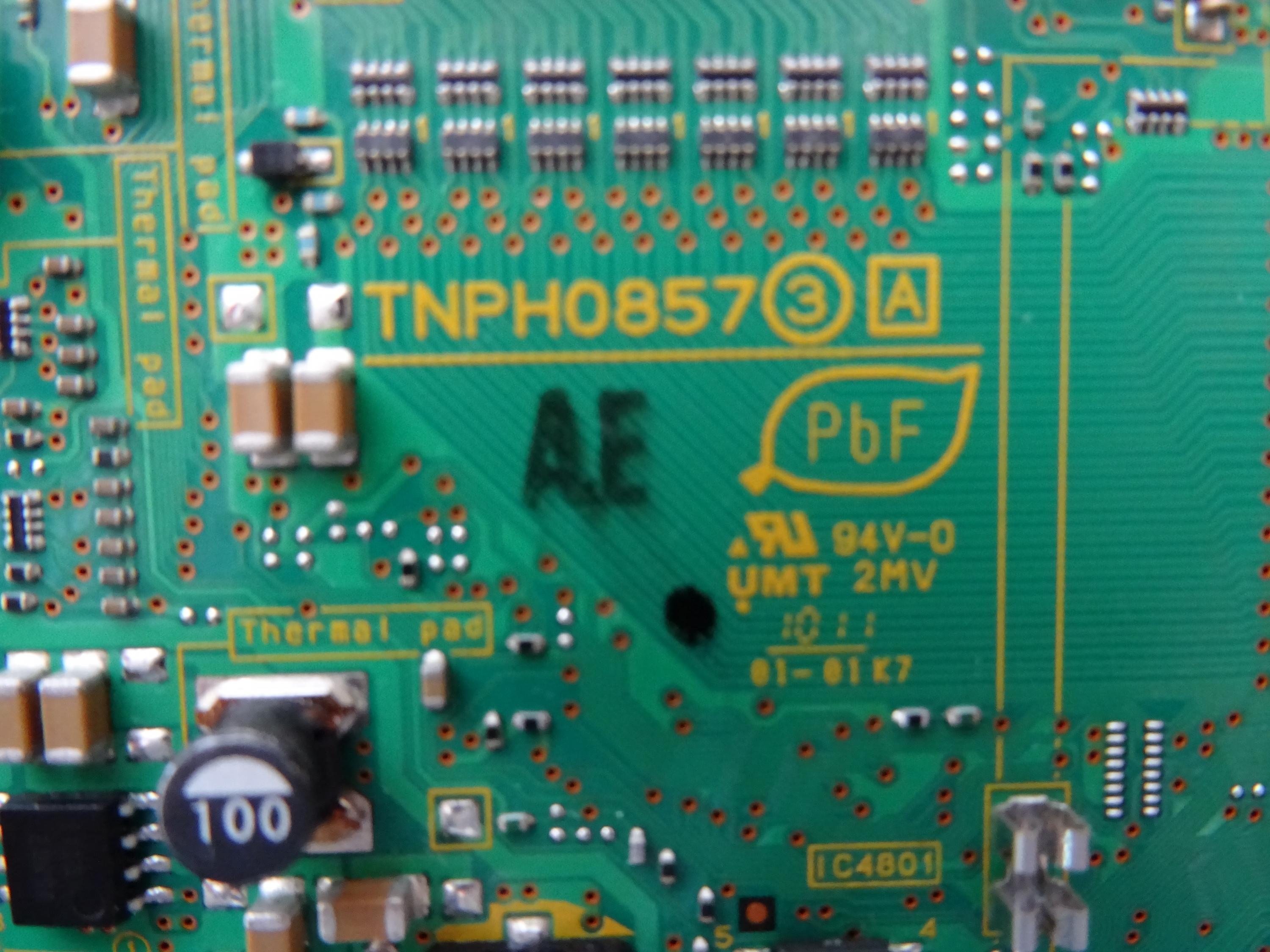

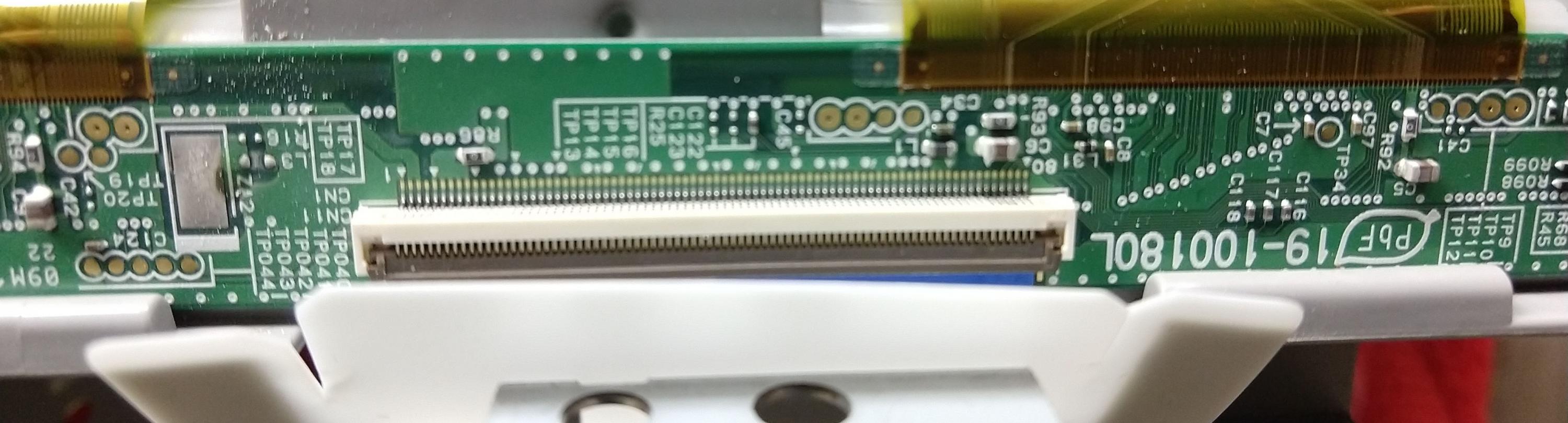

                                #35
                                ok, I originally took the pictures to say "is this where you mean?". I'll be happy to take all that are needed. Then, on trying to load them (as a jpeg) to the website it said invalid extention for png"????
                                Anyhow, here is another shot of the area. I see no fuses on the entire board, just smt components.
                                anyhow, as a reminder, solid LED on (not flashing), no picture, no sound, but I see backlight
                                Jim

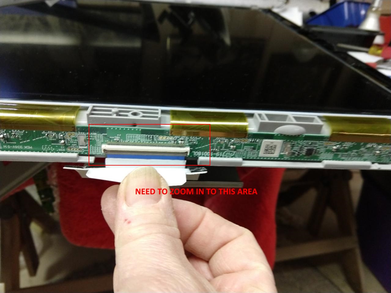

                                  #36
                                  Need to zoom in to the area as marked in the picture.

                                    #37
                                    thanks, this is the best I can do. I don't have a macro lens. Took this full res, then cropped in photoshop.
                                    what am I looking for?

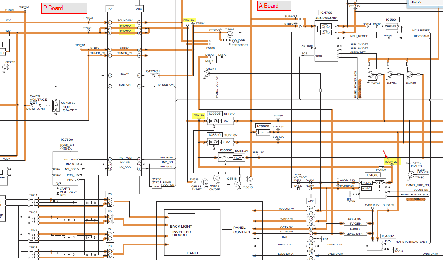

                                    In everything I have found, this TV has a P (ps) board, an A board, and two other little boards for the input/controls and the IR. The panel seems to be treated as an assembly. If you look at the manual in one of the first posts, the block diagram represents this. In searching for parts, only the A, P, and two little boards are represented.
                                    So, I am thinking if the issue is indicative of the display control, and we can't find a smoking gun, perhaps it's time to recycle....
                                    Jim

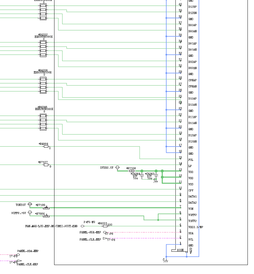

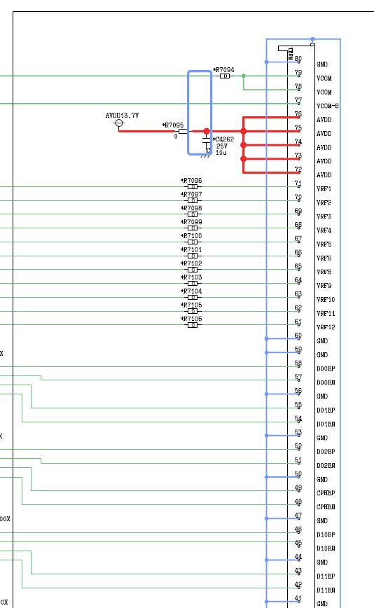

                                      #38
                                      https://www.badcaps.net/forum/attach...3&d=1544132121
                                      Check to see if you have 12V at pin 1, 2, or 5 of that LVDS connector with ref to chassis GND when TV is turned on.
                                      BTW, what is the LCD panel number as printed on the sticker?

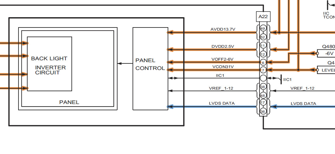

                                        #39
                                        good morning,
                                        I really don't have any way of probing that fine of a pitch on the connector. There must be a test point somewhere.
                                        I have attached a picture of the label on the panel.
                                        Also, I have attached a screenshot of the block diagram to the panel (from the service manual), and two screen shots of the schematic for that 80 pin connector. perhaps if you could point me to what I am looking for, I can trace back to find a tp on the a board.
                                        I ask because I see alot of reference to 13.7v, but none specifically to 12v other than the one area in the previous post. If I am going to test and determine go/no go, I want to make sure I am testing what you are suggesting I test
                                        Thanks;
                                        Jim
                                          #40
                                          LCD panel connector VCOM Pin 2 and 3 are tied together so you can probe on the copper trace, AVDD13.7V pin 5 ~9 are also tied together and connected to r86 so your meter probe should be able to test those pins.
                                          It looks to be that this panel has many Voltage sources to feed that panel.
                                          You can always trace out the connection from the pin that goes to other places so that you can probe the Voltages.
