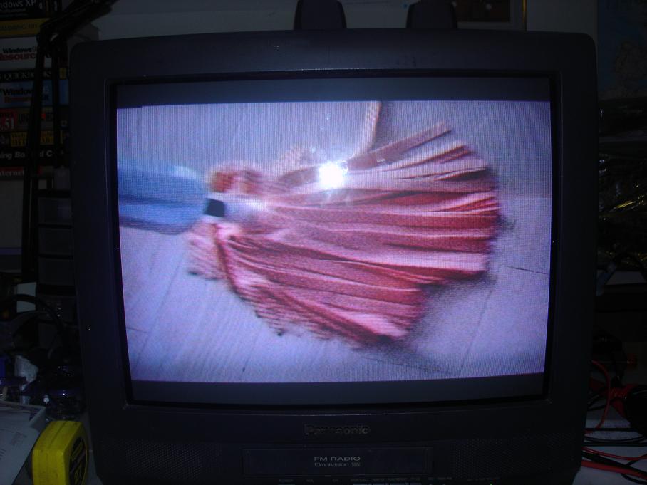

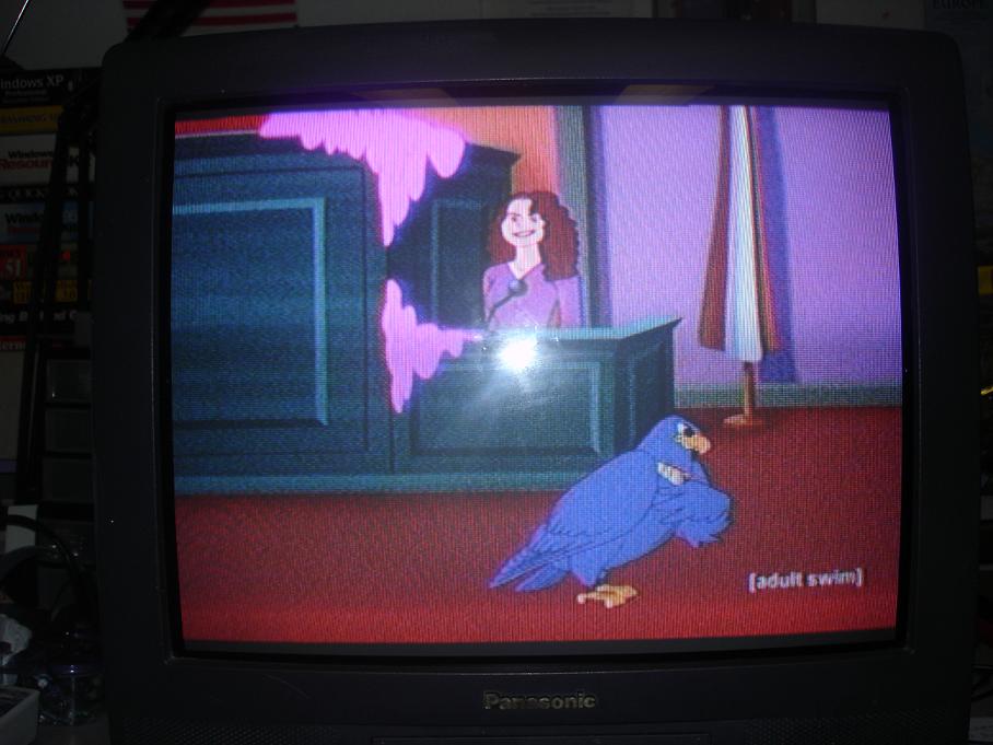

  • Krankshaft
    • Jan 2007
    • 2328
    Re: Panasonic PVC-2021 Vertical Deflection
    Oh I almost forgot here are some pics of the vertical deflection when the set is cold and after it has warmed up.
    Once when I ran it for an extended period it completely cleared up with no visible banding however when the set cools down again the process repeats itself.

            Frustrated I decided to do what i4004 did I took a piece of cardboard and enclosed the U shape of the vertical IC heatsink to concentrate the hot air.
            The 4 caps in the U shape of the vertical heatsink and in the path of this hot air were replaced with new ones so that I could be sure that they weren't reacting to this test.
            Then I heated up the vertical IC with a blow dryer with the set running and slowly but surely the vertical height increased until I got it to deflect 1/8" from the end of the top of the screen.
            It probably would have gone further to the top of the screen if I kept at it but I didn't want to roast the new caps or activate the thermal shutdown on the IC.

                              • 370forlife
                                Large Marge
                                • Aug 2008
                                • 3113
                                He he, Harvey birdman.
