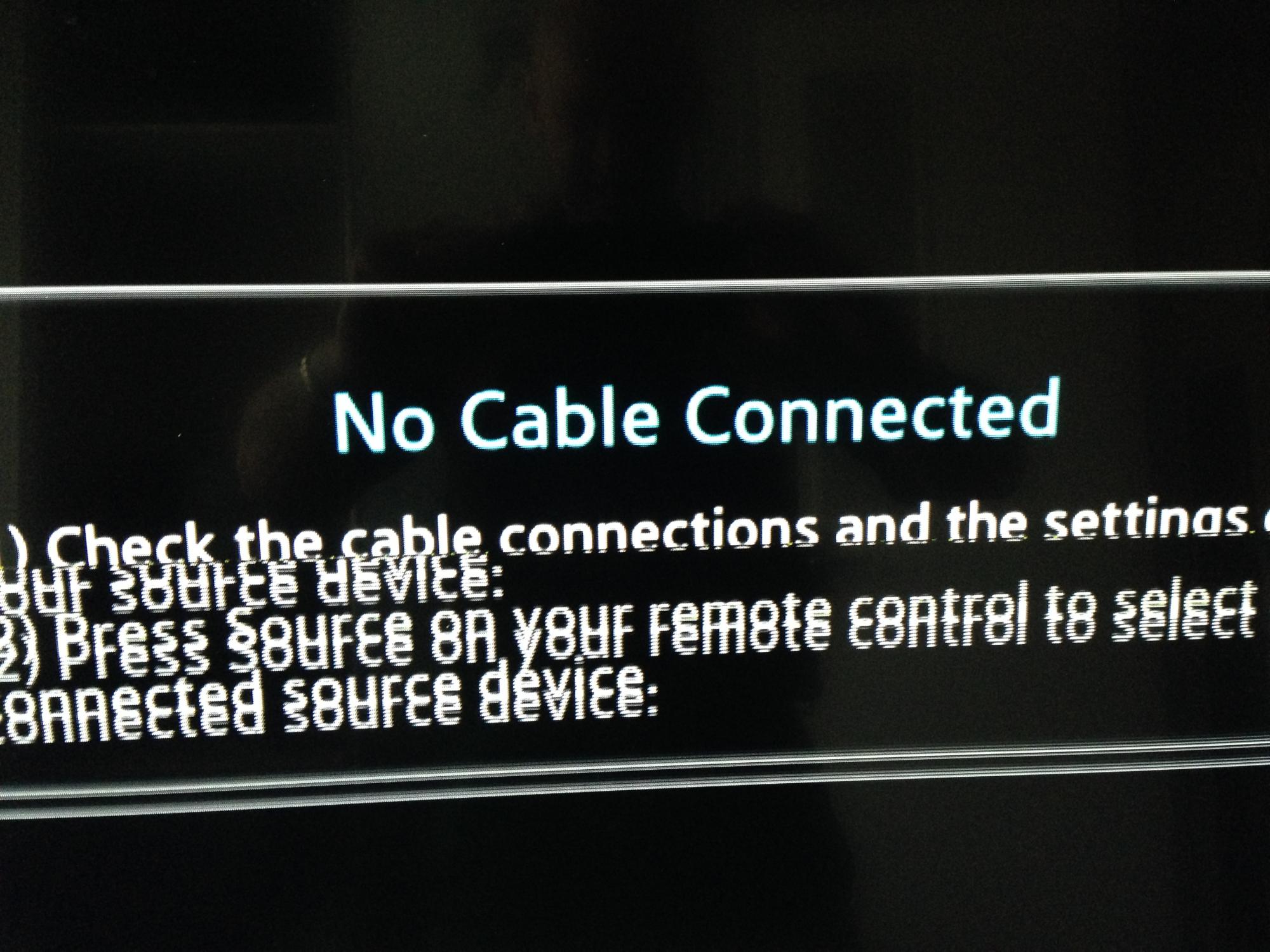

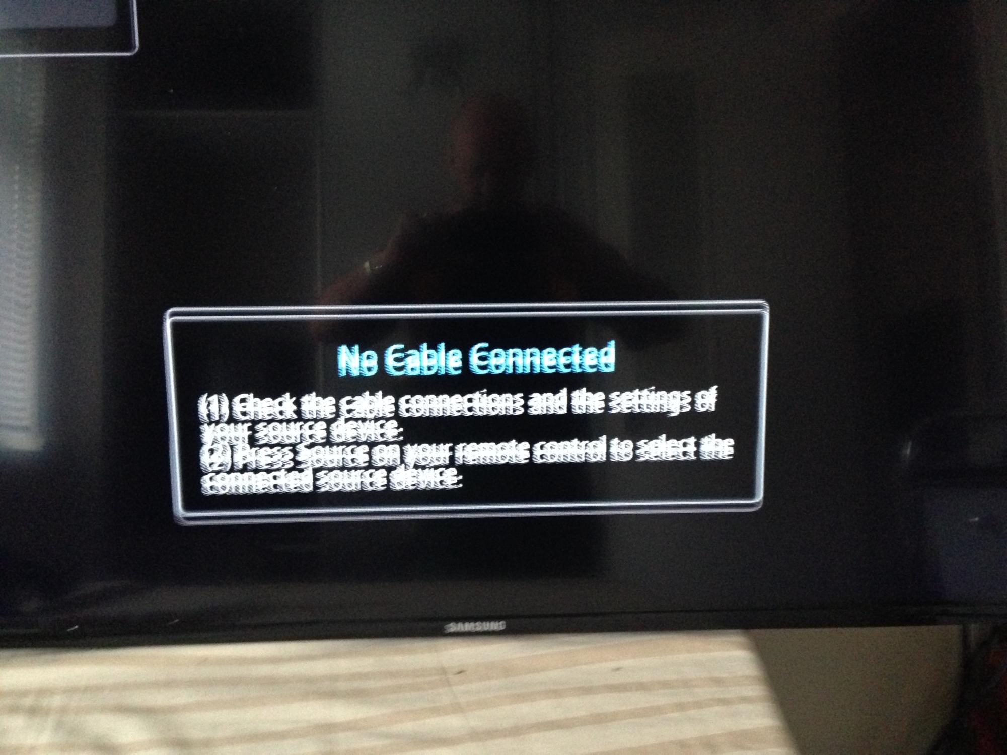

    Hi guys, got this in with a double image problem, but its only on the bottom half of the screen, the top of the screen has a perfect picture,
    checked and cleaned/ reseated t-con cables, but still same prob.

    however you cleaned and rset them, the problem still at ribbon cable or the socket of them. can notice in first picture there are line much go its cause of T_CON

      Does it change if you flex the panel?
        Re: SAMSUNG UE50EH6300, double image
        Gonna place my bets on a bad panel issue that may be repairable.

            I've heard of hacks to fix some of these double image issues, but believe it doesn't work on the EH series...only the D series. EH uses different panels. Virtually all of the time, an issue like this is down to the panel in some way. It's almost never anything else.

                I am afraid that its not a t-con issue 99% bad panel
                  Panel problem.

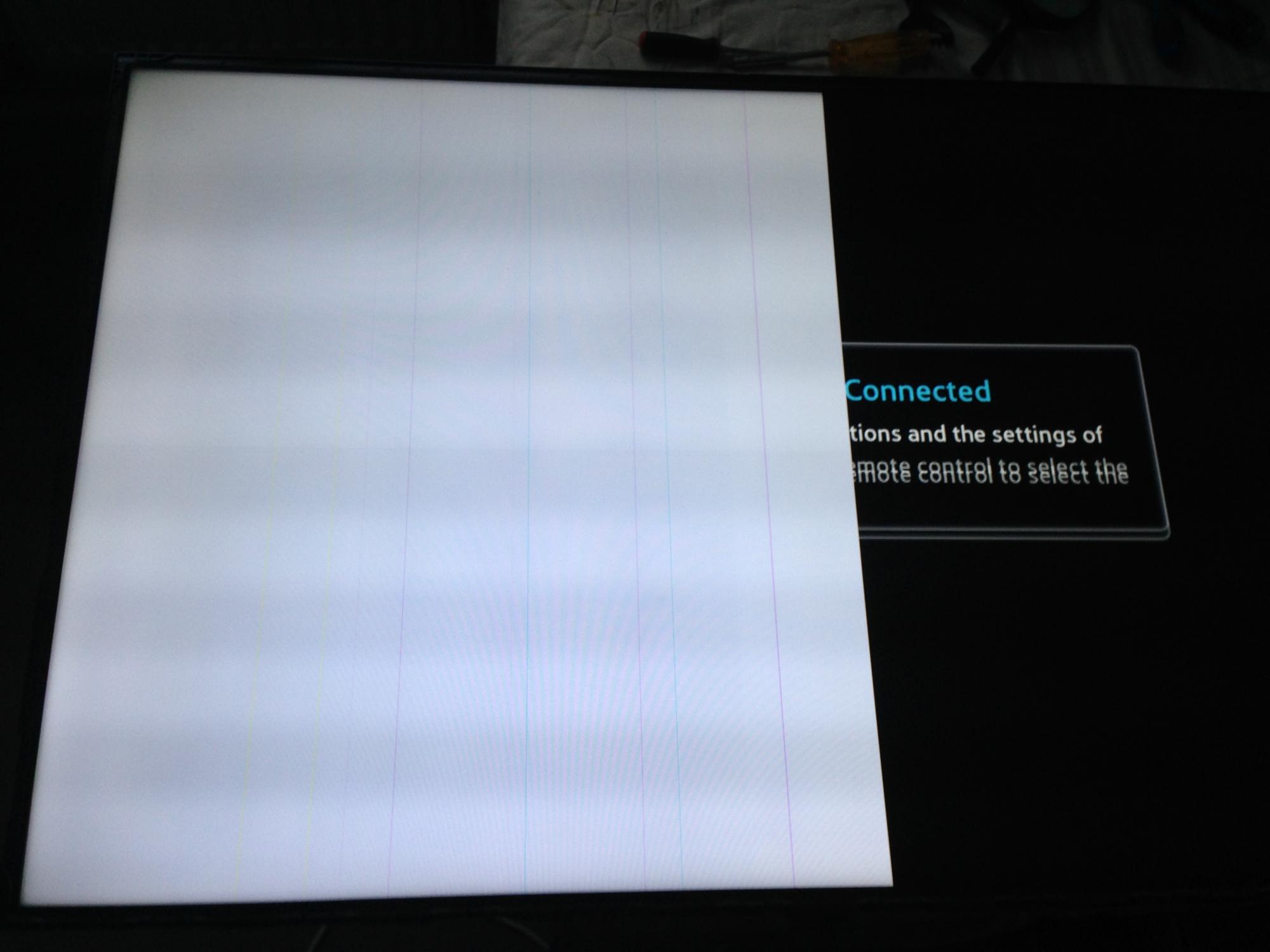

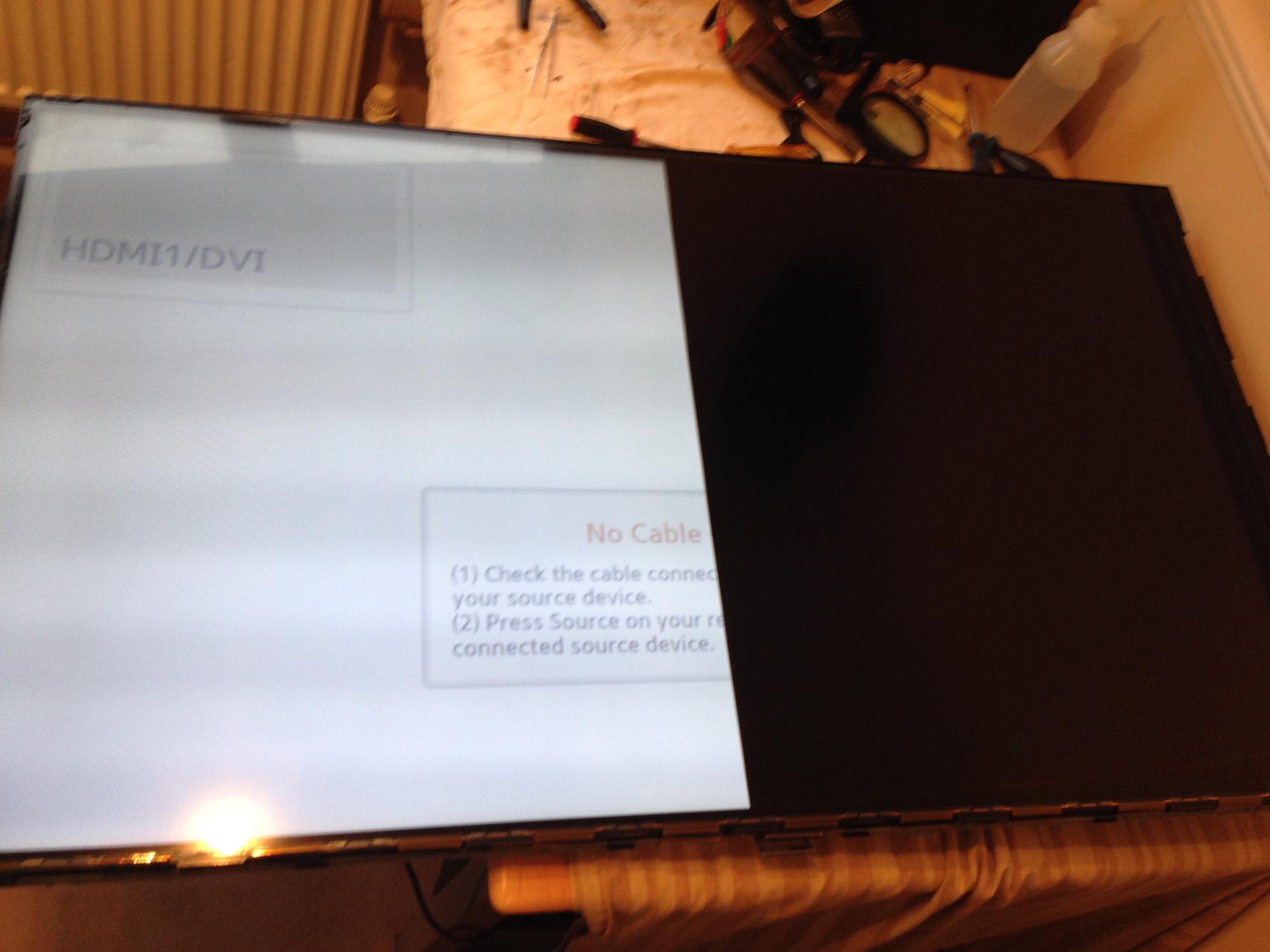

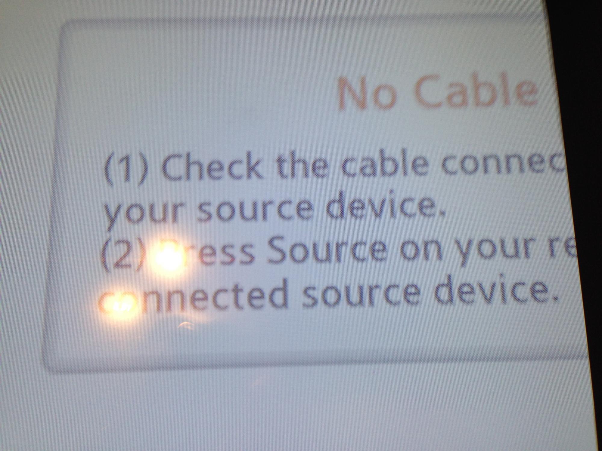

                        so today i had a play, and im going to says bad screen, checked all the tabs with no effect, and then removed t-con to screen cables one at a time, and these are the results.as you can see, got a negative image but not double, changed sides and then got white screen with lines.

                            Panel problem end of.

                                OH YES
                                but im not an happy bunny
