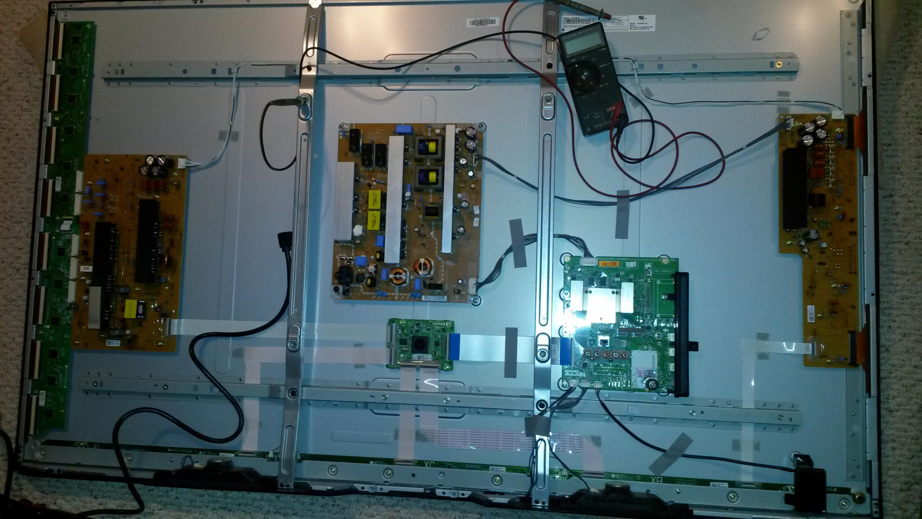

        I went through the voltages on the P813 connector when it is in run mode as soon as it's plugged in and (what I think is) standby mode after doing a power button hold / reset. Without the right manual, I'm trying to cross reference using manuals for a 50PJ350, 50PG20, and 60PS60, which are kinda sorta close, but all are different with some keeping 5V in STBY and some not, and labels being different for functions that I'd suspect are the same. In any event, this one is keeping 5.2V in RUN and STBY, keeping AC_ON at 5.07V in RUN and STBY, and everything else drops out on STBY. Other voltages in RUN seem plausible comparing the other manuals, but they don't all agree exactly on the values.

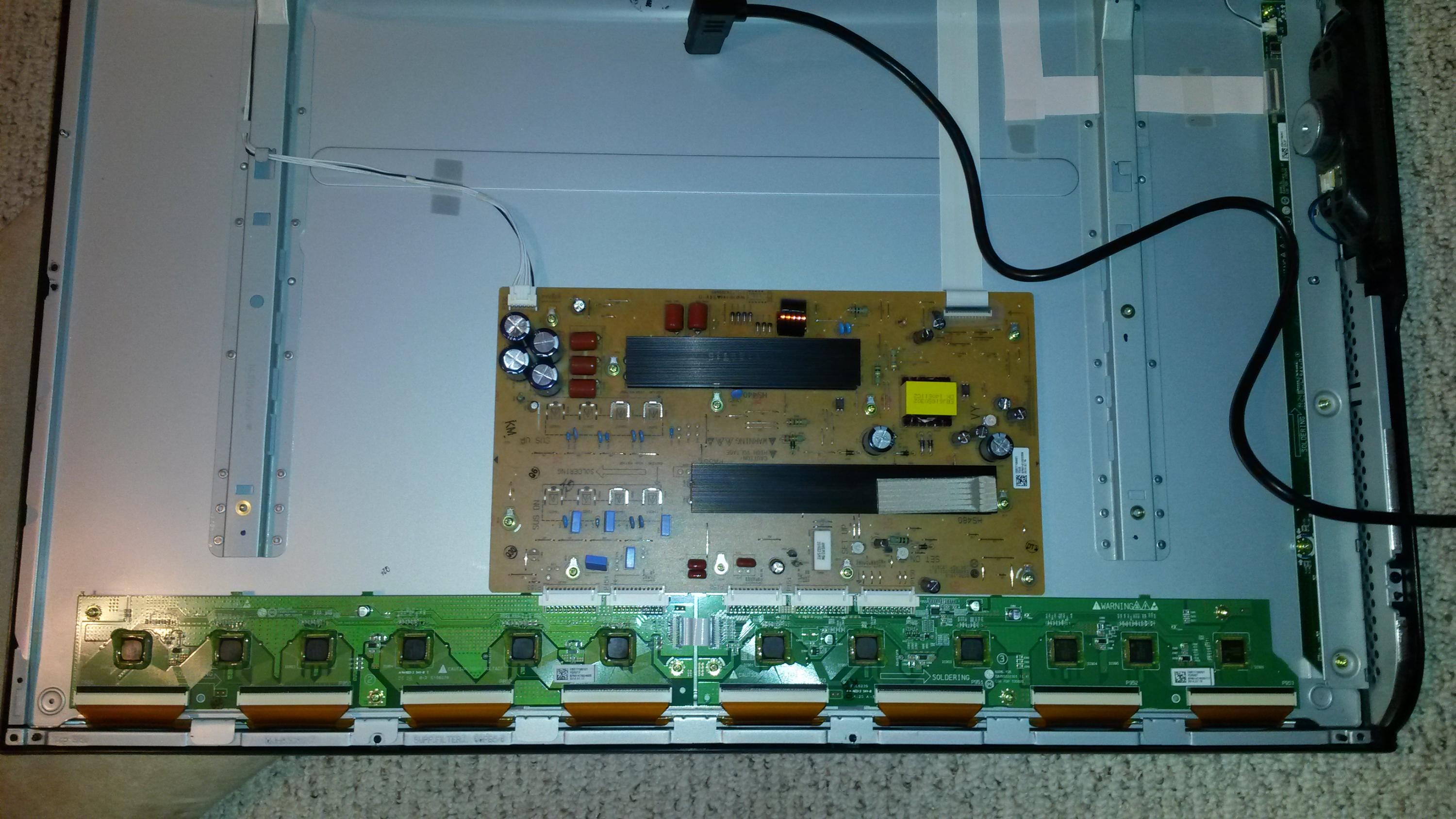

            Attached is a picture of the Y area boards so that I'm clear as to what we're talking about, because I'm still a little unsure.
            The upper and lower buffer boards are attached to the Y-SUS by rigid header pin connectors. To disconnect the buffers from the Y-SUS, the Y-SUS board will have to be un-screwed and then pulled apart from the buffer boards.
            Also, I tried to disconnect the orange PDP ribbons from the buffer boards, but can't figure out how they come out. There is a black flip up lever on the opposite side of the white housing from where the ribbon goes in. The white housing seems fixed to the board. The ribbon is locked in there somehow, and you can't get a good grip on it. Is there a special tool or trick to pulling the ribbon out?

            I just found a blown surface mount cap, C873 on the upper Y buffer board. It goes between the ground screw pad and the big pad next to the ribbon connector that connects the upper and lower boards. So, now, why did it blow? Fault of the Y-SUS board? Do I just replace all 3 Y boards at once?

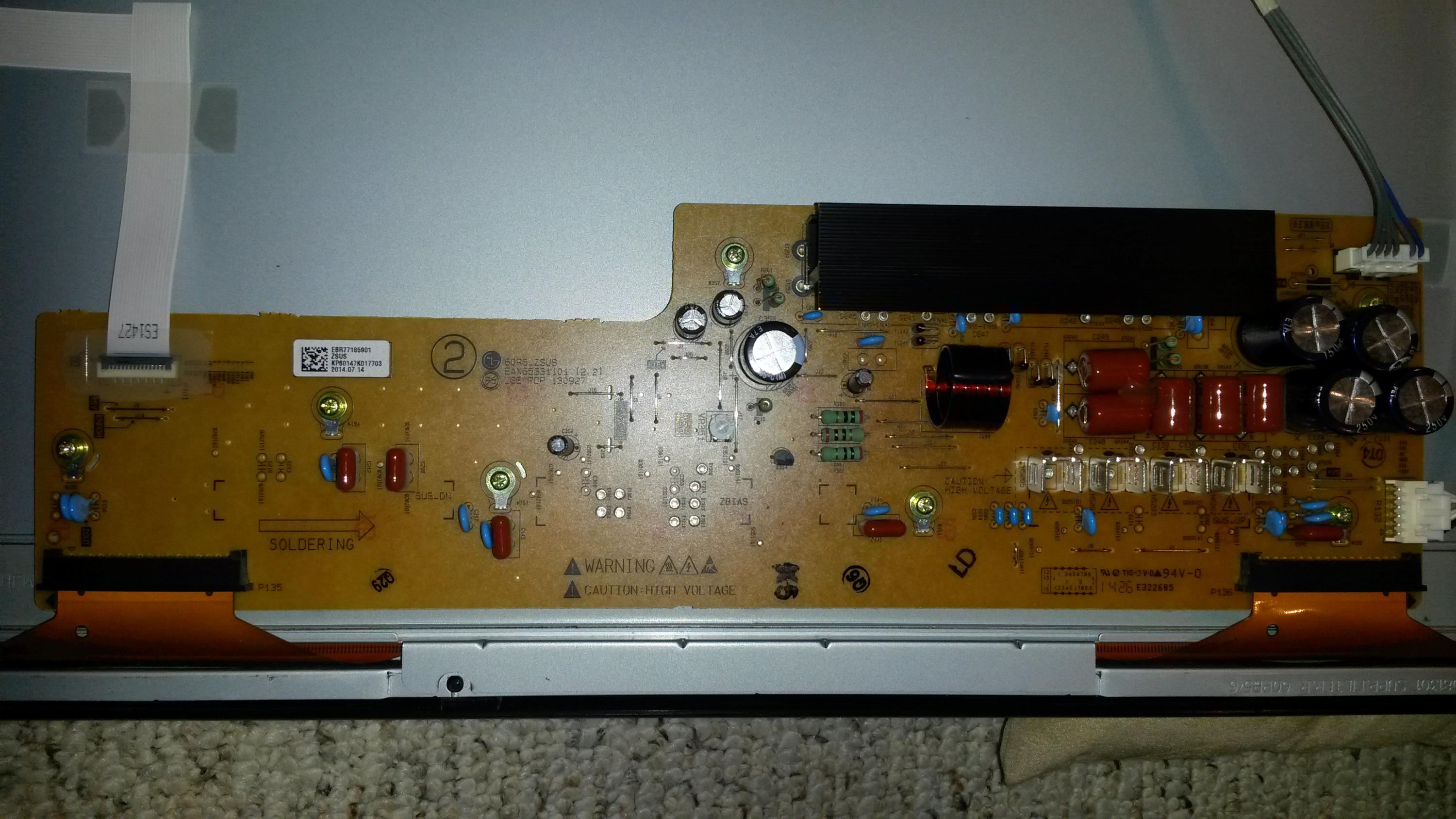

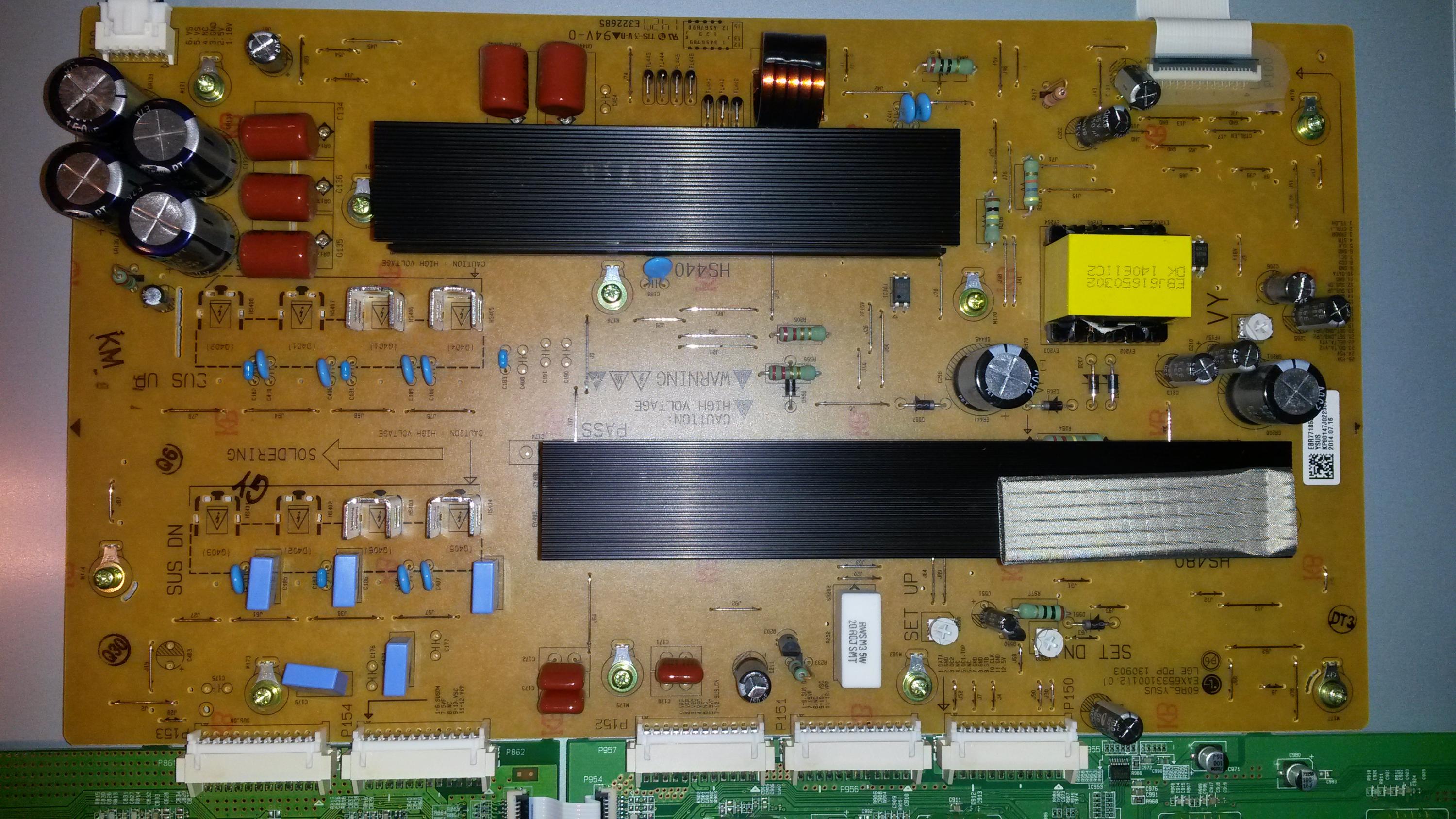

              So anyway, I've replaced the Y-SUS board and the upper Y buffer board. There's a picture now!
              The screen has 2 thin horizontal lines running across it about 3 inches down from the top. What could cause that?

                      Also, as a summary update, this was the repair sequence so far:
                      The power supply board would go straight to "on" mode when AC cord plugged in, and replacing the main board (with the AV jacks on it) fixed that situation.
                      Now, the power functions seemed correct, but still no picture. Replaced the Y-SUS and upper buffer board, and now the TV functions, but there are 2 thin horizontal lines across the top of the screen.
                      I've ordered another upper buffer, but I kind of suspect the ribbon cable connection might not be made correctly. Those ribbons from the PDP into the upper buffer are hard to insert in the connectors and getting them perfectly seated is completely shady.
