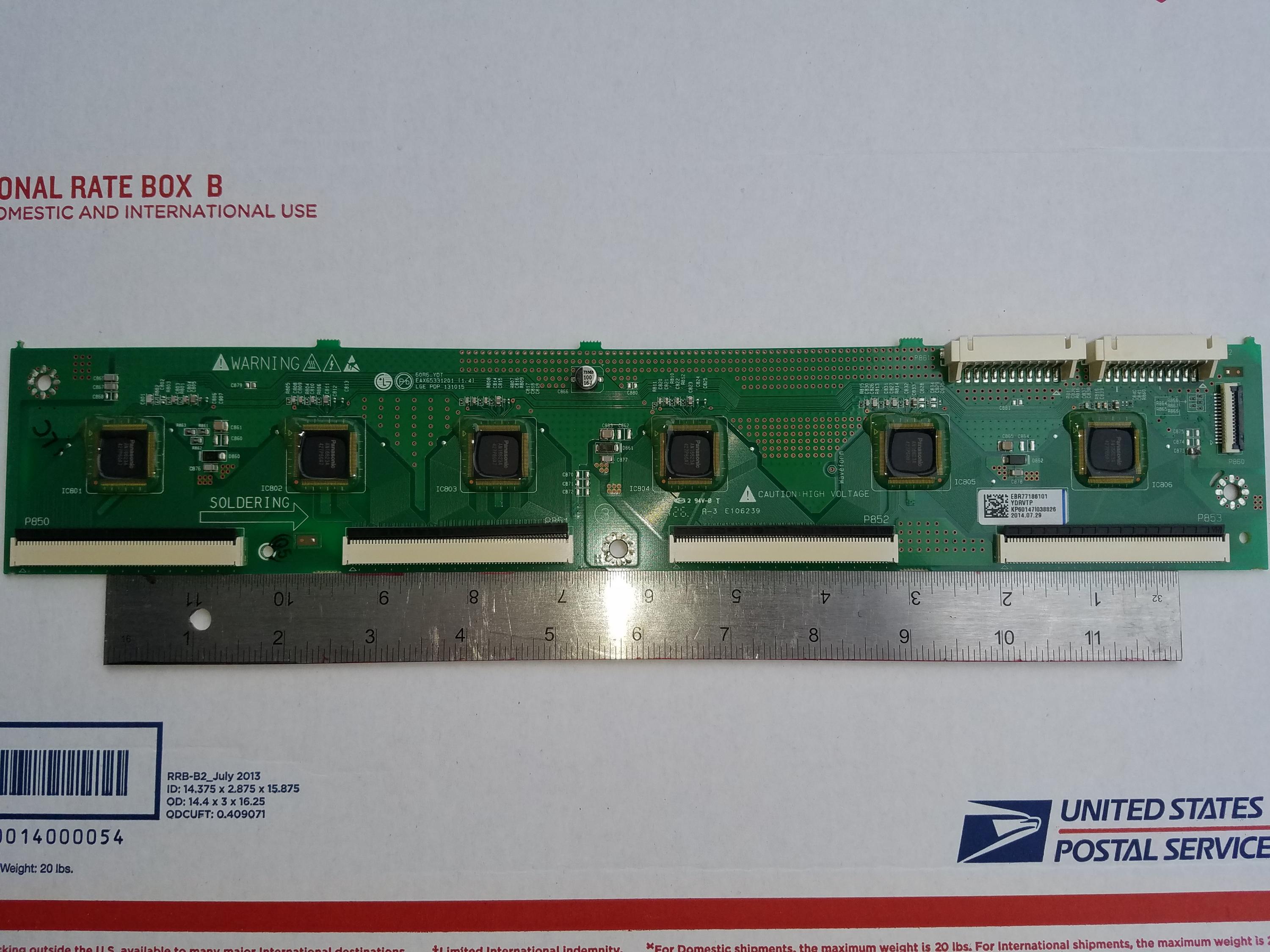

LG 60PB6650 plasma flashes gray, then nothing
  • Jsikora
    • Apr 2016
    • 64
    Re: LG 60PB6650 plasma flashes gray, then nothing
    Pics

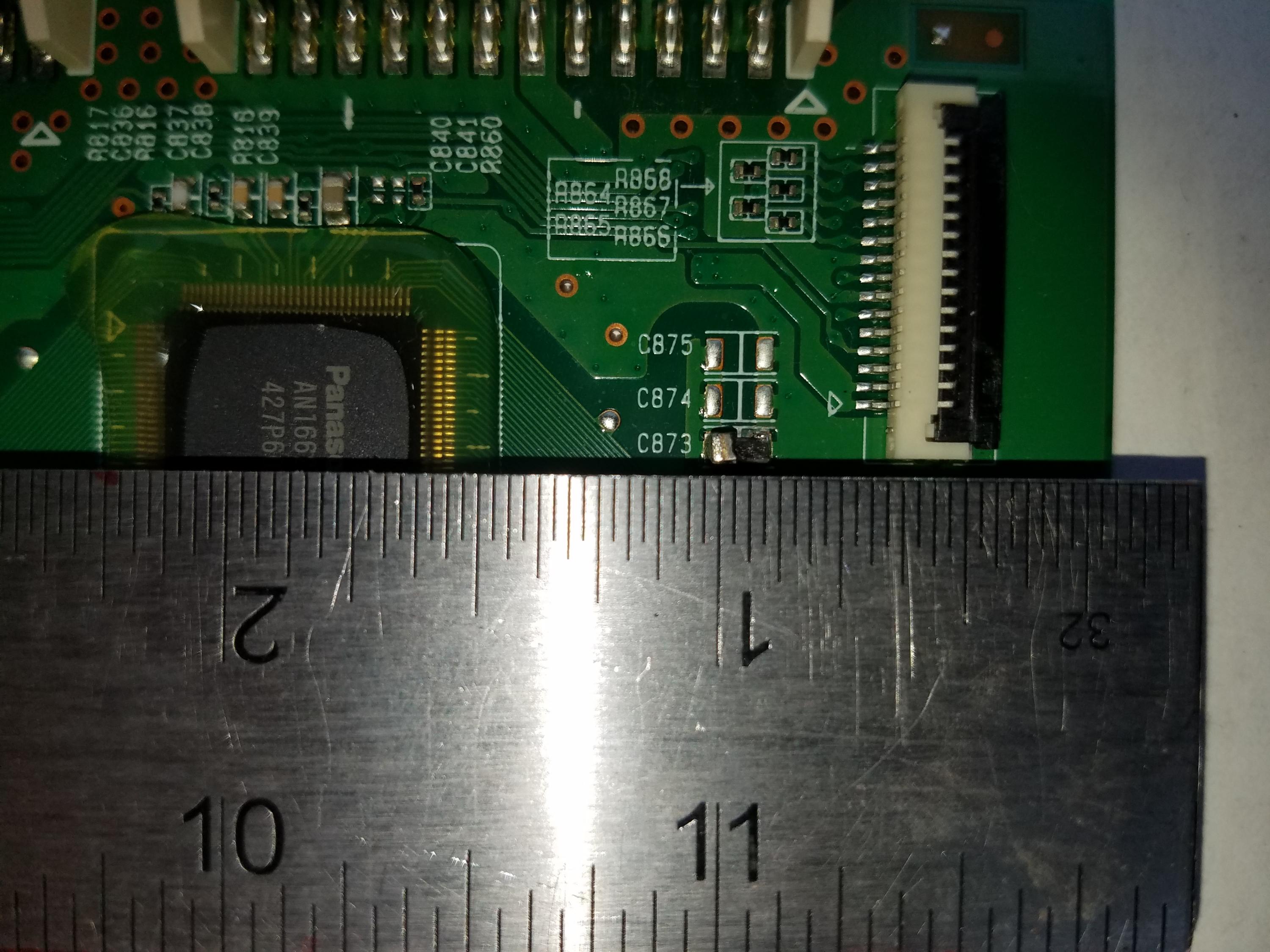

      Looks like a 1206 size capacitor (3.2mm x 1.6mm, or 0.12" x 0.06")
      Max rating for that part of the circuit will be around 500V. So any 500V or above 1206 capacitor with C0G, X5R or X7R dielectric should be okay...others may also be okay.
      • stjeff0
        • Jul 2015
        • 11
        Finally got the YSUS and found working driver boards. I'm trying to get Nick @ NicksTV to start repairing these 3 boards. Tried that Oleg guy on the Bayster and he kept my parts!!! Still can't believe that. We got our money back, but I had to scour the net to find 2 more. Won't make that mistake again. TV is working perfect. This is our 3 one this year that needed all 3 boards.
