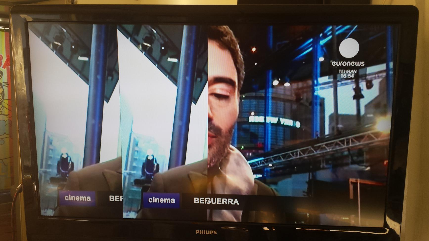

    hi frends i have a philips 42PFL3604D/12 i changed the t-con and still the same problem . can anyone help

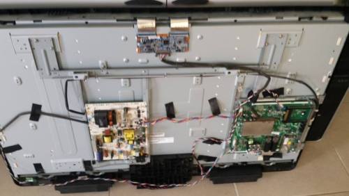

    Can we see the whole back side of the TV so we can see all the boards?

      Re: problem with 42PFL3604D/12
      is this o.k
        OK, I was looking to see if this this TV has FRC (Frame Rate Converter) board or not which may o may not have caused what you are seeing on the screen, it does not have FRC.
        Did you try heating and cooling the main board yet.
          Originally posted by olymbou
          is this o.k
          Philips lack with bad PSU Voltage, replace all caps in 12 volts and 20 volts if the sound need 20.v
          also i i had this fault i found customer play with service menu, go there and find dealer and try verging on
            Did'nt do nothing by heating and cooling the main board .i will try caps 12 and 20 volt . ant other solution.
