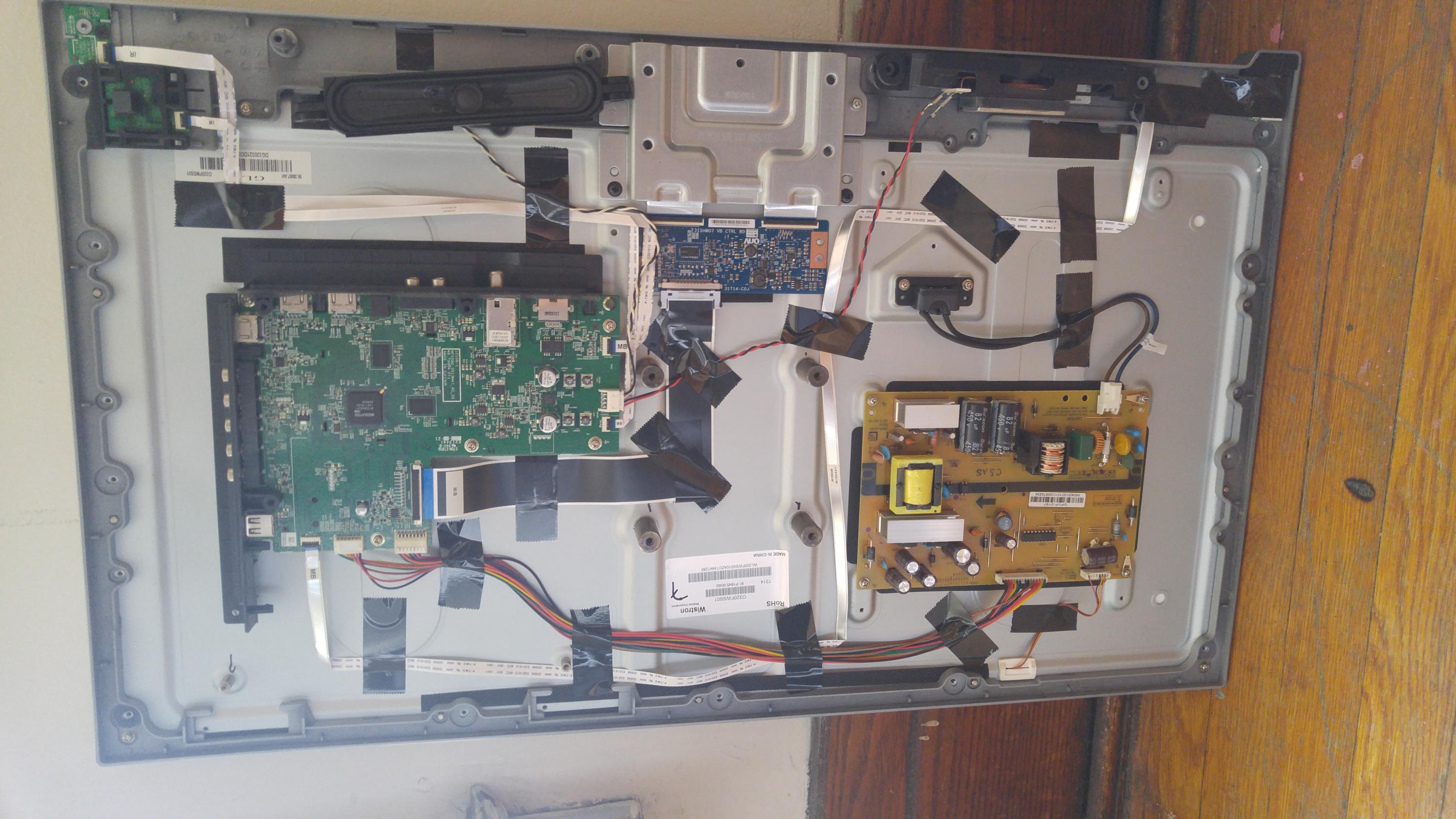

    Vizio 39 Tesla M321i-A2 Not Powering On
    When I plug it in I get a white standby light then after a few secs it goes out. Pressing the power button does nothing. Tested the power supply was getting 5v and the 12v was coming back 12.32v

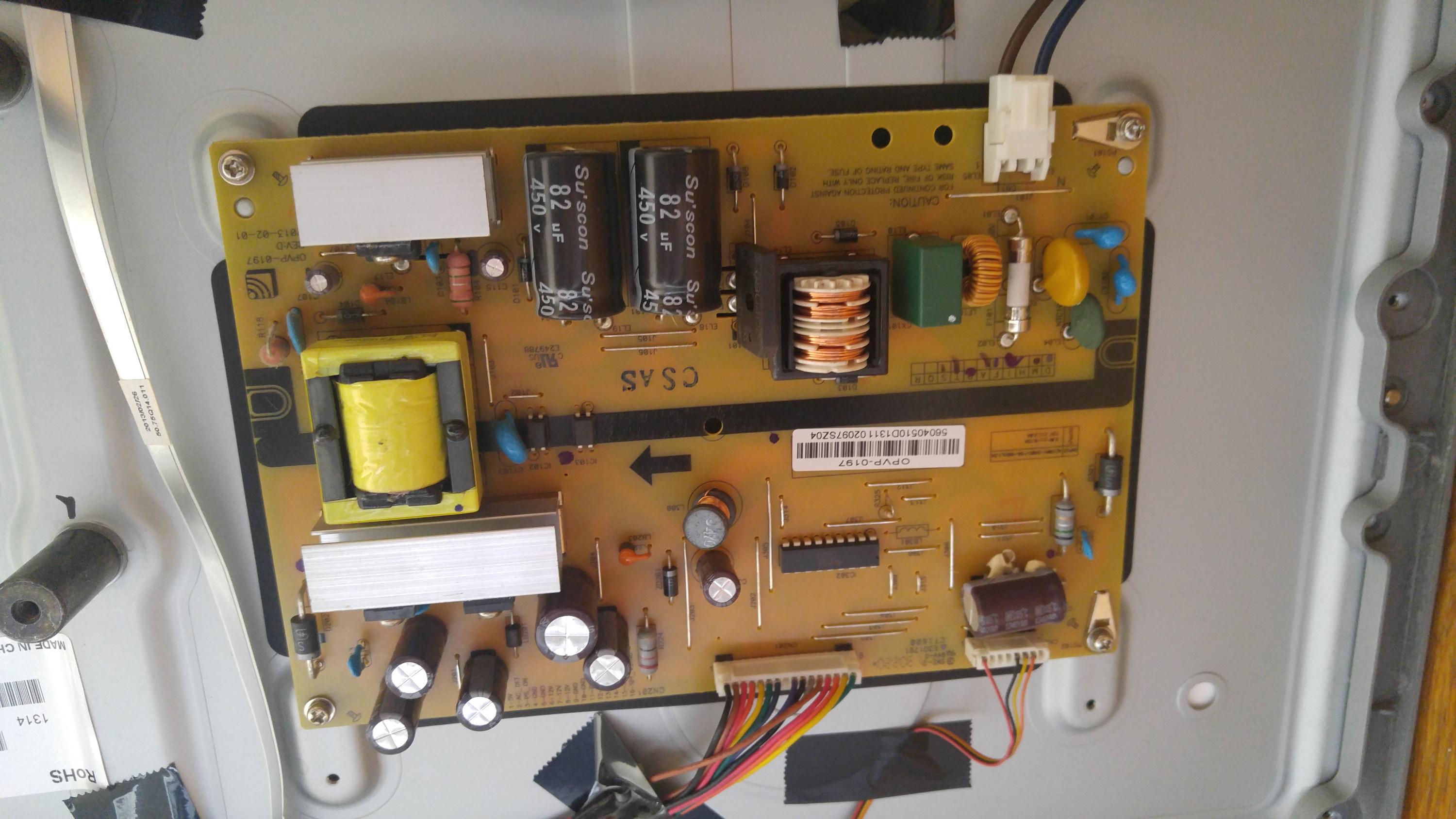

          If the 5Vstby is coming on but then dropping to 0V I would check C105 & C107
          Are there components on the underside of the power supply and if so can you post a sharp picture?

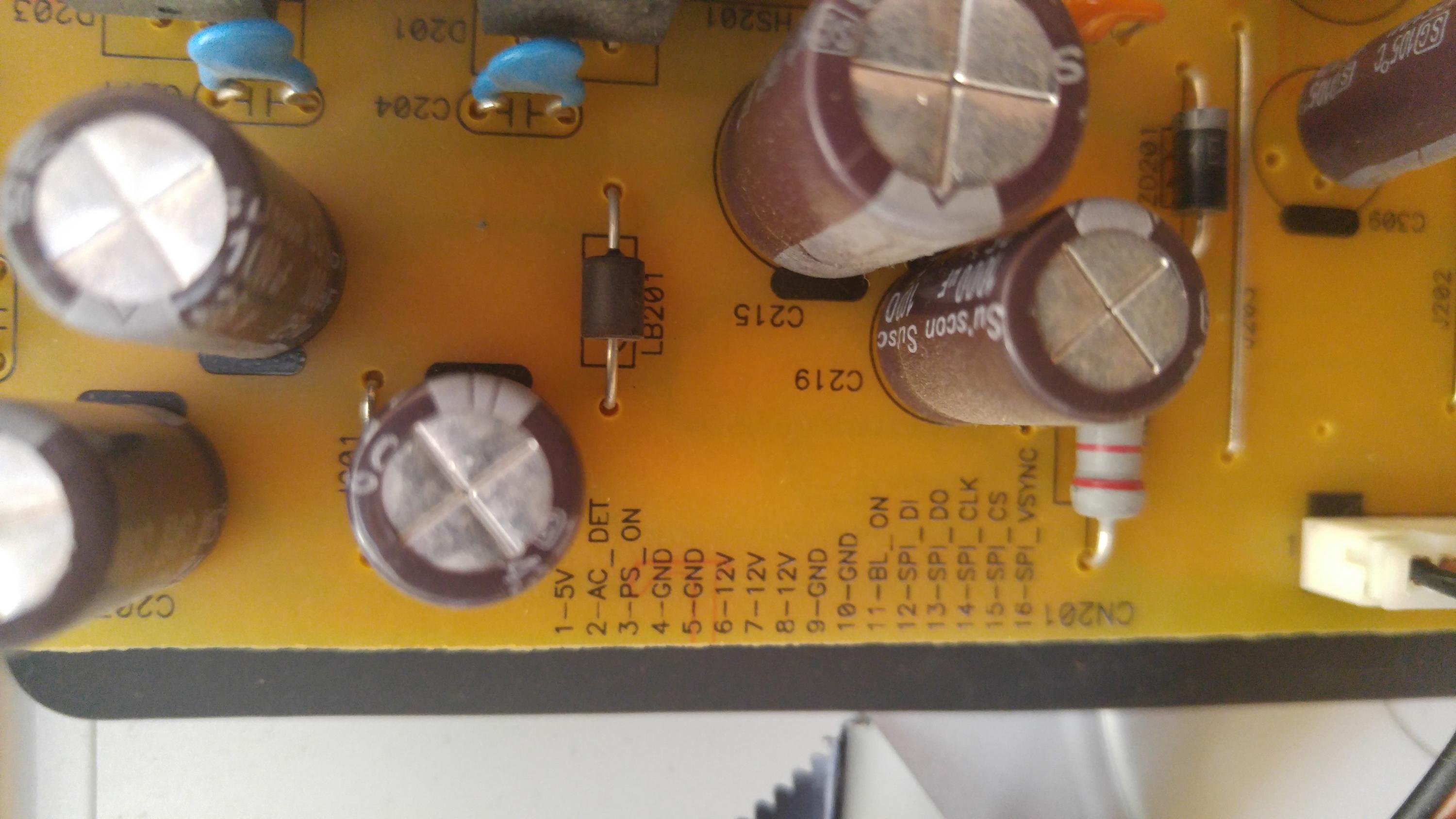

            Re: Vizio 39 Tesla M321i-A2 Not Powering On
            plug the tv in, do NOT turn it on and measure all 16 pins on the PSU (last picture of your post #1). Turn the TV on, let it fault and redo the measurements. Post the pin out name with the corresponding voltages you measured.
              Before pressing power button
              1- 4.95
              2- 3.27
              3- .11
              4- 0
              5- 0
              6- .01
              7- .01
              8- 0
              9- 0
              10- 0
              11- 0
              12- 0
              13- 0
              14- 0
              15- 0
              16- 0
              After led goes off
              1- 4.94
              2- 3.27
              3- 3.06
              4- 0
              5- 0
              6- 12.31
              7- 12.31
              8- 0
              9- 0
              10- 0
              11- 3.25
              12- .09
              13- .08
              14- .10
              15- 3.05
              16- .09
                Pin 8 should also be 12V. Can you recheck it.
                • Gadjet
                  • Aug 2012
                  • 248
                  your correct 8- is 12.31 it doesn't have a wire going to that pin so i misread it

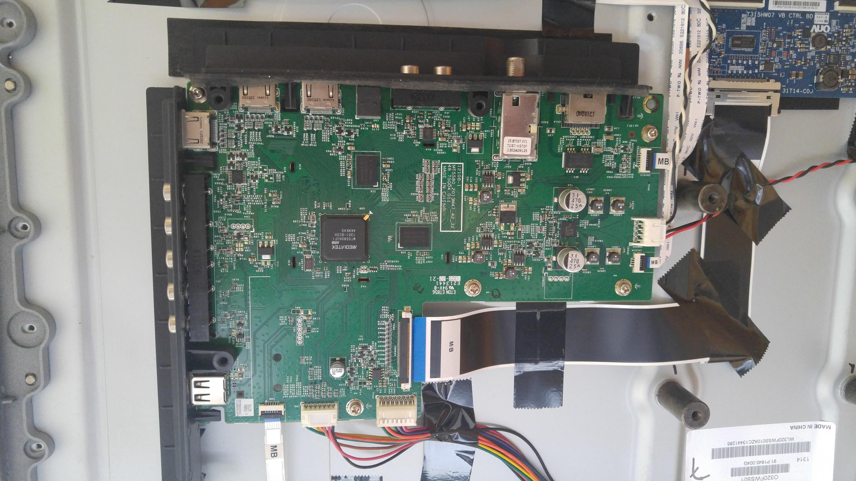

                    must be something with the main board. The PSU is fine.
