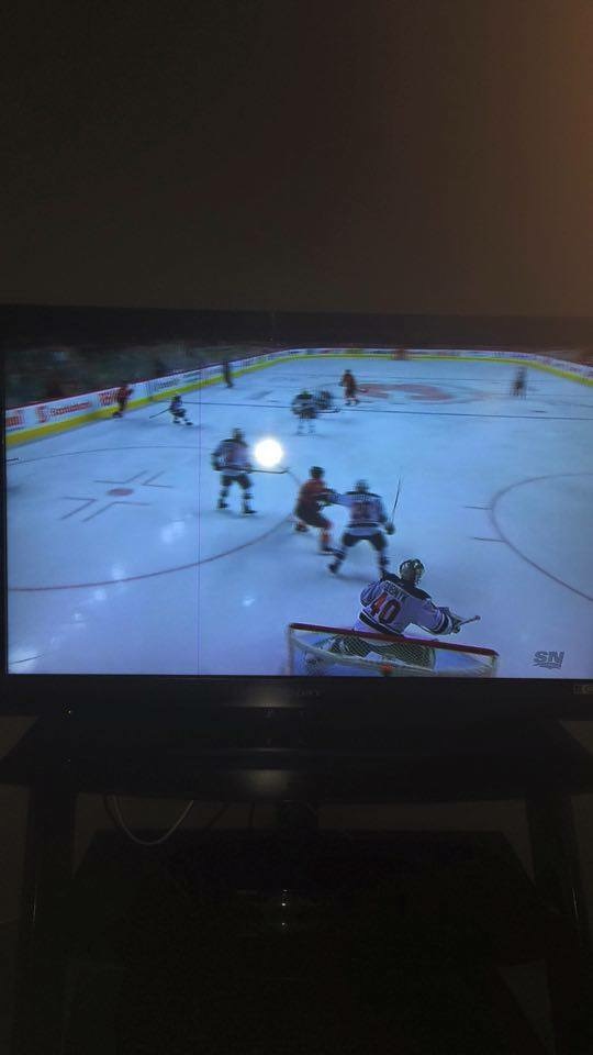

    Sony Bravia LCD with 1 thin vertical line
    Would this be a panel or tab bonding issue? I don't have the tv with me this was a text sent by a customer.
  • ReeceyBurger123
    Never Give Up !
    • May 2014
    • 7325
    • Britain
    Re: Sony Bravia LCD with 1 thin vertical line
    Failed COF Ic that drives Lcd panel not fixable.
    • tech2014
      • Aug 2014
      • 807
      thanks
      • getmoresoon
        • Sep 2016
        • 6
        Digging up an old thread
        Hey.. I have a similar Vertical line (opposite side of screen) on a Bravia kdl-40v4100 that I just replaced a bad AS15-F Gamma chip on. However the line goes away after the TV has been on a short while. Do you think this would still indicate a failed (failing) COF IC?
        Thanks!
        Getmoresoon
