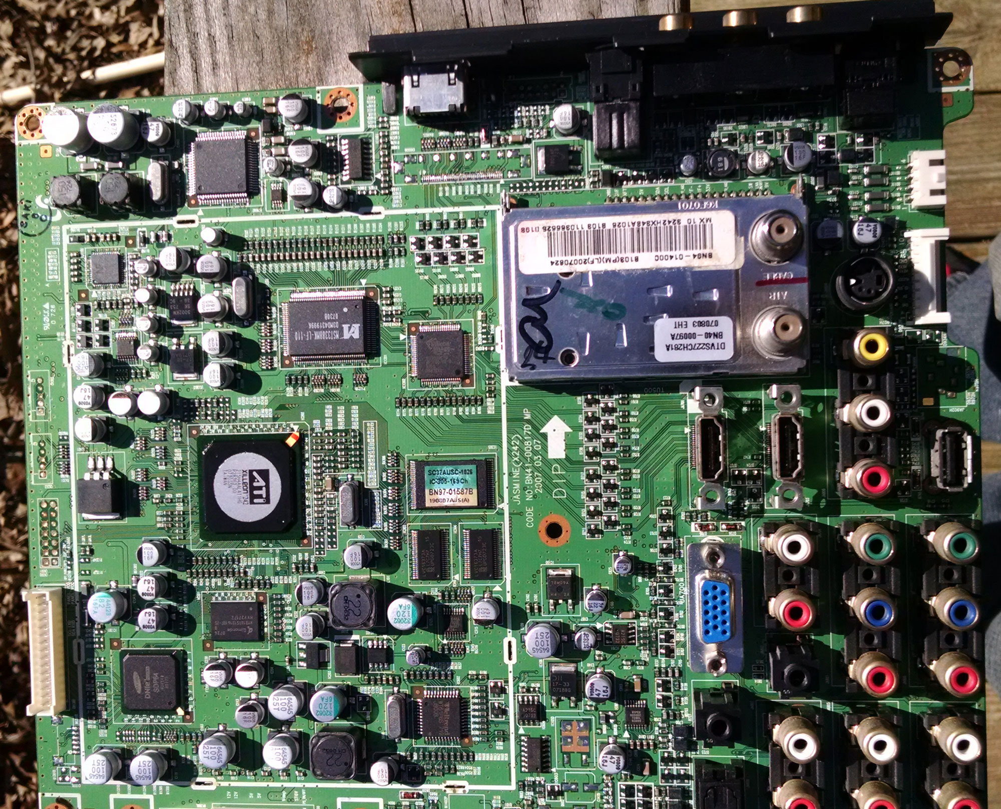

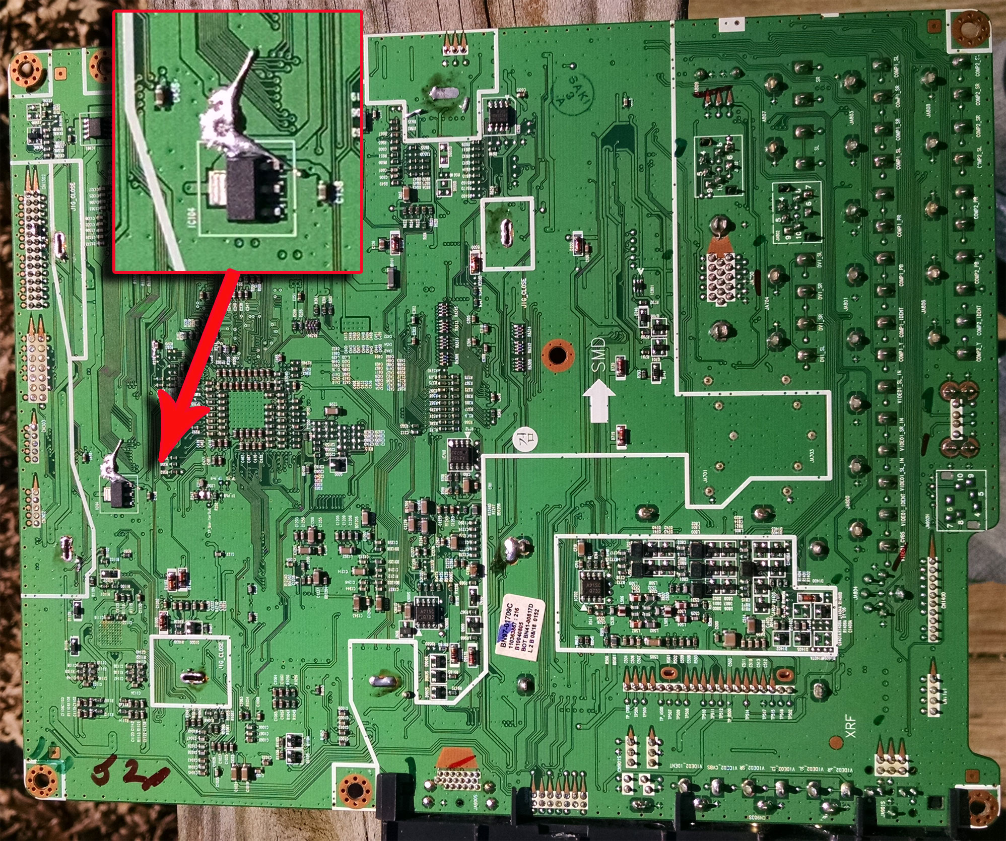

    Picked this TV up at the landfill. It had one bulging cap so I recapped the whole psu. I get PS_ON but still no BL_ON.
    Upon CLOSE inspection I noticed what looks like a horrible repair gone wrong on the main board! Not really sure, but can you guys check it out?
    Check out the pic of the Main board backside. Then look at the SJ stock image.
    What the???
    • 31291
    Re: Possible sabotage?! Samsung 32" LNT3242HX/XAA LNT3242H
    it's a splash, the board may have been on the floor of a workshop.
    where is the shield?
    lots of splash around where that was desoldered too.

      Hmm.. I took off the shield today...
      I guess I did it and didn't even notice. argh! Haven't powered it up thankfully. I guess this one is toast anyhow, unless you guys have any ideas on this main board.
