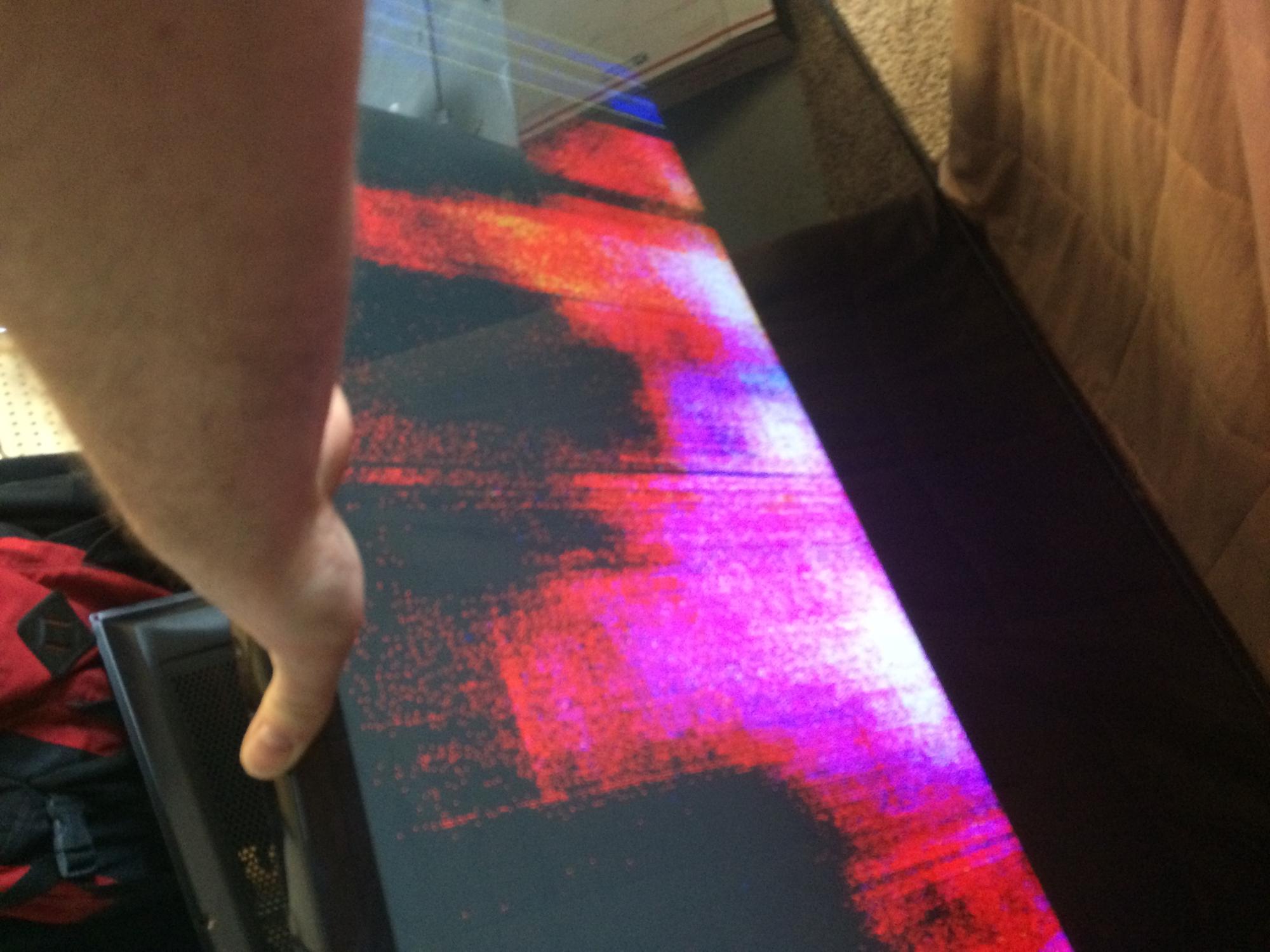

    I have read numerous threads of similar model numbers but none seem to solve my issue. My Tv powers on and stays on like normal. All voltages are good from power supply to y board and z. The screen stays completely dark. I have purchased a new y sus board and installed. It did look like it primed and then no picture. It has not done this since the initial start up. I followed Tom66 suggestion to power one with top then bottom buffers disconnected. I do get the screen to light up in both cases. In fact with the top buffer disconnected from the ysus board but connected to ribbons and bottom buffer, the entire screen lights up.
    I tried jumpering for the test pattern on the logic board with everything connect besides the lvds cable. No response on the screen at all. I did get a new bottom buffer, no change, and I am currently waiting on an upper buffer in the mail. Anyone have suspicions based on the screen images of what could be the culprit? Or if I have a blown ysus board, what component is failed?

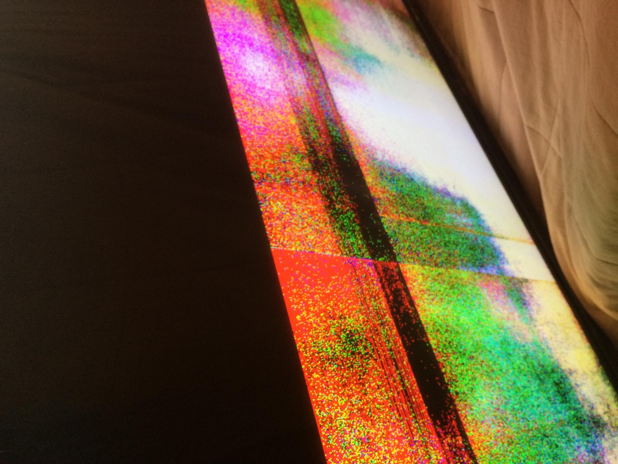

    Most of the screen images do have a constant blue bar on the right side of the screen. I'll have to upload the photos individually, it is only allowing 1 at a time. Thanks for the help!

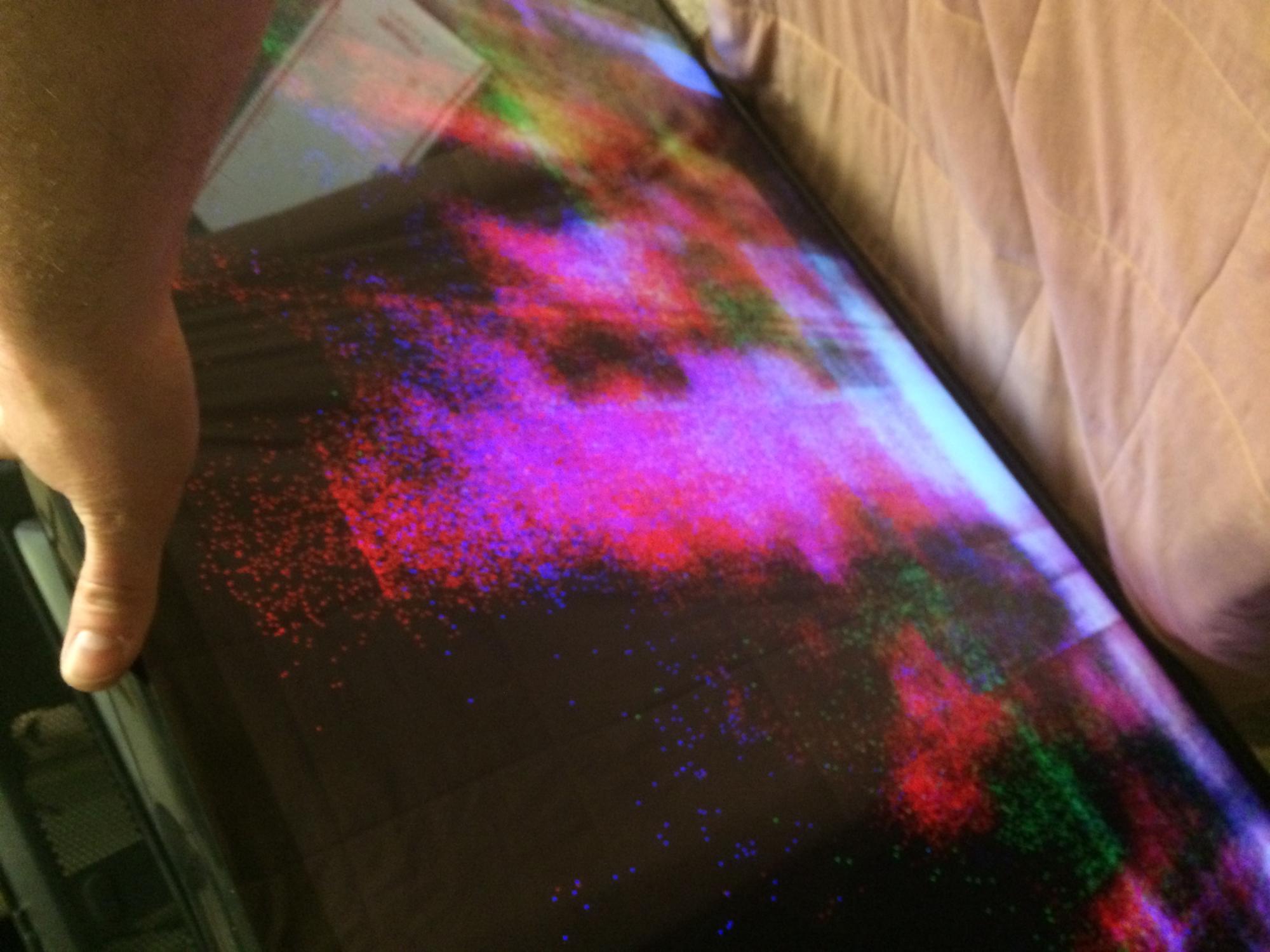

    Here is a photo of the entire screen when it generated light after disconnecting the top buffer from the y board. I can upload all boards too if needed
      Re: Lg 60PA5500 No picture
      And here is a photo of when top buffer is disconnected entirely. One other thing I did not mention is the screen seems to respond when the input and menu buttons are pressed. There is a "white" image that moves around on the screen, possibly a "no input" that typically would appear when nothing is connected.

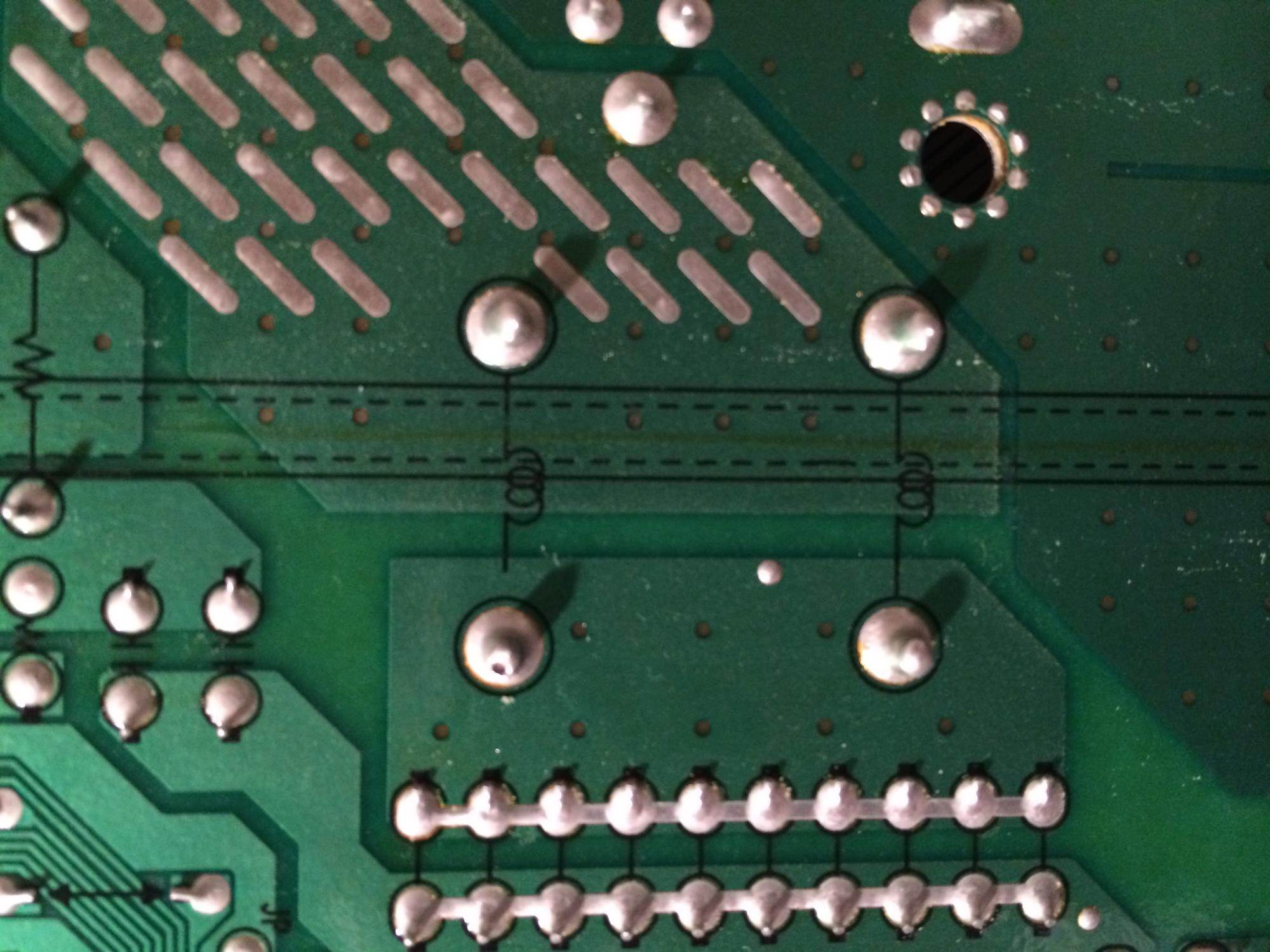

                              I checked the solder joints on the coils and they appeared ok. I did go ahead and re-solder them just for insurance.

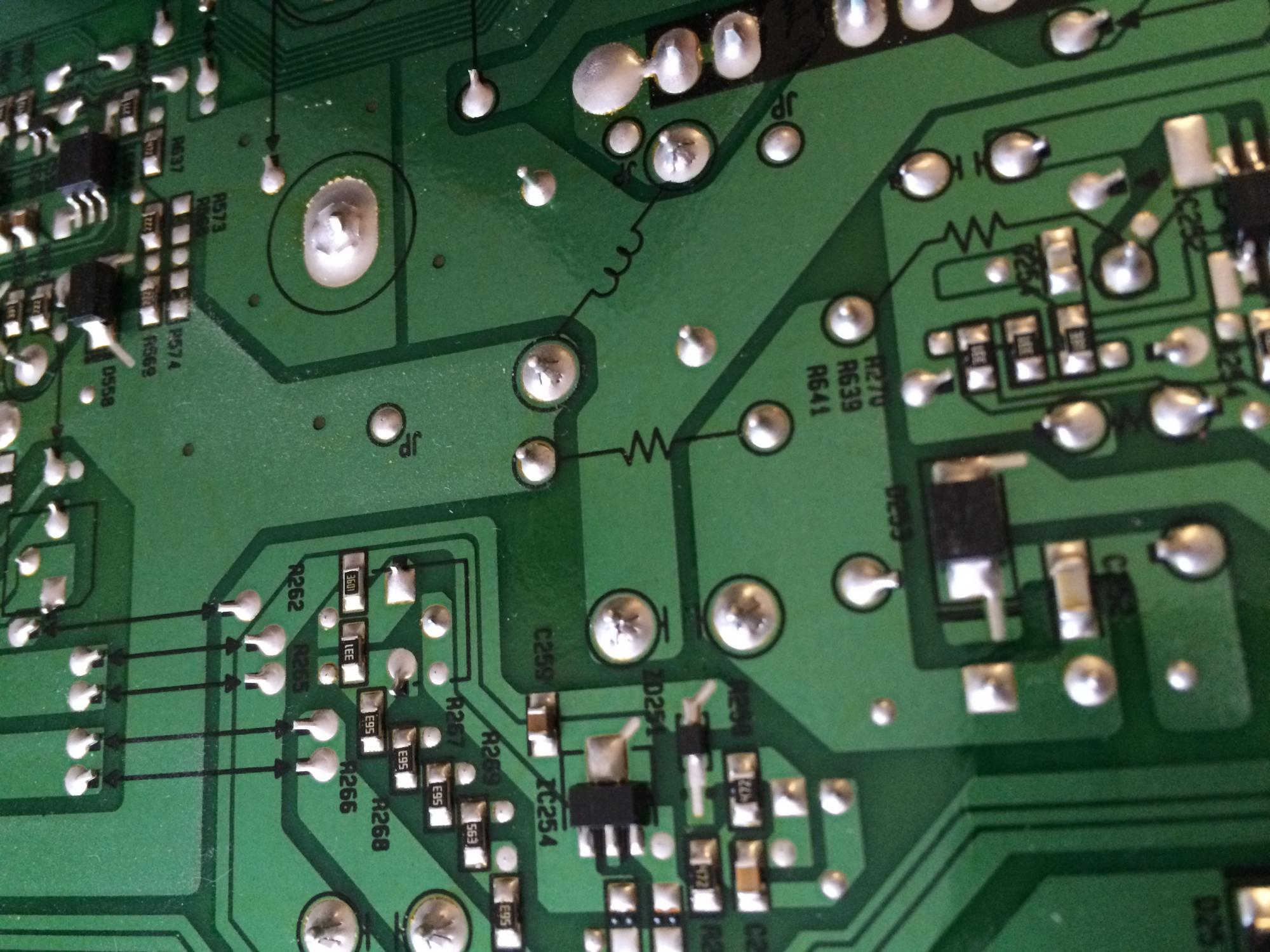

                                As a rule of thumb and it only takes a few minutes anyway, but just double check all your axial diodes and all your transistors, fets, none axial diodes and any other components screwed into your heat sinks for shorts or low ohm readings.
                                  Do these solder joints look suspect? I have them on a few areas. I'll probably redo them anyways, but just curious if this could be my ailment. It looks like the isn't enough solder in the joint.

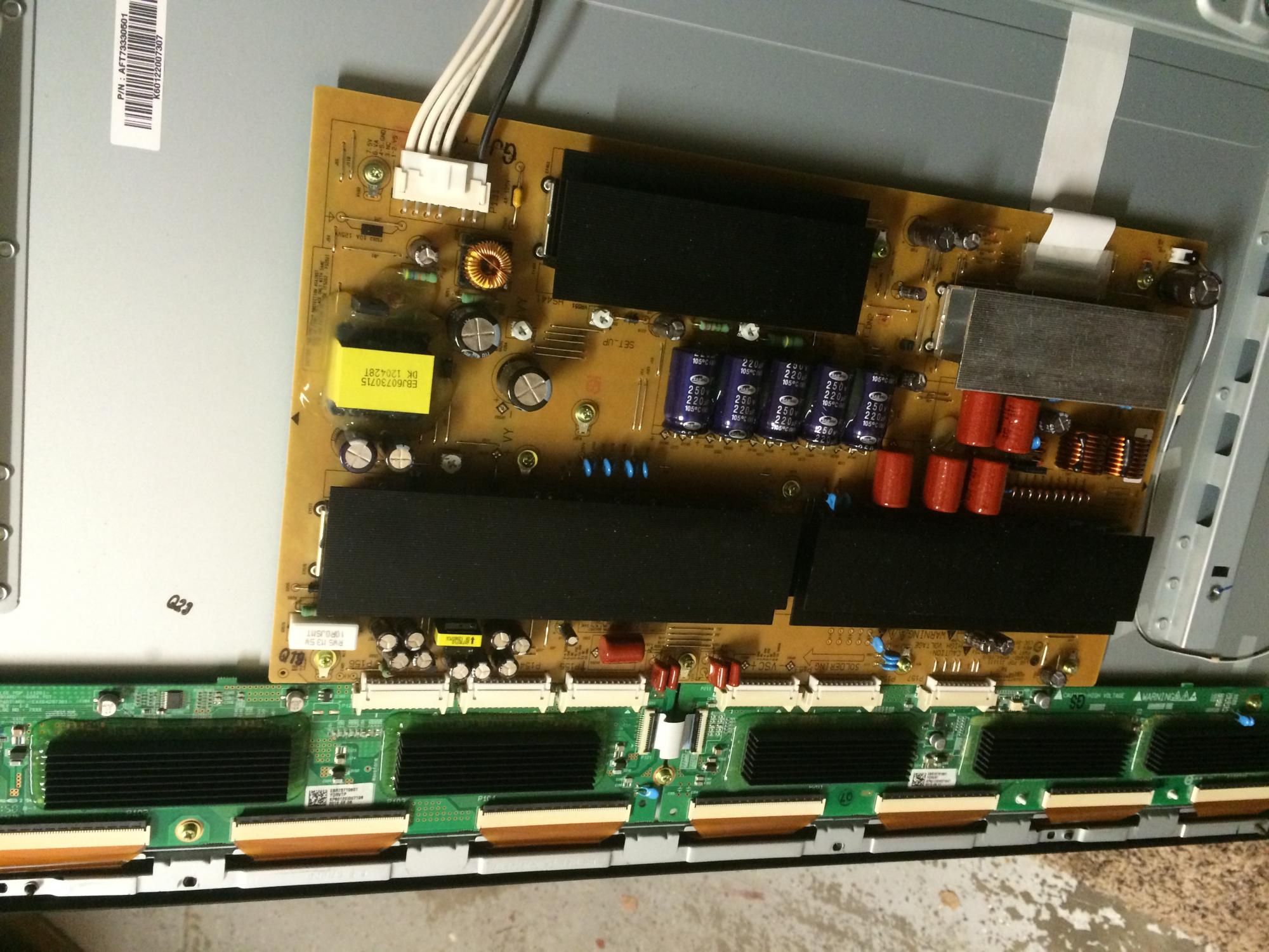

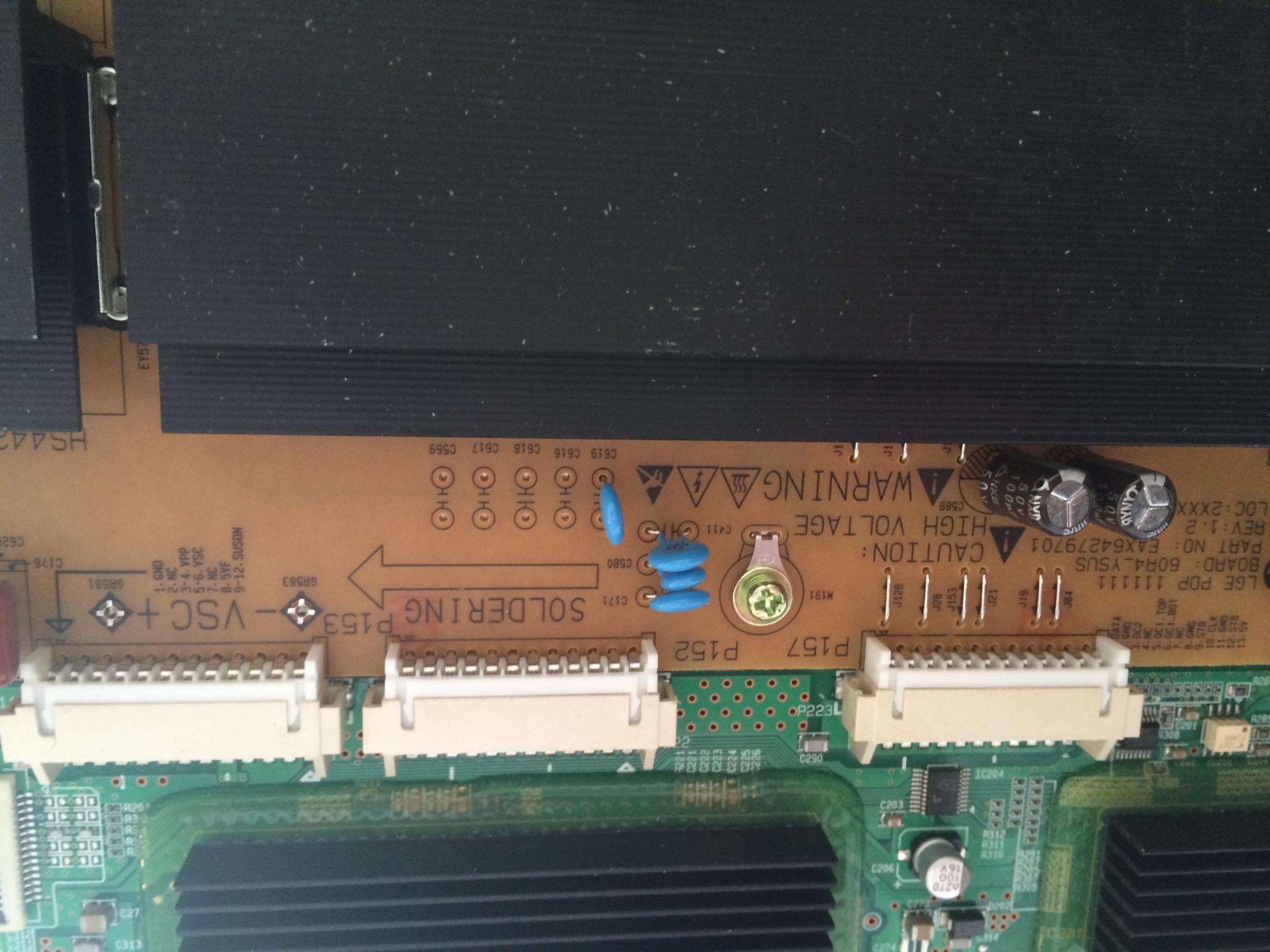

                                    I've included a picture of my ysus board. I'm at the point I believe both of these boards have issues. When measuring voltages, they are unstable going to the buffers. I almost want to try and see if I can make 1 good board out of the 2 bad before ordering another board.
                                    Would the larger/higher output capacitors be causing the board to not produce steady voltages? Can someone tell me what the large square device is that had the silicon around it, I'm drawing a complete blank. Just trying to get some clarification before I order 1 more ysus.
                                      Those solder joints are just fine.
                                      Did you get any picture when the lower buffer was plugged in?
                                      The large capacitors very very very rarely go out, I wouldn't even consider them to be a possibility. The large square is a transformer, also very rarely go out.
                                      Have you checked your through hole axial diodes? That chirping sound that you are talking about has been known to be caused by bad axial diodes.
                                      Also going back to you testing the Y-sus boards, you said one had negative voltage. That's probably because you just switched around your leads, and that's absolutely fine.

                                      If you could also take a picture of the back of the Z-sus for me, the last pic you posted was an up close. If you could take a picture from the top and from the back side as well. I just want to make sure I am thinking of the correct board here. The picture you showed us had only 2 inductors on it when it should have had 3 so I am thinking you may have just taken a pic of a different location.
