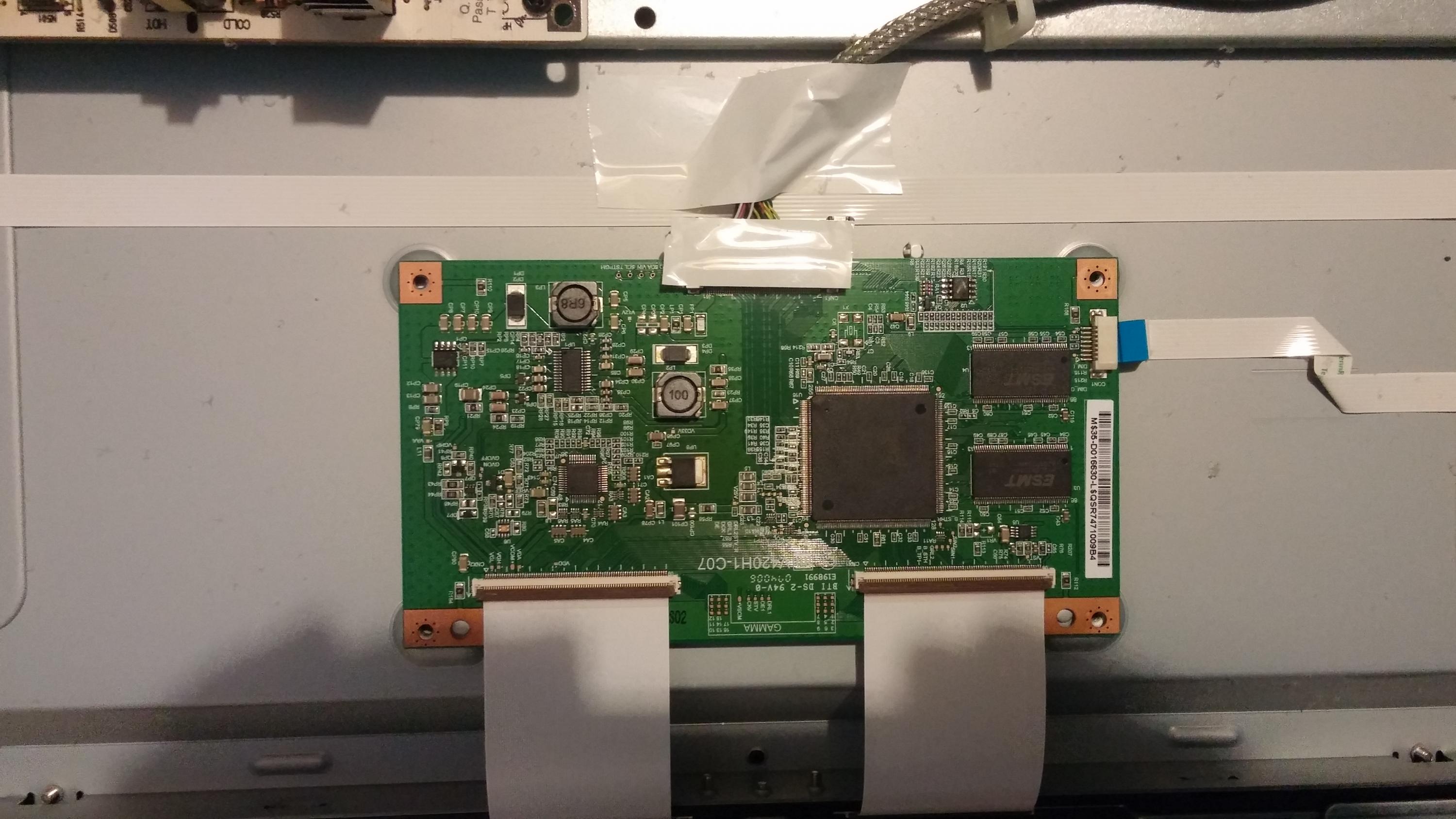

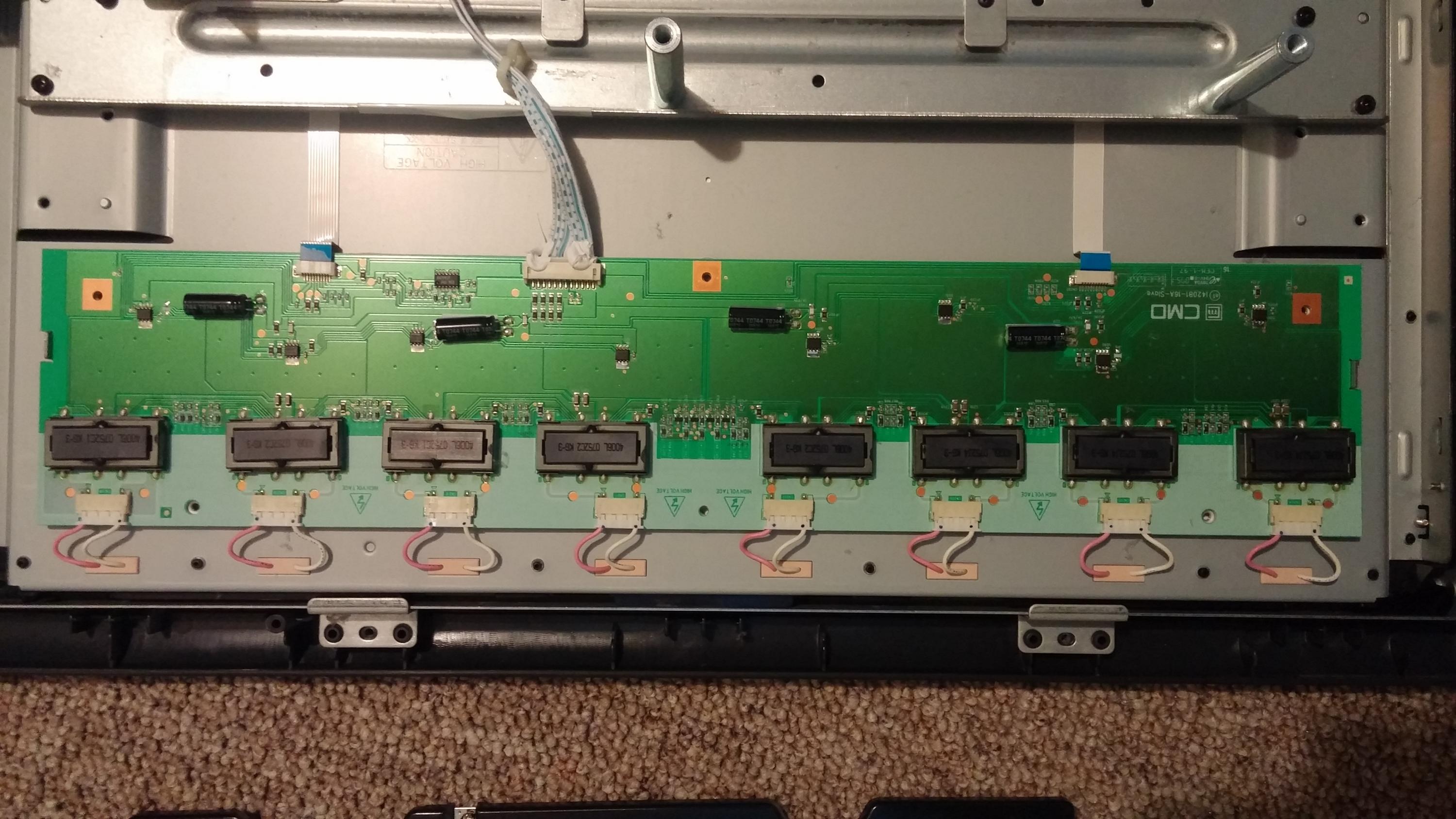

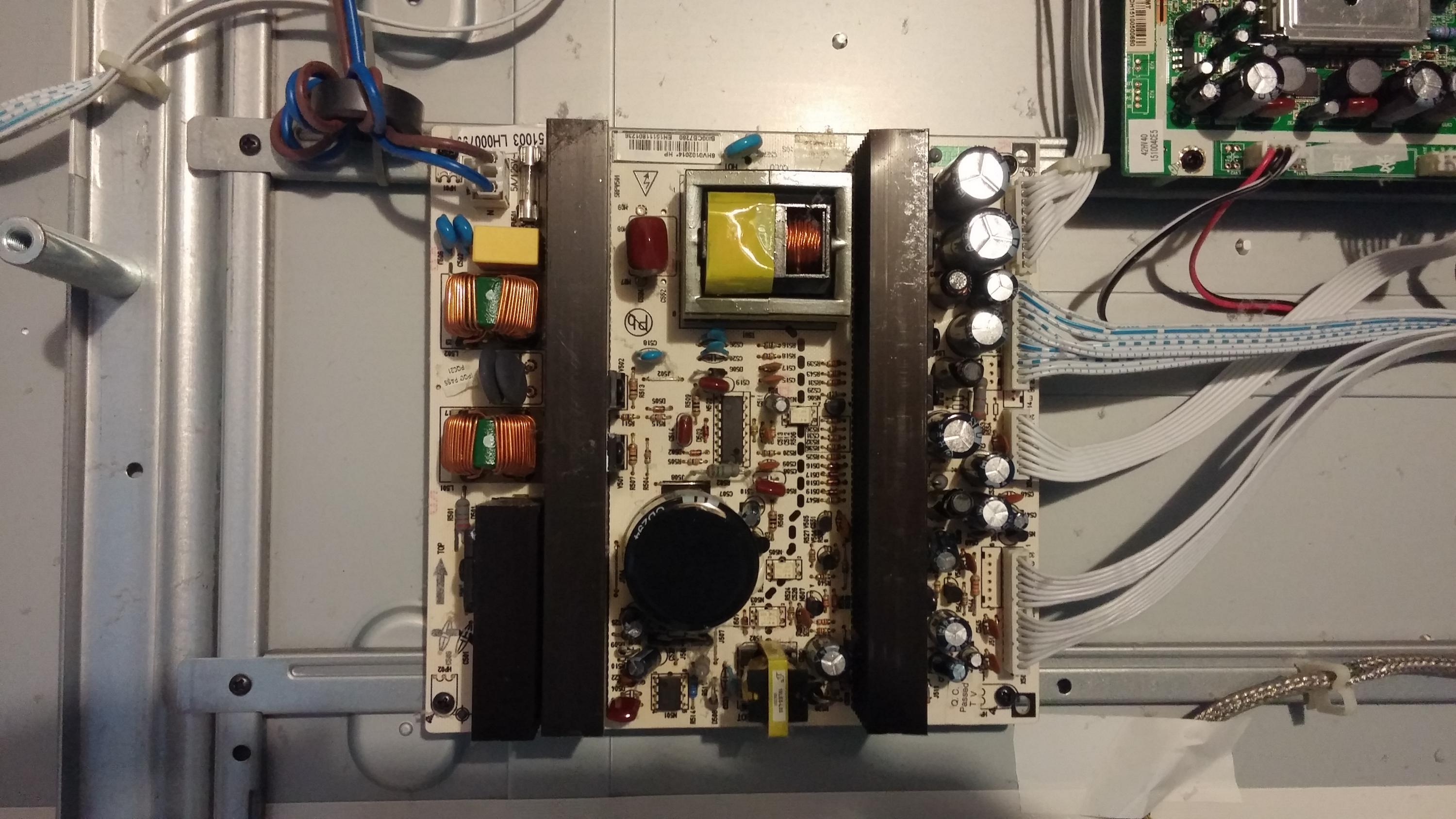

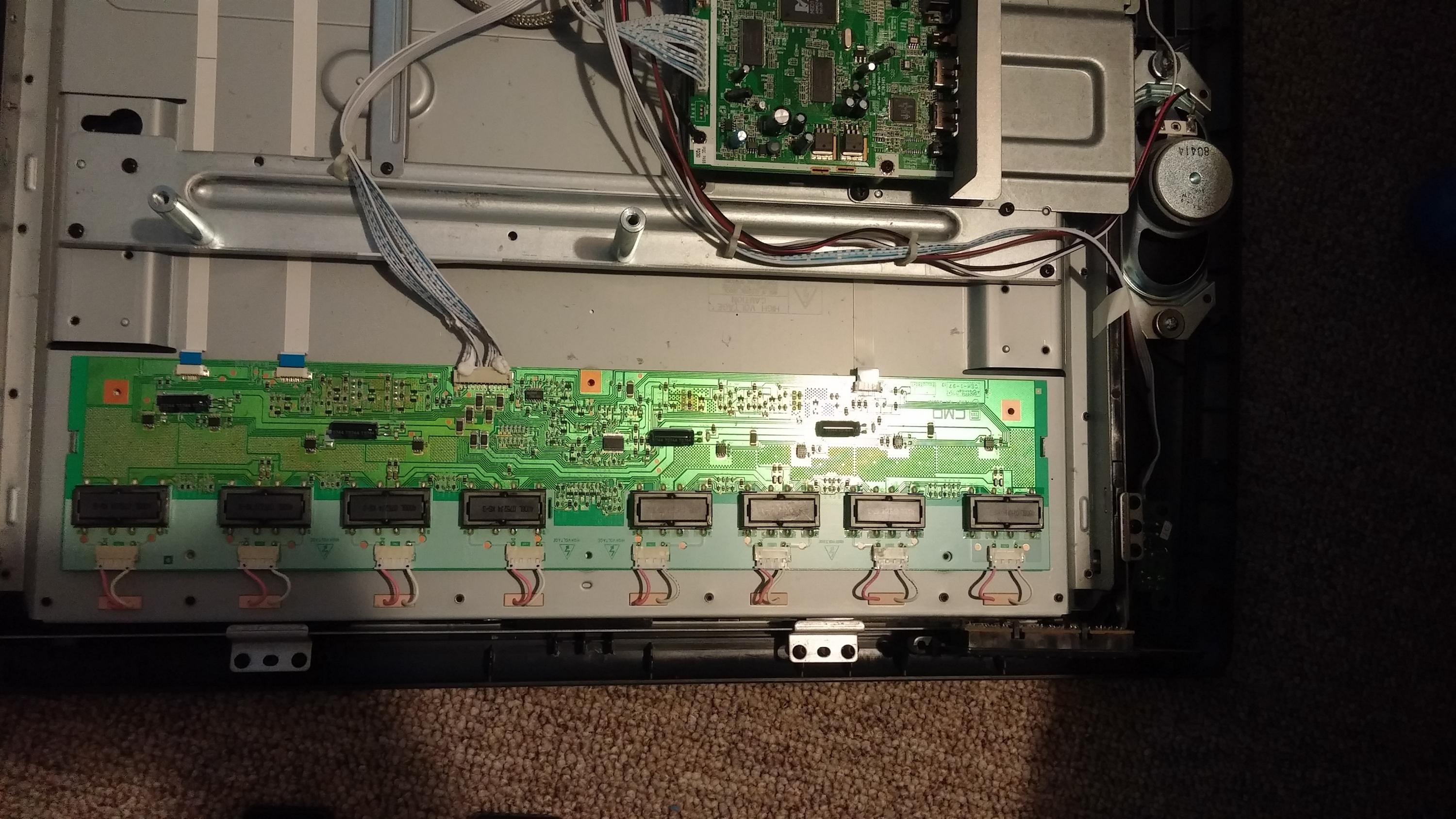

    Re: Dynex DX-LCD42HD-09 goes blank after a few seconds
    Maybe I didn't provide enough information initially. I have taken photos of the main circuits that I could find. If there is any additional information that I can provide to assist in tracking down the fault, please let me know.
      On the power supply measure all the DC voltages on all pins that go from it to the main board (2 ribbon cables) post them voltages including with the pin name you measured it from with the tv on.
      Also try to set it to a channel or play a DVD etc, to see if it puts out audio and video. You have to shine a good flash light into the screen and you may see a picture.
        Ahh the CMO inverter board. Check the resistance of the HV windings (there are two HV windings per each transformer:S1-S2, S3-S4 on each of the Inverter transformers (all 8) to see if they are within 3% from each others.
        There are 4 white fuses that should be check also, those 4 black filter caps should also be replaced.
            One of the ribbon cables:
            PON: 3.0
            GND: 0
            5V: 5.1
            GND: 0
            GND: 0
            16V: 15.8
            16V: 15.8
            GND: 0
            5V: 5.1
            GND: 0
            5V: 8.8
            GND: 0
            32V: 32
            The other ribbon cable:
            BON: 5.0
            PWM: 3.3
            GND: 0
            GND: 0
            GND: 0
            GND: 0
            GND: 0
            24V: 24.2
            24V: 24.2
            24V: 24.2
            24V: 24.2
            I have confirmed that it has both audio and video on HDMI input 1, but the video was extremely hard to see (using my cell phone as a flashlight). I see that the last 5V signal on the first ribbon cable was supposed to be 5V but was all the way up at 8.8V so that does not seem good. Thanks in advance for any advice based on these results. BTW, I measured it from the grounded metal chassis of the TV.

              Thanks for the response. I checked 4 fuses on each of the two inverter boards. They all tested okay (short circuit). The resistance of the windings all read between 1.052k and 1.079k so that falls within the 3% you suggested. I have not replaced any capacitors yet, because I first wanted to get additional feedback based on the information provided to you and CapLeaker if you think that might be the issue or if it is likely to be something else. Thanks.
                All the voltages and the command signals for the inveter are present, so it it either the inverter board or the lamps.
