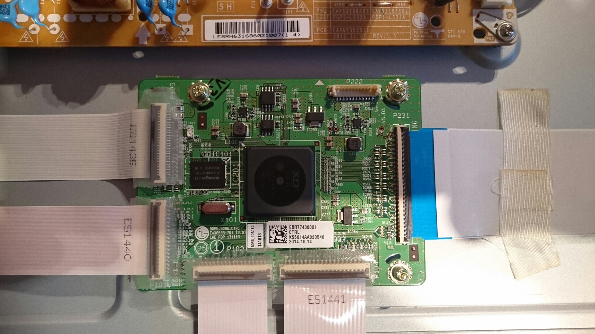

                              • jczarniak
                                • Oct 2015
                                • 179
                                Re: LG 50PB560B completely dead
                                Originally posted by ReeceyBurger123
                                You can run the test patterns with the Mb disconnected. Just jumper the ext gen pins on the control board and unplug the Lvd cable and the set will power on.
                                Thanks a lot.
                                Which pins these are, please?
                                Attached photo.
                                Thank you very much.
                                • cliff_hootarski
                                  • Jul 2006
                                  • 411
                                  EXT AUTO GEN pins top right of the big chip in the middle.
                                  • jczarniak
                                    • Oct 2015
                                    • 179
                                    Done.
                                    Nothing is happening.
                                    Next step, please?
                                    • cliff_hootarski
                                      • Jul 2006
                                      • 411
                                      Did you disconnect the LVDS cable? The blue colored connector.
                                      • jczarniak
                                        • Oct 2015
                                        • 179
                                        Yes, I did. Blue colored cable disconnected.
                                        Also checked with connected and disconnected power cable to main board.
                                        Still same.
                                        You my only hope, what's next step, please
