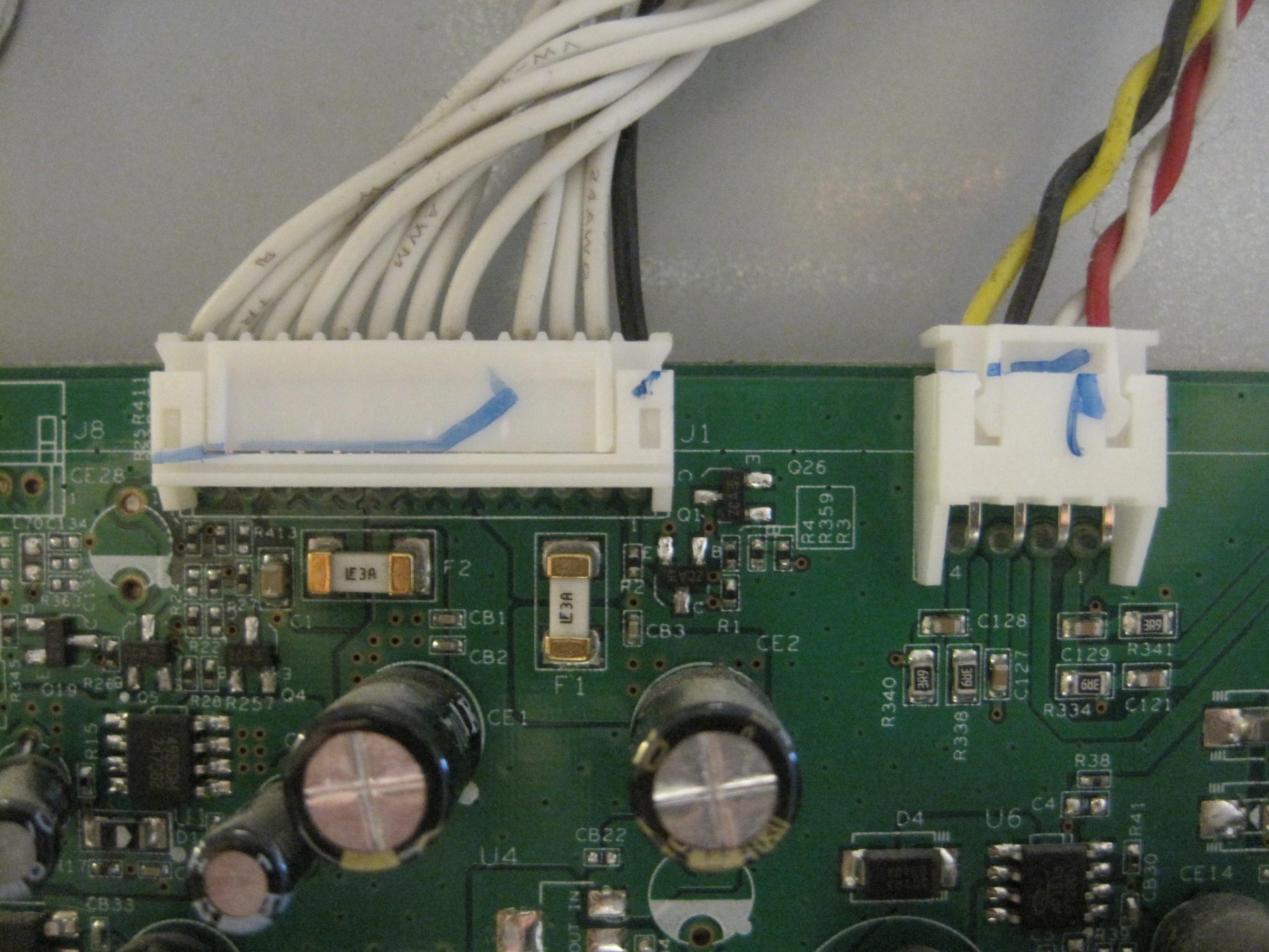

    Hi All,
    I have read many of the Posts on this Tv problem - cannot find one on what I am seeing or what to test further.
    I gave the Yellow Standby and then White light on with the Front of TV.
    Checked all Cap's nothing looks bad or nothing else sticks out as bad.
    No 12 or 24 V on the Power Supply so looks like not coming on.
    On the Main Board I have on Fuse F2 5.1 volts, on Fuse F1 no voltage at all on either side on this fuse.
    I figure should see something on at least one side if Fuse was Blown.
    So the Question is - Where to look next ?? or link to a post that can help

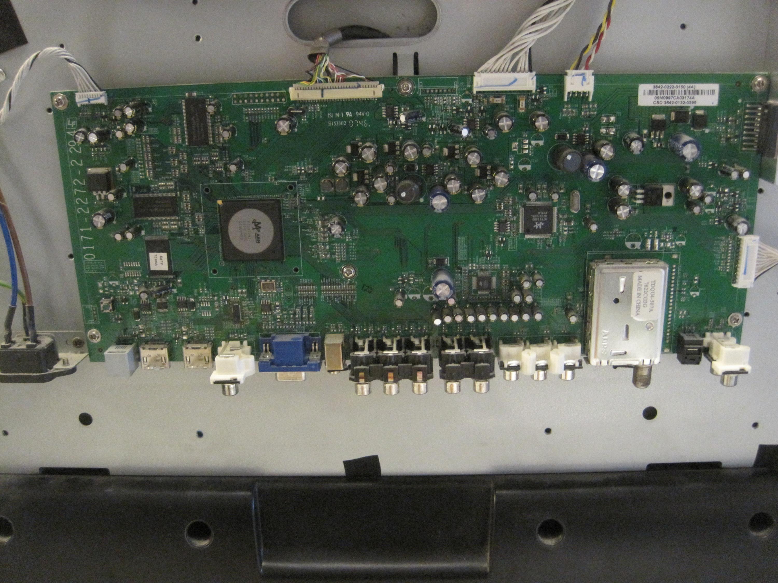

    Please post good clear pictures of your boards, each connector on the board, and one of the entire assembly. We can't really help if we don't know what you're working on.
      Re: Vizio VW42L hdtv10a No Picture
      F1 is fed by the switched 12V from the power supply board, it will be present when the power supply board gets the PS-ON signal to turn on the power supply.
      So you need to report the DCV readings of each pin of the power supply connector that goes to the main board, you MUST put pin name and pin numbers for each reading so will will know what are missing.

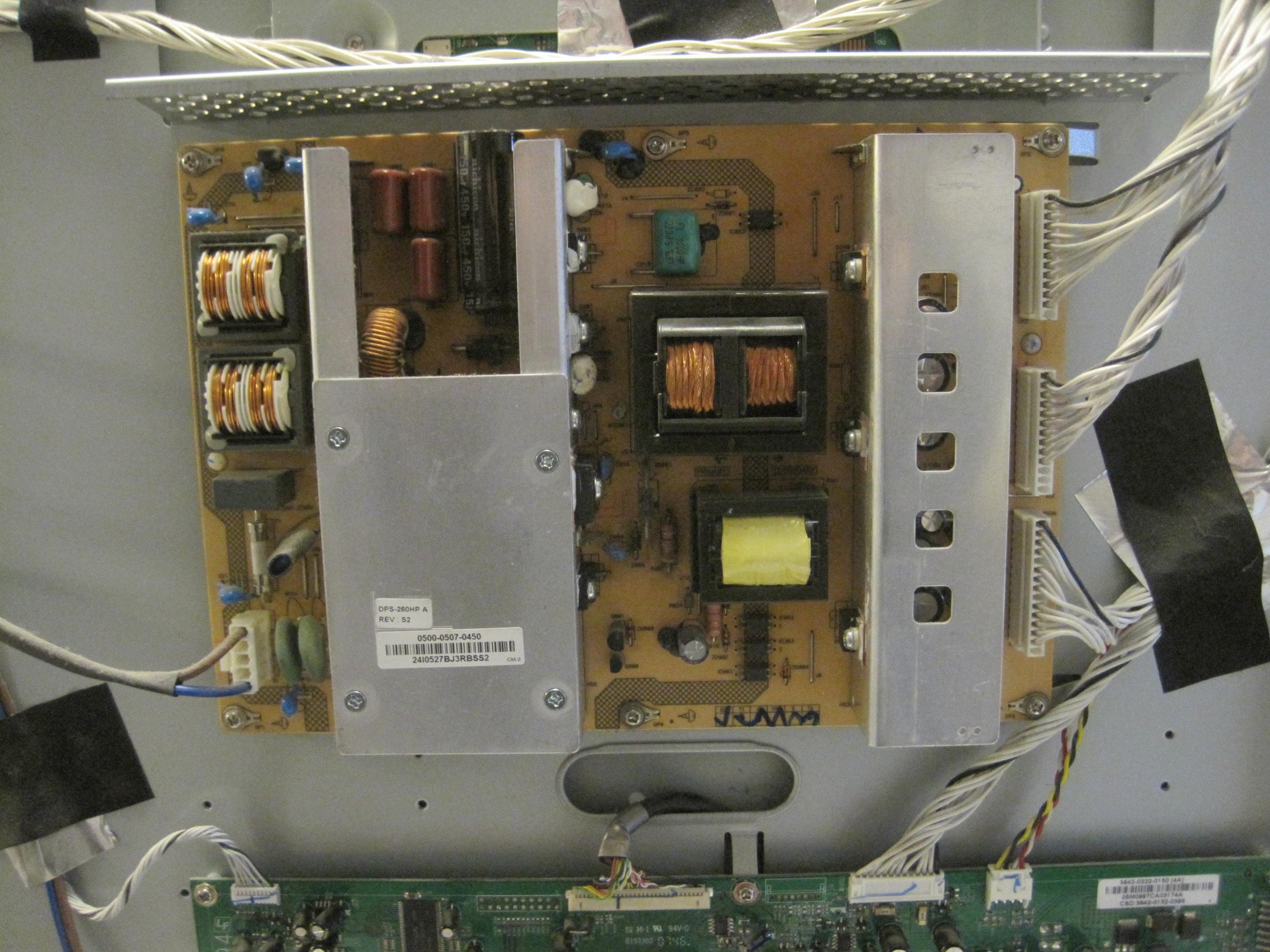

        Here are some pictures
        The Power Board, Main Board and the Two Fuses F1 & F2
        If need more please let me know what your trying to see so can focus on that area.
        Thank you

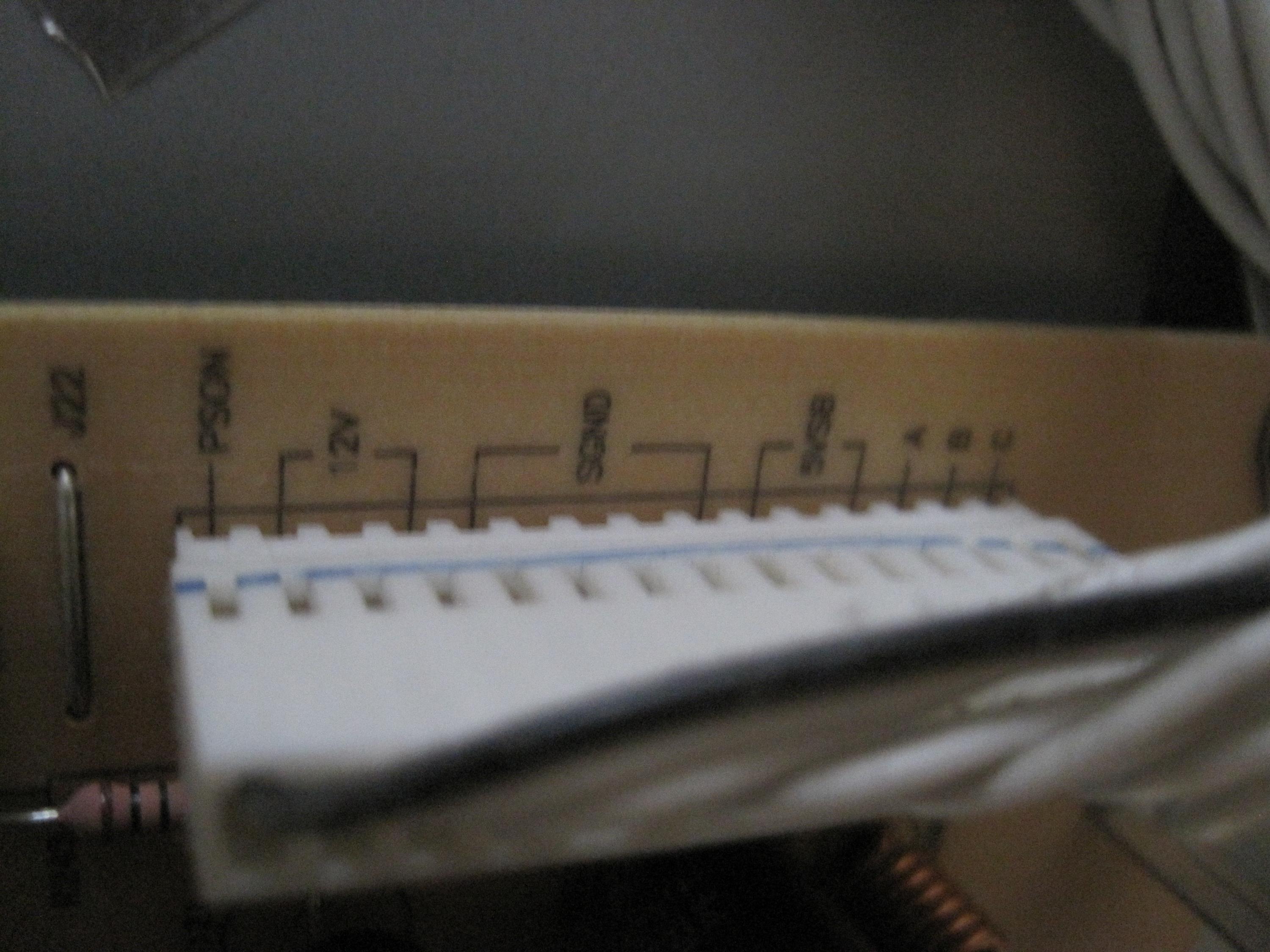

          OK Measured from Power Board Connector
          PSON - 3.12v
          12v all -0 v
          SGND - all 0 v
          5v - 5.19 v all three
          A- 1.49 V
          B- 2.89V
          C - 0

            OK, so you do have PS-ON, now we need to find out if the PFC Voltage booster is working or not since the 12V/24V power supply require Boosted Voltage to work.
            Check the DCV between the two legs of the main filter cap to see if it has close to 400VDC on that cap. Be careful you will be working in the deadly side of the circuits.

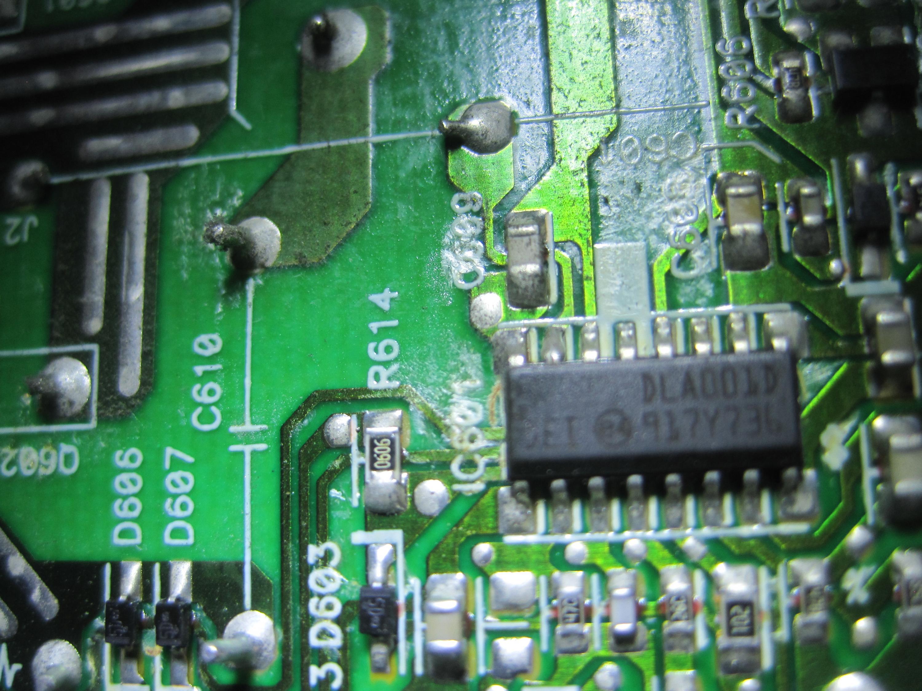

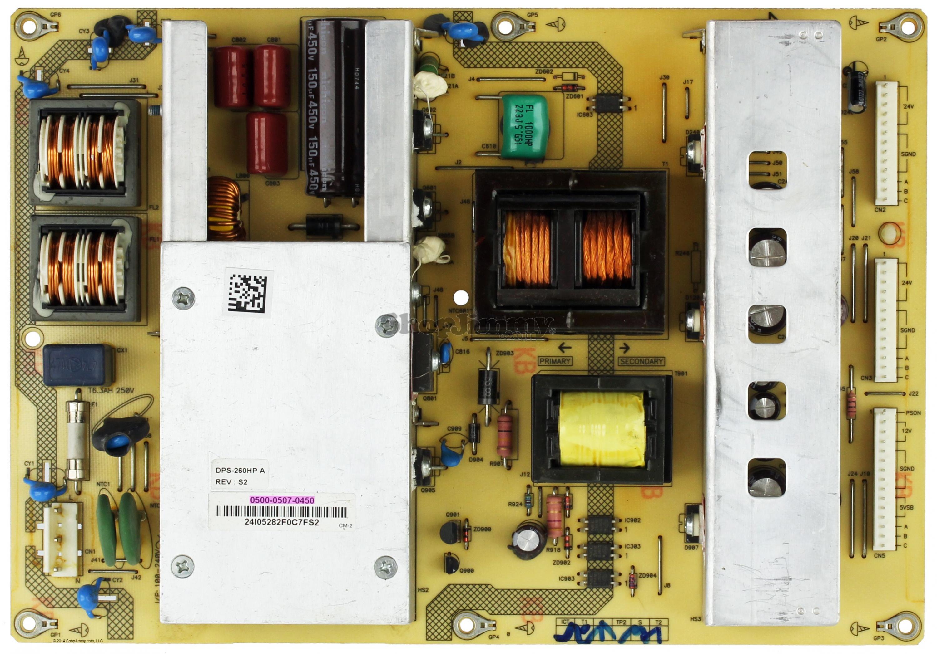

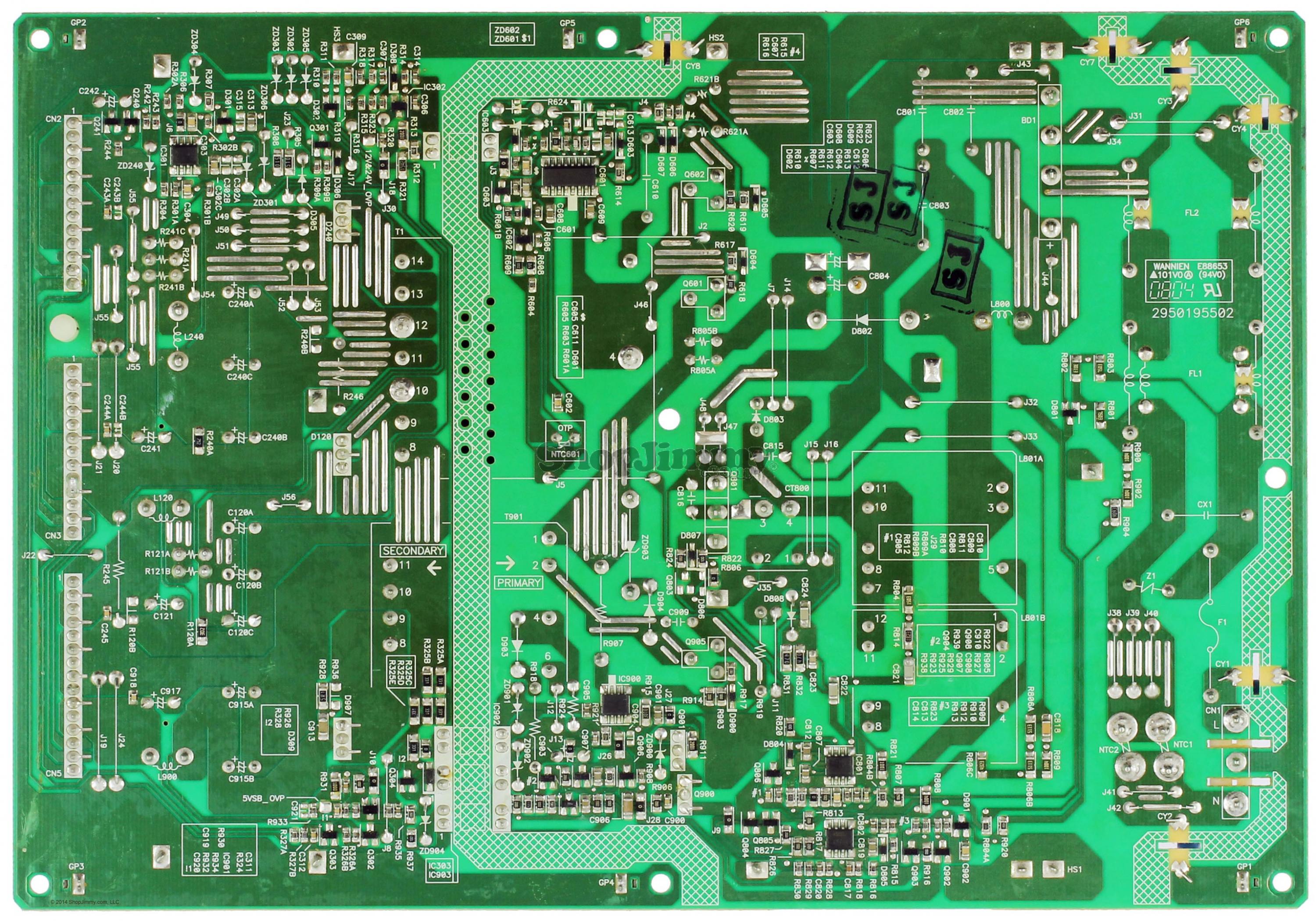

                OK, we need the P/N of the SMD SMPS IC601 so we can look up the spec sheet to find out if it does have VCC to run it.
                Vizio 0500-0507-0450 (DPS-260HP A) Power Supply Unit.
                http://www.shopjimmy.com/vizio-0500-...wer-supply.htm
                Pictures provided by shopjimmy.

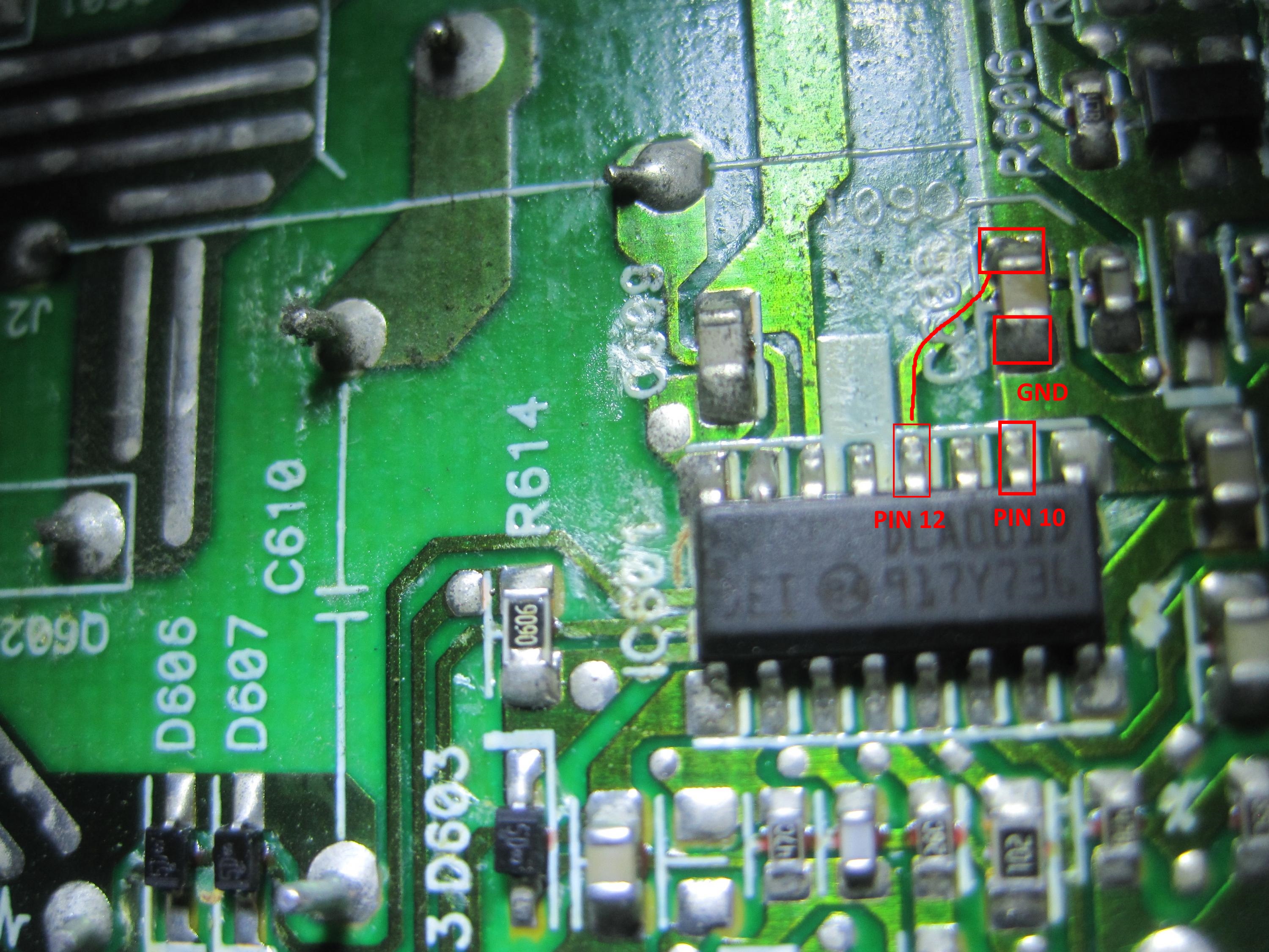

                  Find IC603 on the board upper top middle and three lower bottom middle.
                  Do not see a IC601.
                  Can you give me a idea where to look?

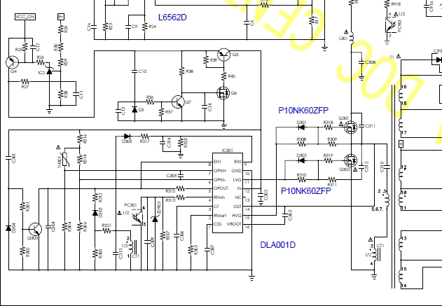

                    Dla001d
                    917y736
                      http://www.datasheetcafe.com/dla001d...controller-st/
                      Check the Voltage between pin 10 gnd and pin 12.
                        To do this I need the board to be removed from Frame and hanging free.
                        To get to the back IC
                        Is this OK to do powered up?? Board not grounded then to frame
                        Also the picture I sent of the IC which Letters are those pins near.
                        Want to make sure I measure correct ones
                          You can solder two wires to the pads and connect the wire to the dcV meter, you should leave the board mounting in place and you will need to have the main board connected to the power supply board.
                          Or you can use 470~1K resistor 1/4W (or larger does not matter) resistor between 5VSTBY and the PS-ON pin to force on the power supply so you can test the board by itself without having other boards connected to it and without mounting the board to the chassis.
                          You will be making the measurement in the HOT side so do not touch anything with your hands or body.
                            Ok
                            Your saying I connect wires to pin 10 and 12 and remount board with wires out back so can measure them.
                            For the ground can I touch any ground point or has to be the one you marked so then would need three wires out back
                            • pfgallo
                              • Dec 2012
                              • 17
                              • usa
                              Looking at the IC its going to be hard to solder wires to it being so small
                              I got a 1 k Resistor and can do the second one.
                              So what is exactly you want me to do.
                              Connect resistor between 5VSTBY and the PS-ON pin and then ??
                                Originally posted by pfgallo
                                Ok
                                Pin 10 is the GND pin for your black probe, pin 12 is the VCC for your Red probe.
