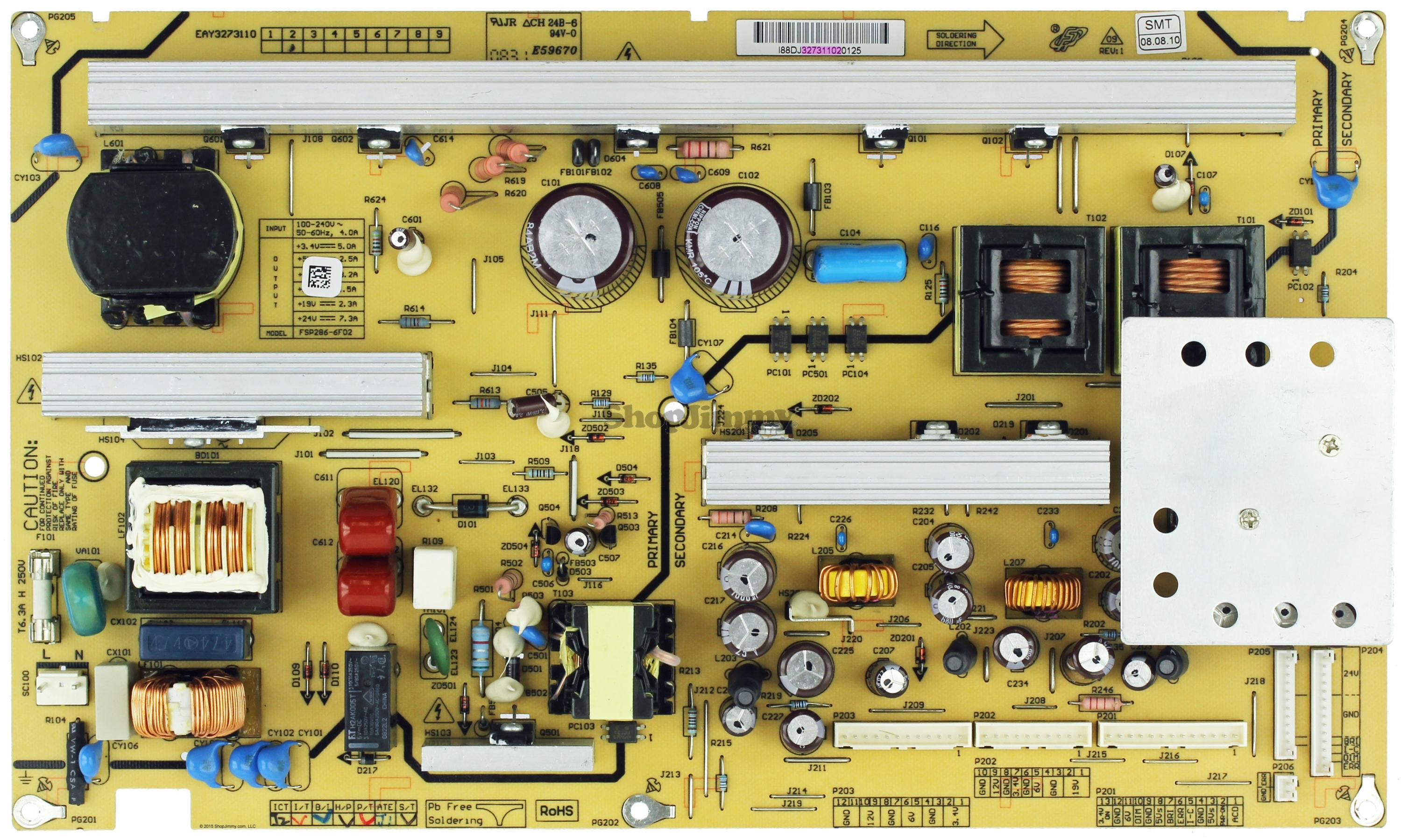

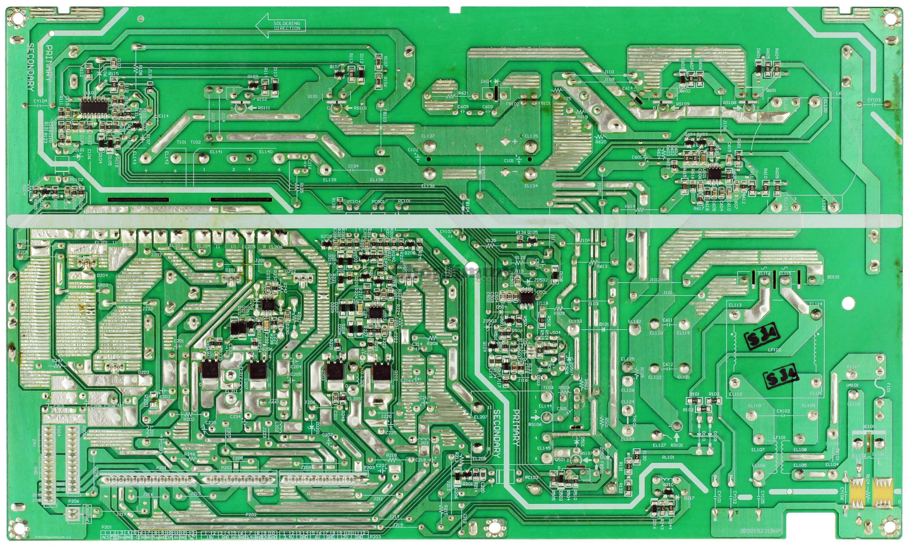

        Re: LG 42LC7D-UK Repair
        Is this the exact board you have?
        http://www.shopjimmy.com/lg-eay32731...pply-unit.htm#
        LG EAY32731102 (FSP286-6F02, 3BS0152315GP) Power Supply Unit.
        No need to do any force on right now, you need to get the standby power supply working first.
        The STBY power supply section has IC U501 for the SMPS IC whcih drives the power MOSFET Q501 which drives STBY power transformer T103.
        Small caps C505, C507 are part of the startup running caps that you need to check the capacitance and the ESR.
        You also try running the board by itself without other boards connected to it to see if you will get the STBY Voltage back.
        D205 is the rectifier, C216, C217, L203, C218 sre the Pi filter for the 5Vs at connector P201 pin 3.
        So verify for sure that you do not have 5VDC at that pin.
        Pictures provided by shopjimmy.

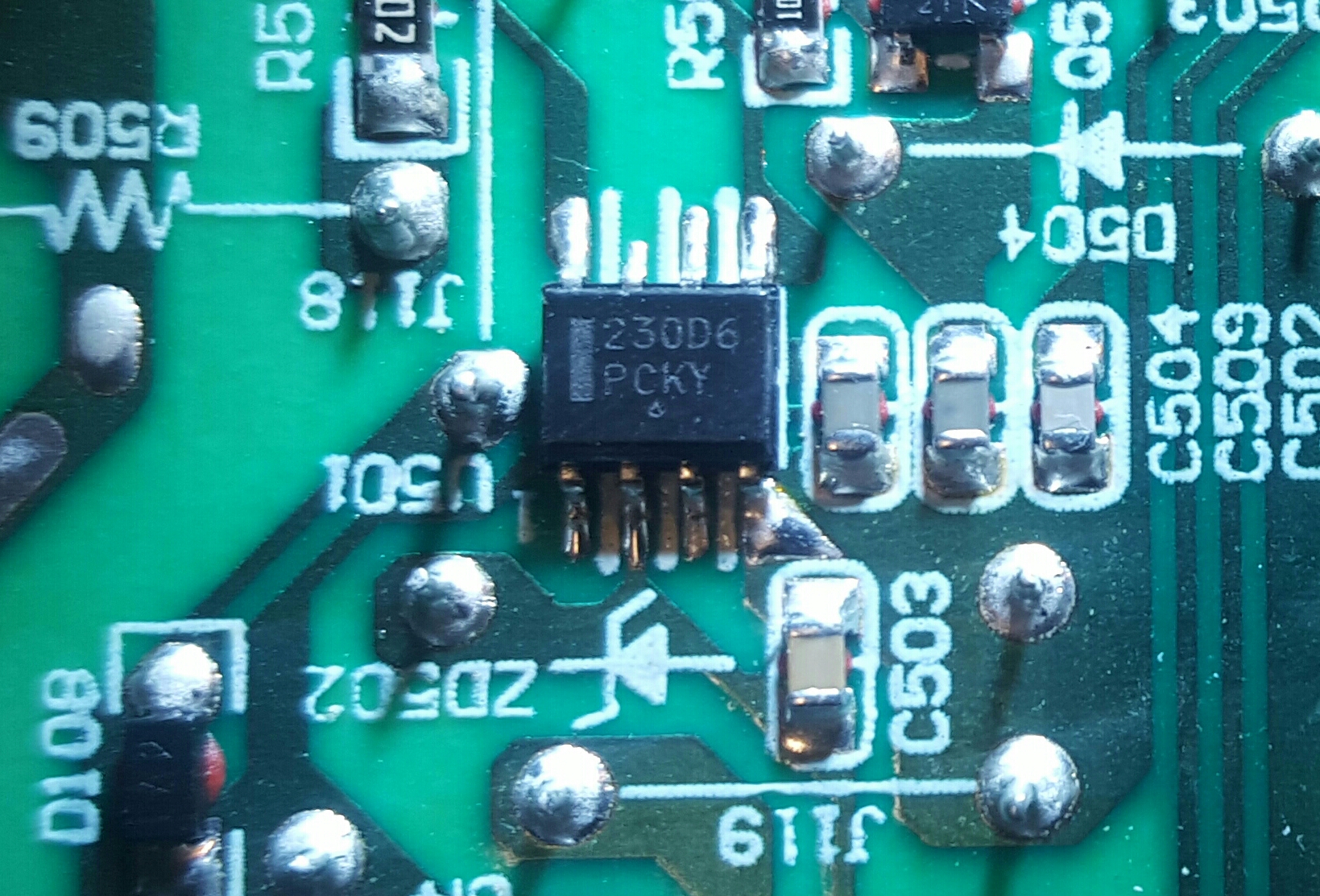

              Part# U501
              I'm finally getting back on this LCD. I got a close-up of ic U501, it is a NCP1230D6, which is a 'Low−Standby Power HighPerformance PWMController'. Here is a link to the DATASHEET. I'll try getting some measurements then post them.
                OK, per spec sheet, the HV is applied to pin 8 which has the charge pump circuit to charge up the Capacitor on VCC pin 6, when the DCV reach 11.6VDC, the circuit will then start running which then the running Voltage for the IC will be generated by the AUX winding of the power transformer to keep itself running , the charge pump circuit at this point will be shut off.
                You can see the application circuit on page 11 on how the IC is used.

                  Here are the results using pin#4 as the GND:
                  Pin#6 = 8-10.3 Vdc
                  Pin#8 = 164 Vdc
                  Would you say that this means that startup voltage at pin#6 is too low? What happens if I give it a little boost to see if it will start?
                    That can be that the electrolytic caps (C505, C507) connected to pin 6 may be bad (high ESR, low capacitance), or D205 I mention in post 4 may be leaky or shorted.
                    The circuit is on the HOT deadly side of the circuit so do not try to attach any external power supply to it.
