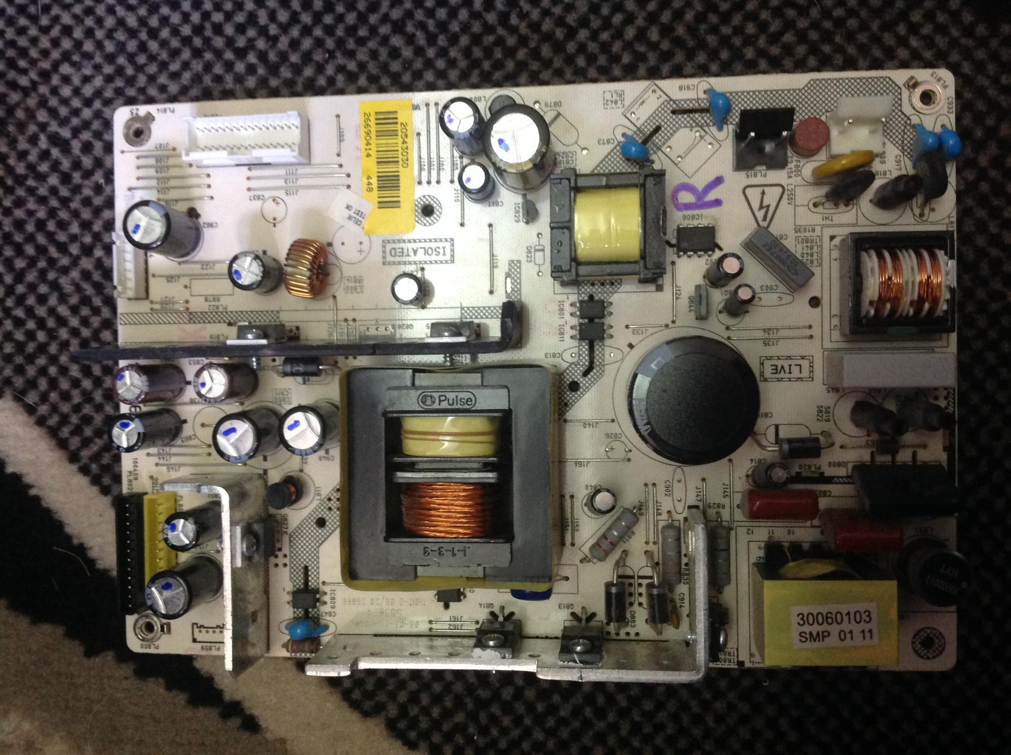

        Re: 17PW26-4 Odd Failure But Simple Fix
        Top side of Pcb. Output caps all changed as well as polly cap.

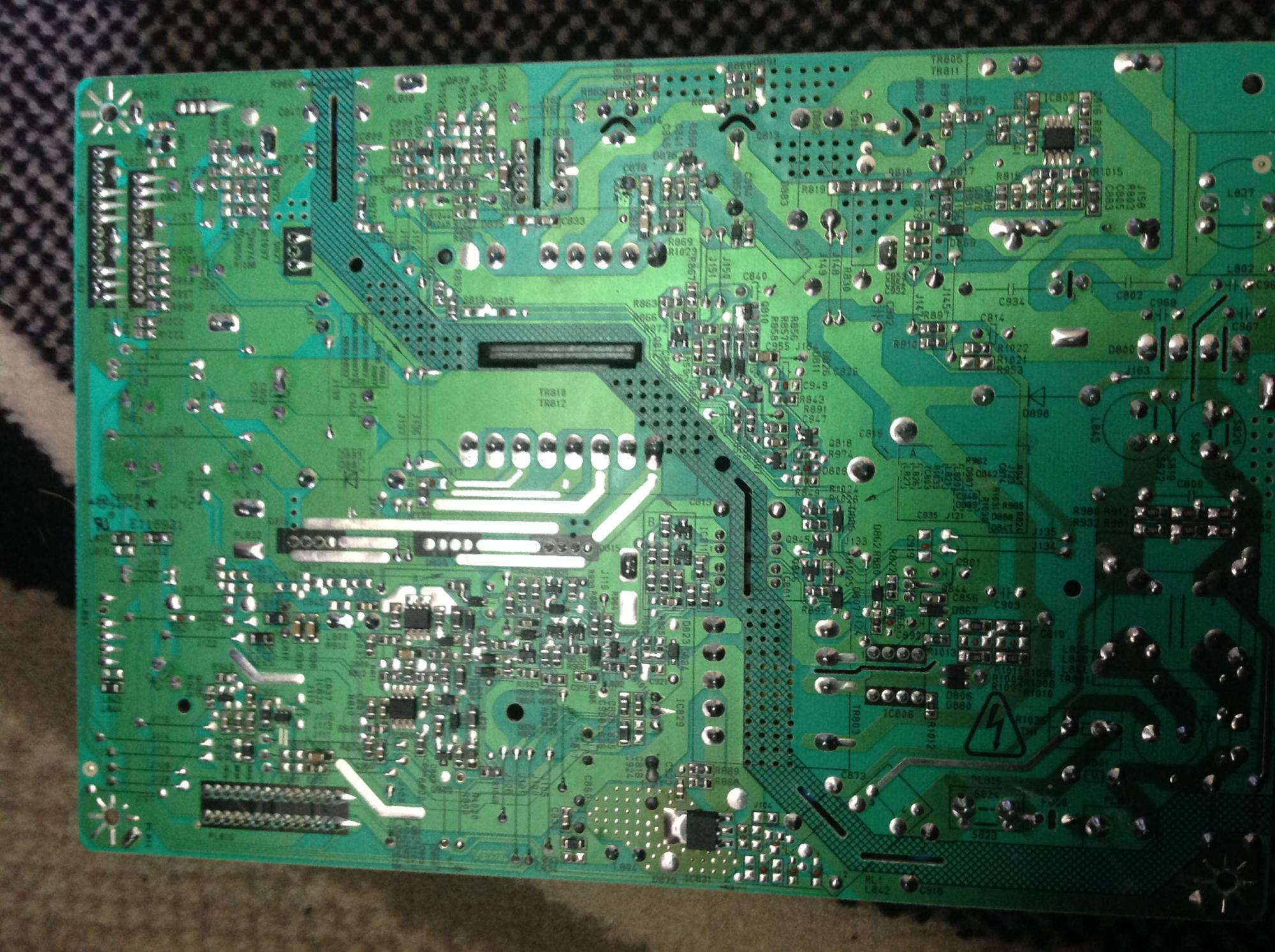

          Bottom side of Pcb.

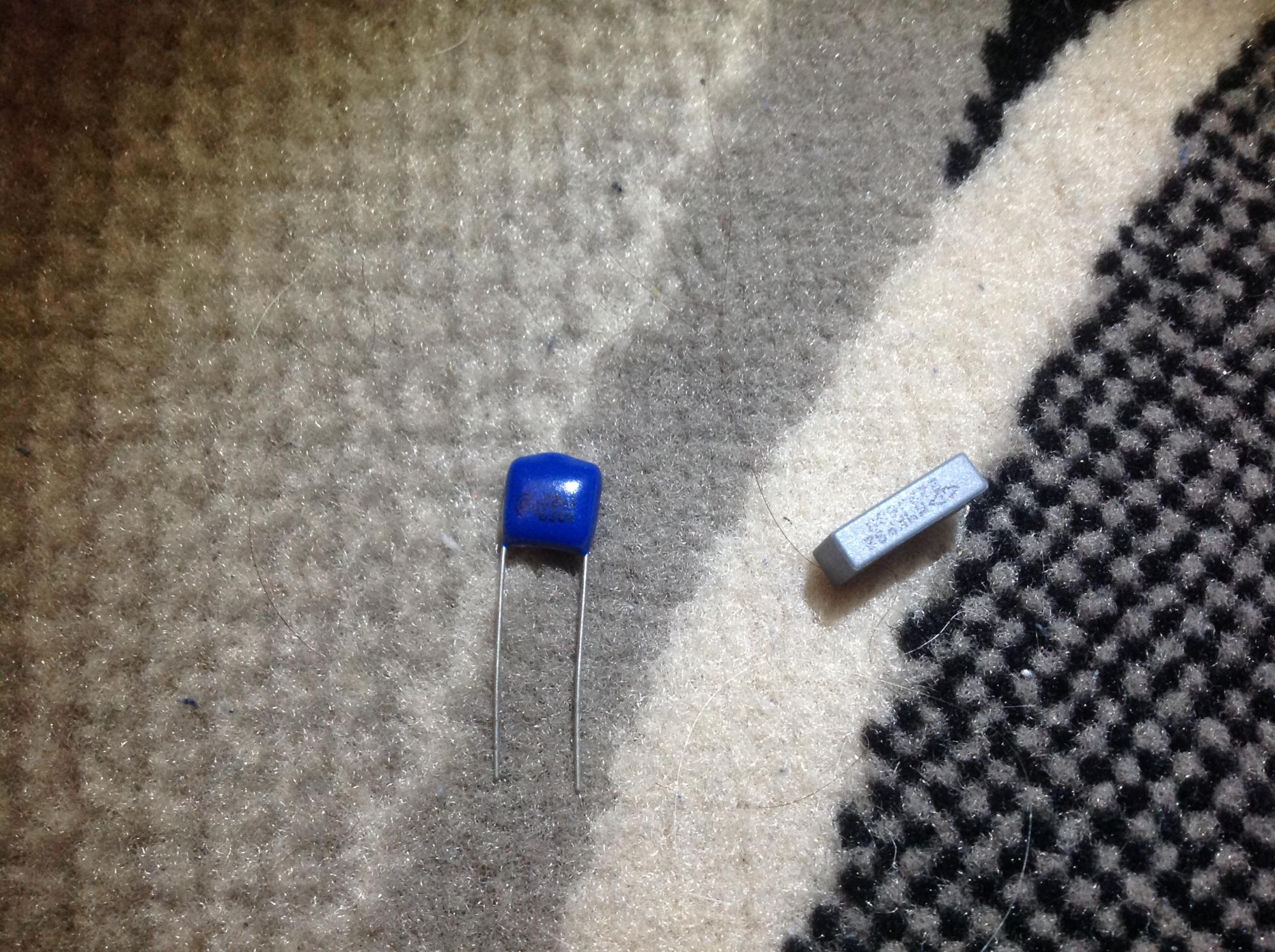

            Polly cap old vs new 223nj 630v.

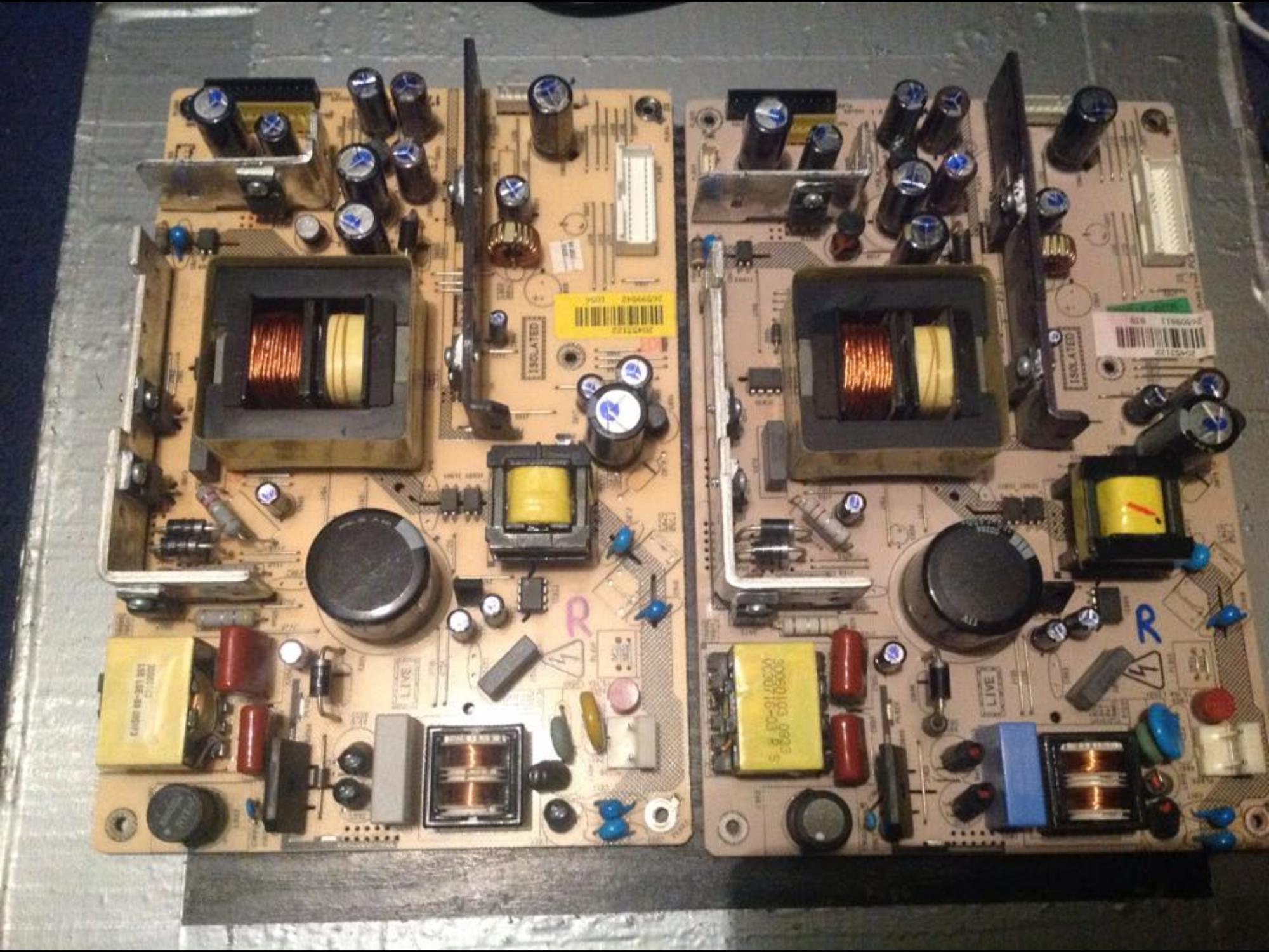

              Another 2 I did a while ago bit better image quality. Both polly caps replaced (not in this image) again as well as output caps apart from that these are good Psu's
