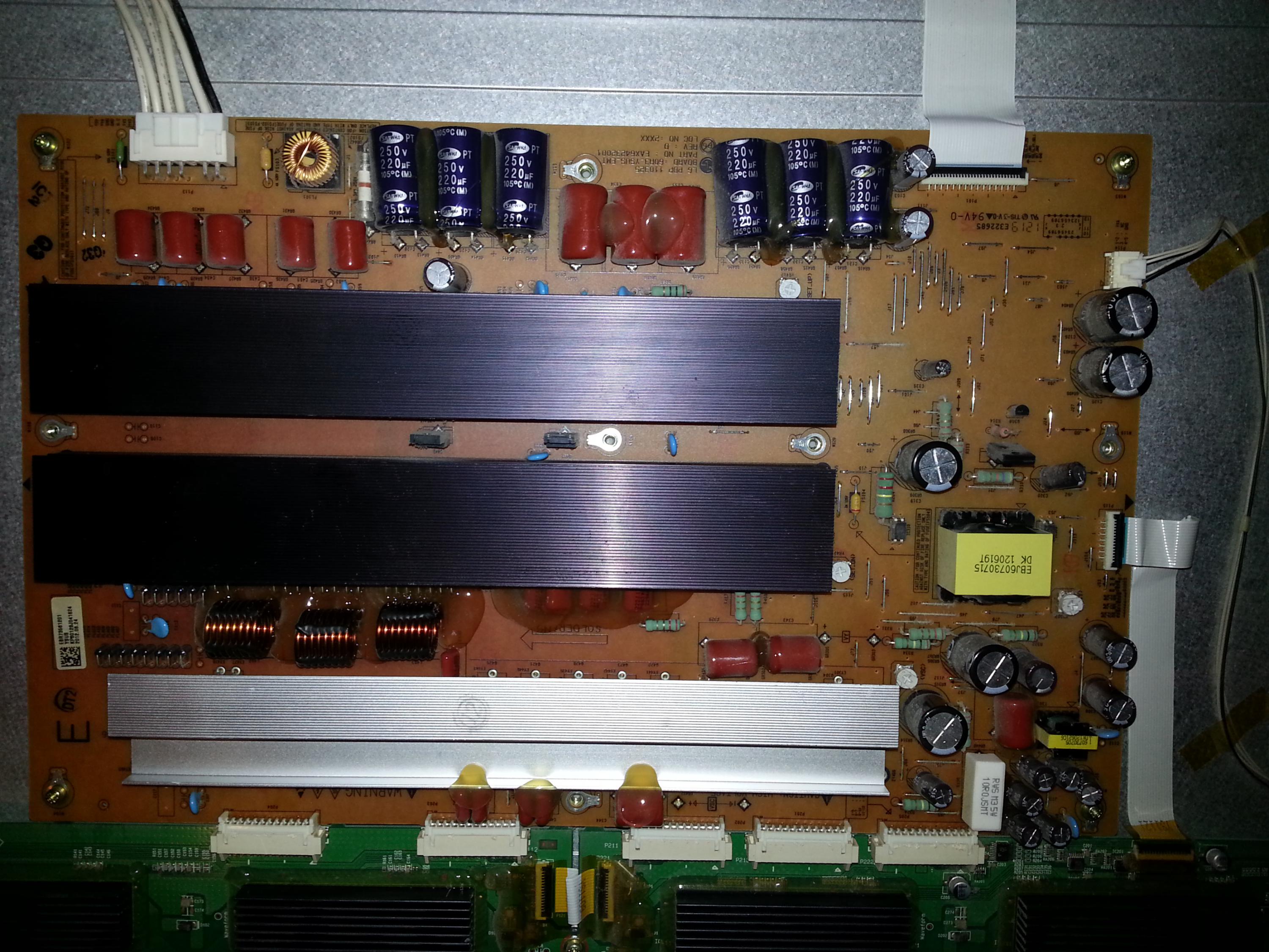

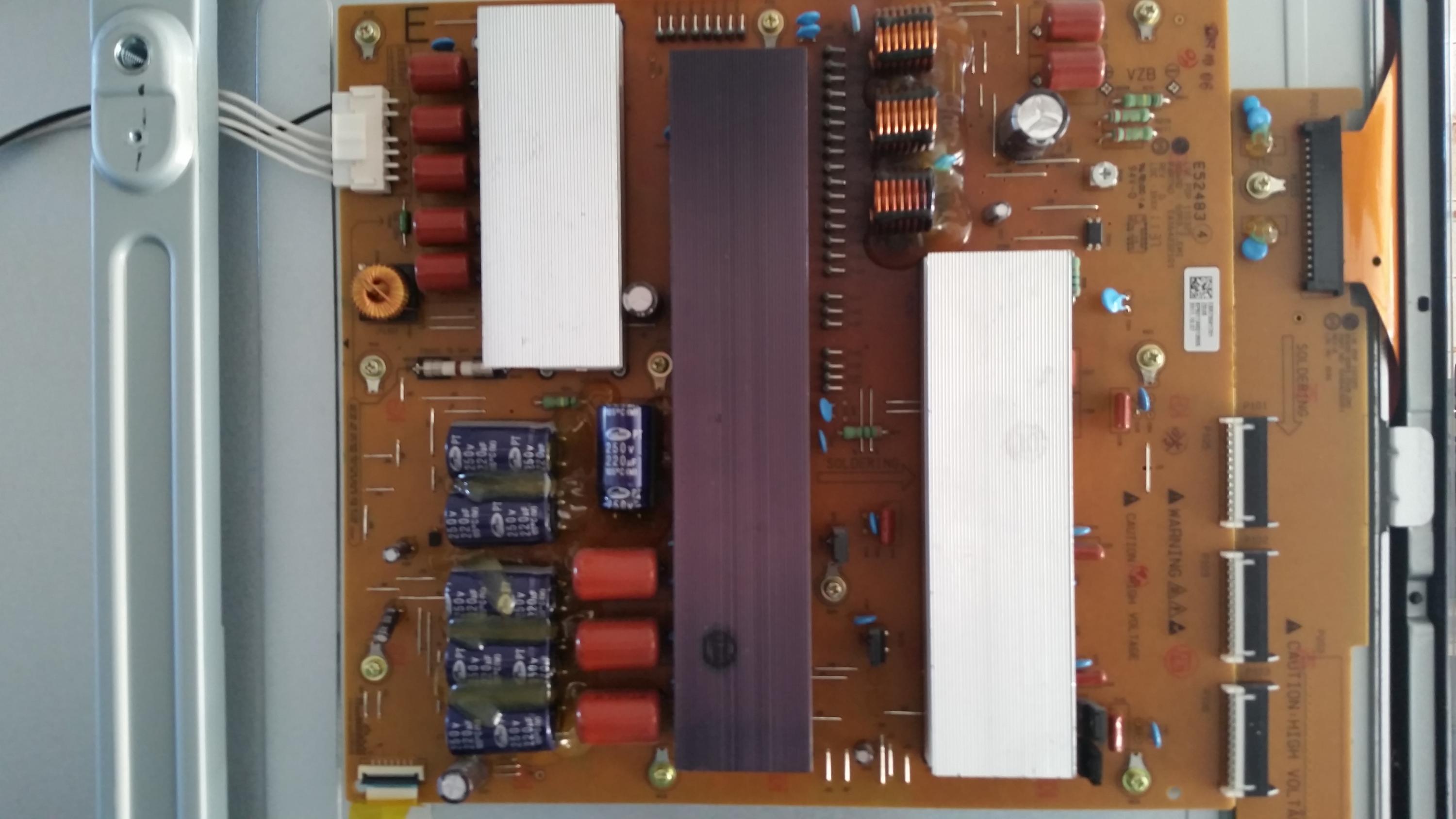

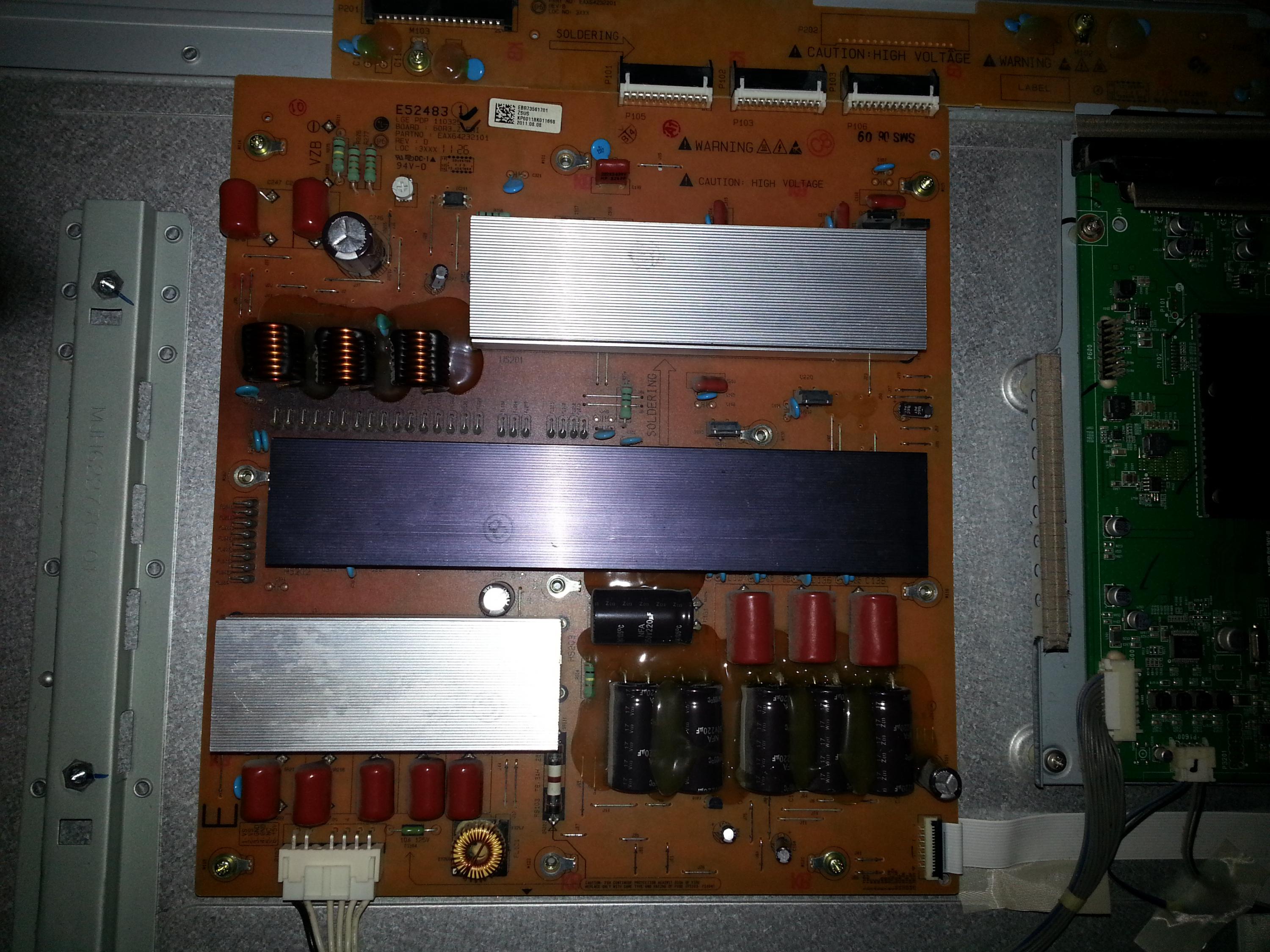

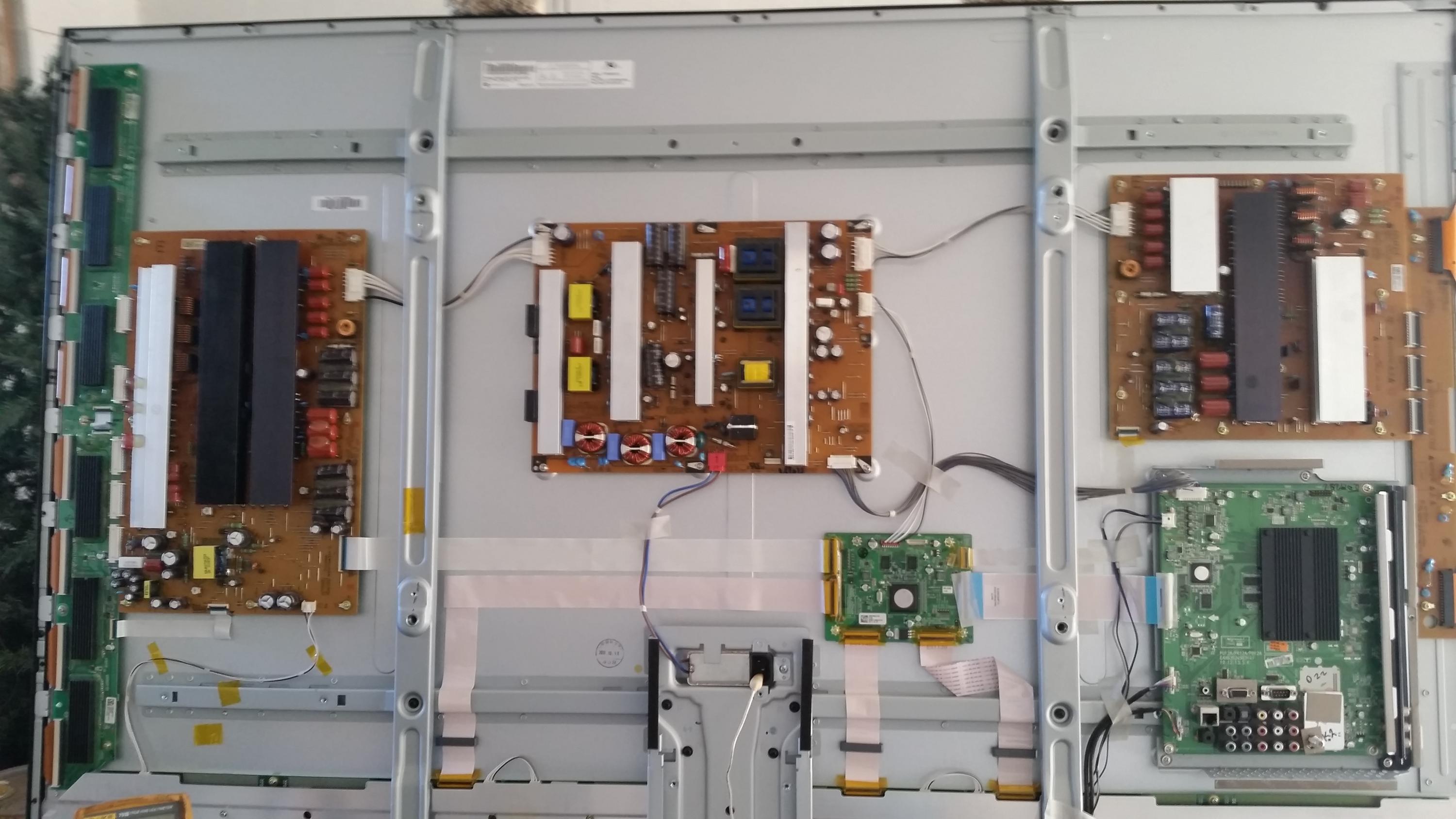

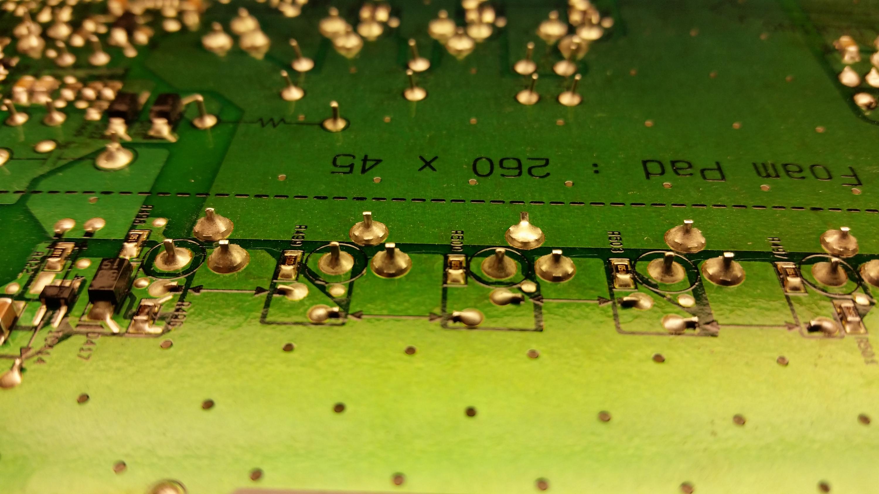

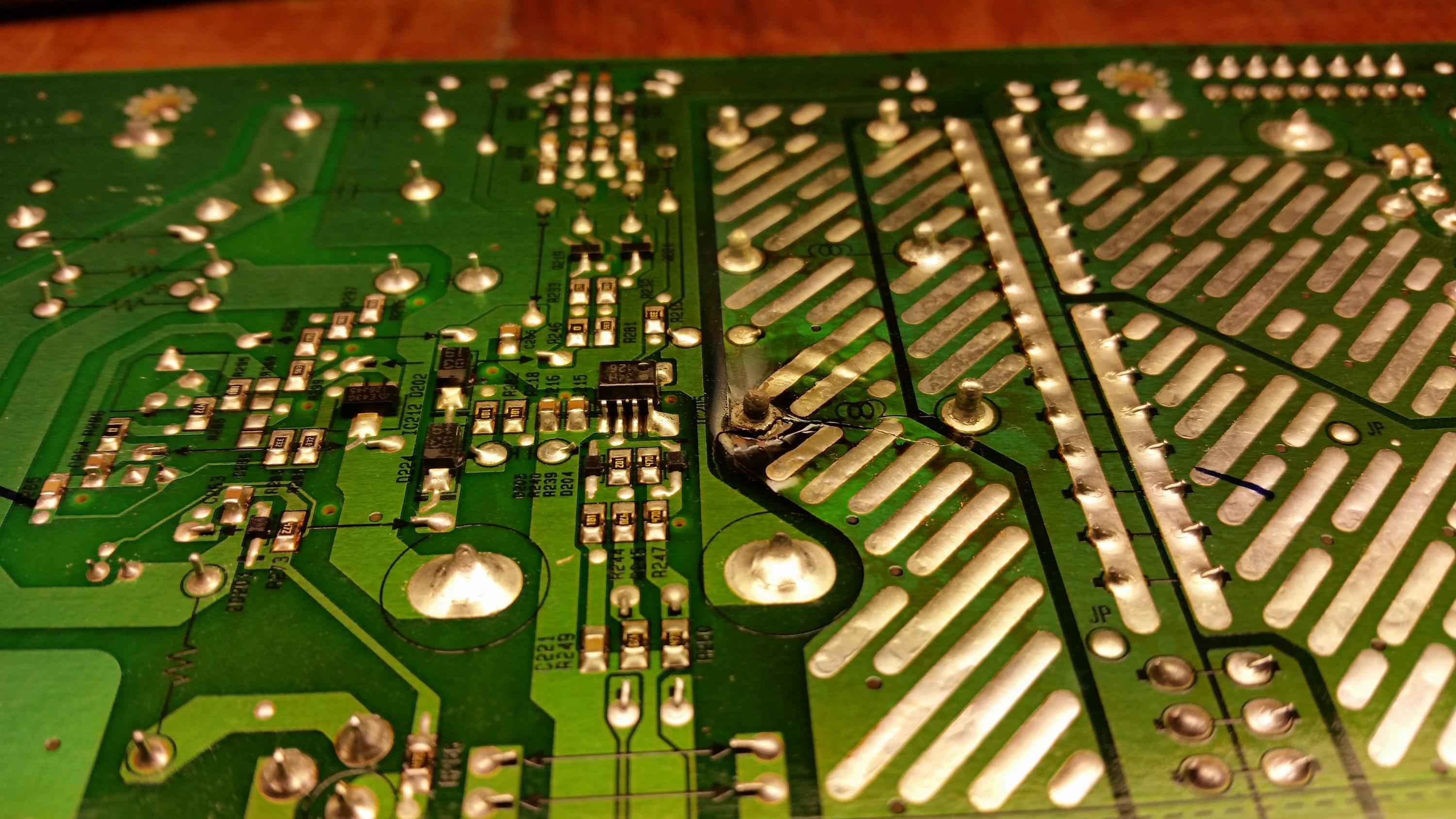

Hello. I have a LG Infinia 60PZ750 . I change the Z-sustain board in my tv and it gives me sound but not picture. I disconnect the Y-sustain board and left the Z-sustain connected and it gave me sound but not picture then I disconnect the Z-sustain and connected back the Y-sus and again it gave me sound but not picture.
I check both fuses in the boards and they seem to be ok unless i am checking them wrong.
Could this be a y-buffer problem?
please help
Thanks in advance
P.s the z-sustain in this picture was the one that got replaced.

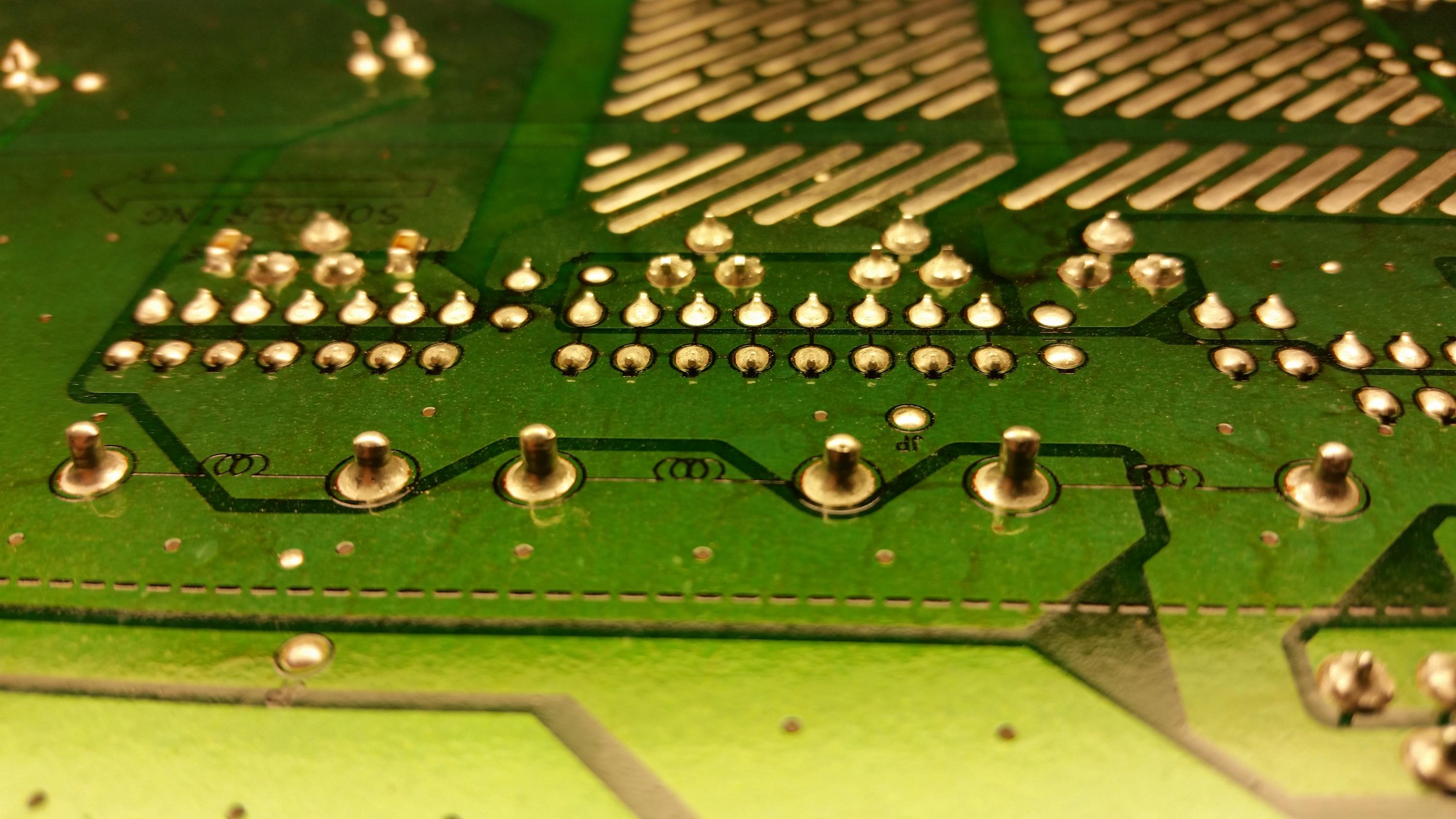

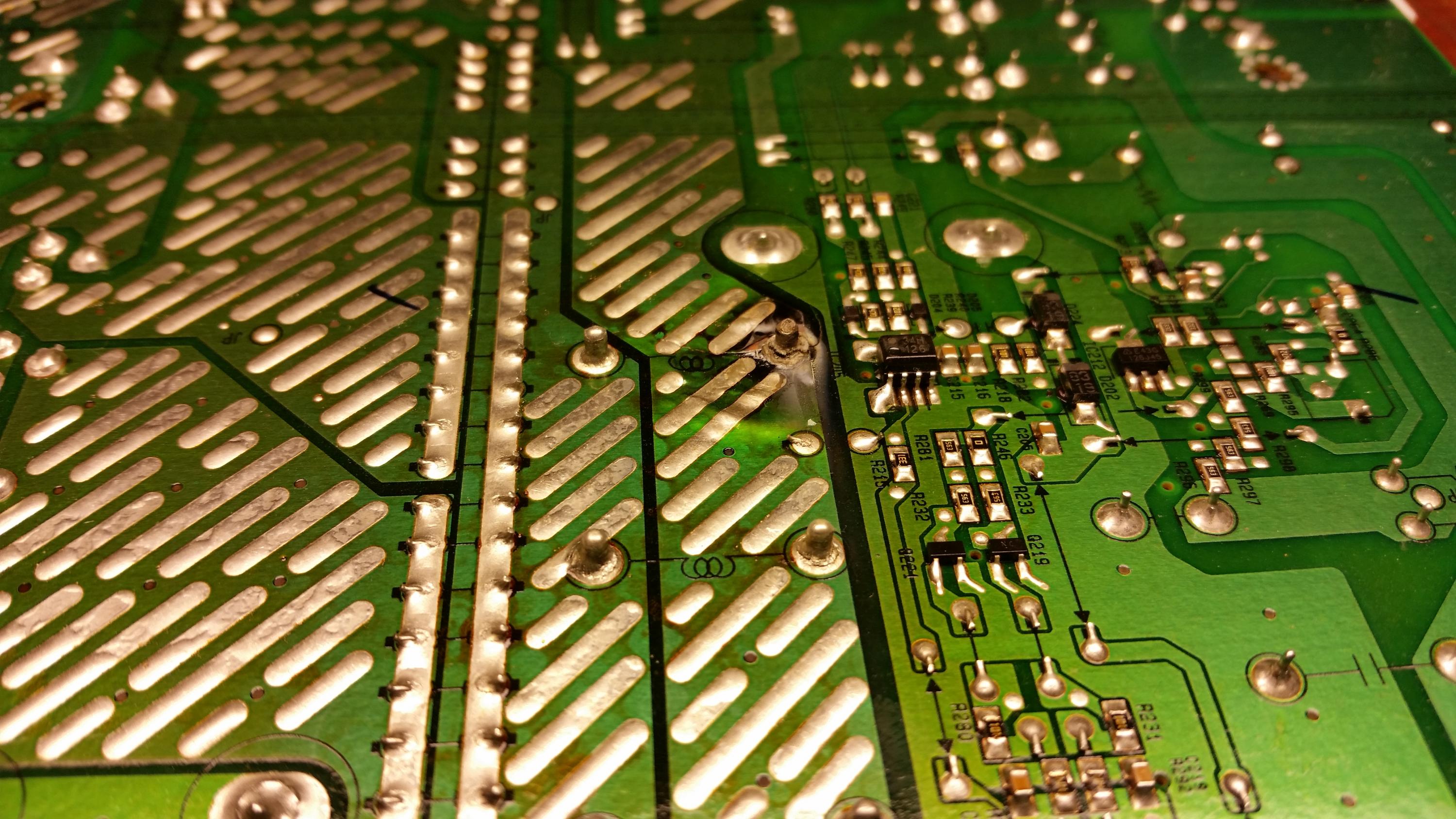

Yes you can use IPA and cleaning swabs to clean the soot off. Also resolder them with alot of freah solder to help prevent future failures. Also take the Ysus out and preform the same repair on it.
