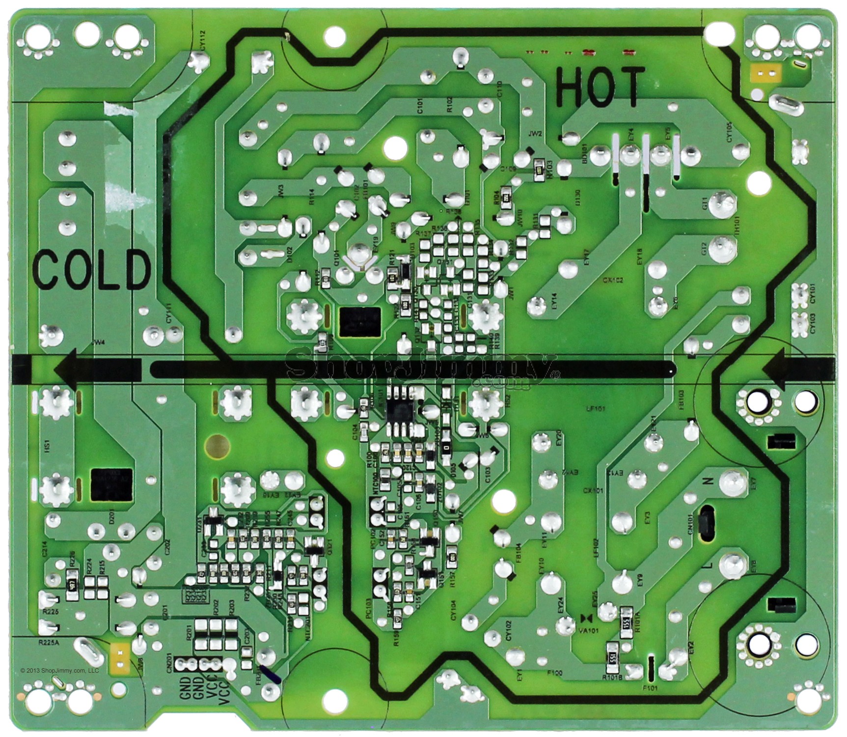

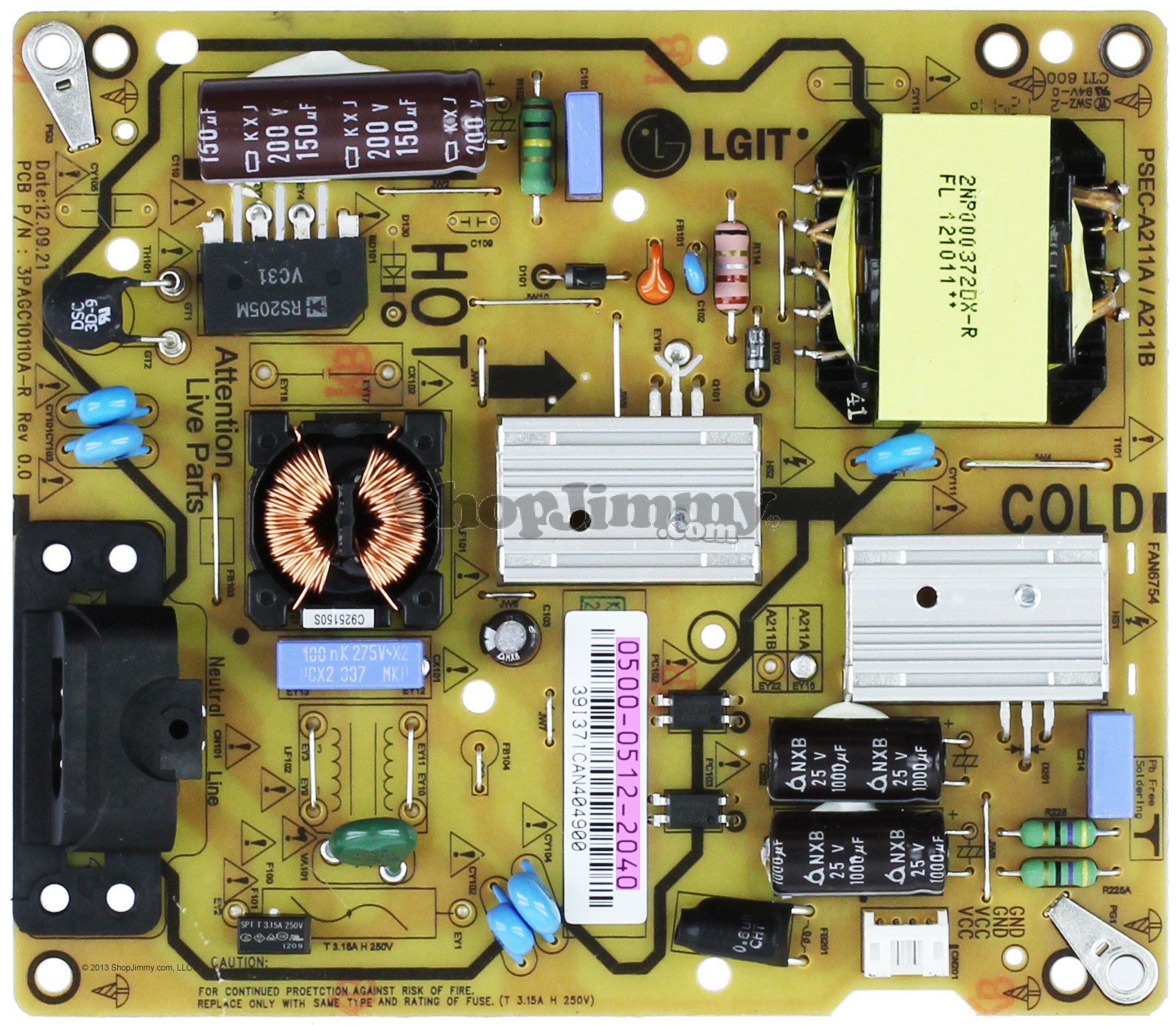

    This is your power supply board?
    http://www.shopjimmy.com/vizio-0500-...upply-unit.htm
    Pictures provided by shopjimmy.
    Yes, you should verify your meter to make it is not giving you false readings.

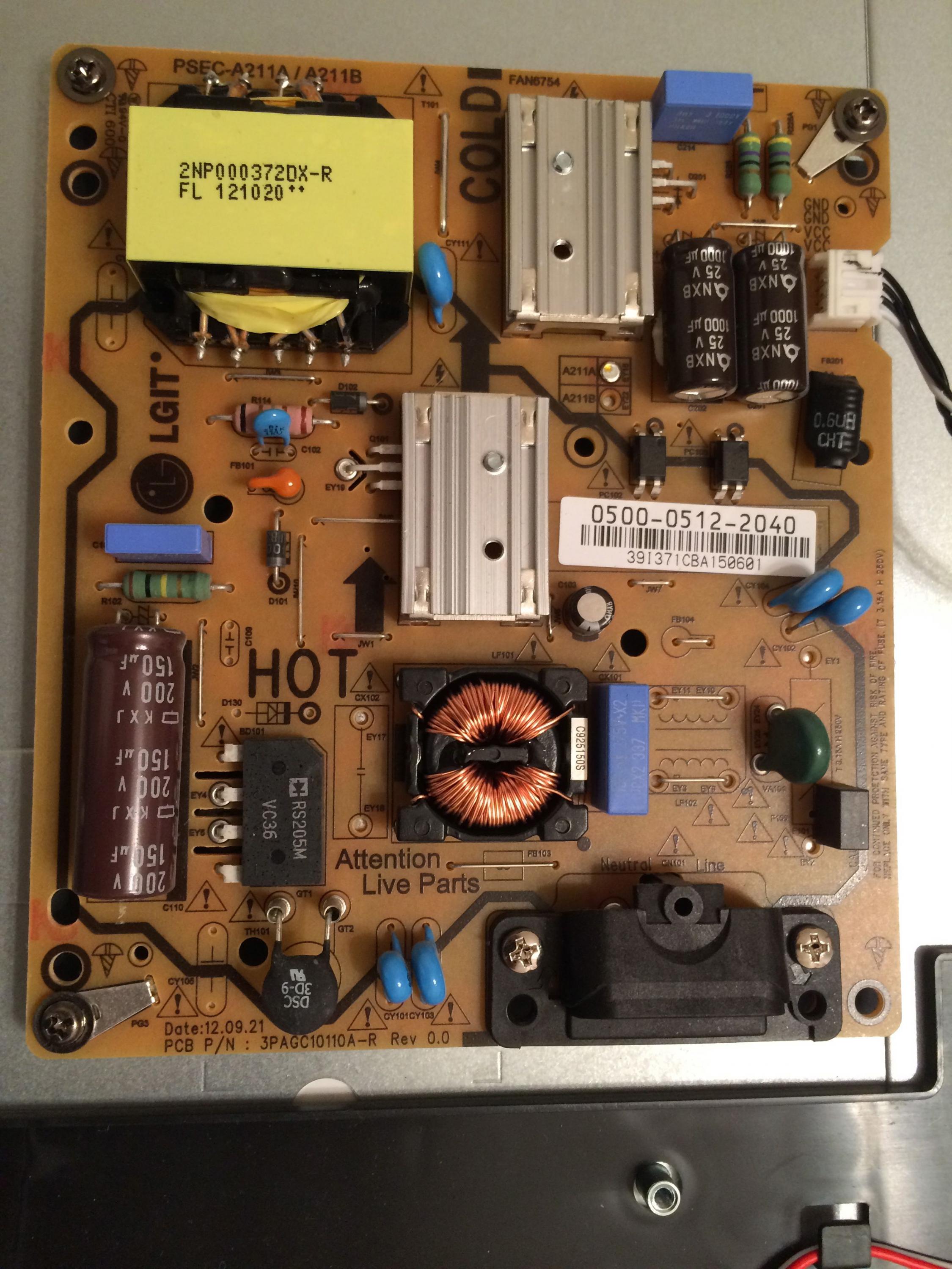

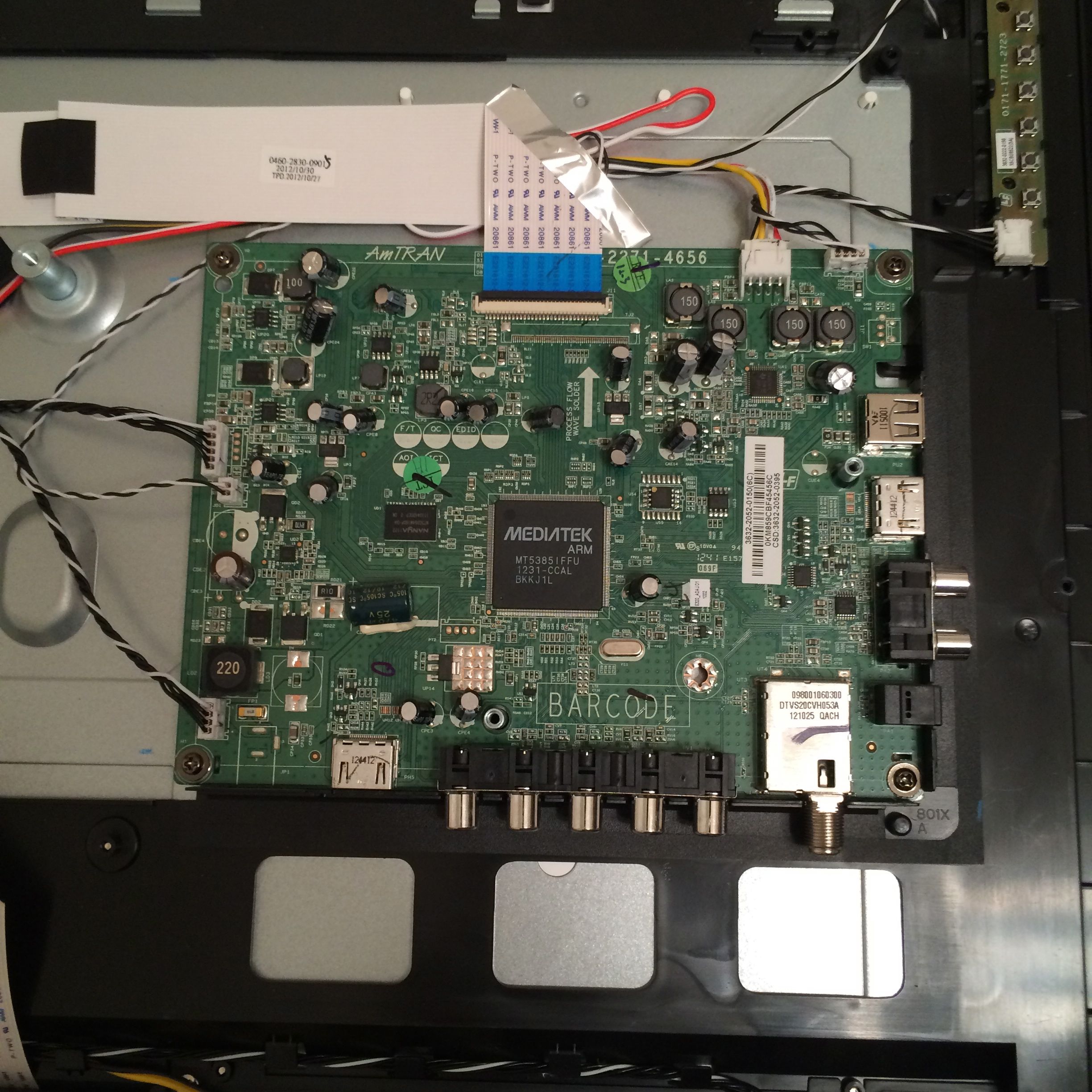

        Here are the photos. Yes that is the power board. The multimeter was spot on measuring the voltage (AC) coming out of the wall. It gave me 9.6 v on a 9 volt battery and 1.6 v on a 1.5 volt AA battery.

          Do you get 24VDC if the cable between the main board is not connected to the power supply.
          The other symptom you have does sound like main board problem.

            If i understand you correctly, you are asking if I still get 19.5 v after disconnecting the cable which runs between the two boards? Yes, I still get 19.5 v with that cable disconnected.
              Re: E320-A0 with near death
              Then you have two problems, if the power supply is supposed to put out 24V and you only getting 19.5V.
              19.5V should be enough to run the main board but may not be enough for the LED driver circuit. So I would try to get the 24VDC back first.
