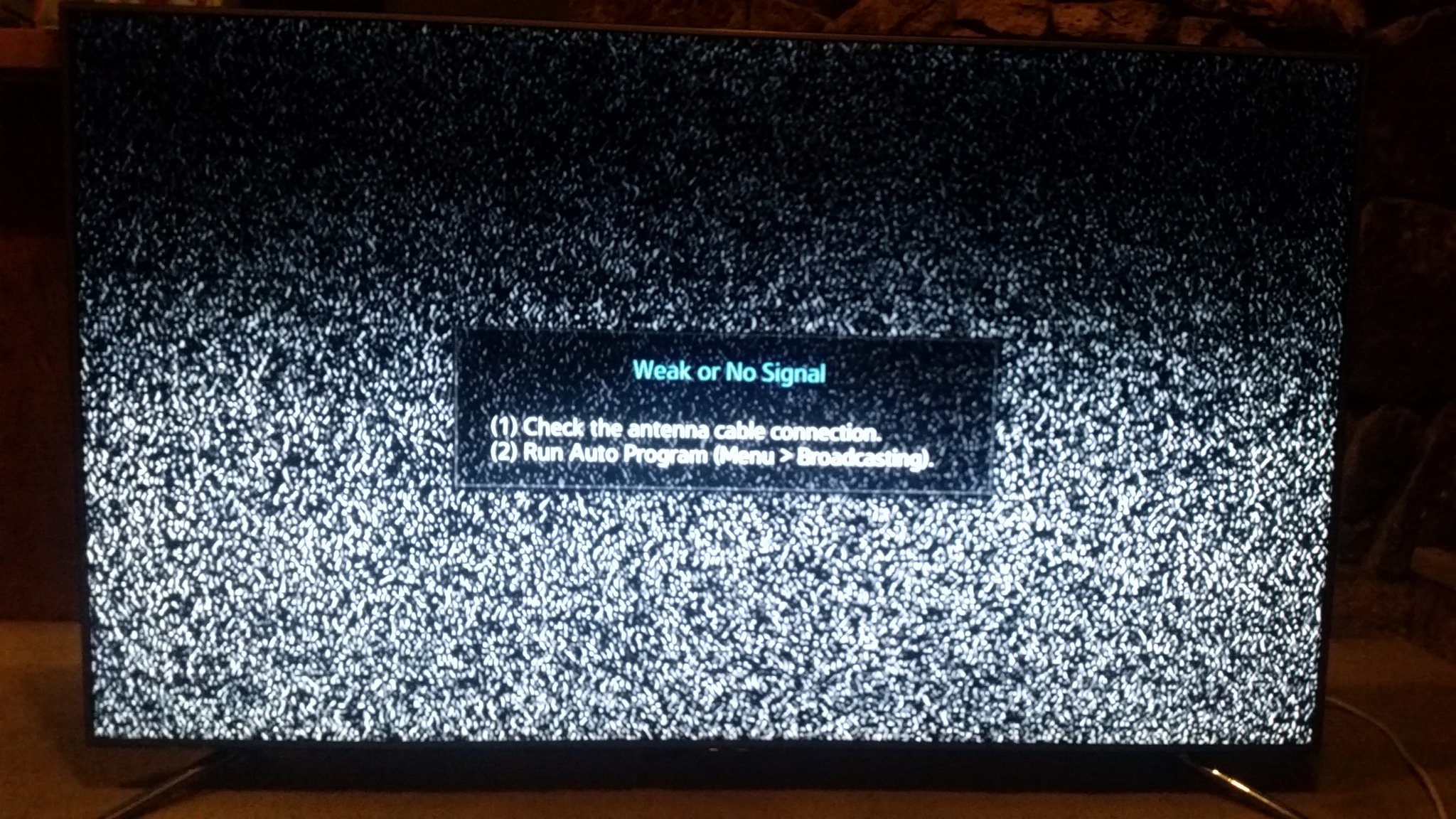

    My tv just developed a dim area on top of the screen
    It is from left to right
    TV is under 2 years old and out of warrenty

    Now this new issue
    Could this be a bad power board?

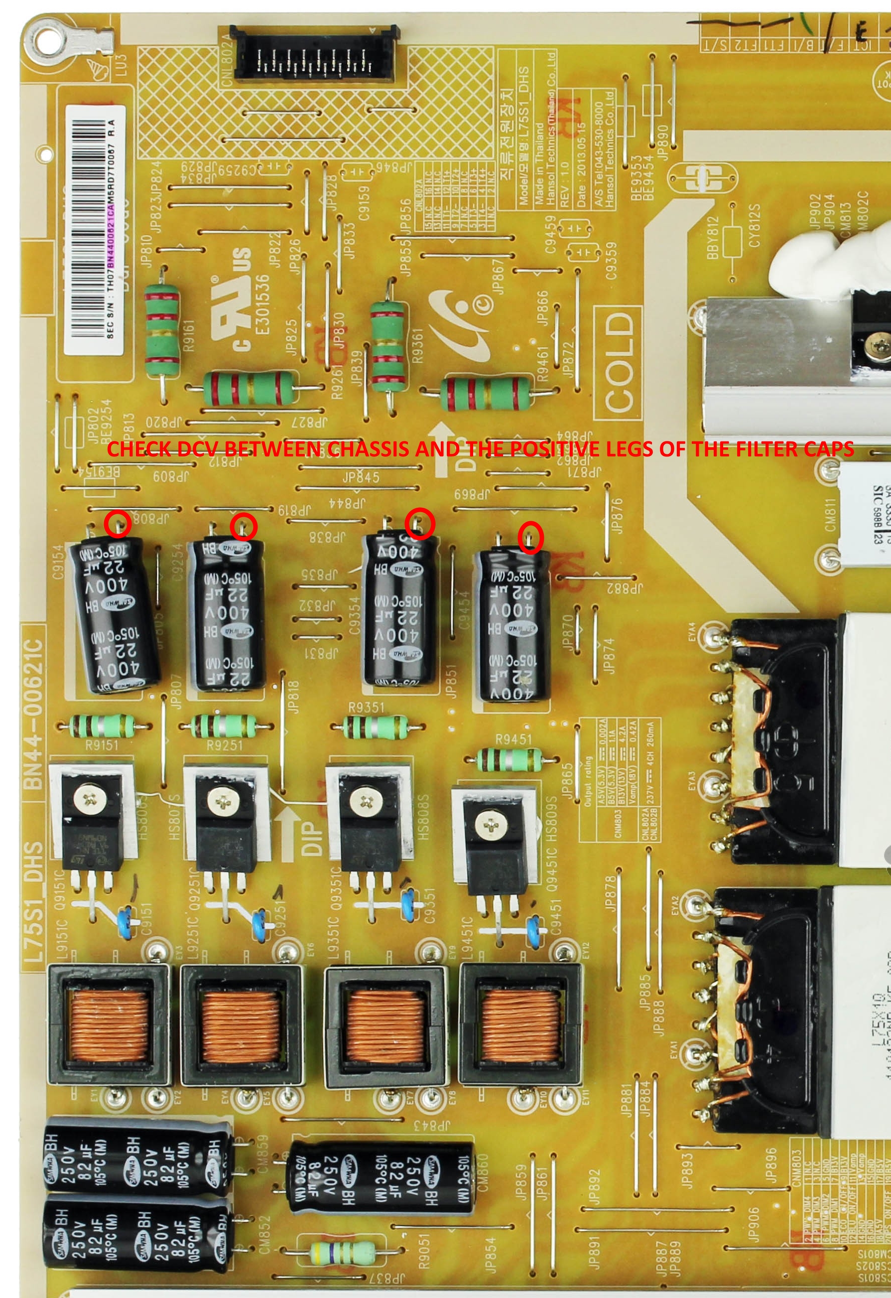

      There are four LED drivers circuits, so check the DCV between chassis GND and the positive leg of each filter caps for the Boost converter circuit to see if they all show the same Voltages.

          Just to confirm
          Remove the rear center cover
          Plug in and test the leg of the capacitors circled in red to ground
          Set meter to DC

            Yes.

                If one or more has higher Voltage than the rest, that will indicate open LED circuits.
                  Re: Samsung 75 LED UN75F6300
                  The top one has higher voltage. 340 to 358 jumps
                  The bottom 3 are steady at 240
                  What does this indicate?
                  Would replacing the power board help?
                  Any futher suggestions?
                    That means there is no load or very light load connected to that C9154 output. So more likely you have LED/LED connection problem in the panel.

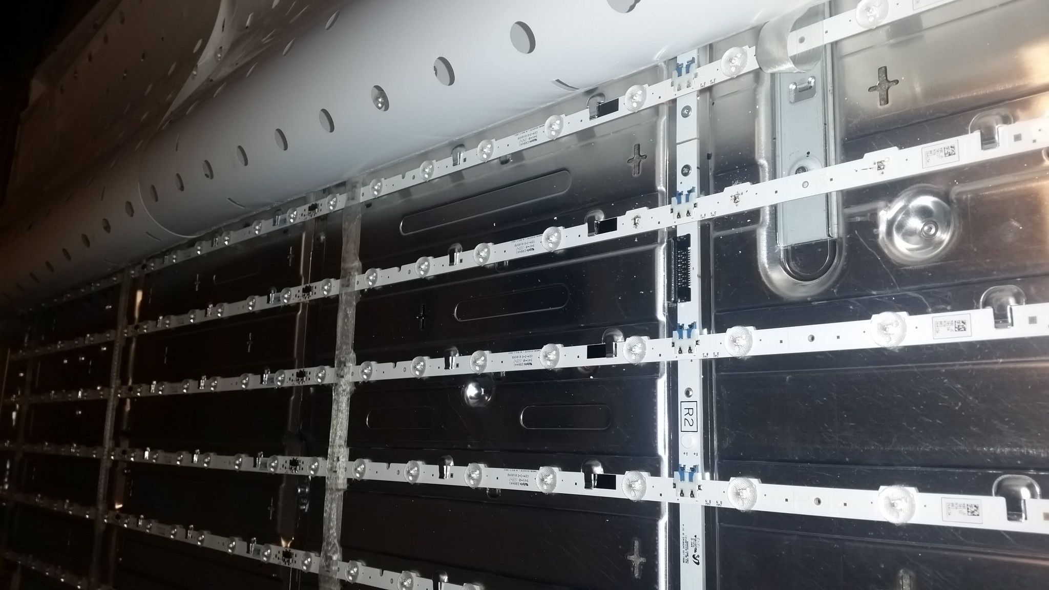

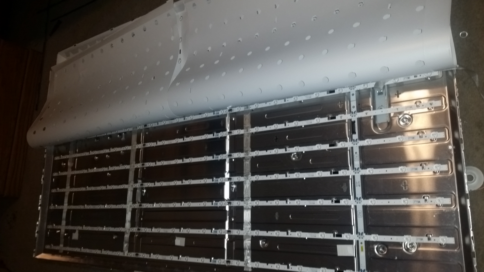

                                  Here are some pics I took
                                  How expensive are the replacement led strips?
                                  This may be something ill have to live with, at least untill it completly fails.
                                  This is discourging, this tv was a major purchase for us. First flat screen I have ever purchased. Learned my lesson. Ill never purchase a samsung product again and whatever I replace it with ill get the extended warranty.
                                  I have an electrician friend at work who is pretty handy with this stuff. ill show him the instructions above and see if he can assist me.
                                  Thanks for the help and suggestions, I really appriciate it.
                                    Hmm, it looks like you can see the nine brown backlights LED strips showing on the back panel of the LCD.

                                      Yes the reviews for my 7100 said it was edge lit also but it is not it is backlit. The louvers on the back side of the metal panel give it away. The backlighting lies within the louvers
