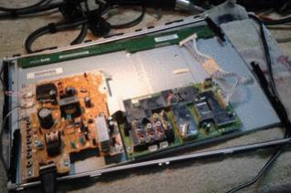

    I have a SANYO DP19640.
    When I turn on it did turned on the back light then in few seconds then off the back light but I can bare to see the LCD screen seem working but no light..

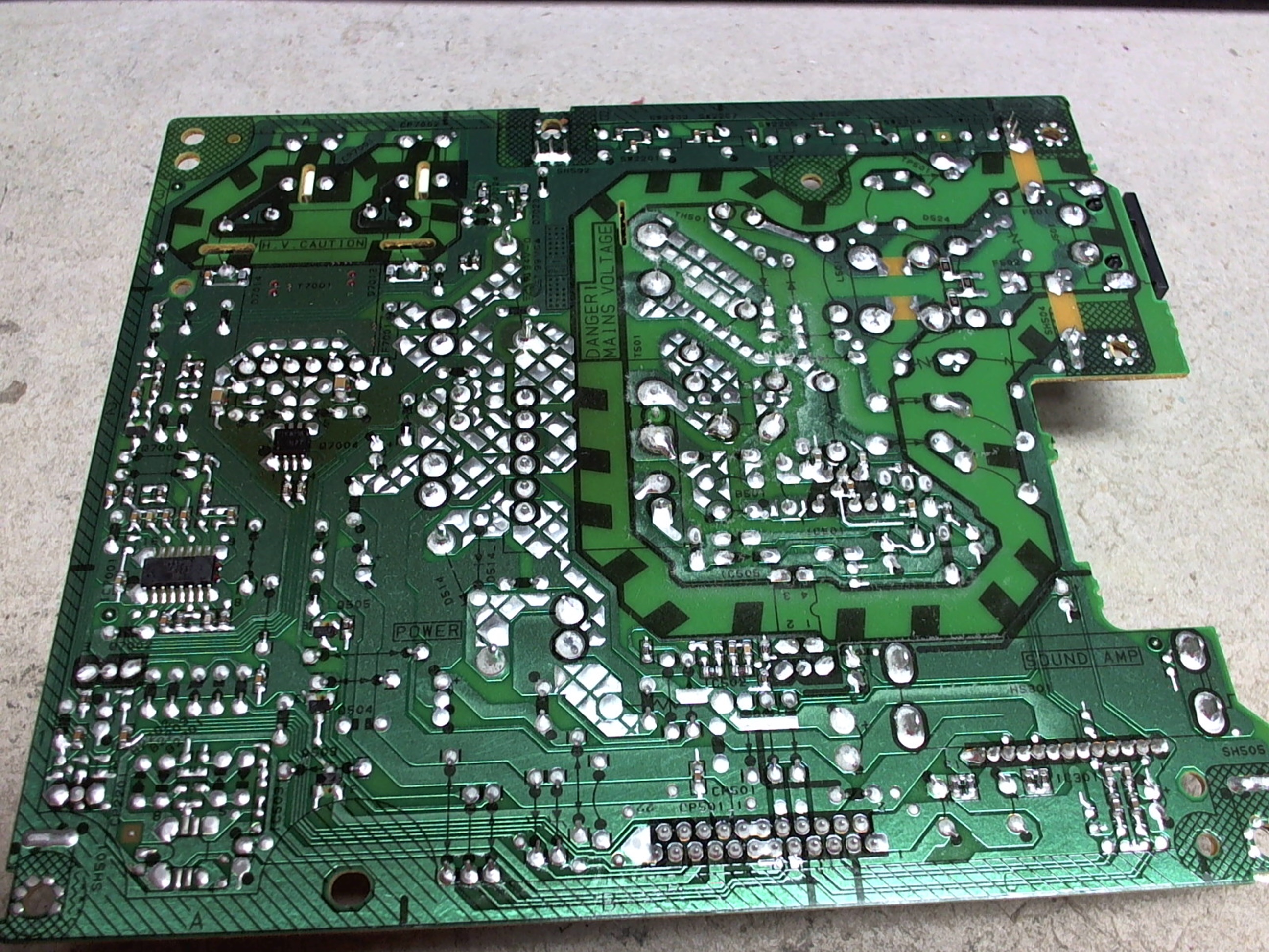

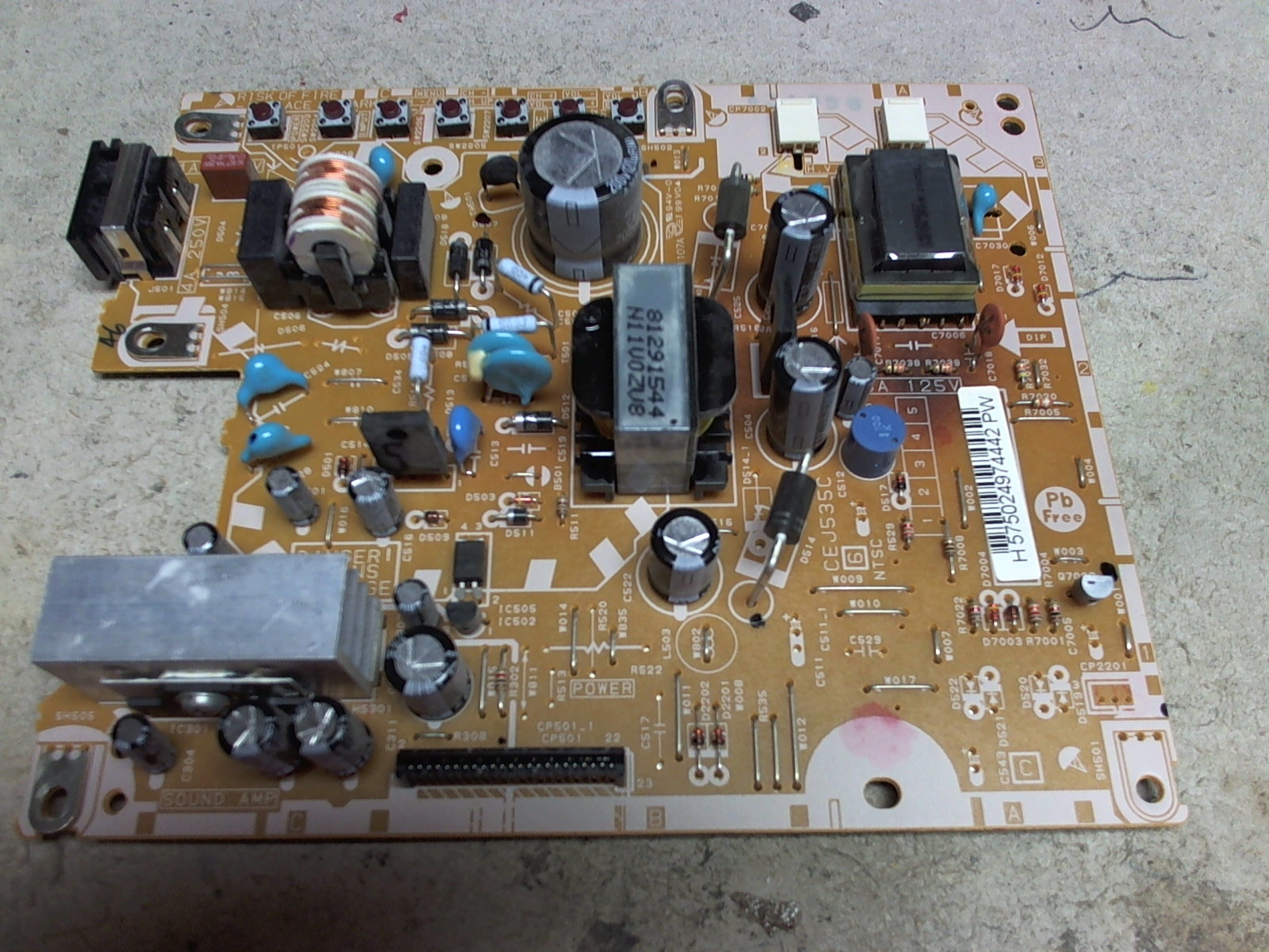

    I opened back panel and I see the board has built in power supply and inverted together.
    See the pictures in attached files.
    I checked all caps are good...

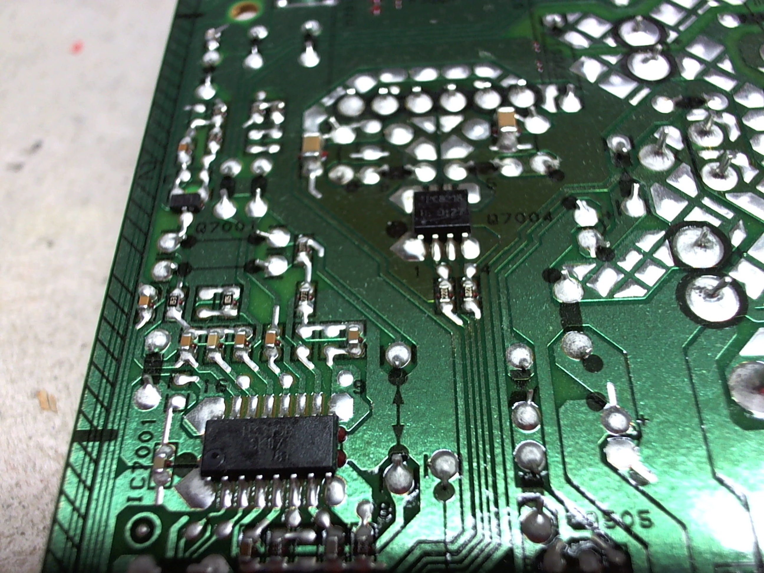

    I suspecting the two chips something.. Q7004 and IC7001
    Any idea where caused the problem with back light? OR anyone have fixed it before?
    thanks!

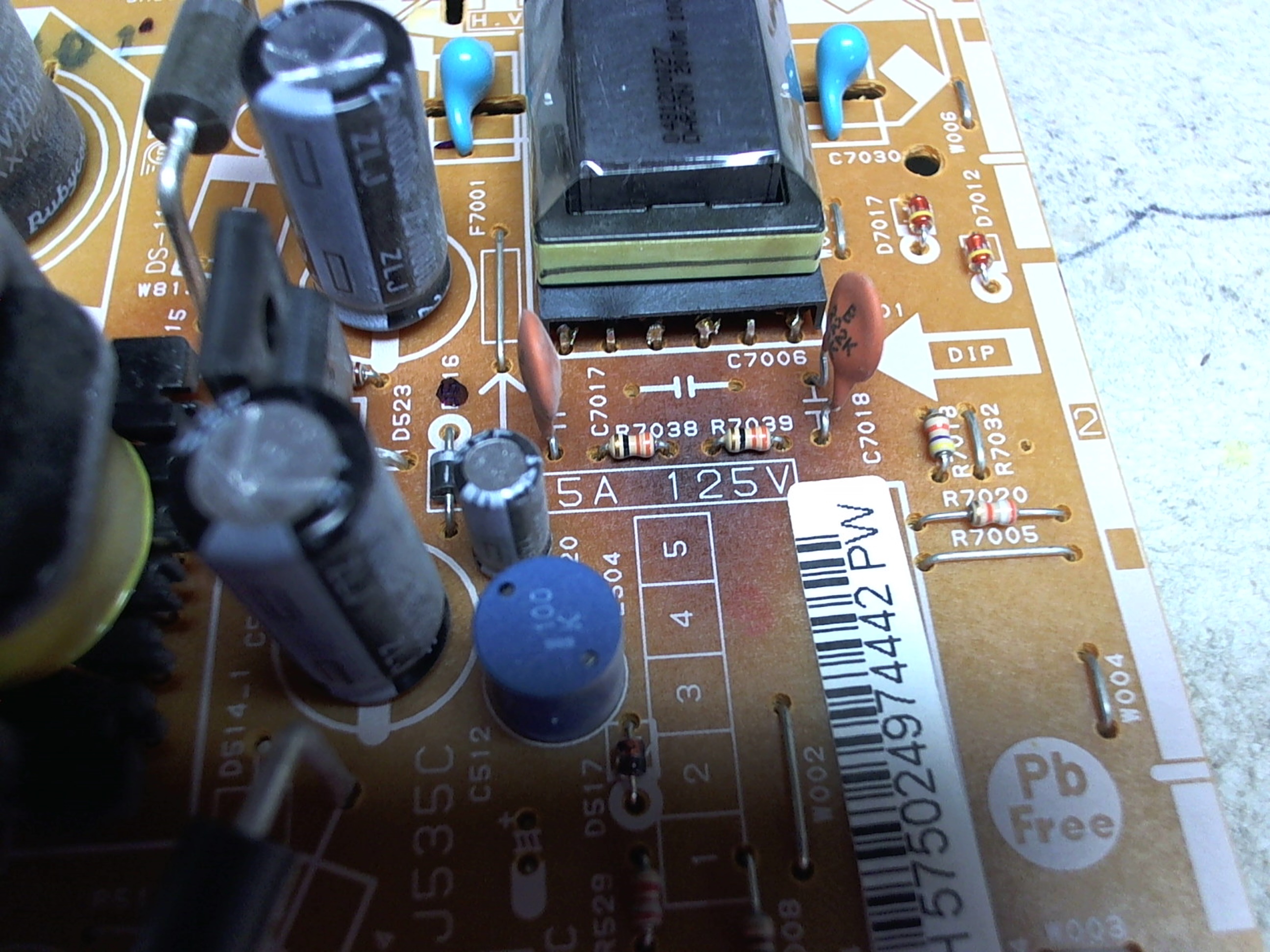

    Re: SANYO DP19640 back light out...
    That MOSFET Q7004 got very hot, did you check the capacitance and ESR of the filter caps? Hopefully the Inverter transformer or the MOSFET is not damaged, you need to get the P/N of Q7004 to check the resistance between Source and Drain.
    If the lamps are worn out they can also cause too much current DRAIN, so there are many things you need to check.
        Did you get the P/N of Q7004? That should be checked first.
        • RAMSELECTRONICS
          ATARI boy
          • Jul 2015
          • 48
          Yup it's TPC8218 H
          Here what I found:
          http://www.aliexpress.com/item/TPC82...339305292.html
            TPC8218 Dual MOSFETs. Check the resistance between Source pins and Drain pins
            • RAMSELECTRONICS
              ATARI boy
              • Jul 2015
              • 48
              I measurement Source and Drain looks like all open.
              Of Course I desoldered the chip to out then measurement
                  Back here again... I got new the Power Supply board from eBay and replaced it. but the issue are the same... uhhhh????
                  I saw on the screen when happening.... When I turned on the power, screen show "Please wait" show red then change to "HDMI" display show red become to white then picture looks great for less 3 seconds then back light shutdown but the green light still on and I hardly to see the screen picture is still there.
                  Possible bad CFL tube light inside the back-light? BUT short time turned on looks perfect??
                  thanks!
