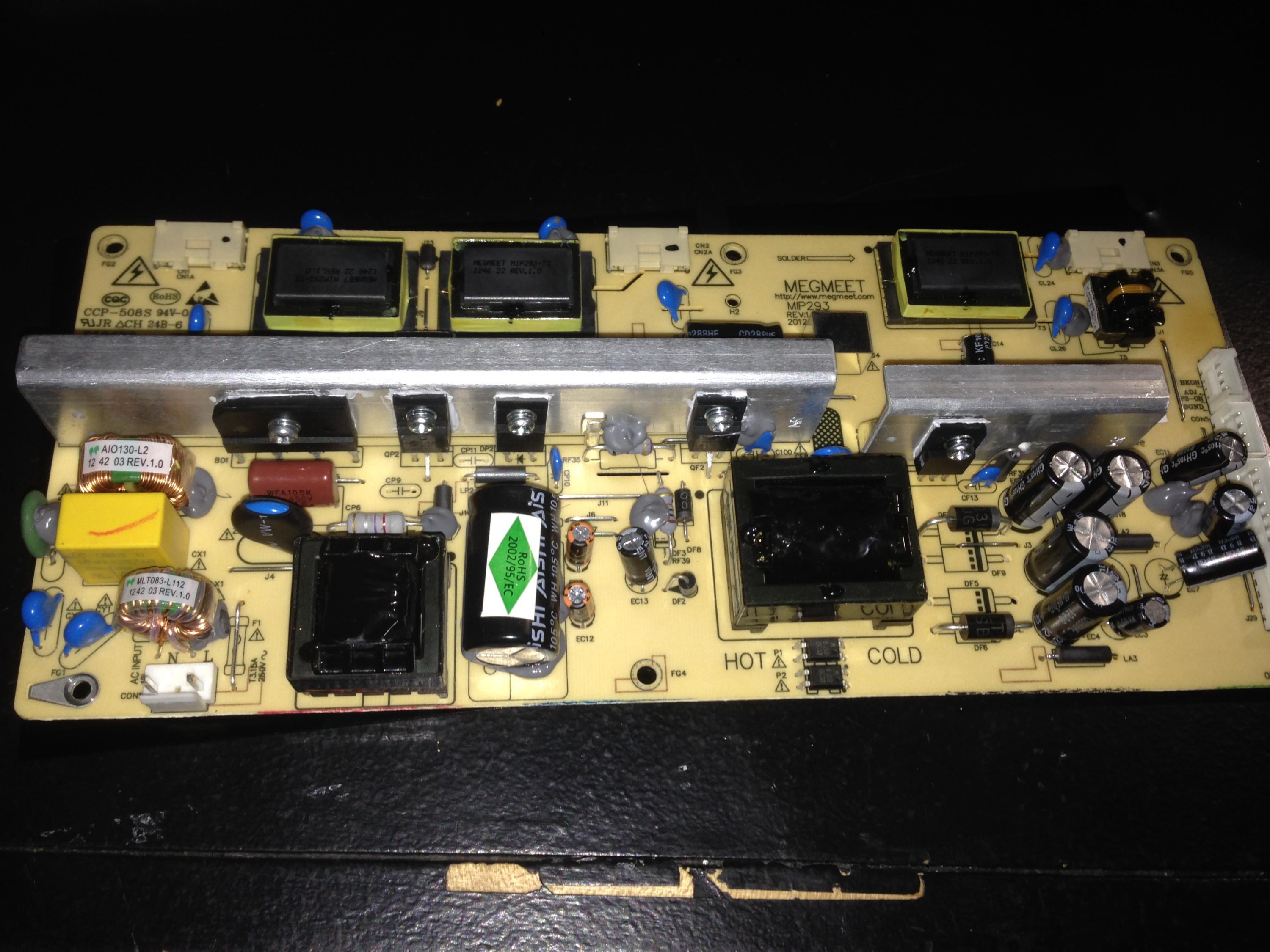

    Hey guys and gals. I have an Insignia NS-29LD120A13 that i got from a friend and it keeps restarting about every 6 and a half seconds or so. Heat doesnt seem to be a facor - i tried the localized blow dryer method and it didn't make any difference. Its always at 6.5 seconds every time. I'm certain that it is a power supply problem because the whole TV powers off completely and restarts but i'm seeing no physical signs. The supply seems hard to find so id prefer to fix it. When its running, the big capacitor on the power side has 325.8 VDC and when the tv restarts, it retains that voltage. Same goes for the audio amplifier and the transisters. Keep in mind that mi'm not sure what these components should actually be running at. It's just acting as if someone unplugged the TV and plugged it back in. Anyone have any thoughts as to what this could be?

      Oh im sorry, i forgot to add the board model. Yes, that is the power supply.
      So... since this post, i have a little backstory. While checking to see where power was lost when the TV restarts, I was checking voltage on the legs of one of the Mosfets. This one had about 70VAC and when i kept it on the legs, the TV actually stayed on. As soon as i took it off, the fuse blew and the mosfet started smoking. So i dont really trust it. I replaced it with one i had hanging around with very similar stats. (I am well aware that this isn't a great idea and don't make a habit of practicing it). I replaced the fuse and the TV turns on now and does the same thing. BUT the filer cap is running at 140Vdc now. I'm assuming that this is because of the component i substituted. I'm not going to leave it on for any extended period of time until i can get the correct one. But to answer your question, It reads 139v when the main board is plugged in and when i unplug it, it goes to about 165v. I don't know if this at least helps you a little. Although the values have been compromised. I'll remove the baord and get some pictures up as well.

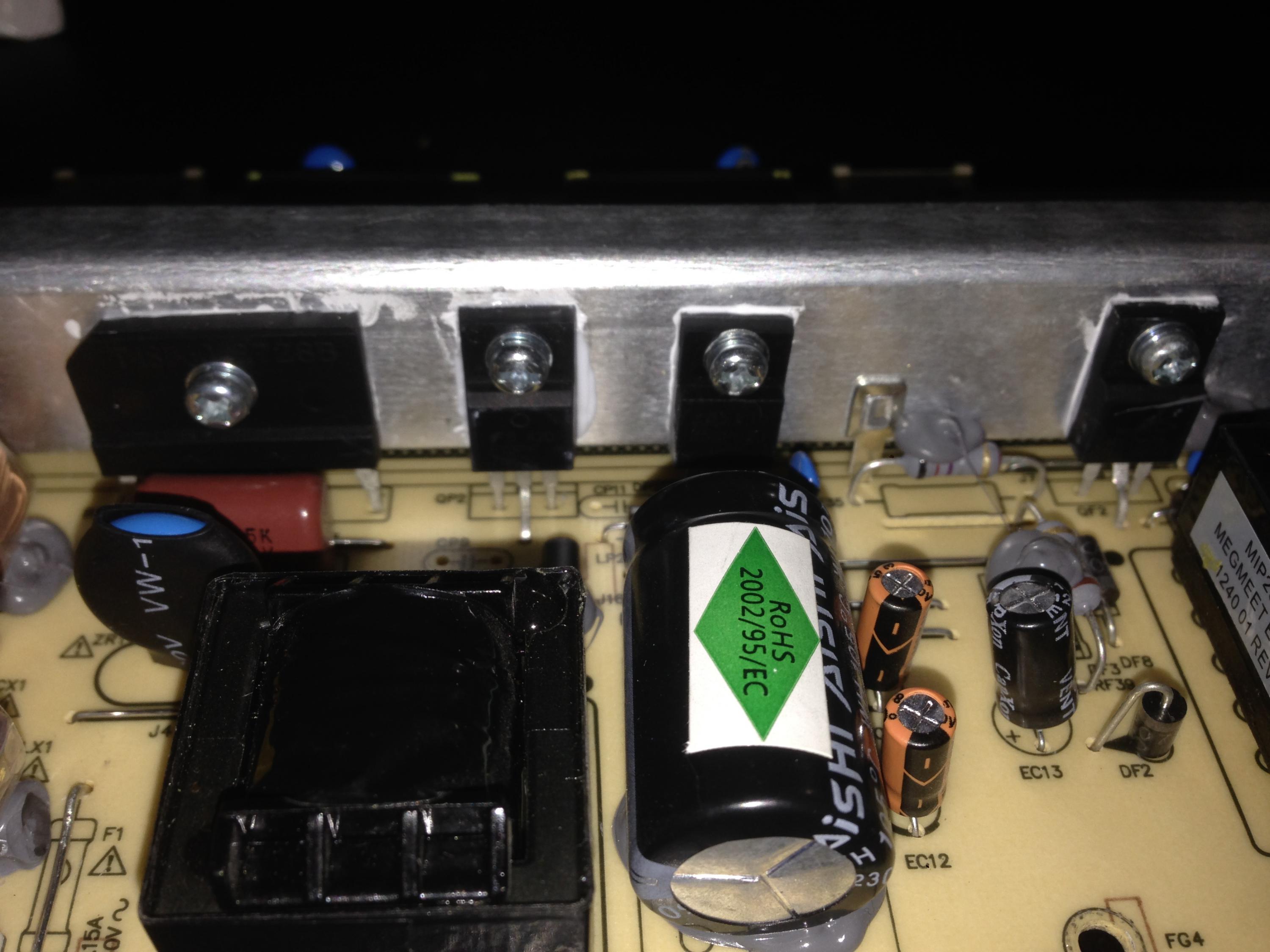

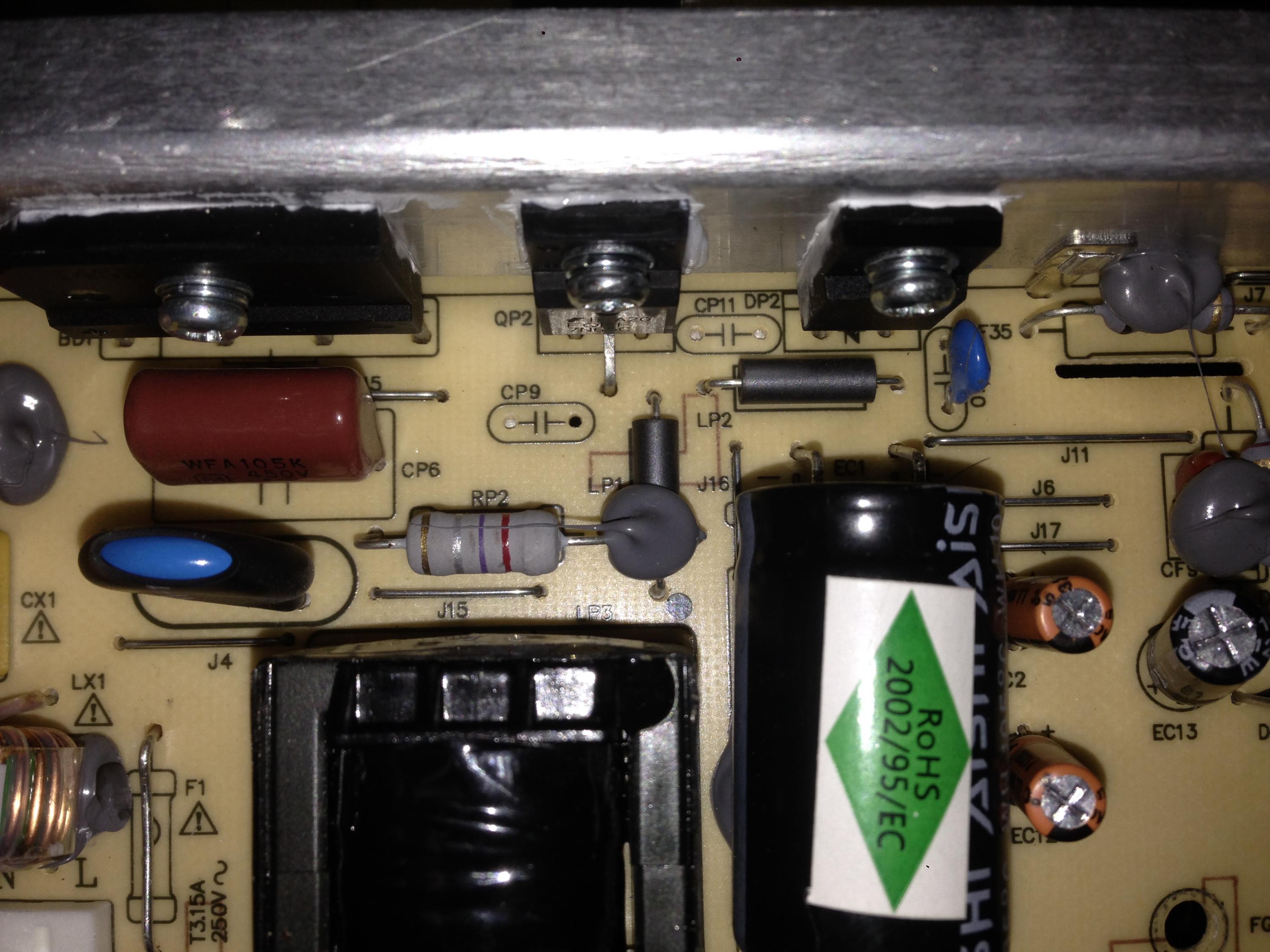

          Here are some pics of the board in question. Not sure exactly what you need some hopefully this helps somewhat. The second one from the left mounted on the heat sink is the one i replaced.
            Re: Insignia NS-29LD120A13 Keeps restarting
            That is the Power MOSFET for the PFC Voltage booster circuit, so more likely the PFC Controller IC is also damaged, also check to see if RP2 is still showing <1 Ohm.
                RP2 is reading .5 Ohms.

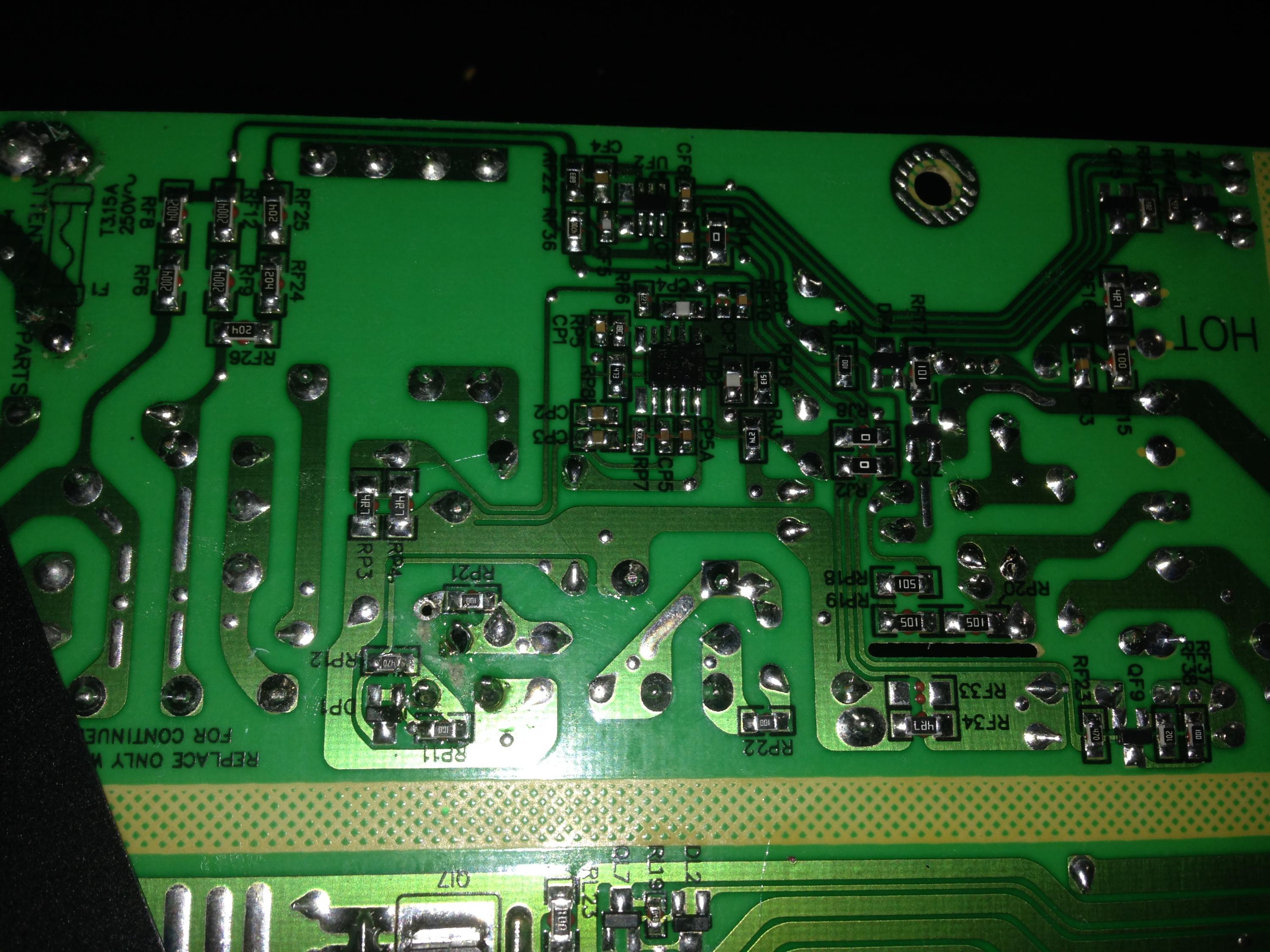

                I see 2 Ics on the hot side on the underneath of the board. Is one of those the one your referring to?
                  When PFC Voltage is too law, it usually due to faulty feedback circuit that is used to maintain the output Voltage, the resistors network in the feedback circuit were probably drifted in values.

                      At this point I would get the new Power MOSFET, the PFC Controller IC, and check that resistor I told you to check.
