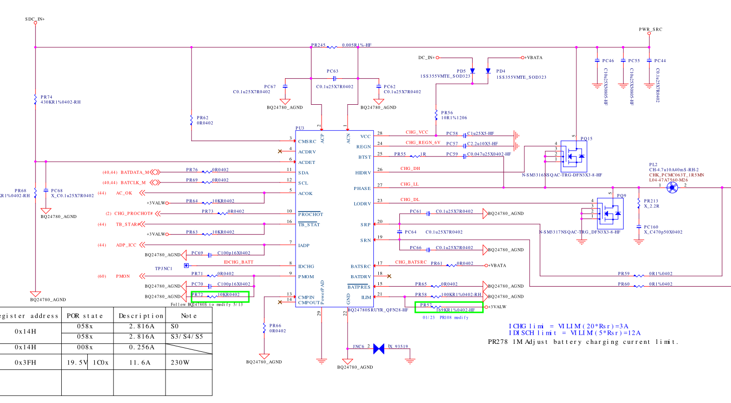

    Laptop MSI model MS-16P5, with installed Windows 10, restarts whenever I connect power supply - within a second or two the laptop restarts.
    (Without a charger the laptop works OK.) Another charger behaves in the same way.
    However when windows starts in SAFE MODE, laptop does NOT restart even with connected charger.
    Stop error log is not generated by Windows.

    Suggest to review the charger IC.
    Attach the power adapter. Meter in DC volts (30V or higher is ok) scale.
    Carefully, measure the voltage to ground of each pin on the charger IC @ PU3.
    Post your readings and their pin numbers.

          It is only a thought but after the normal mode of Windows is loaded, the smbus / I2C bus driver will be operational. It is possible that a defective smbus interconnect is raising the fault.
          Often the charger IC is a root cause so best to review it to at least eliminate this part as a suspect. Symptoms like yours usually lead to a defective mosfet but the mosfet is driven by the charger IC so best to review the charger IC.

                  Remove all power. Meter in diode mode.
                  Check if PD4 and PD5 are ok.

                        i will check all mosfets on powerline from dcin to battery. seems like issue when switch from battery power to charger power

                          It's possible, yes. I agree - first two mosfets and the battfet must be checked too.
                          @Jane - does the laptop work normally when it is only with the charger plugged in (no battery connected)?

                            @ktmmotocross: But how can you explain that the laptop charges when it is OFF or in SAFE mode?
                            @Vesko356:Without battery it restarts too

                              A rechargeable battery can be charged with a dc power supply.
                              A leaky mosfet can supply the voltage to recharge the battery pack.

                                That being the case, it's worth checking the DC IN charging jack - poor contact, cracked soldering etc, also the power adapter itself. This laptop consumes a lot of amps, so poor contact at the DC IN jack or/and faulty power brick can be the cause of such a behavior.
