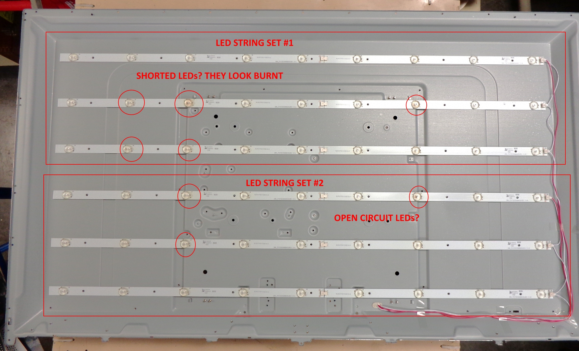

    The set of LEDs that light up probably has shorted LEDs, I can see brownish color on the LED LENS that is why that set lights up.
    The other set of LED that does not light up may have open LEDs.

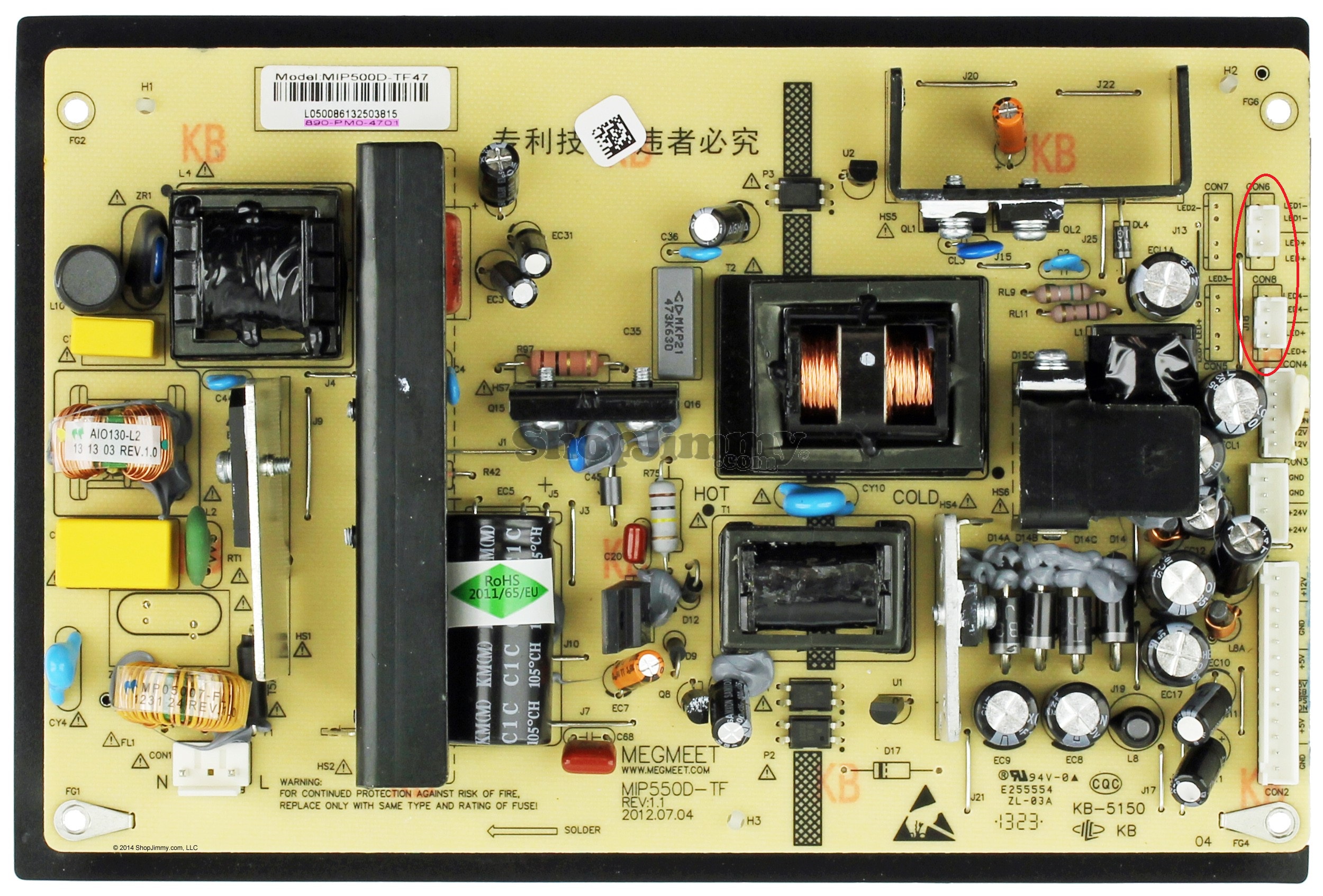

      Re: Seiki SE47FY19 - No backlights
      Sorry, the mystery picture is one of four little supports that keep the center of the screen from sagging in the middle towards the backlights, Kinda like the little thing pizza hut puts in the delivery box to keep the cardboard off the pizza. I broke one of them getting it out to remove the reflector. I guess I will have to glue it back in when the time comes?
      I will try to trace some things around those strips and see if I can find out anything and get back to you. Thanks for all your help.

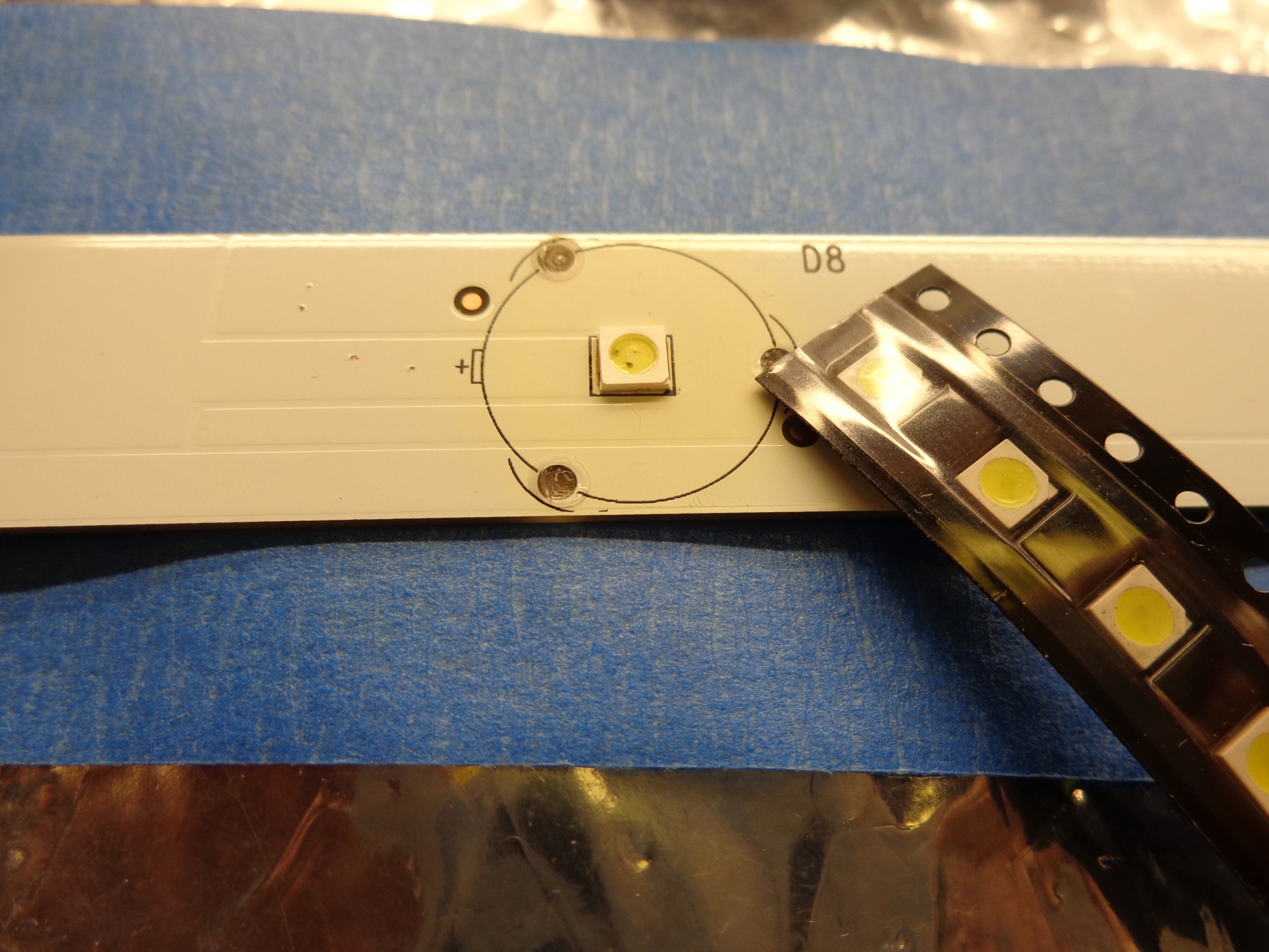

                Man, I have been totally swamped at work and had to set my toys aside for a few months, but wanted to report back. I ended up going with Vishay VLMW51N2P3, PLCC2 Plus LEDs for my 1st attempt at fixing LED strips. They were kind of pricey at $1 each, but if it works out, I will try some cheaper ones next time. I need to practice and refine my methods but I have 1 strip done and I think they are a good match. Problems I have encountered is I am discoloring the surface coating of the strip removing with a heat gun and haven't done much better with a soldering iron so looking for ideas. I have been getting them back on with the use of a small amount of solder paste under the LEDs, but I have many more to do and will get back if I can improve my method. I have enclosed a picture of the old and the new.

                                      I am totally confused. I got a variable DC power supply and set it for 27V and 50mA. Applying the proper polarity to each strip of 9 leds, lit them all fairly brightly. The power supply readings displayed 25.5VDC and 47mA on every strip of 9 so I am assuming that is good? All 6 strips of 9 leds lit up and looked good to me. I went back to using the clamp meter on the wires coming from CON6 and CON8 and readings were again like before, so I cut the white wires to each set of strips. With voltmeter in DC A max 10A I got .671A on the upper set of strings and in 400mA max .04mA on the lower set with the TV supplying the drive (I think the clamp meter couldn't read that low and I misread the initial reading. The upper set of strings (3 strips/27 leds) are very bright and the bottom set barely emit. I went back and changed the top strips to the bottom circuit and vice versus and everything repeated as stated. I must be doing something terribly wrong, but I can't see what. In my humble reasoning the strips are fine?

                                        It seems the overcurrent situation from the power supply may have caused the destruction of the original repaired leds and will soon destroy the replaced strips. If it is the power supply, what should I check which could cause the situation of over current on one string and undercurrent on the other. Or am I completely wrong in my assessment?

                                          As said this is my first attempt with LEDs. Decided to go back to basics and read. Starting to understand Vc, Vf and the use of current limiting resistance in examples with LEDs and physical wiring in example test circuit, but I am unable to relate it to the real world LED strip examples in TVs. I need a slight push in understanding where the current limiting comes to play in a TV. It must be incorporated in each strip or on the power supply/driver circuitry, but I see nothing on the strips. One driver to one set of strings seems to have little current limiting thus I am getting excessive current to that string, the other driver has little current, but if I swap the strings physically to the 2 drive connectors, the over current does not follow the strings which would indicate to me LED problems on those strings. If the current limiting is part of the power supply circuit on the board, it kind of makes sense. I need some enlightenment, then maybe I can fumble through this. Thanks.
