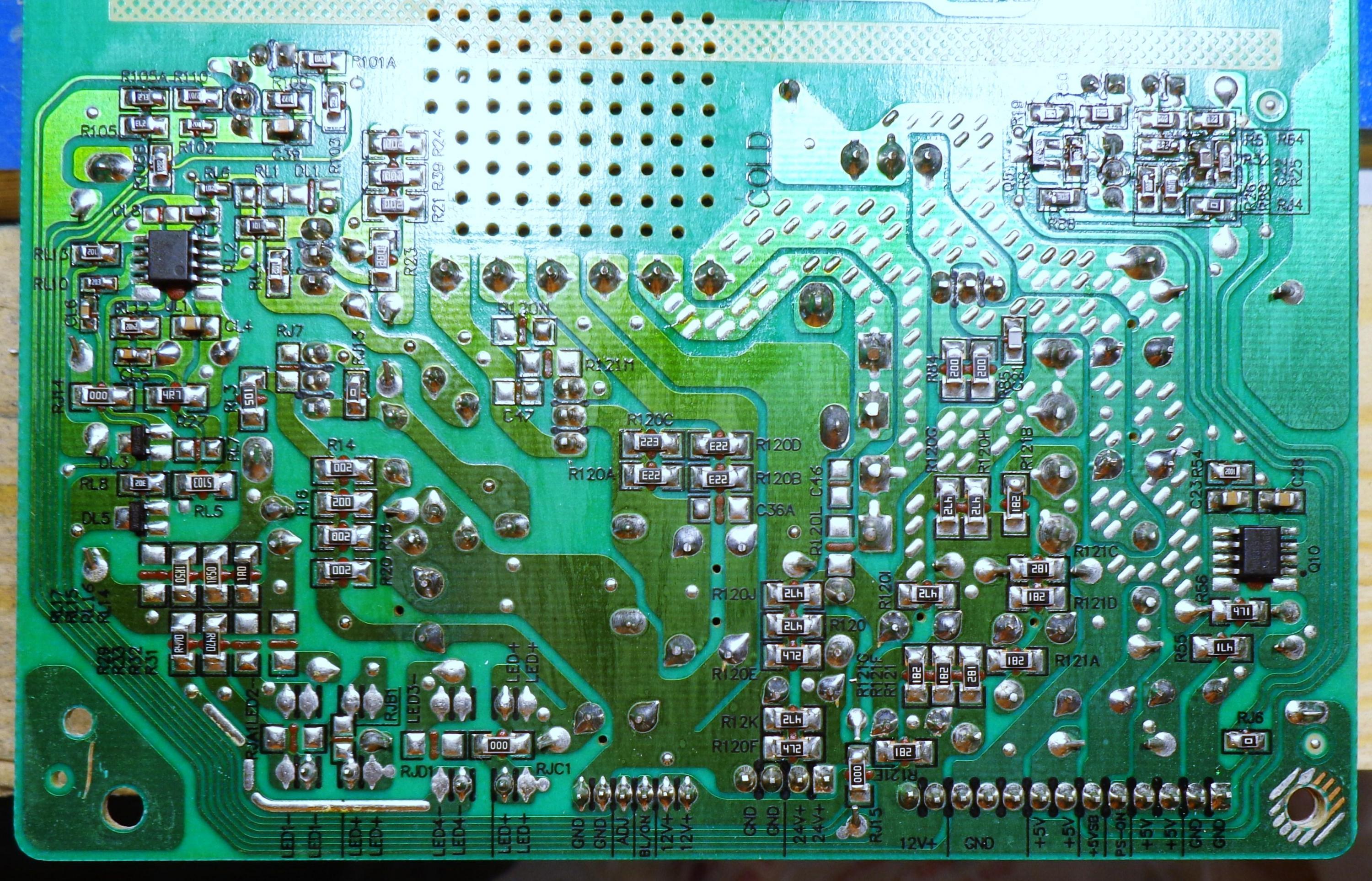

        It could be a board problem if the led driver IC has feedback pins for over current and over voltage to monitor the voltage and current fed back from each led string.
        I would identify the led driver chip and look at its data sheet so that you can compare the two feedback circuits.
        I would also check out the two mosfets QL1 & QL2 which look as though they may be part of the led output stage.

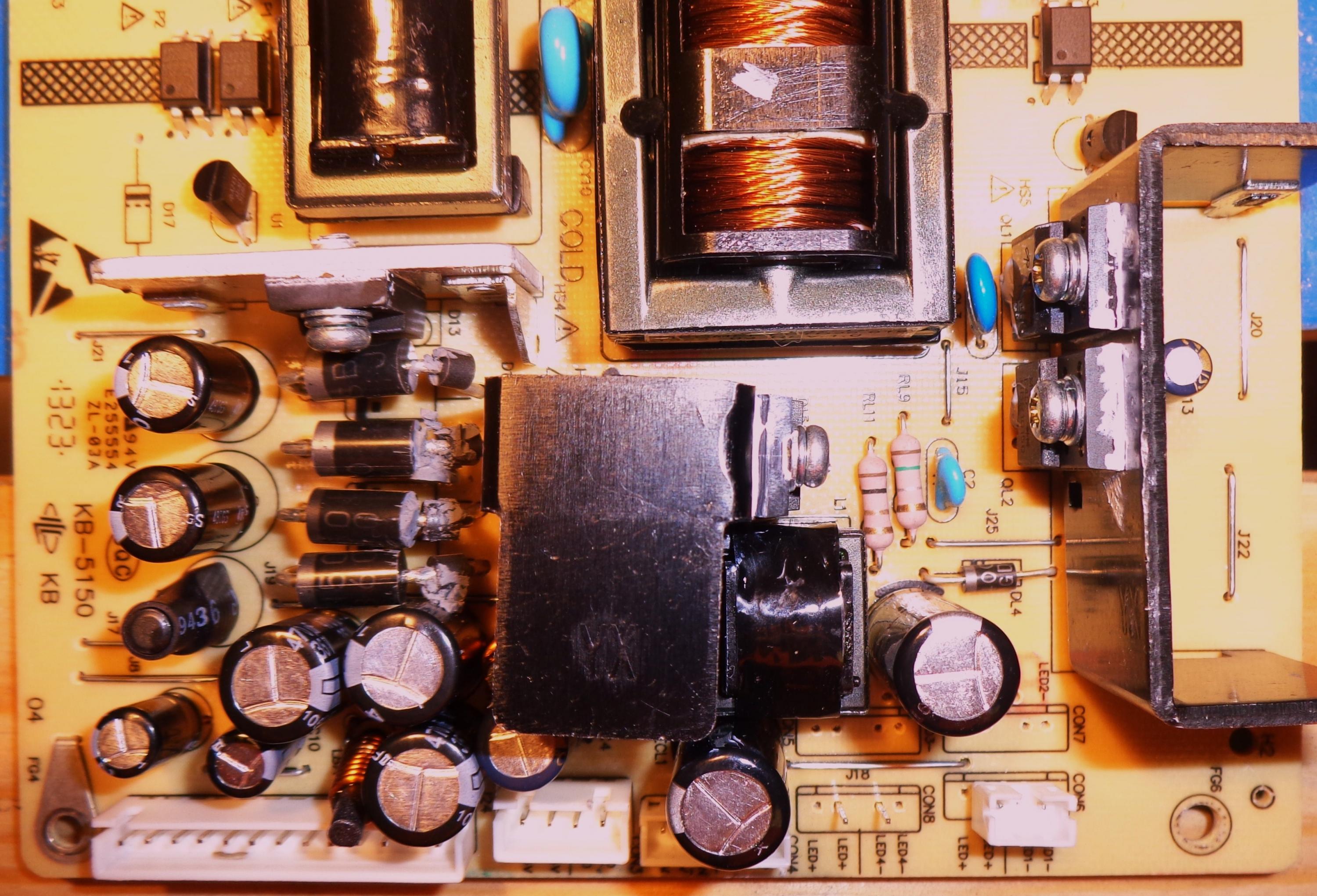

            OK, What I found out:
            QL1 -TF450 N-Channel Mosfet, Alpha&Omega
            QL2 - HBR10150 Schottky Barrier Diode, Jilin
            UL1 - OB3350CP LED Controller, On-Bright
            Datasheets attached. With multimeter QL1 tested no shorts between any pins in circuit, QL2 tested directional like 2 diodes. The LED Controller chip I found, just adds more questions as I expected to see feedback and ouputs for 2 channels (LED strings) but didn't, which further confuses me as to what I am thinking. I can provide more information if directed, but I am about out of ideas on my own. That is why I am here though!

              Looking at the pdf of the led driver it only has one output so it looks as though one output is driving the 2 strings of 27 leds in parallel.
              If this is the case then the voltage applied to both sets of leds is identical.
              Con6 looks as though it has the two Led1- pads connected together and also the two led + pads connected together.
              If there's a difference in brightness between the two led strings then it definitely has to be a led problem since the electronics is common to both led strings.

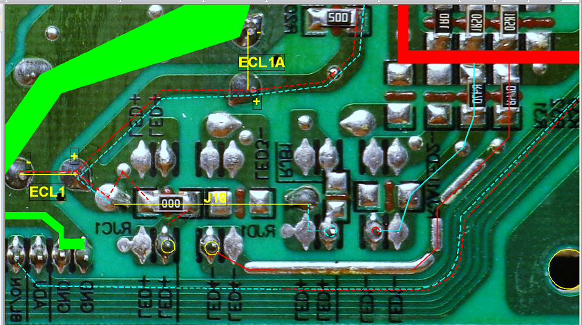

                  I have attempted to attach, if you can view them, a sketch showing how I believe the strings are wired and an image showing the back section of the power board on which I attempted to trace out the circuit previously. There is some shorting of pins on Conn6 and Conn8 but the pins are actually not used on the board in my opinion.
                  I could not locate any additional components on the strings themselves, only connectors and LEDs as shown in the sketch. Am I not sufficiently testing the LEDs/strings cause I still feel they are all good?
                  If you can see on the attachment Conn6 and Conn8 connect to the circuit through a jumper (Conn6) or a no value resistor (Conn8) and the only other difference is through R29 and R33. All other routes are through common components in the single driver circuit I believe.
                  Thanks for your help and I will attempt to supply all the information you request.

                    Have you checked the resistance of all the resistors including the 000 ohms shown in the photo seiki power.bmp ?
                    • MEB
                      • Sep 2013
                      • 371
                      #50
                      Re: Seiki SE47FY19 - No backlights
                      000 resistor checks shorted.
                      There are the 2 resistors marked R470 that I think are supposed to be .47 ohms. One goes between Conn6 and drive circuit, and ones goes between Conn8 and drive circuit. The Conn6 resistor reads .9 ohms and the Conn8 reads open. This surely must be a clue! I will await your instructions, but am prepared to extract and read out of circuit. These reading were all with the board totally disconnected from the unit.

                        I think it's best to lift them carefully. The resistor marked 000 is just a short circuit of 0 ohms so if it is open that is a real fault. The other two marked R470 I believe are 0.470 ohm resistors. If they don't read that when lifted then change them. I suspect they limit the led current in each of the strips.

                          I removed both of the R470 marked resistors from the board and they checked same as in circuit, open and .9 ohms. I have ordered some and will get back in a few days. Will I just fire it up with the strings reconnected or is there a gentler approach? Thanks again for your help.

                                  Ok, received and installed the current sense resistors, R29 and R33. Replaced strips and all 54 LEDs now light with equal intensity! I had previously opened each string's wiring to measure current and now am reading .338 and .328A in each string. They are burning brightly. Ran them just long enough to make readings. Is that too much current or am I measuring incorrectly? It seems rather high to me. Am totally excited and thank you for getting me this far.
