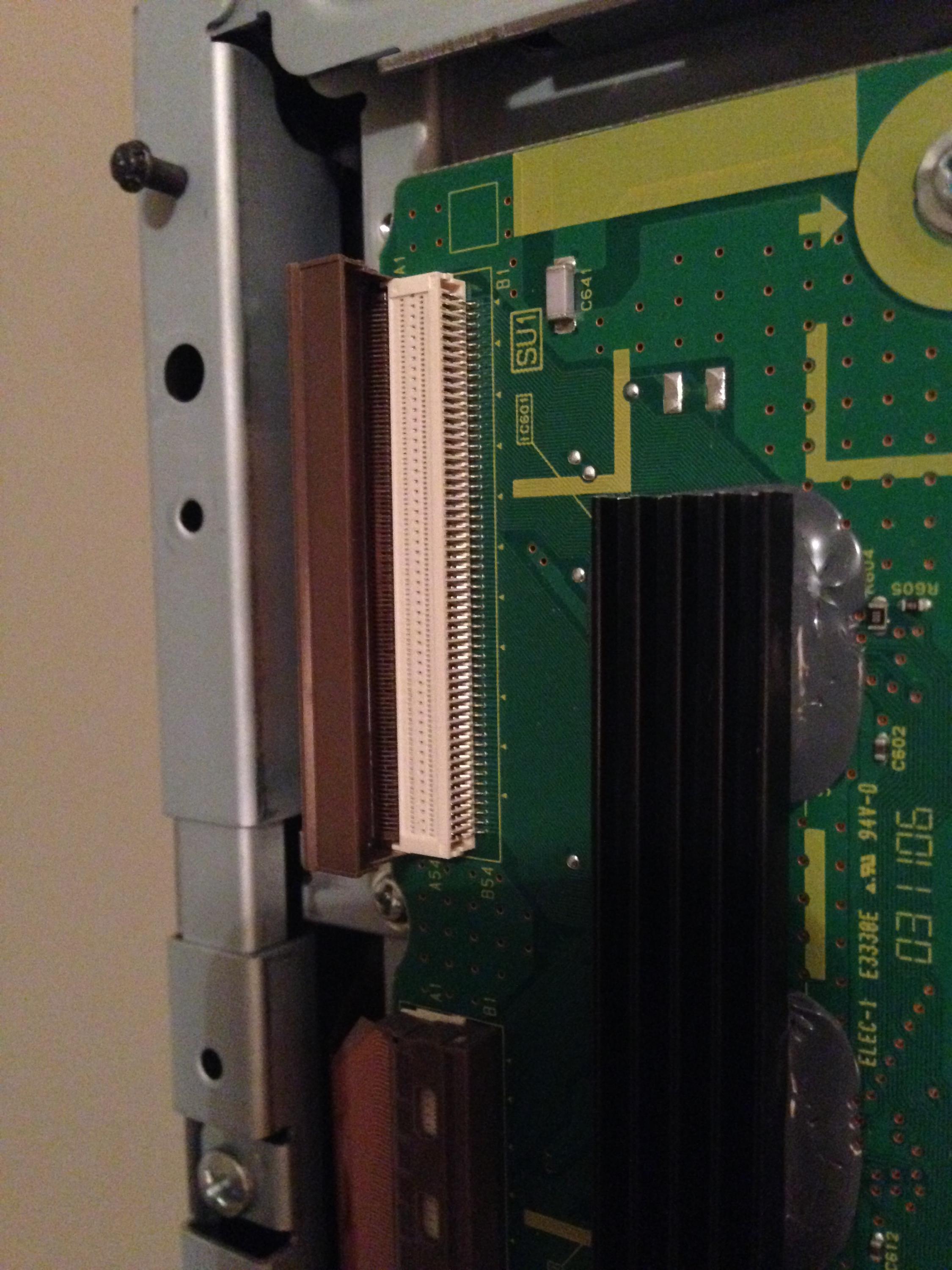

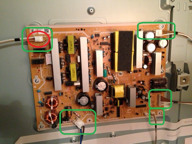

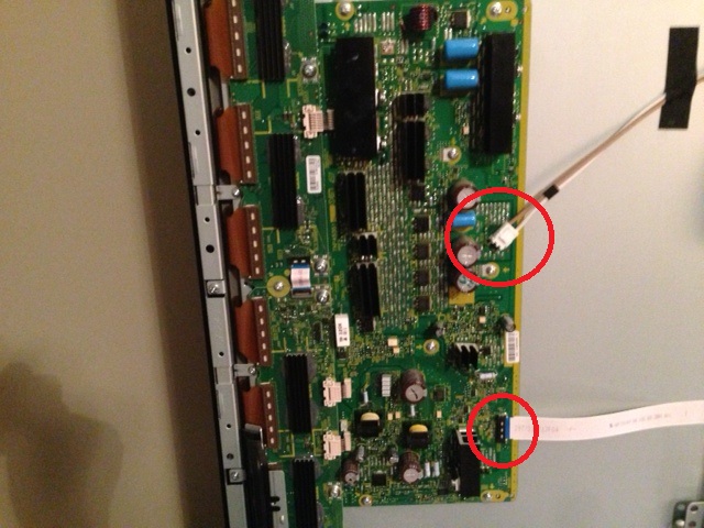

      Thanks for the quick response. I did take some pictures and added them if it will help.
      When the TV popped, the TV had a solid LED on it. I pressed and held the power button for a few seconds and then it flashed 14 times before repeating. I did a google search and found a page but it was cryptic and basically led me to believe the SC board was bad. Then I found the video I linked before and tried to troubleshoot it myself but not sure I'm doing this right.
      With everything hooked up initially, I started these checks. From photo 1 with the red oval, I did continuity checks on pin 1 and GND on P2 on the P board. I put the negative probe on the chassis and the positive probe on pin 1 on P2 and GND on P2. Both times the buzzer set off. Then I put the negative probe on pin 1 and positive probe on GND pin and it buzzed.
      Then, I disconnected the cable from SC2 to P2. Then, at the P2 connection, I did continuity checks from pin 1 to chassis, GND to chassis and pin 1 to GND. Buzzed all three times.
      Next, I disconnected all cables from the P board shown in photo1.jpg. I put all the disconnected cables in green boxes. I tried continuity checks again at P2 the same three ways as above: Pin 1 to chassis, GND to chassis and then Pin 1 to GND. Buzzed all three times.
      I tried continuity checks on SC2 at both of those pins and buzzed everytime there as well. I also tried checks with SC2 cable and ribbon disconnected shown in photo2.jpg. I was going to try and isolate the SC2 board but I didn't want to break the connectors in photo4.jpg. How are these things opened up?
      This is what I'm confused about. When it buzzes, is that telling me that I have a ground or that I have a good circuit? I thought continuity checks would tell if you had a complete circuit. But a ground is a complete circuit too, so how can I tell if a board is shorted?
      Specifically what I don't know is: am I checking the boards SC/SD/SU for shorts correctly? Should I see something different on my multimeter?
      I have replaced the board screws in the past with the lock washer like you've attached in the picture and replacing the transistors and diodes is way outside my current skill set.
      Thanks again for your help!

          locked solid is an indication of shorted Vsus (P2-Sc2 is Vsus which is about 200Volts, same is supplied to the SS SS11).
          So for the experience, assuming you have not powered this on very recently because residual voltages will exist for a short while at these points.
          With everything hooked up, just set to continuity and place a probe either side(measure across the pins) at P2, that's pins 1,2 at P2.
          I expect it will beep.
          now, disconnect either the Sc2 end or the p2 end of the cable. Repeat the same test.
          i expect it not to beep.
          The 14 change to 7 with SC2 removed tells me you have shorted Vsus at SC2

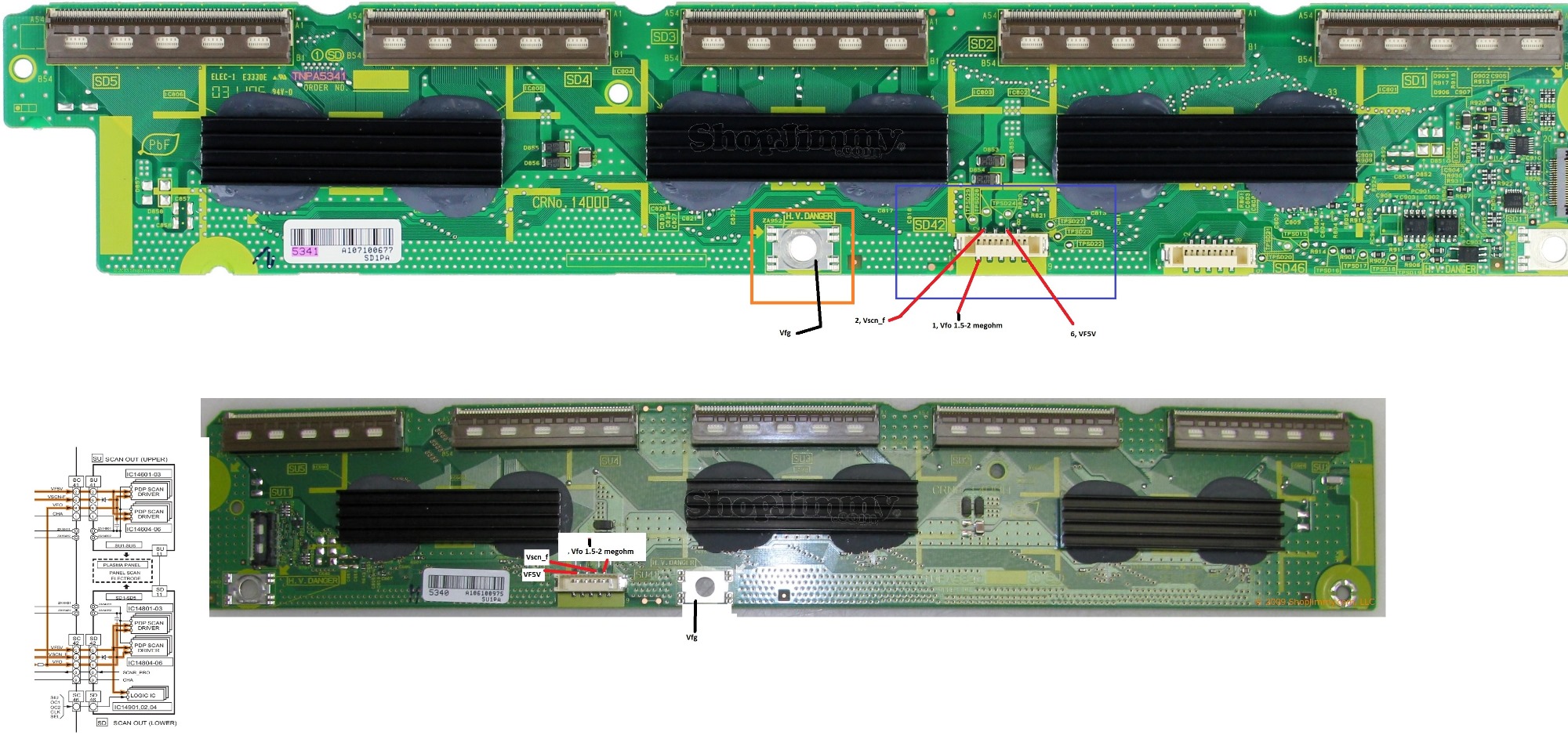

                                  yes , you'll enjoy this, more resistance and continuity checks. use the digital and I would like to know what it is I'm working with here range wise.
                                  Start with Vfo and have the meter set in megohms, we don't want low ohms or short but as a rough guide over 1.5megohms,
                                  the others I'd have to check but one could be 200k ohms and the other will be megohms and be out of range if your meter is a basic one.
                                  measure resistance between Vfg and each of the others, if a buffer is shorted Vfo i find is always bad or shorted.

                                    Re: Panasonic TV-P55ST30 loud pop, display black and 14 blinks
                                    Originally posted by Tnmg
                                    What are buffers and how do I check them?
                                    Had upload issues, see if you can follow the diagram

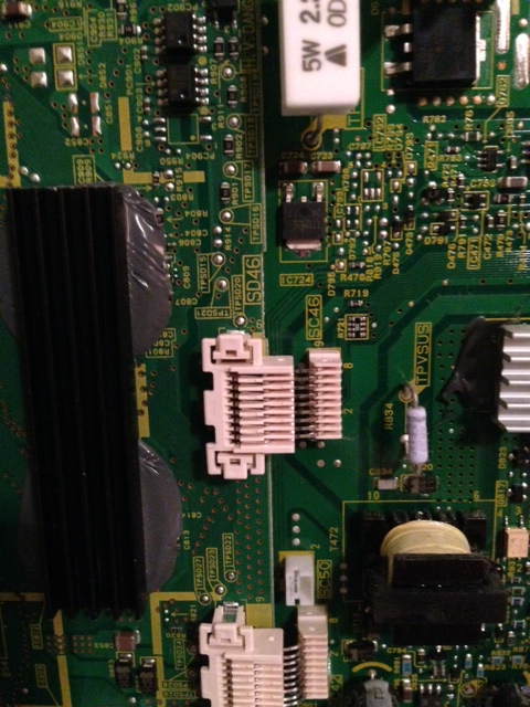

                                      I did a quick check of the buffers. I put one probe on the chassis and used the continuity to run through the buffers, or what I think are buffers. I didn't get any buzzers.
                                      Do I go through with the digital in the 2M ohms on each of these connections and take readings? There's a lot of pins I'll probably have to do that tomorrow after work. Thanks again for your help!
                                      I added a photo of what I think are buffers.

                                        you probably missed my post as i was editting but follow that. leave the panel ribbons alone if you can for now, just check the points I've marked on the input side. Forget about chassis earth, it has nothing to do with the buffers.
                                        Remove the SC board, its toast anyway, and probe the connectors at the SD/SU. Check Vfo first and set 2M ouhs and see what we get.
                                        If you can get away with not touching the panel side this will save you some heartache becasue lining those ribbons up again can be tricky.
