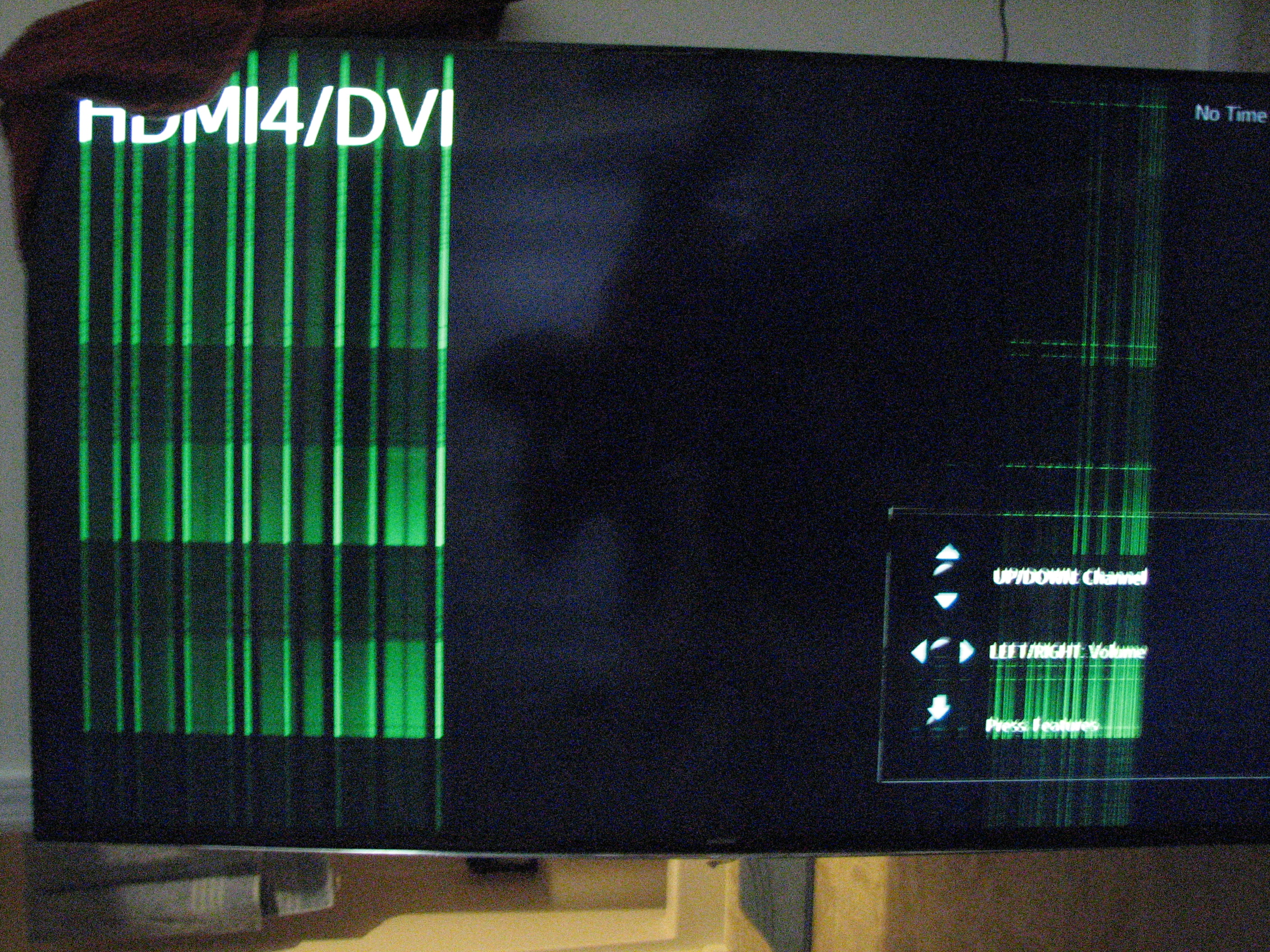

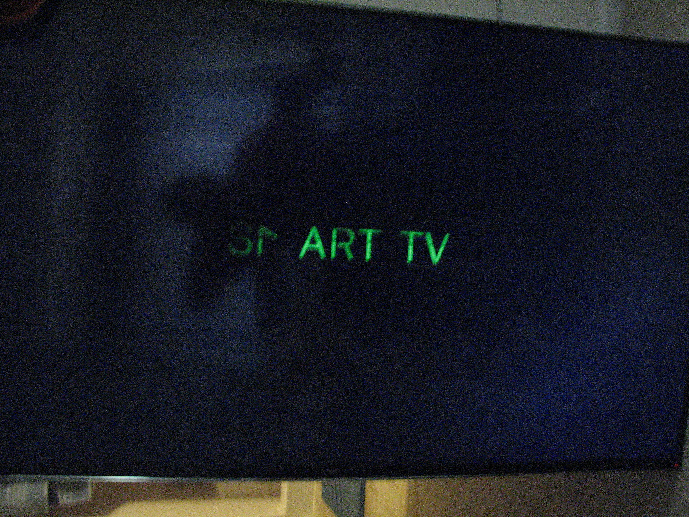

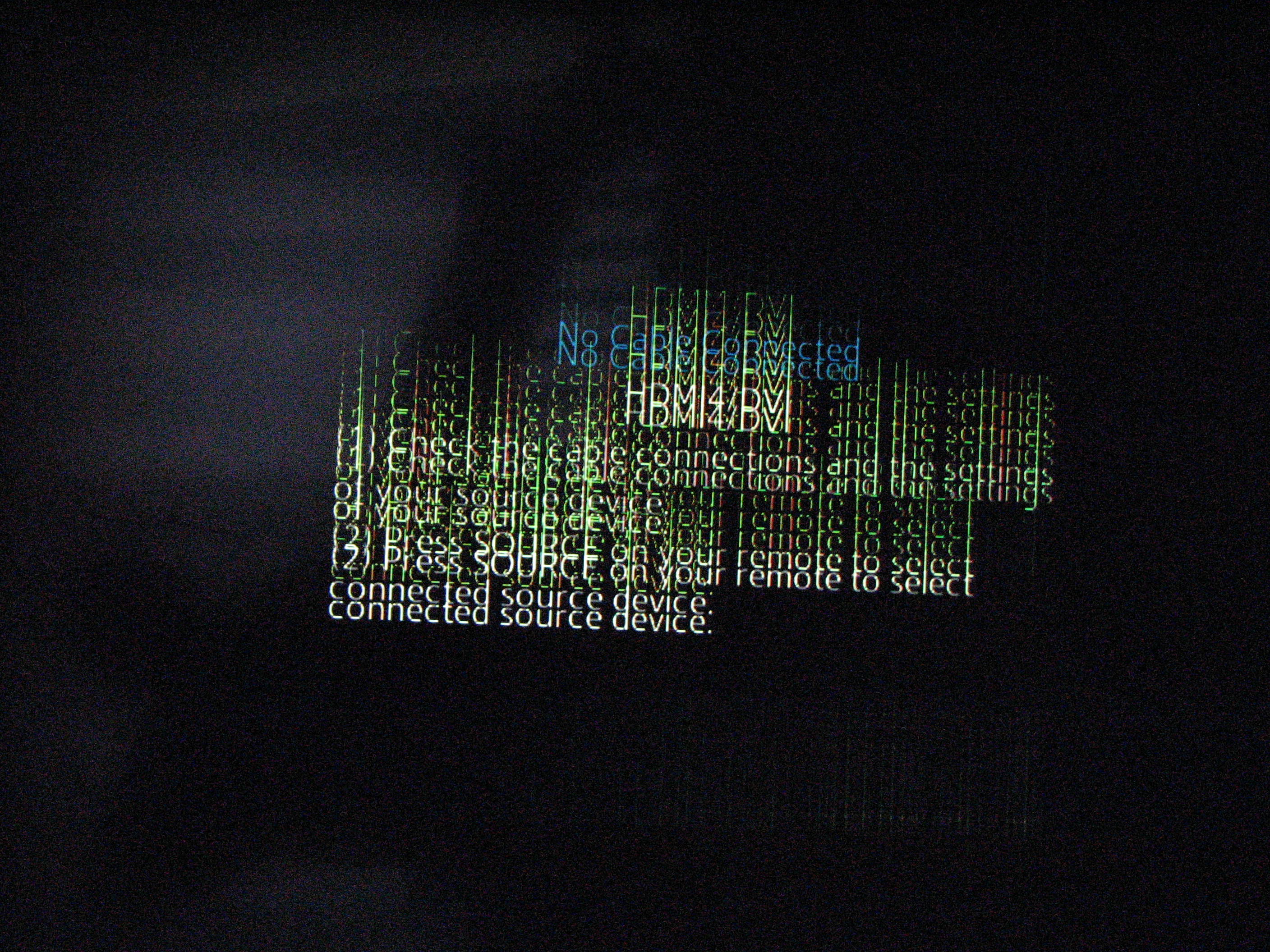

    Hello.
    I have a Samsung UN65H6350AFXZA with a screen issue. I have replaced the main board and power supply and stlll have the same problem as shown in the attached pictures. I assume this is a bad panel but wanted to check with other folks here to see if anyone else has encountered this problem. The screen is not damaged, but obviously there is a image problem. Has anyone else encountered this type of image? Is my panel bad?
    any info would be greatly appreciated..thanks in advance..
    Re: Samsung UN65H6350 Screen Problem
    Look like bad panel to me.
    Did you try flexing the screen to see if it will change?
