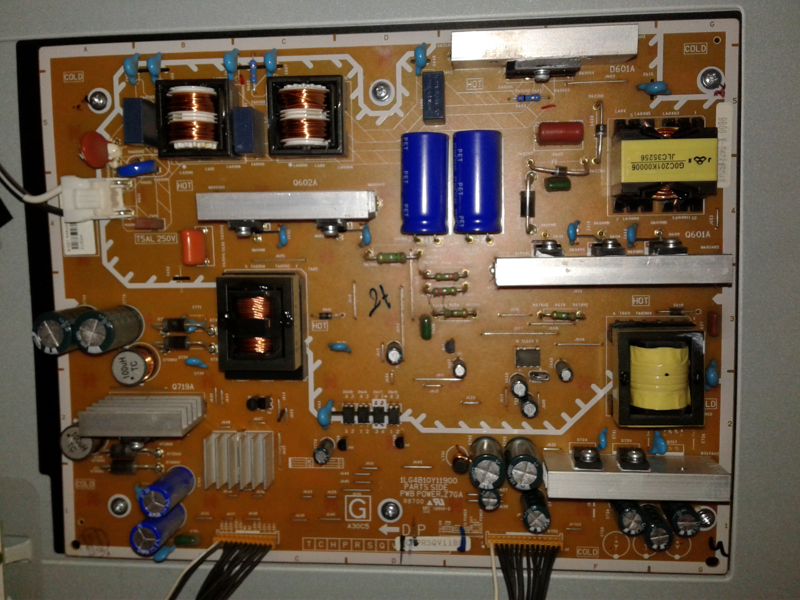

    Re: Sanyo DP58D33 Sound but no picture
    These are the voltages when powered on.
    Two main caps 437
    PS0N 3.4
    GND 0
    5VSTB 5.4
    5VSTB 5.5
    GND 0
    12VA 13.8
    12VA 13.9
    GND 0
    Audio Power 14.0
    GND 0
    Line off 3.7
    BL-ADJ 1.6
    BL-SW 3.7
    Audio Power 14.6
    LED 5- 3.7
    LED 4- 23.4
    LED 3- 22.9
    LED 2- 22.9
    LED 1- 23.1
    NC 0
    NC 0
    LED+ 157.7
    LED+ 157.9
    LED+ 158.1
    LED+ 158.1
    LED+ 158.2

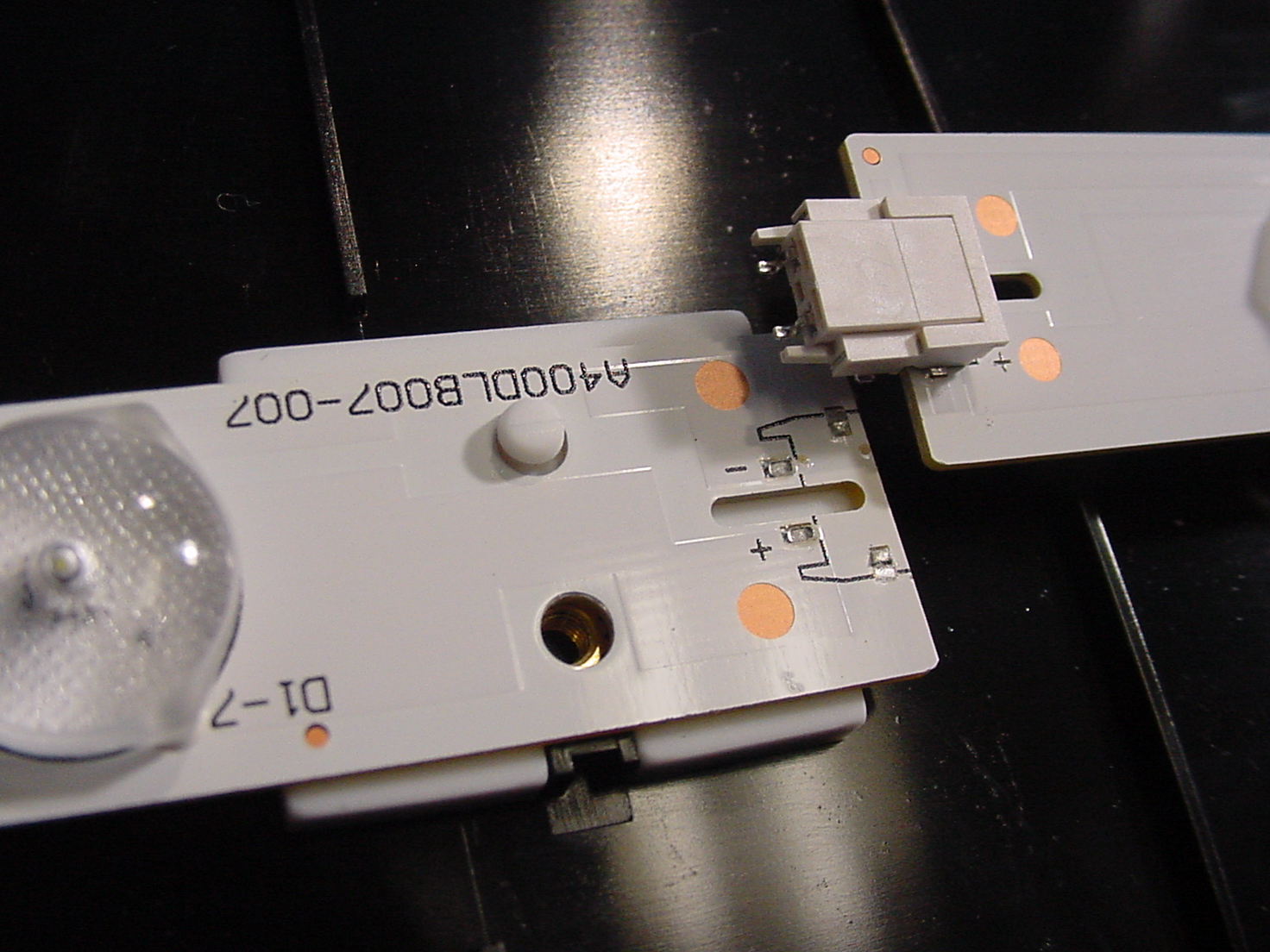

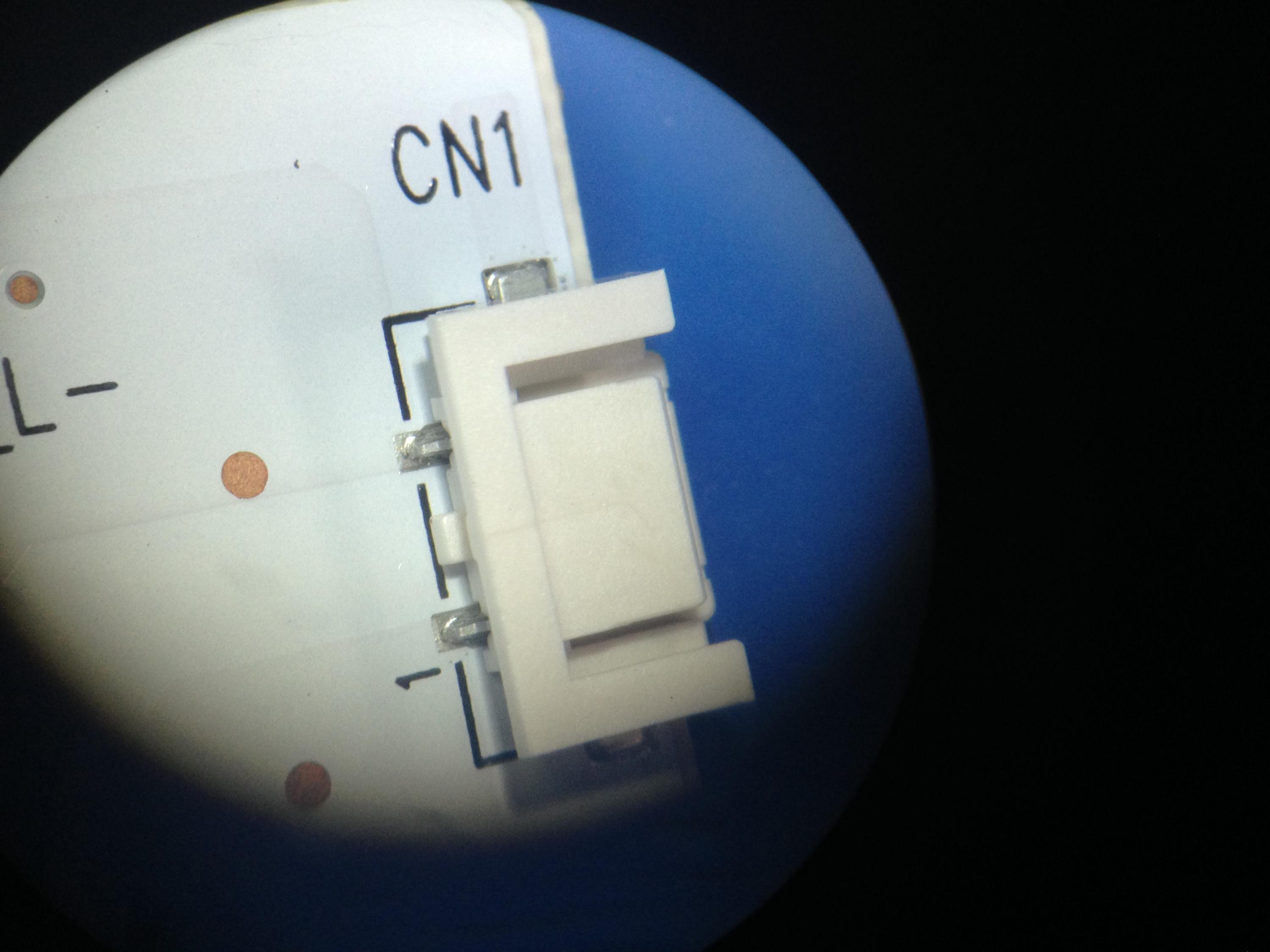

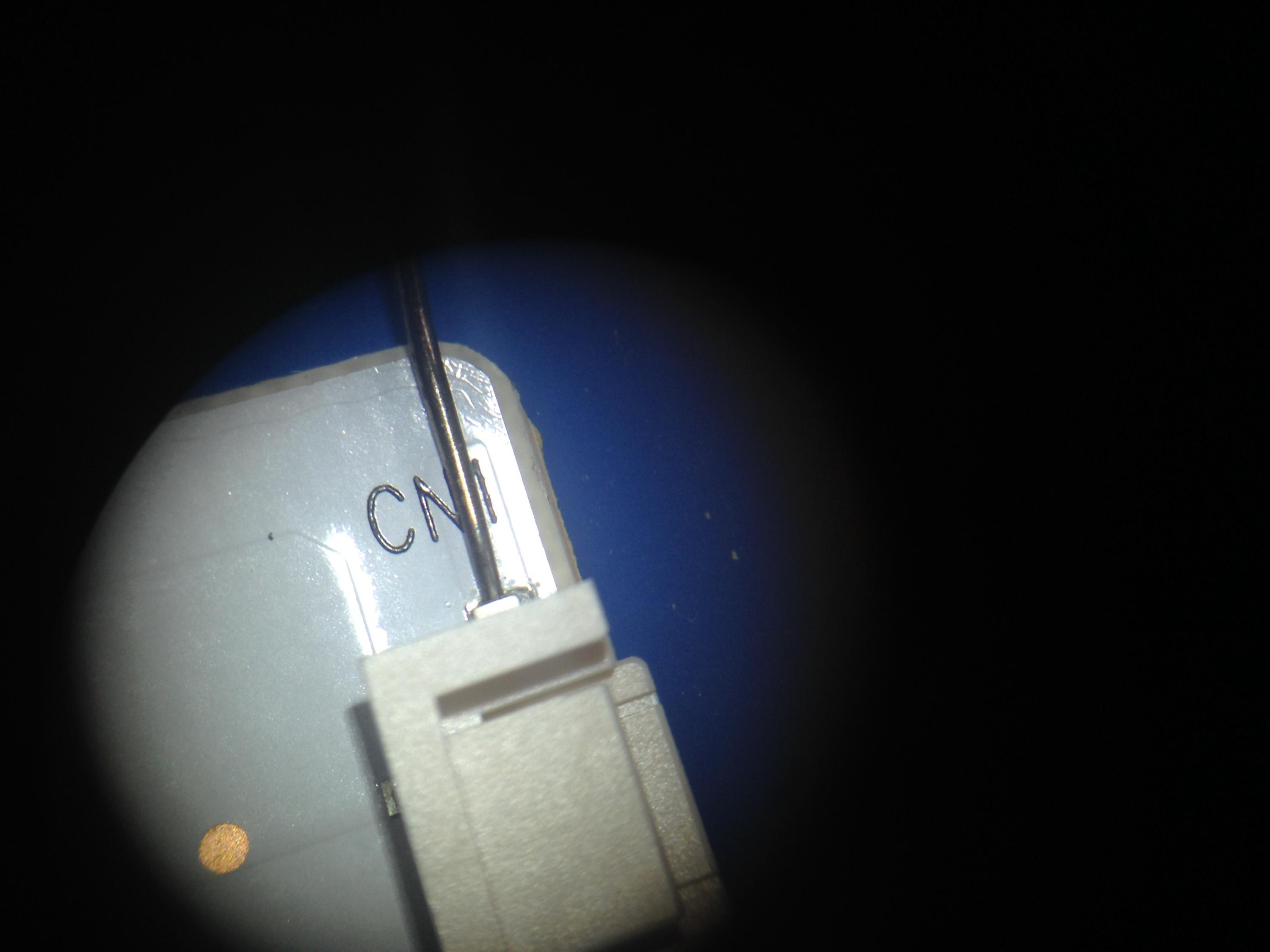

              I want to thank you guys for the post. I was chasing that 3v not realizing its a return. I got it working now. Maybe just a bad connection, I swapped the bad led strip with the good one (half at a time) and now everything seems likes it working without replacing anything. I may have got lucky on this one.
              {UPDATE}
              Tapping on the connector where the 2 halfs of the led strip meet caused it to fail again. I soldered the 2 little legs and now they are not failing. Something for anyone else with this issue can try.
                I would like to add to this thread a successful repaired of Sanyo DP58D33.
                Same issue, tv flashes for a second, sound remains but picture is gone. no glowing.
                Found the loose connection (just like skinner mentioned before) between the 2 strips that in this case they were located on the bottom (t-con side)
                Resoldered them and tv is working properly again.

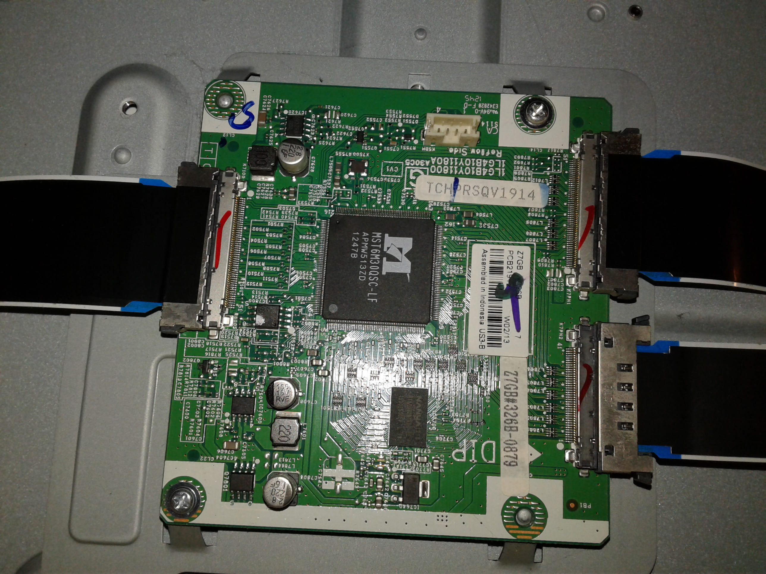

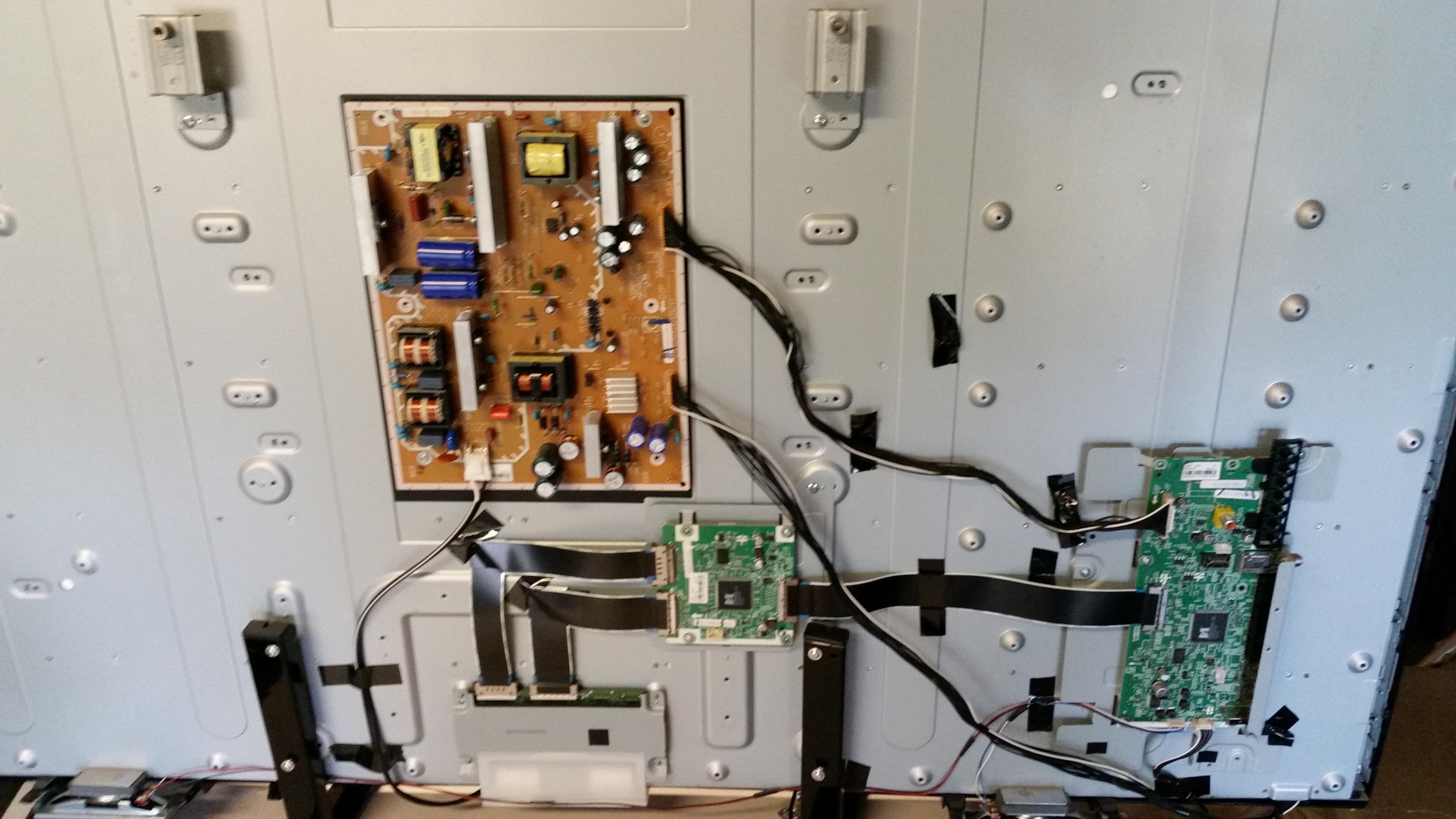

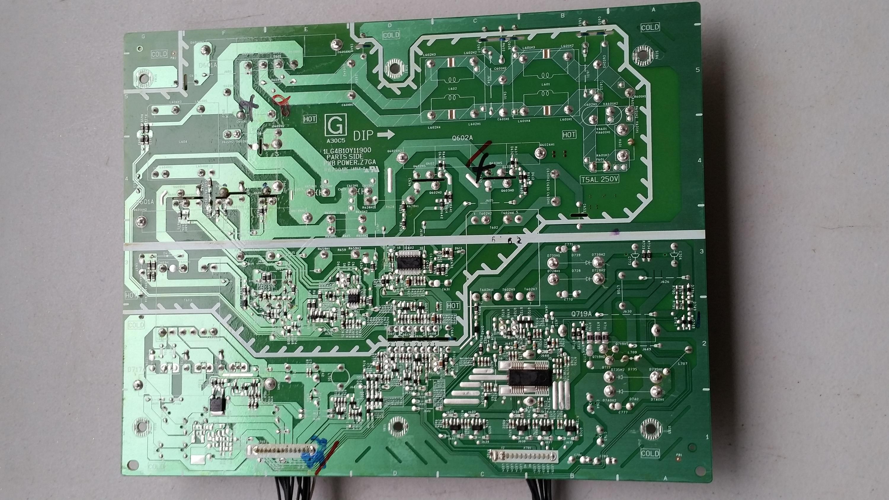

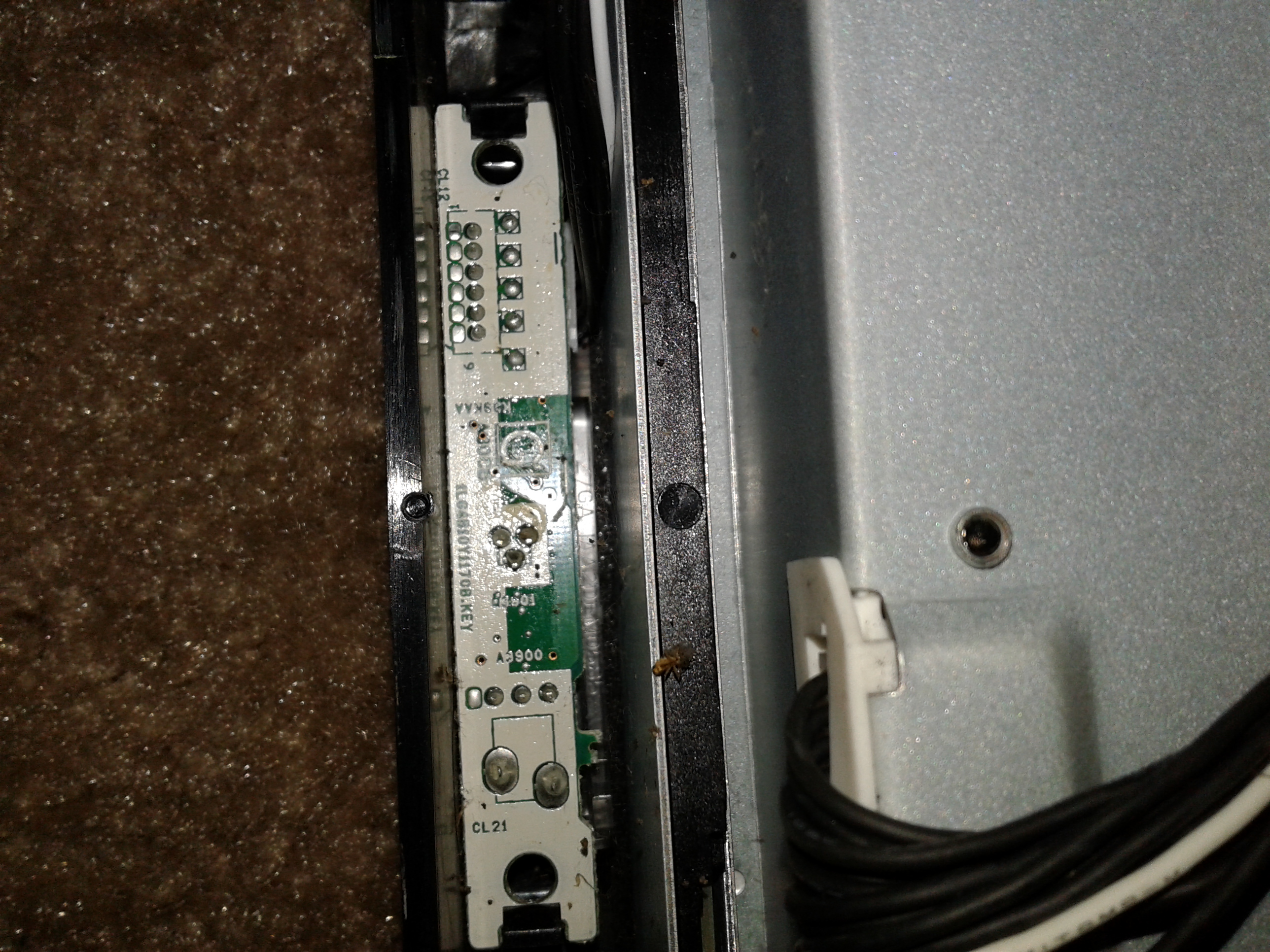

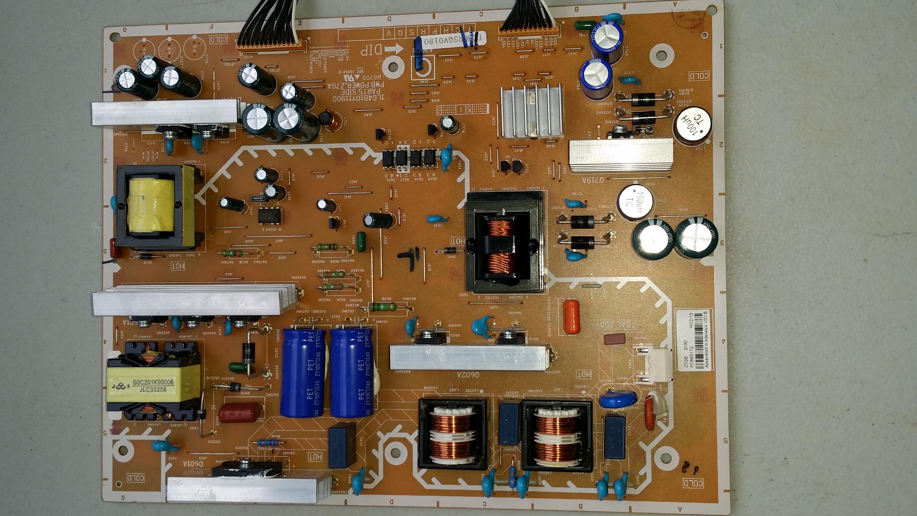

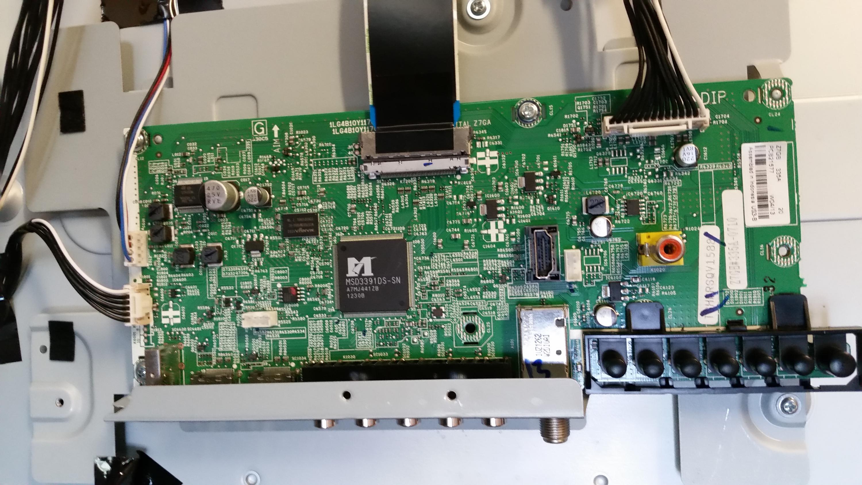

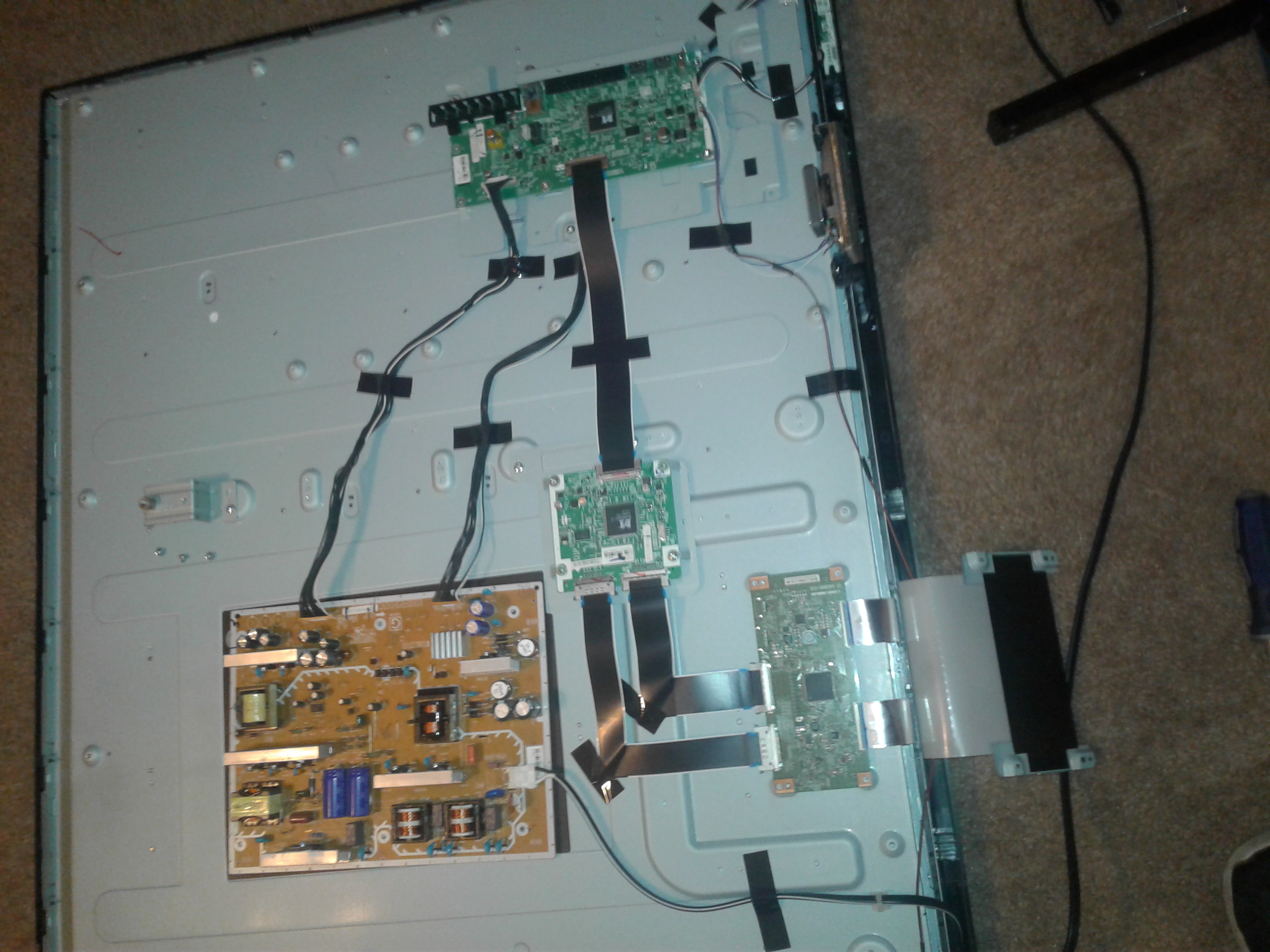

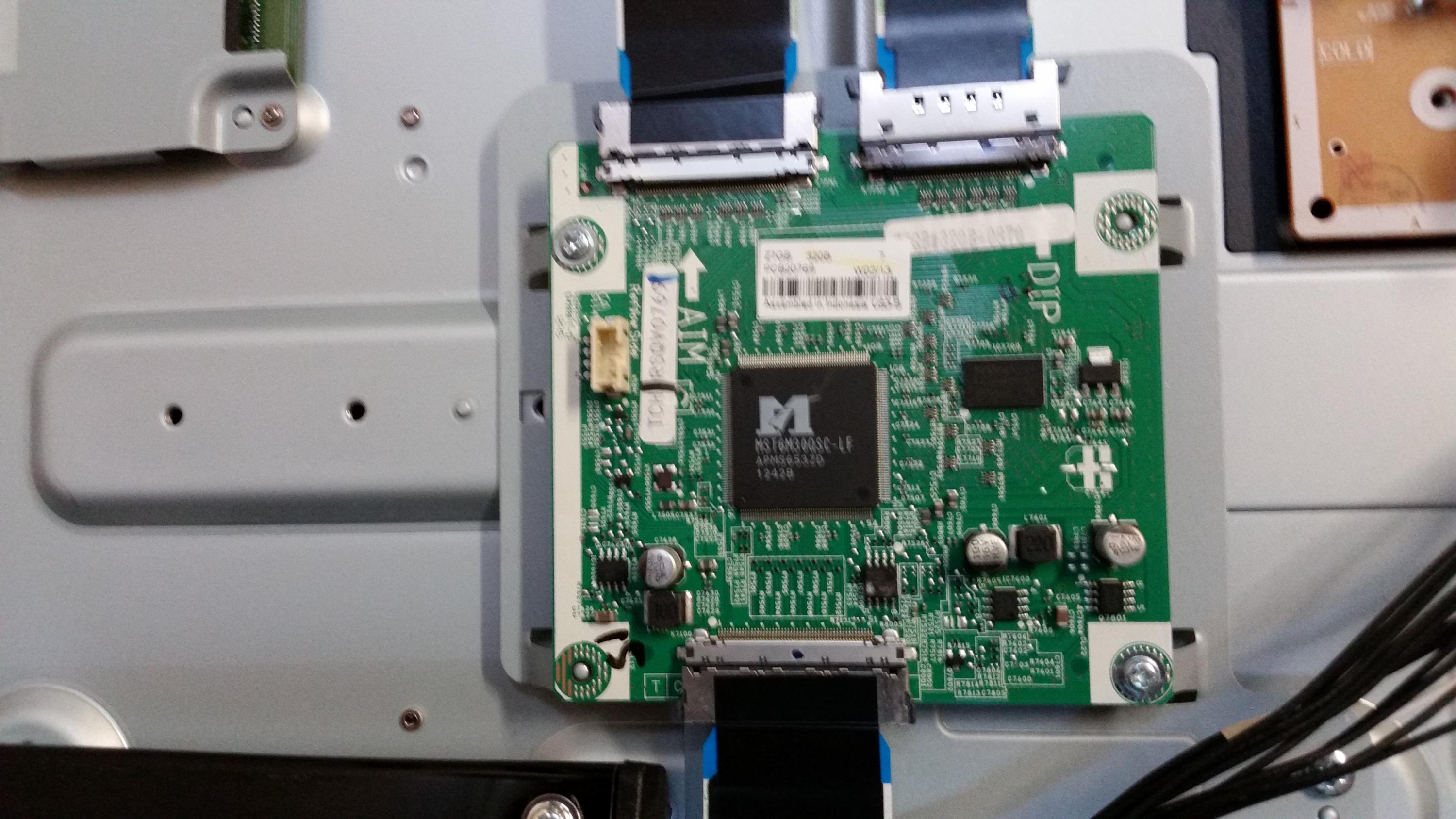

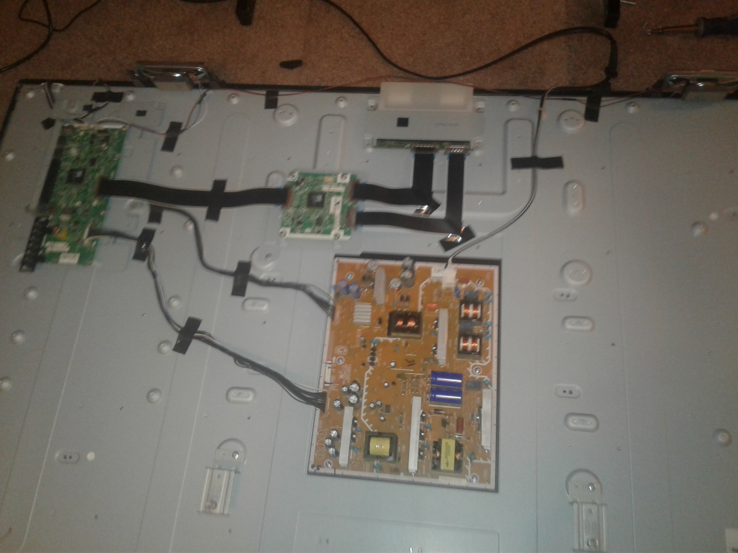

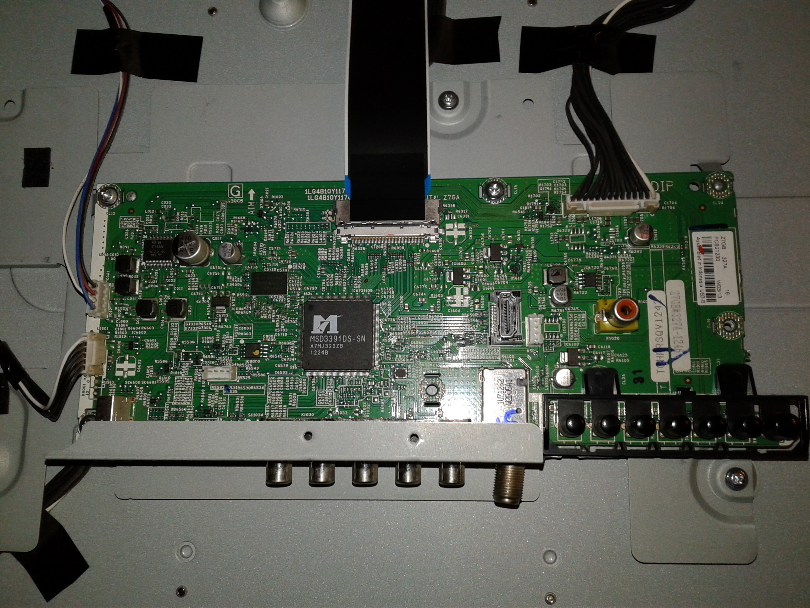

                        Hello, here are pics of all the boards for reference. The pics are from my phone and I apologize if not clear.
                            I could not see any bad caps nor anything that looked like a cold solder joint. In the blind I bought a new t-con board. Is that a waste of time? I will be taking it to my shop this weekend once the new board shows and I will trace steps from there.
                            Any input is appreciated.
                                Thank You budm,
                                I have only had the back off and not tried to take it apart any more except to pull a few boards and flip over to check the underside.
                                I'll do a search here and on youtube for a quick tutorial of how to disassemble it further. If you(or anyone) knows of one and can point me to a link, that would be greatly appreciated.
                                I'm kinda guessing that most LED/LCD come apart pretty much the same so I'll keep my eyes open for other brands. I just don't want to break anything.
                                Thanks again,
                                -Carl
