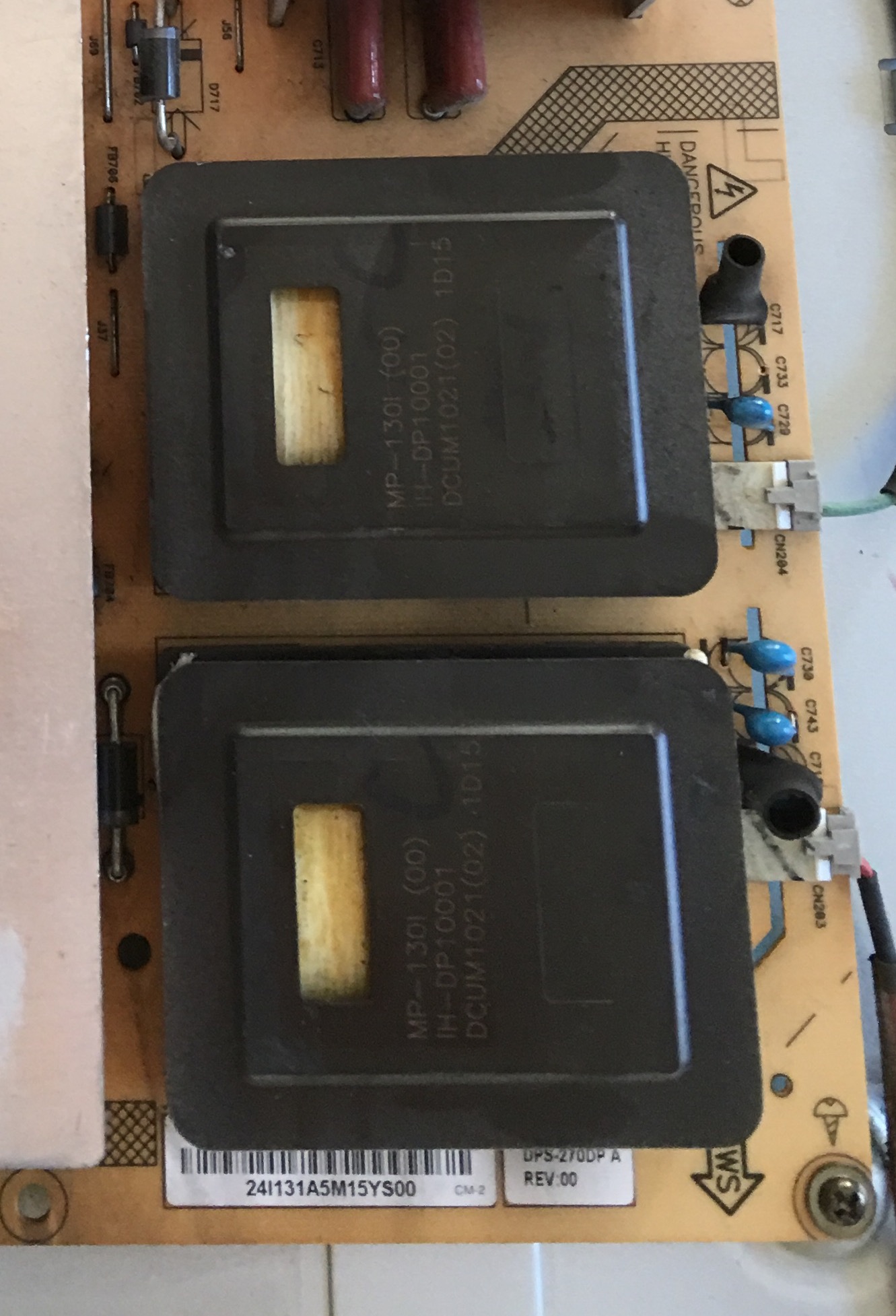

                  can you post a good clear picture of the back of the power supply as you may need to check the invertor transformer windings next for shorts are there any numbers on top of the two transformers that are by the back light wiring connectors.

                    So you want me to take the board off and take pic of the soldered side..

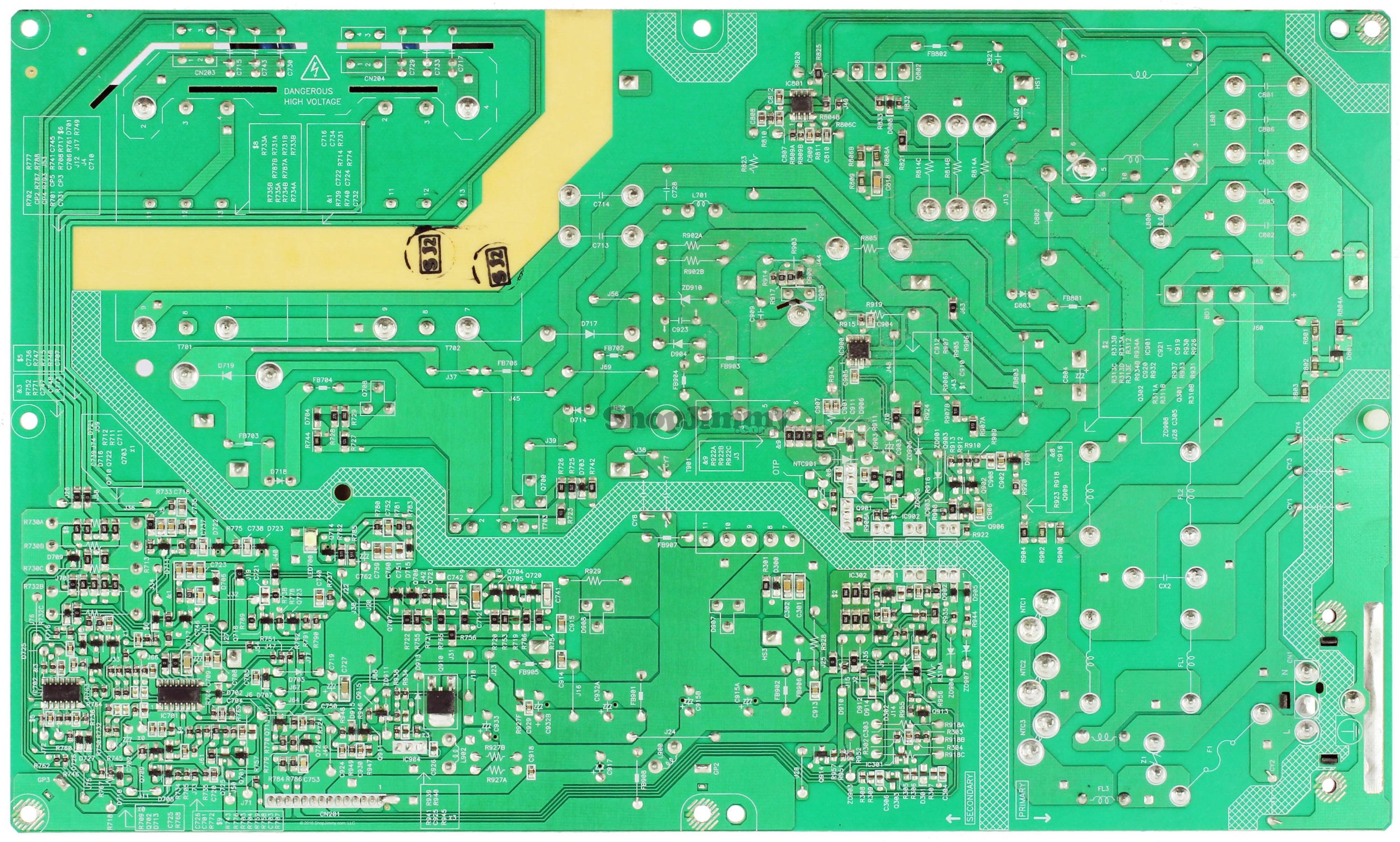

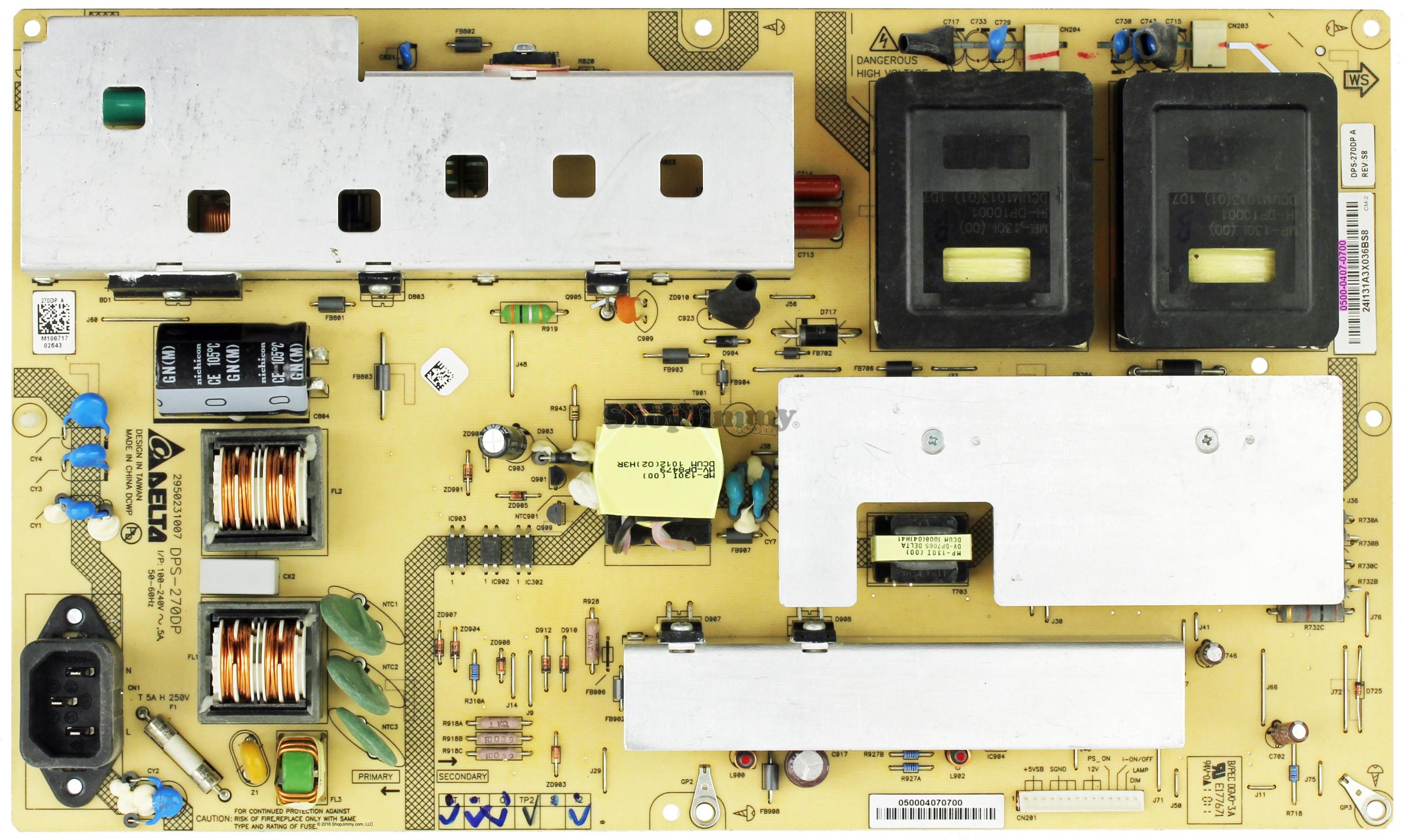

                      Please verify if this your board.
                      Vizio 0500-0407-0700 Power Supply / Backlight Inverter
                      http://www.shopjimmy.com/vizio-0500-...upply-unit.htm
                      Since you did see the backlights flash on for seconds, then it can be the inverter circuit or the lamp/s problem.
                        #31
                        Re: Vizio E470VL NO Backlight help
                        Yes that is board that I have ...
                          #32
                          Replaced the board . Still no backlights . Just tore it down and inspecting the bulbs
