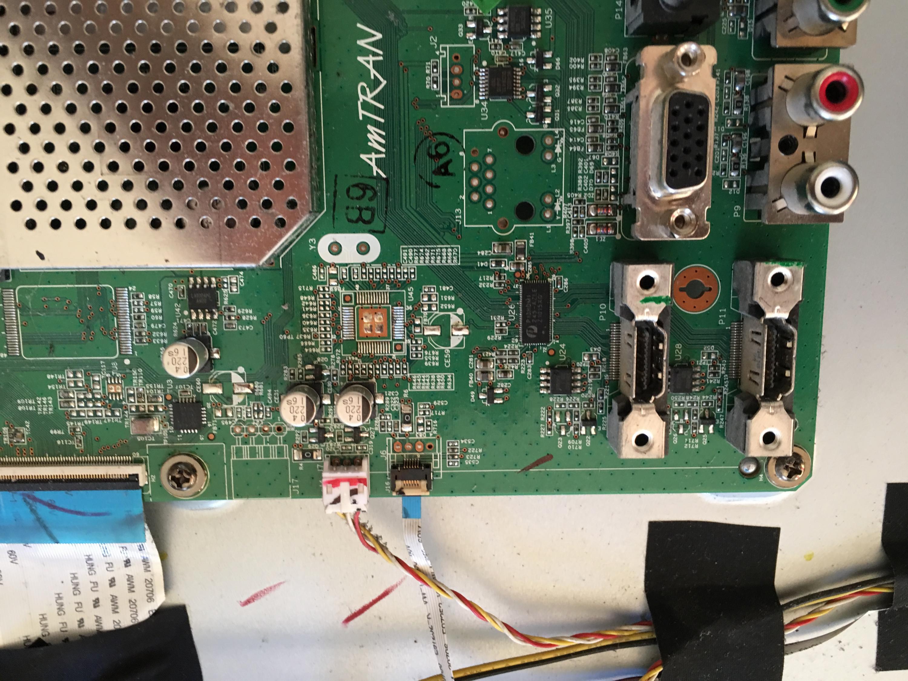

    ok got this tv and at first backlight would come on then shut off, now I cant get backlight to come on, but tv will power up just no backlight. atfirst I thought it was bad power supply now im not sure
    I have my
    5v standby
    12v
    ps on is 2.2
    I on/off .75v

          So I'm kind of confused. I know the main sends these signals to the psu to turn on. I have some boltages but not all. So is main bad? Or is main sending its signal but power supply is not producing enough voltage?
            Re: Vizio E470VL NO Backlight help
            The main signal is not sending enough Voltage level, it has to be >2.5V for the Backlights circuit to turn on. You can try forcing on the backlights using resistor but you MUST disconnect the BL-ON wire going back to the main board FIRST.

              Now is there a certain component on that main board that is responsible for this that I can change
                The problem can be caused by bad Voltage regulator IC, BL-ON switched Transistor that switch HI and LO which is controlled by the controller IC, bad caps, bad EEPROM, bad connections, etc.
                So unless you have the diagram to show the details how the BL-ON signal is generated then you just have to start looking at all those parts on the board I mention above

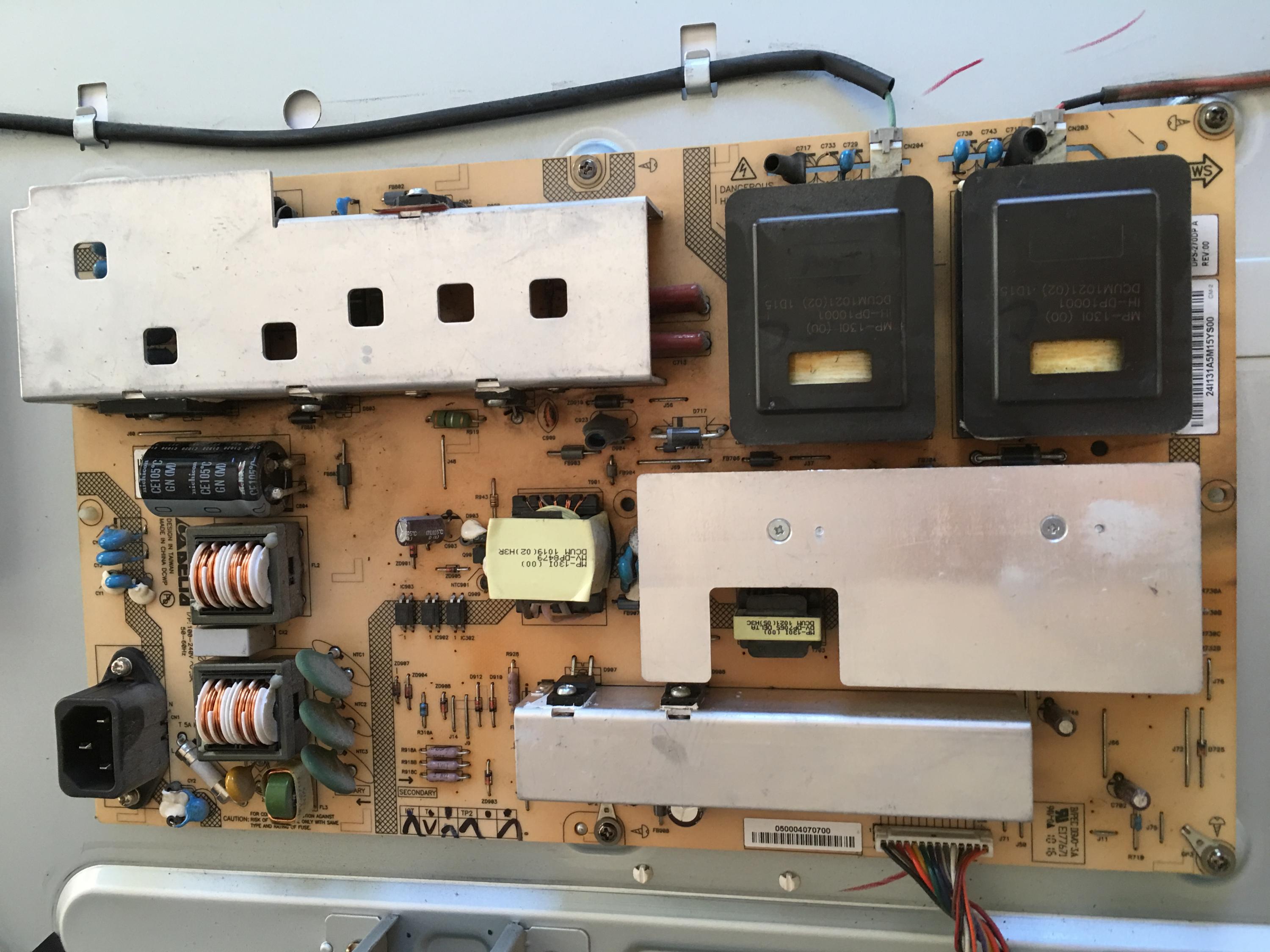

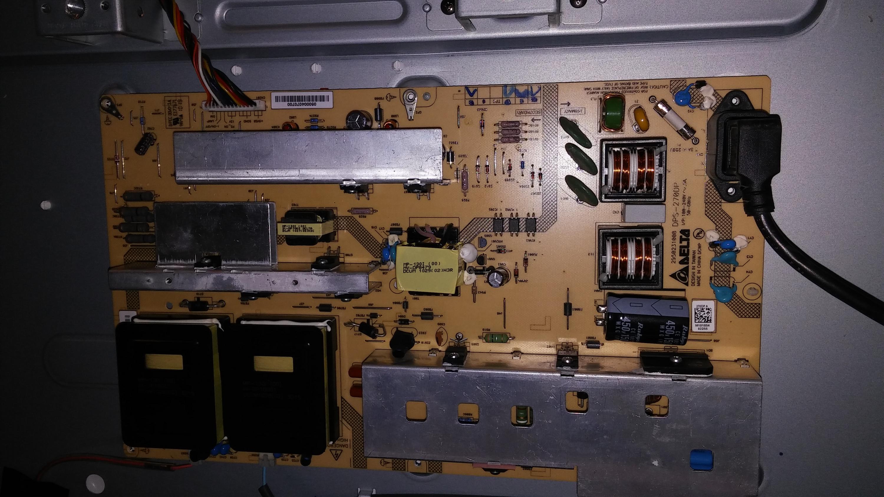

                          Hi all I don't know how to create a thread so I am piggybacking here , I apologize . I have a vizio tv E470VL. Recently the screen went black and I only get sound. I did a flashlight test and I can see images. I was told it could be either a bad power supply led board or bad led strips in the screen itself. How can pinpoint which is th e problem to see if it's worth fixing. Thanks Anthony M
                            Do you have good Meter with good battery in it for testing DC Voltage?
                            We will need good straight shot pictures of the power supply board and the closed up pictures around the connectors of the power supply board so we can clearly see the labels for each pin of the connectors.
                            Testing Voltages is the first step at this point.
                            • Anthony M
                              • Apr 2017
                              • 14
                              • Usa
                              I have a voltage meter to test outlets it also can test ohms and continuity . I can take some pics and post
                                We need the pictures so we can see what we are dealing with, and with the pictures that show the pins' name then we can tell you what to test.

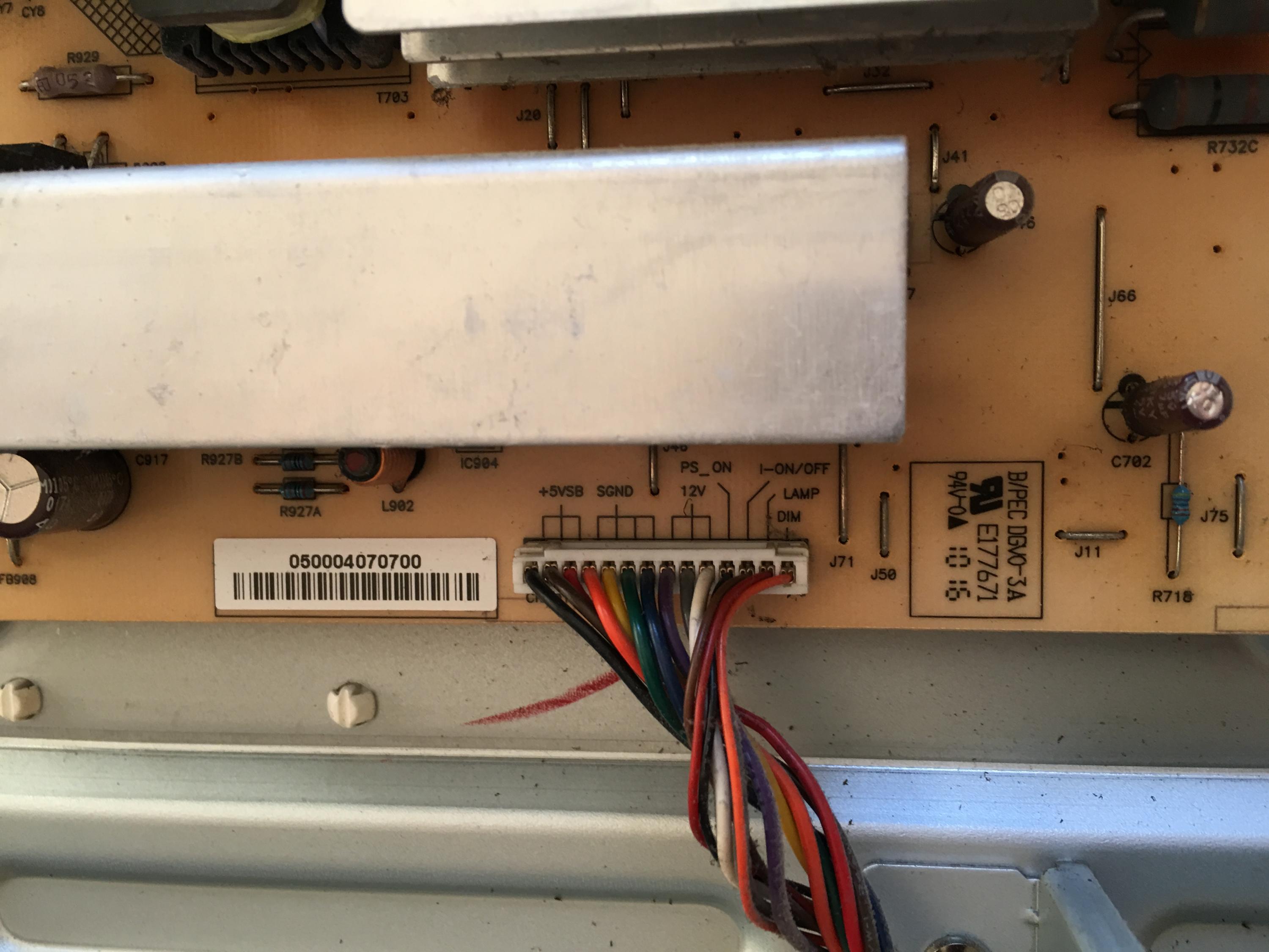

                                  Pics
                                    https://www.badcaps.net/forum/attach...4&d=1491418312
                                    So with the connector is still in place:
                                    1) TV is pluggeg into the outlet but not turn on yet.
                                    2) Black probe on the metal chassis.
                                    3) Red probe on each one of those pins on the connector (you may need skinny probe to make contact with the terminals), report the DCV reading of each pin in this format:
                                    TV OFF
                                    DIM = ??? V
                                    LAMP = ??? V
                                    I-ON/OFF = ??? V
                                    so on and so on
                                    4) Activate the power switch and repeat the same procedure in #3
                                    Just remember one thing, wrong DATA can lead to wrong troubleshooting path.
                                    Make sure your meter is good and has good batteries.

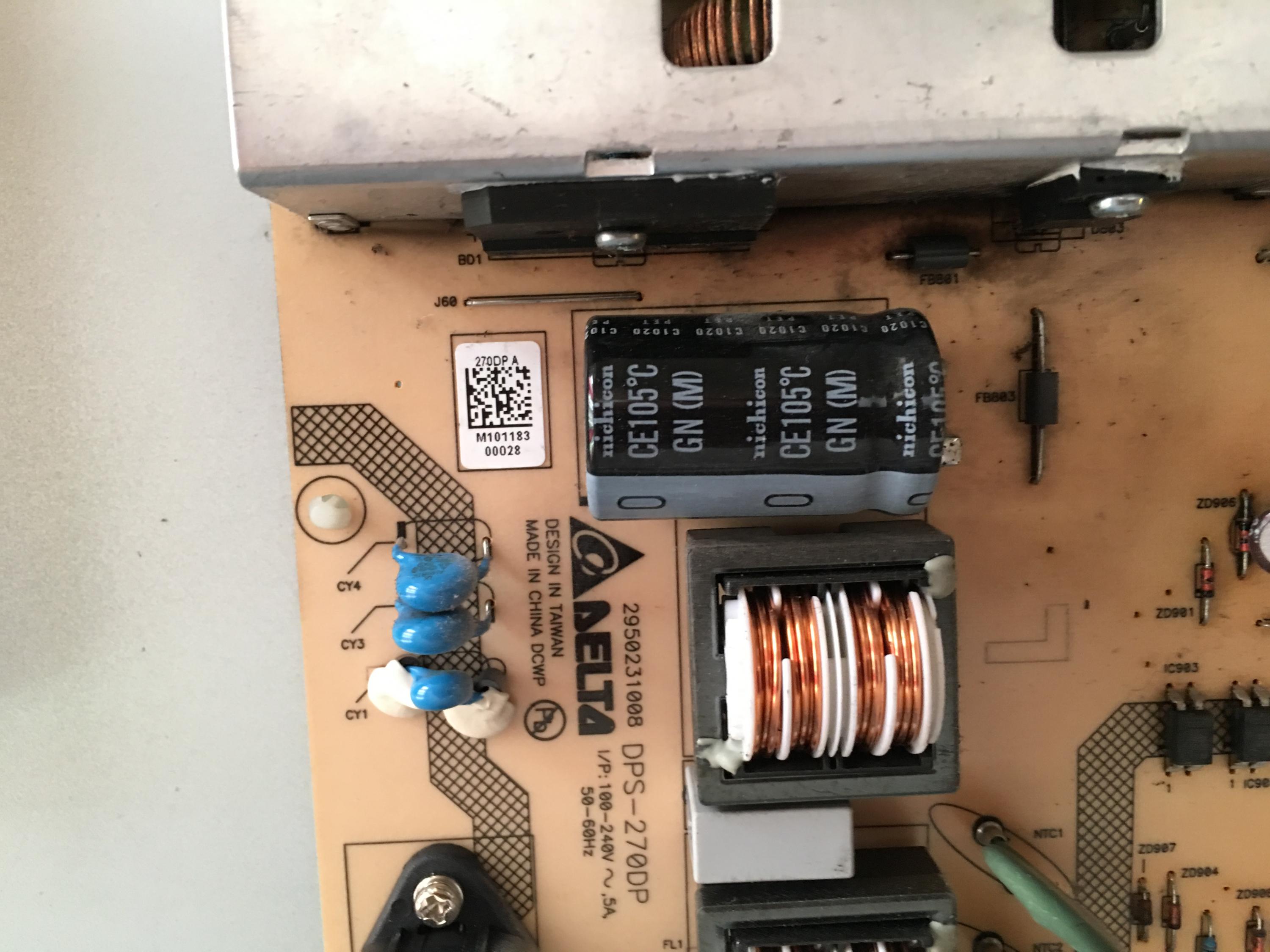

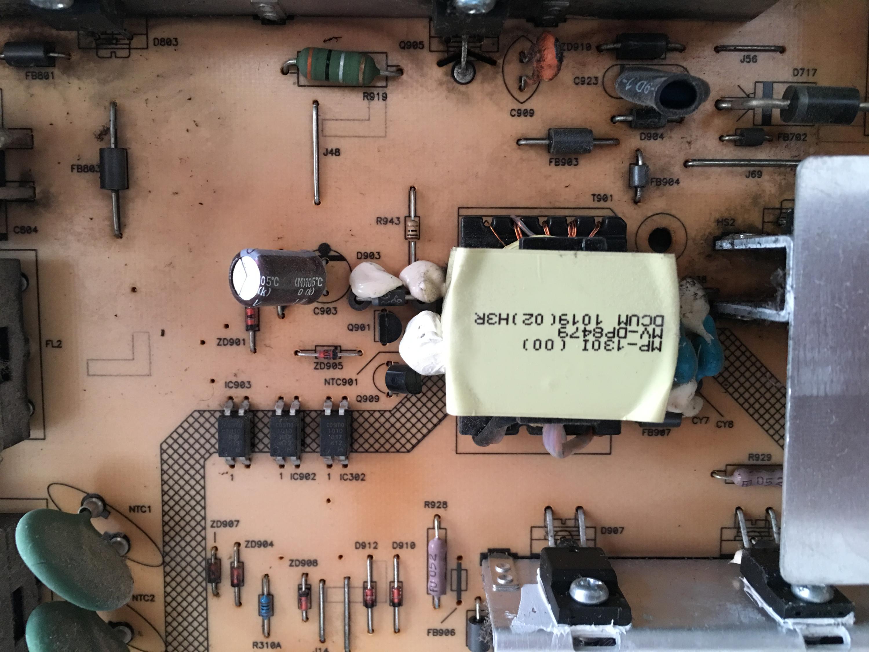

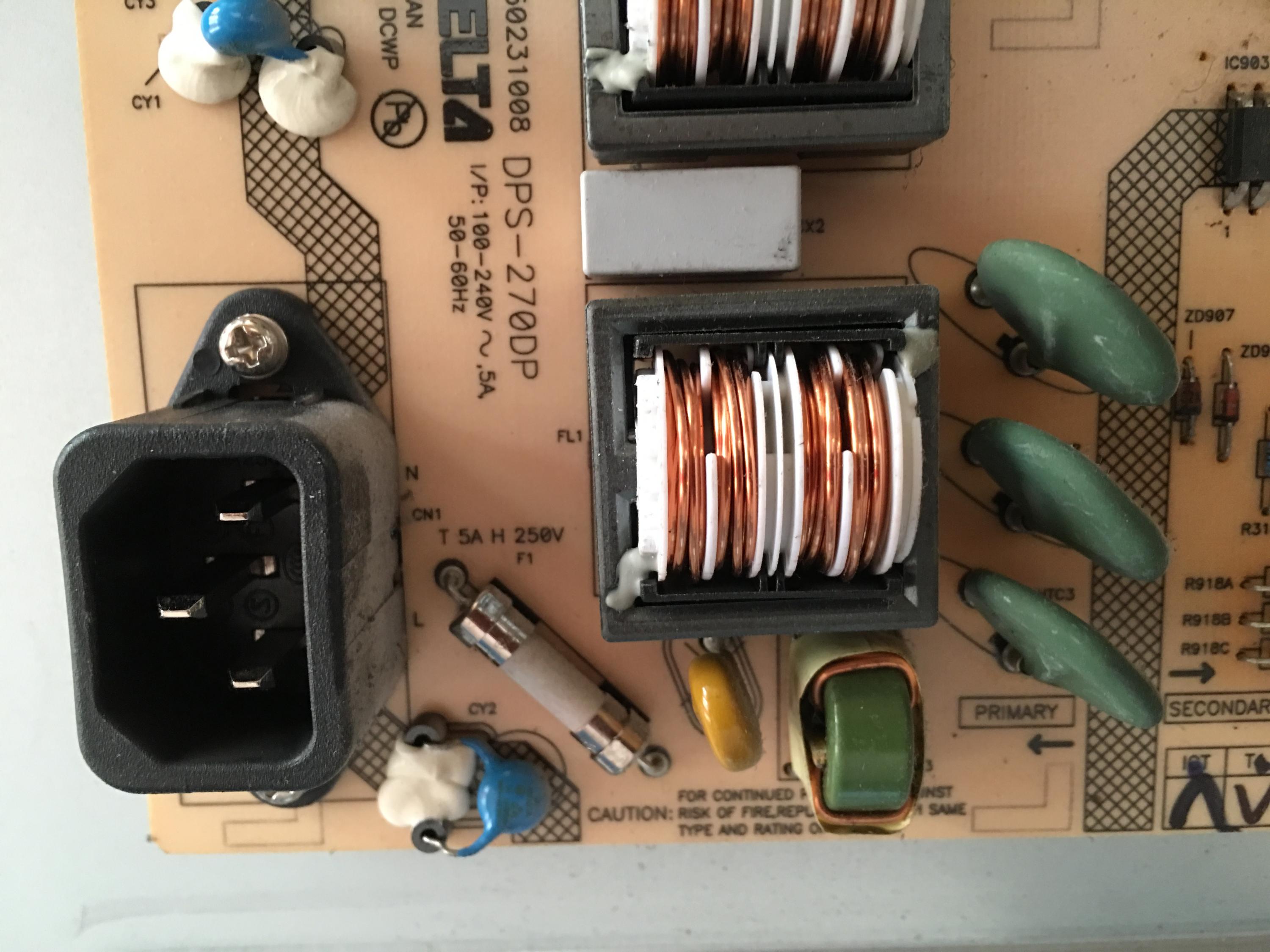

                                      TV Off. TV On
                                      DIM. 0. 3.3
                                      Lamp. 0. 0
                                      I-On/off. 0. 3.3
                                      PS_On. 0. 2.3
                                      12V. 0. 12.3
                                      0. 12.3
                                      0. 12.3
                                      SGND. 0 0
                                      0. 0
                                      0. 0
                                      0. 0
                                      +5VSB. 5.2. 5.2
                                      5.2 5.2
                                      5.2. 5.2
                                      • vinceroger69
                                        • Mar 2012
                                        • 6714
                                        • uk

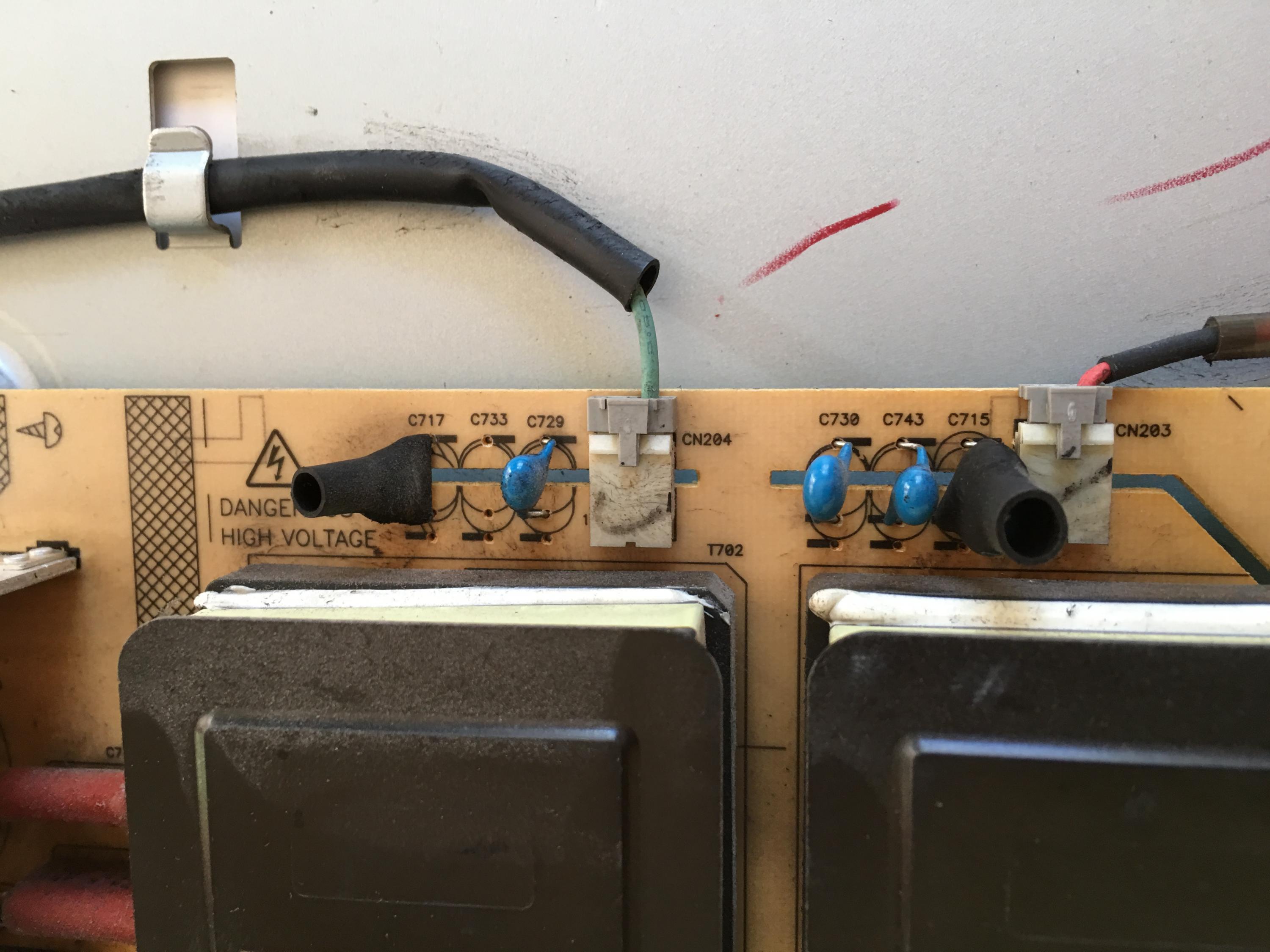

                                        Looking at the psu this is not a led set it uses ccfl/eefl tubes i think so may be a faulty tube/wiring issue as your viltages look ok but budm will confirm
