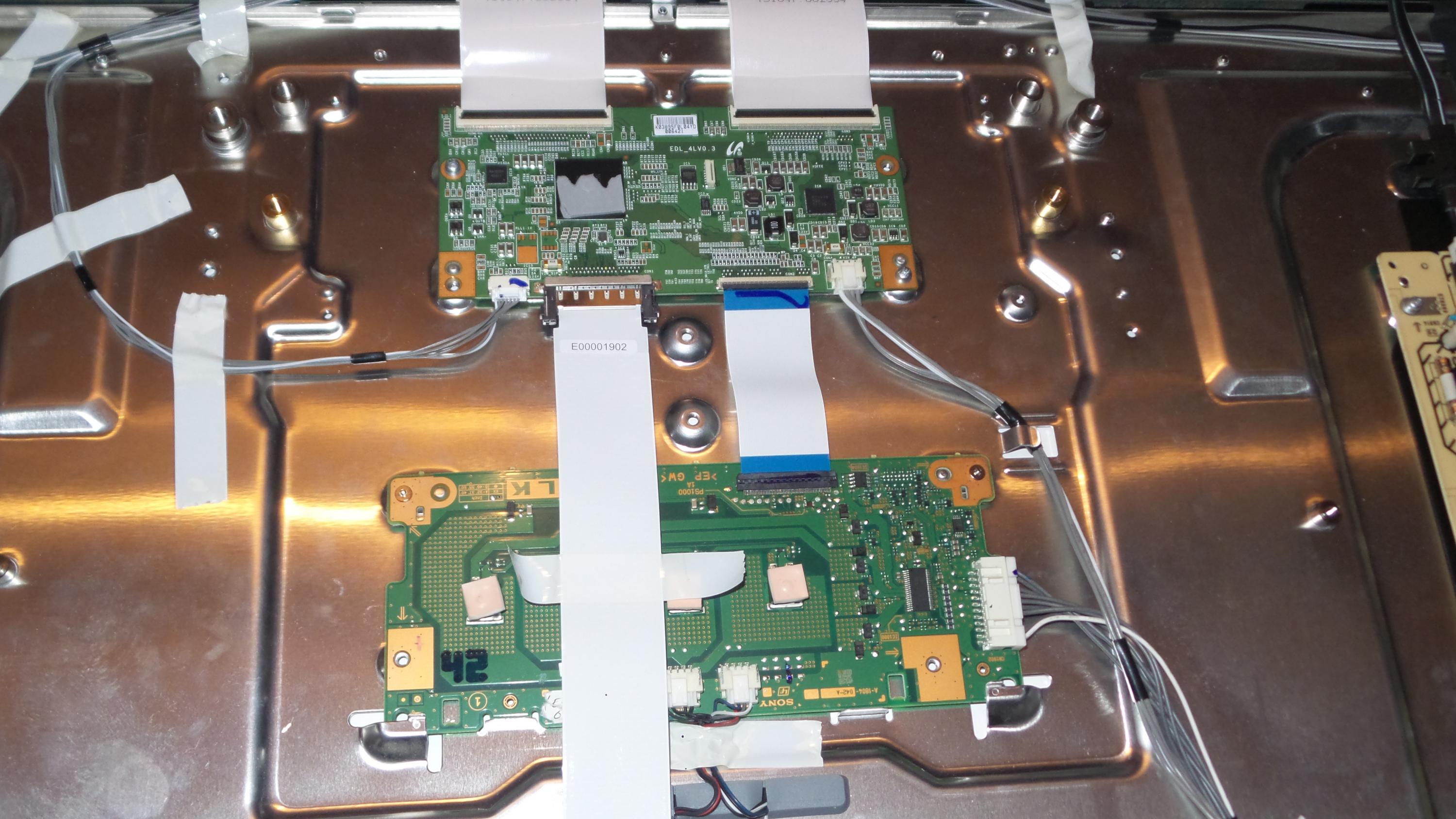

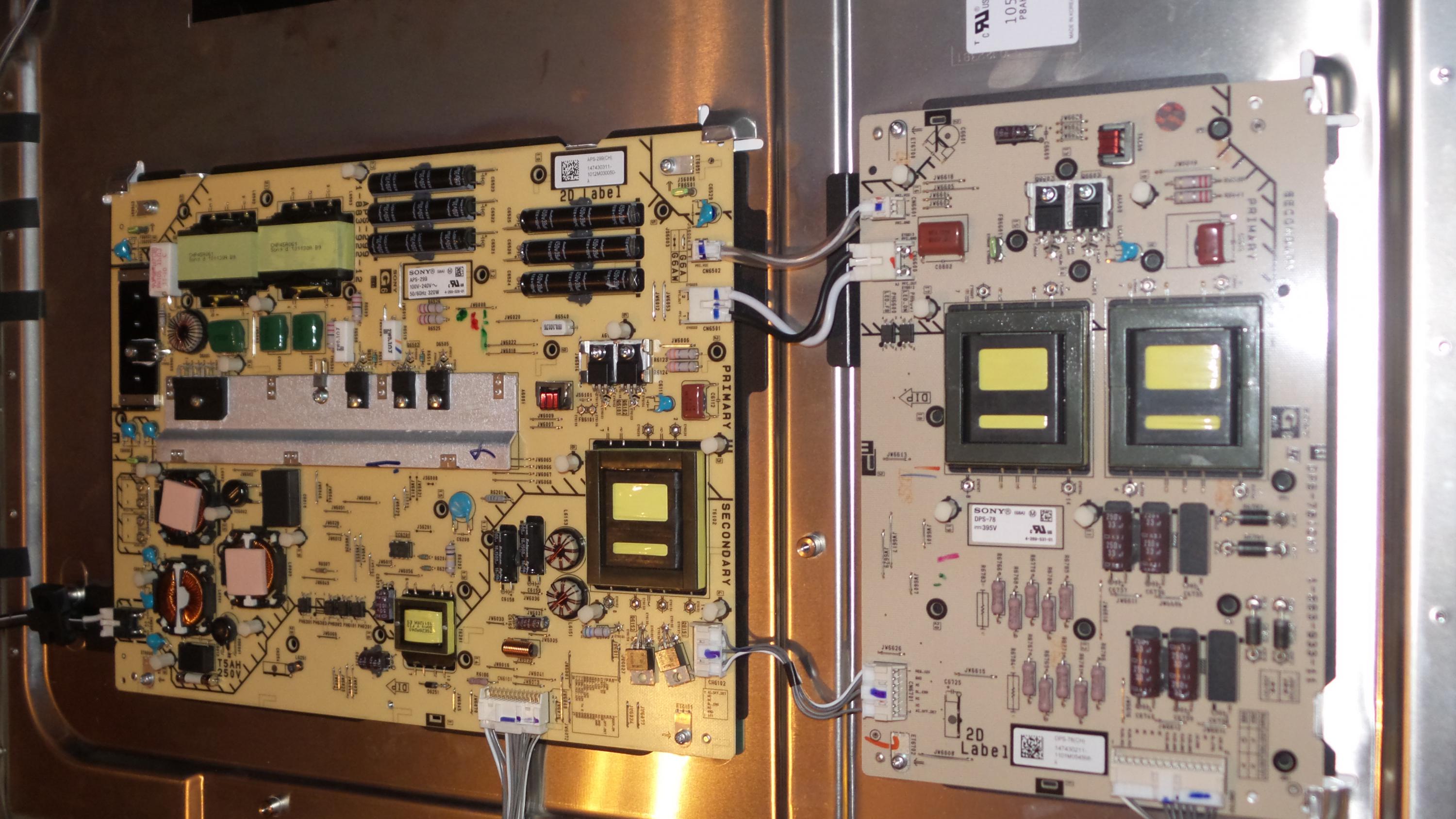

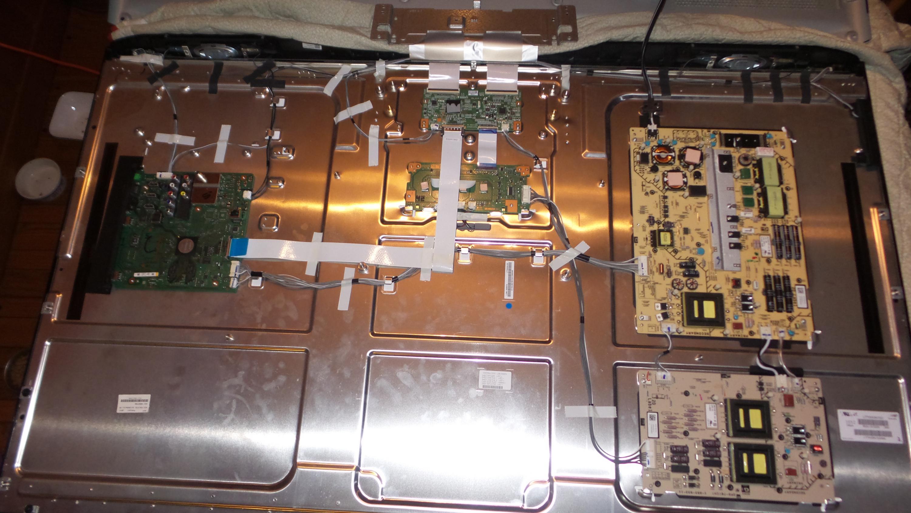

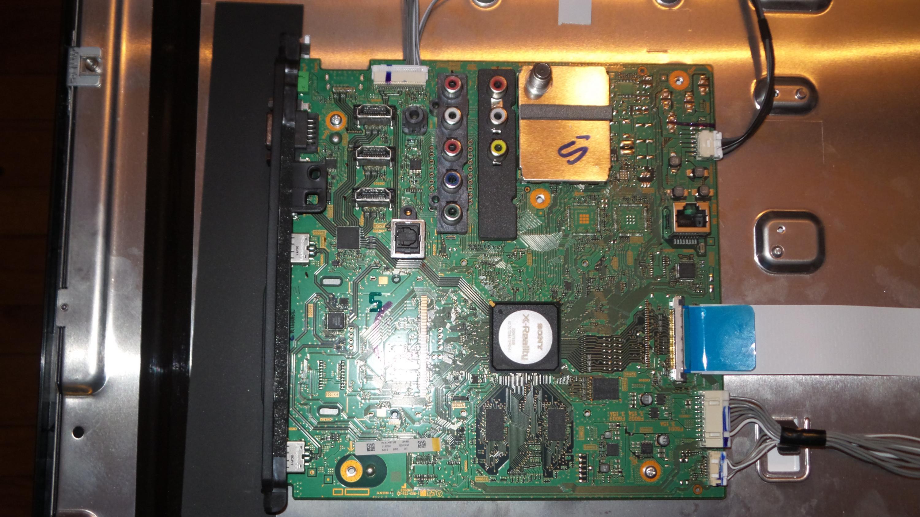

    Here are pics of the TV's innards:

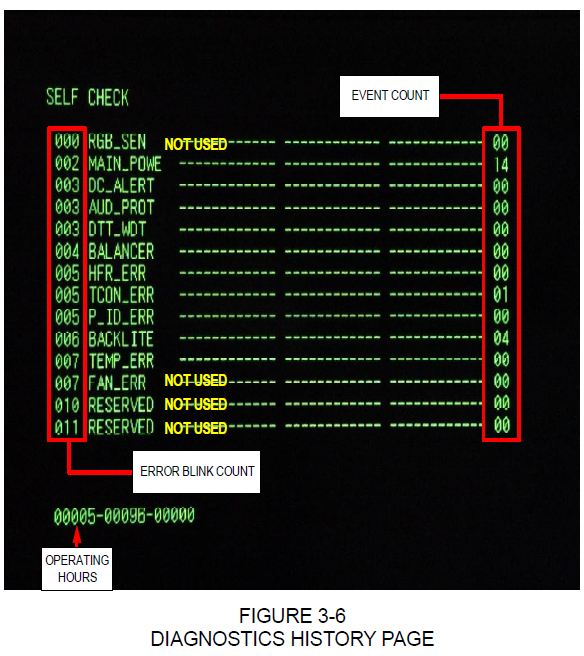

    It looks like 4 blinks could be the main board (BALANCER) and checking the BL_ERROR signal from the BAT-V board is a first step.

      Thanks redwire. So I grounded out the BL_Error wire before the bottom power board and now when I plug it in it the standby light still turns red and I still have to hit power twice to get it to power on. The backlight will still shut off after 2 seconds, but the TV doesnt put itself into standby mode anymore at this point (no blinking, remains on but w no backlight) and I was able to verify I could see see an image with a flashlight and hear the sound when pressing volume keys.
      I then grounded the BL_error before the top power board and the symptoms changed. Now I see a Sony logo when I apply power to the TV, and pressing the power button once turns it on. The backlight is still shutting off after 2 seconds tho, no blinking, can see image w flashlight. So it looks like it's either the driver board or a backlight strip. How can I test the voltages to narrow it down to the backlights or driver?
