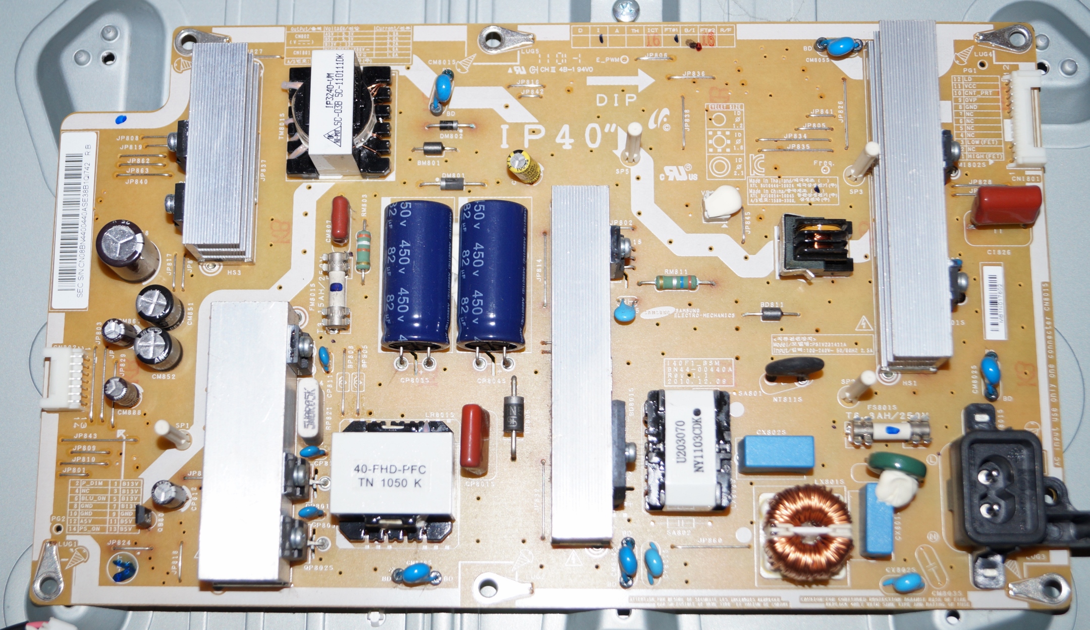

    Hi guys, picked this up this morning as spares / repair job, and it has no power what so ever. No standby.
    Checked all fuses which are good.
    So starting off on power supply, caps look ok but will test shortly. I'm thinking issue may be with bridge rectifier.
    I have tested it in circuit and the 2 middle pins seems to be passing current both ways on multi meter in diode mode. The +/- seem ok as they only work one way but the two centre pins seems to be shorted.
    Is it ok to test this in circuit or should I remove and test again?
    Anything else I should check out?

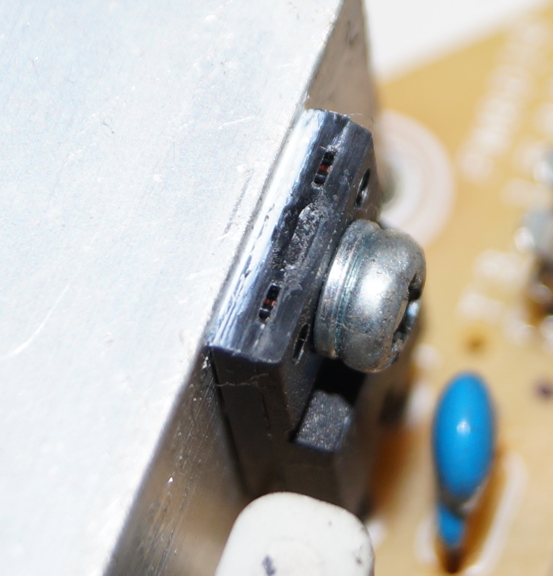

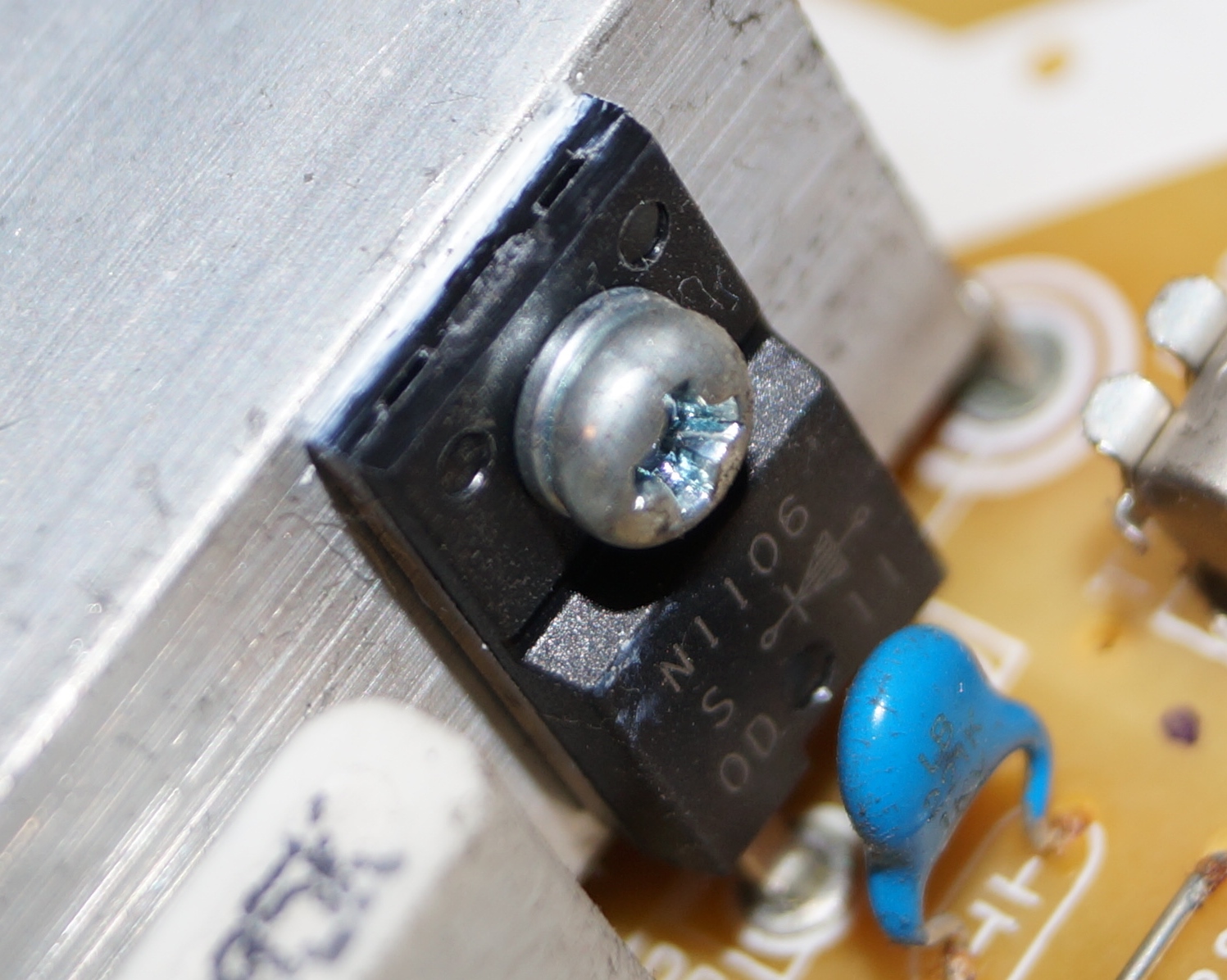

    So pulled it out and above was wrong, I had it on wrong mode but reading it now it only goes one way but
    positive probe to - on bridge rectifier
    - to ac = 0.47
    - to ac (next pin) = 0.47
    - to + = 0.86
    is the - to + @ 0.86 too high?

      So its completely dead? No 5V standby on pin12?
      You need to measure the voltages on the PSU from the outlet untill it stops.
      I think its a mainboard problem , do you know any history of the tv?

          No 5v on the connector on the left of the board, unplgged the cable at the main board side and measured on the connector itself. In fact none of the pins seems to have any current in them. (so no 5v coming out of the psu board)
          Ive measured 330v dc on the main caps

            Whats the type of the tv? For example : LE32D580K2K
            Maybe we can find a service manual for this tv.
            So you measure some voltages on the hot ( high voltage ) side of the board. Is it the picture or is one of the mosfets on the left of the big blue caps damaged on top?

              The fet next to the fuse

                LE40D580k

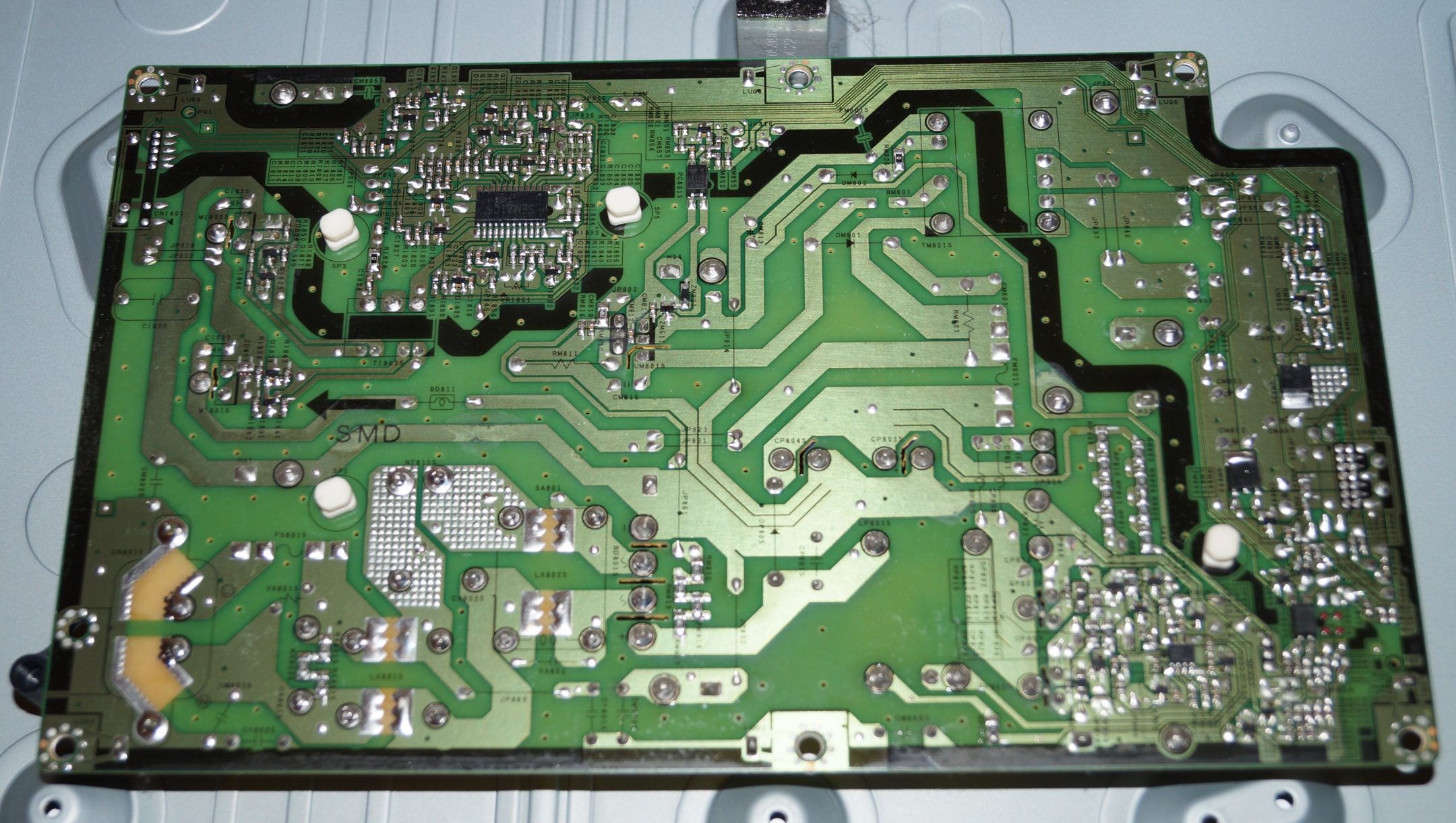

                Might just be picture, heres a couple more

                  Do you measure any voltages on the cold side of the board? Hot is the area with the big caps and there is a white line. Any voltages on the transformer?

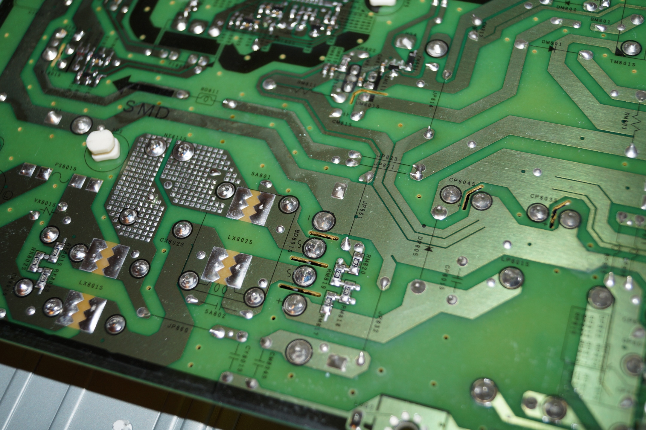

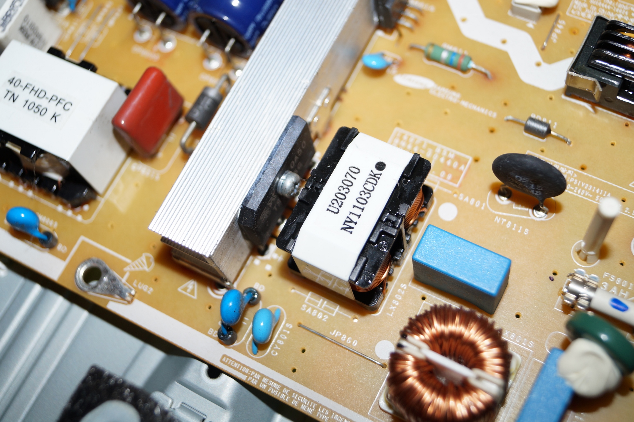

                      ill have to check, just checking the caps and they all seem fine. Testing the transistor next to the caps.
                      One thing, but perhaps I'm doing some wrong, was the fuse on the left has 330v dc going through it. But the fuse on the right near the power plug has no reading at all on ac or dc?
                      But how could the rest of the board be receiving power if that's reading 0?
