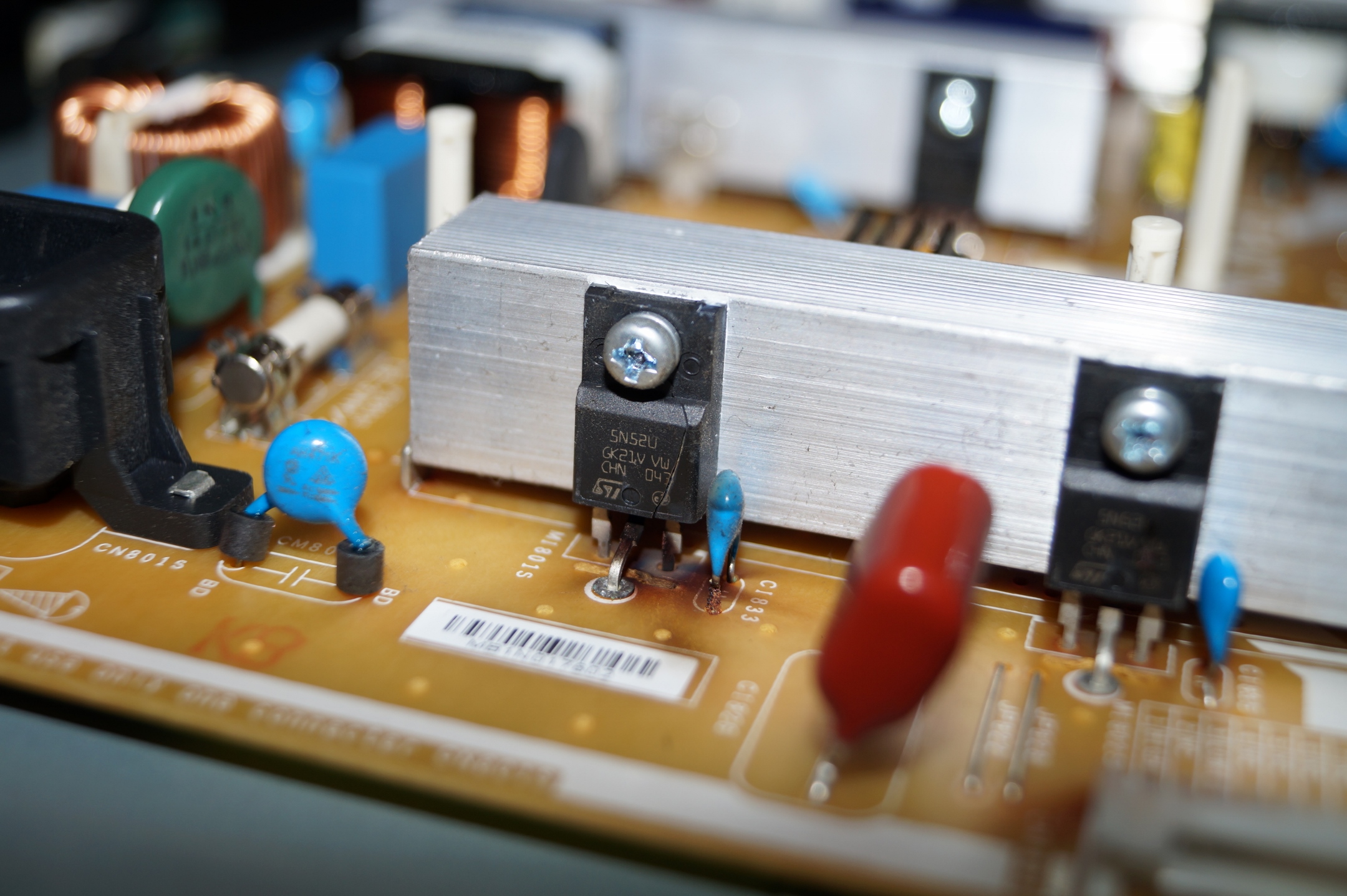

            Re: Samsung D580 LCD TV - No Power
            it blew up lol
            I might have done something stupid, was a ceramic 3.15a time delay fuse. I only had T8a ceramic fuses. so tried it with that and looks like something has blown scaring the day lights out of me!!
            transistor below the ac power in
            Might just order a replacement power supply, only £25?
              5n52u
              • Moreno83
                • Jun 2014
                • 2008
                • The Netherlands
                Aah that looks bad! Yes get a replacement and see if it works or not. Im almost certain that the ps is bad.
                          You have blown up PFC Voltage booster power MOSFET. That MOSFET was OK before you replace the second fuse (FM801S) for the output of the boosted Voltage otherwise you would not have 170VDC on the main cap before.
                          So beside blown up MOSFET for the PFC, you more likely have shorted parts on the output side of the fuse.

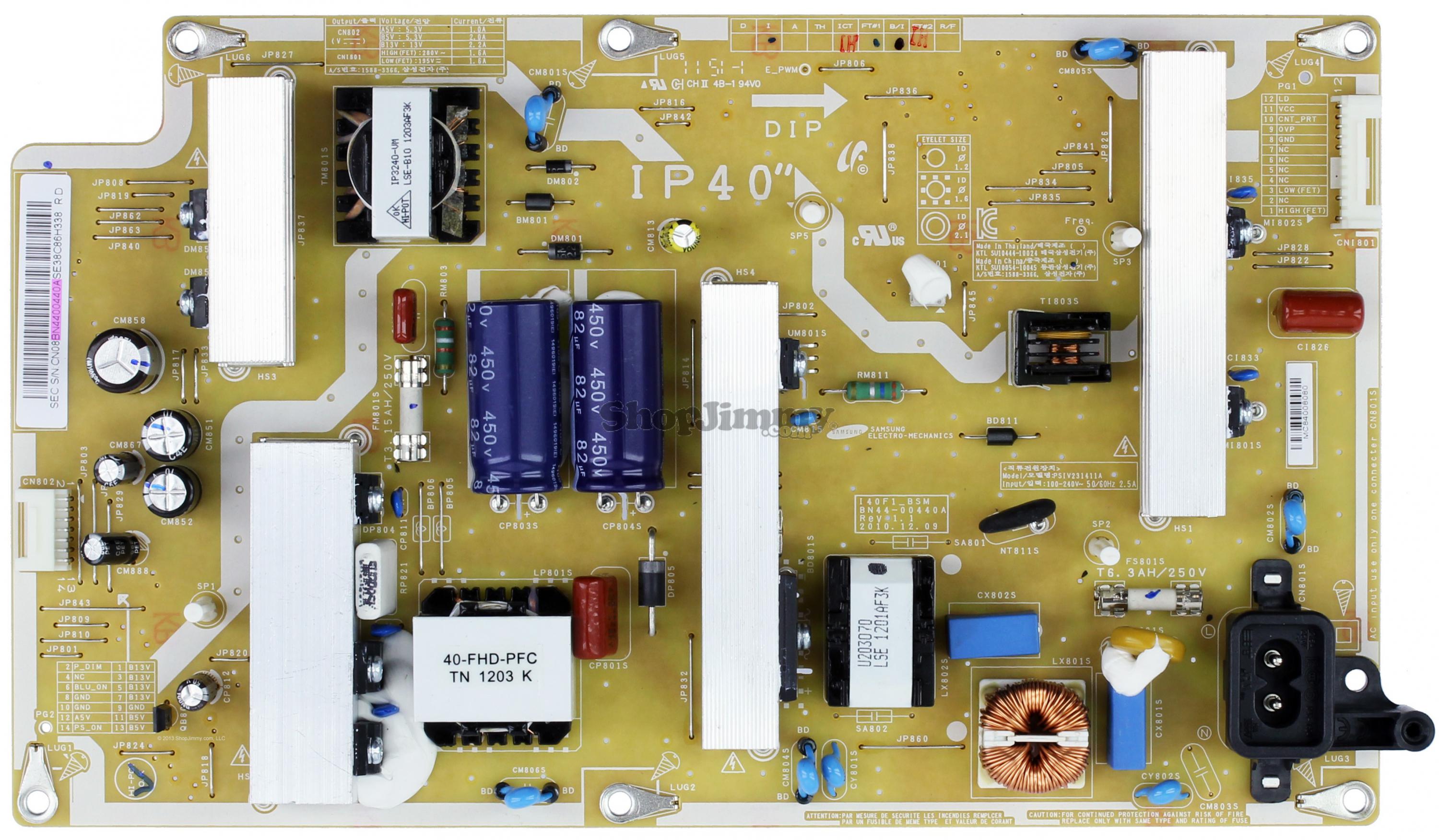

                          Pictures provided by SHOPJIMMY.
