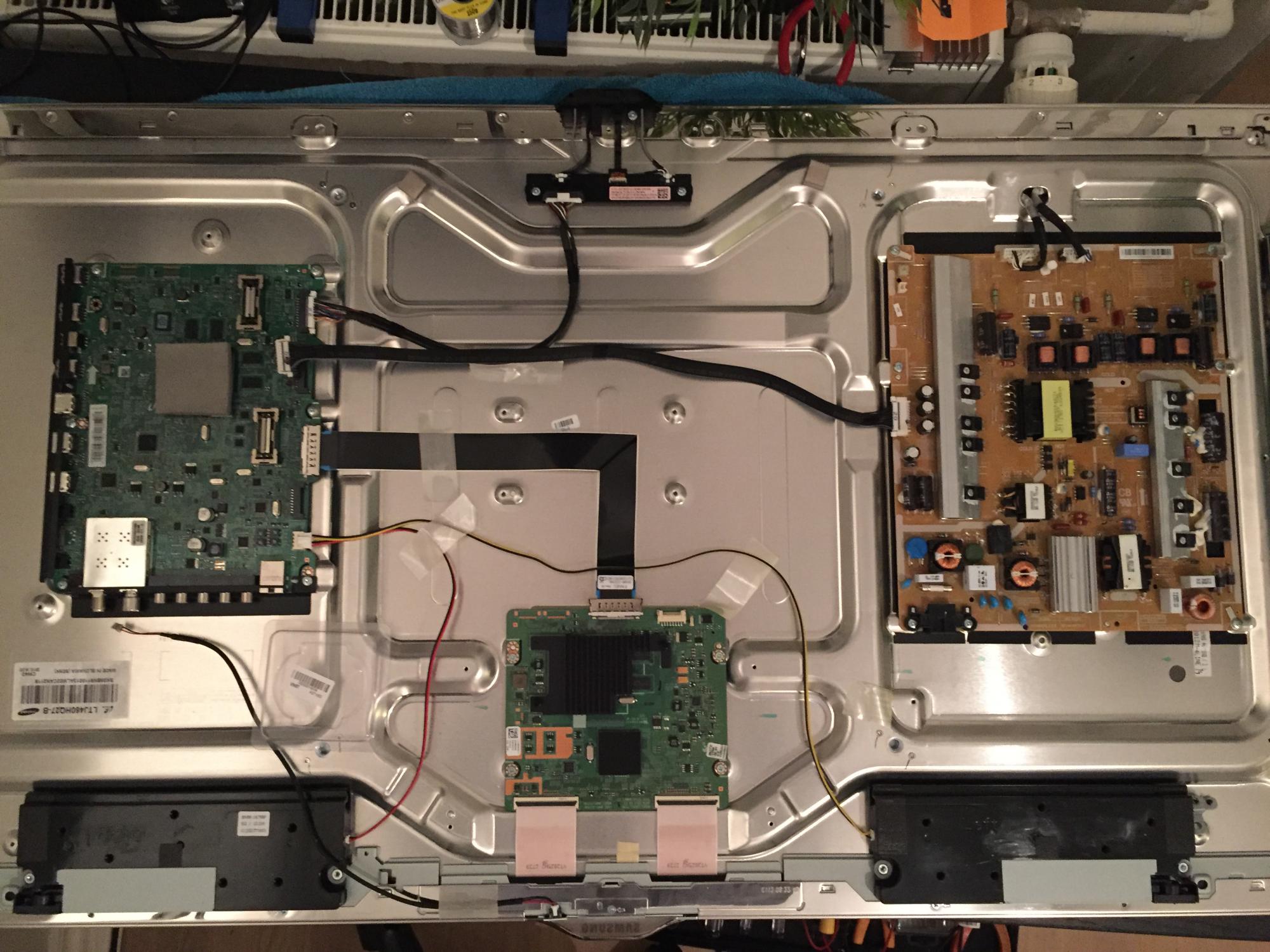

    Re: Samsung LED TV troubleshooting. Help is very appreciated!
    Here is a picture

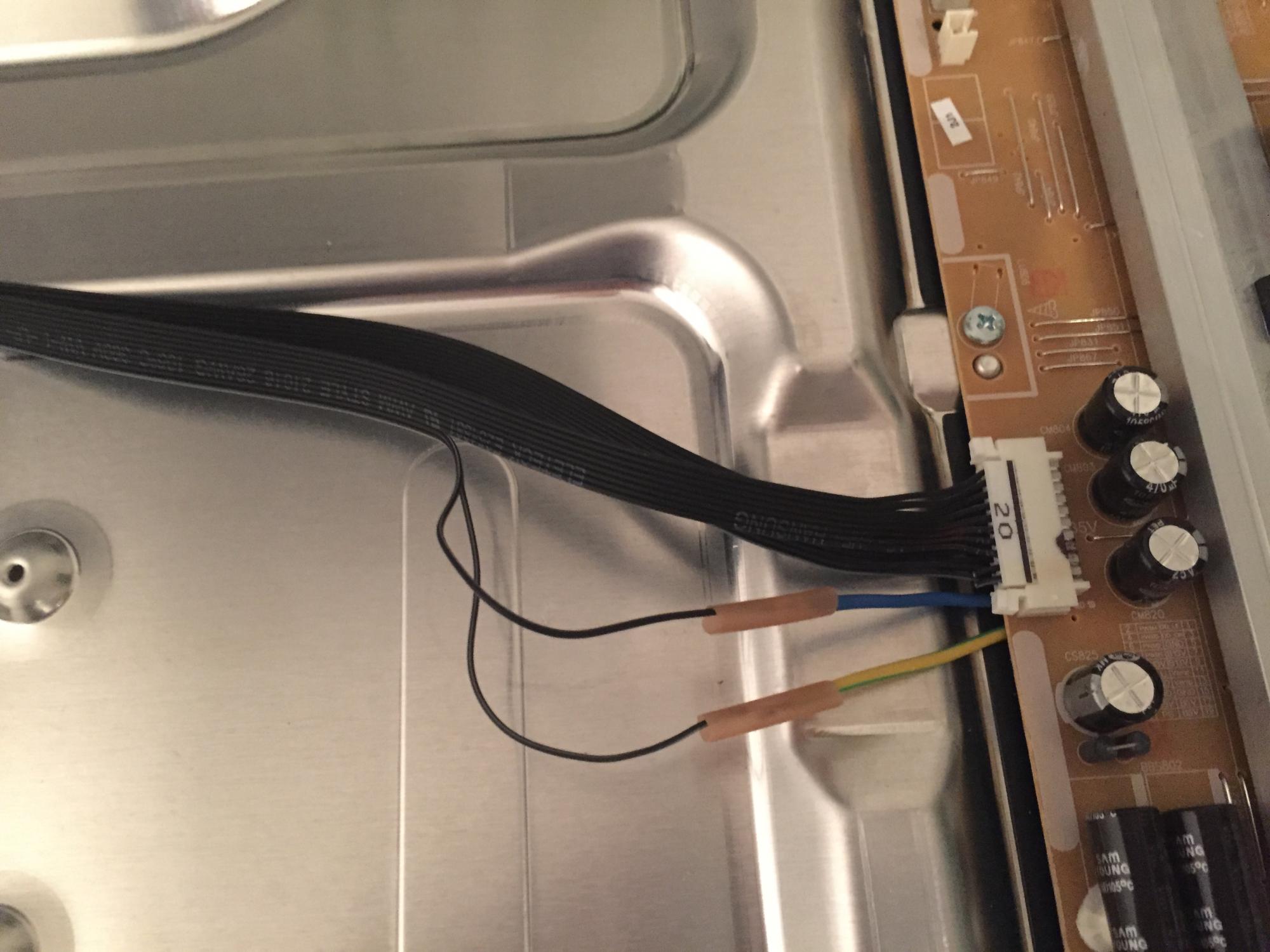

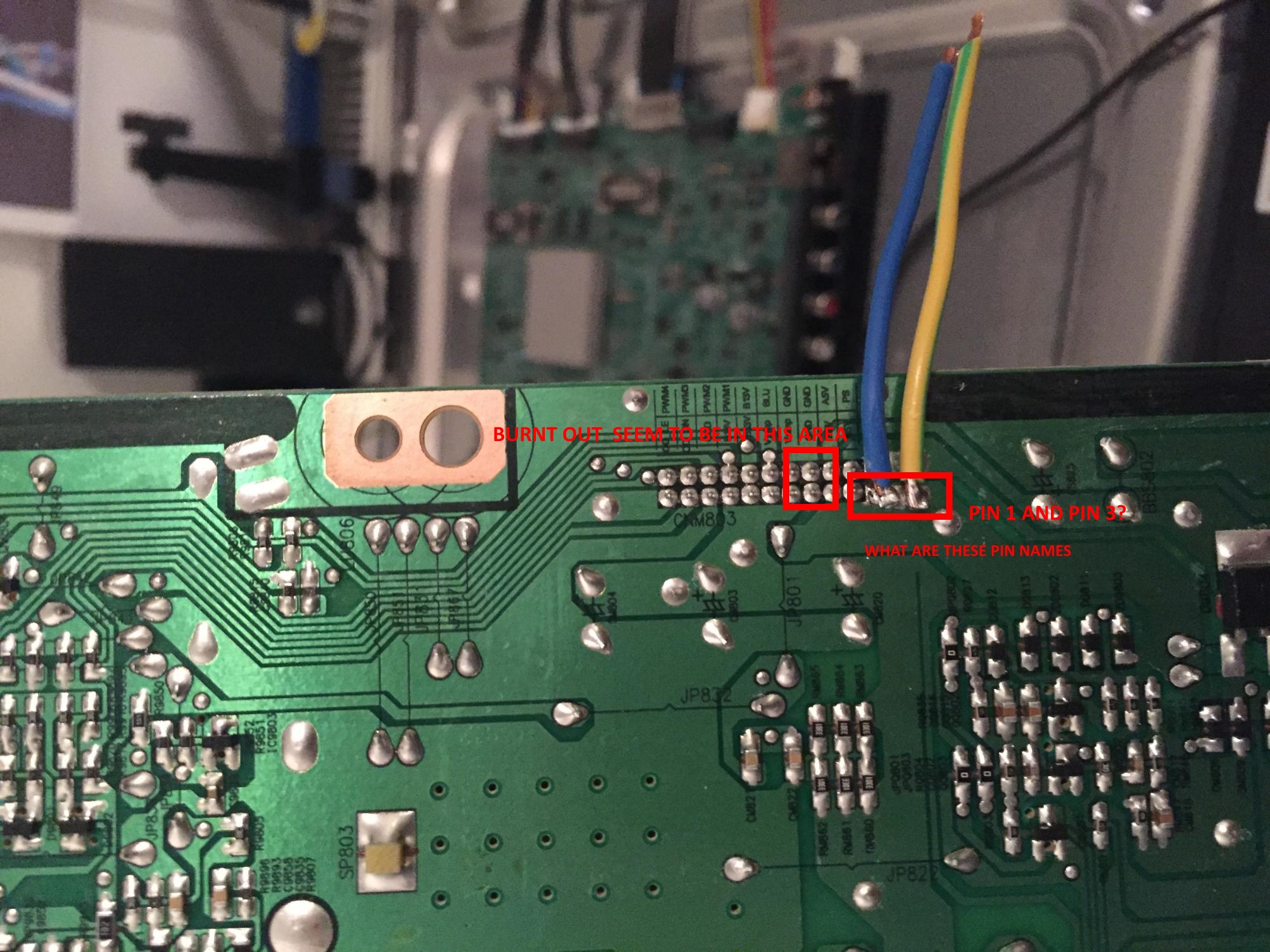

            Thank you! I have just tried to solder a cable directly from the pads but without luck. The TV is just clicking and the voltage is switching between 0 and 5 volts
              Can you show us your soldering with pictures please ?

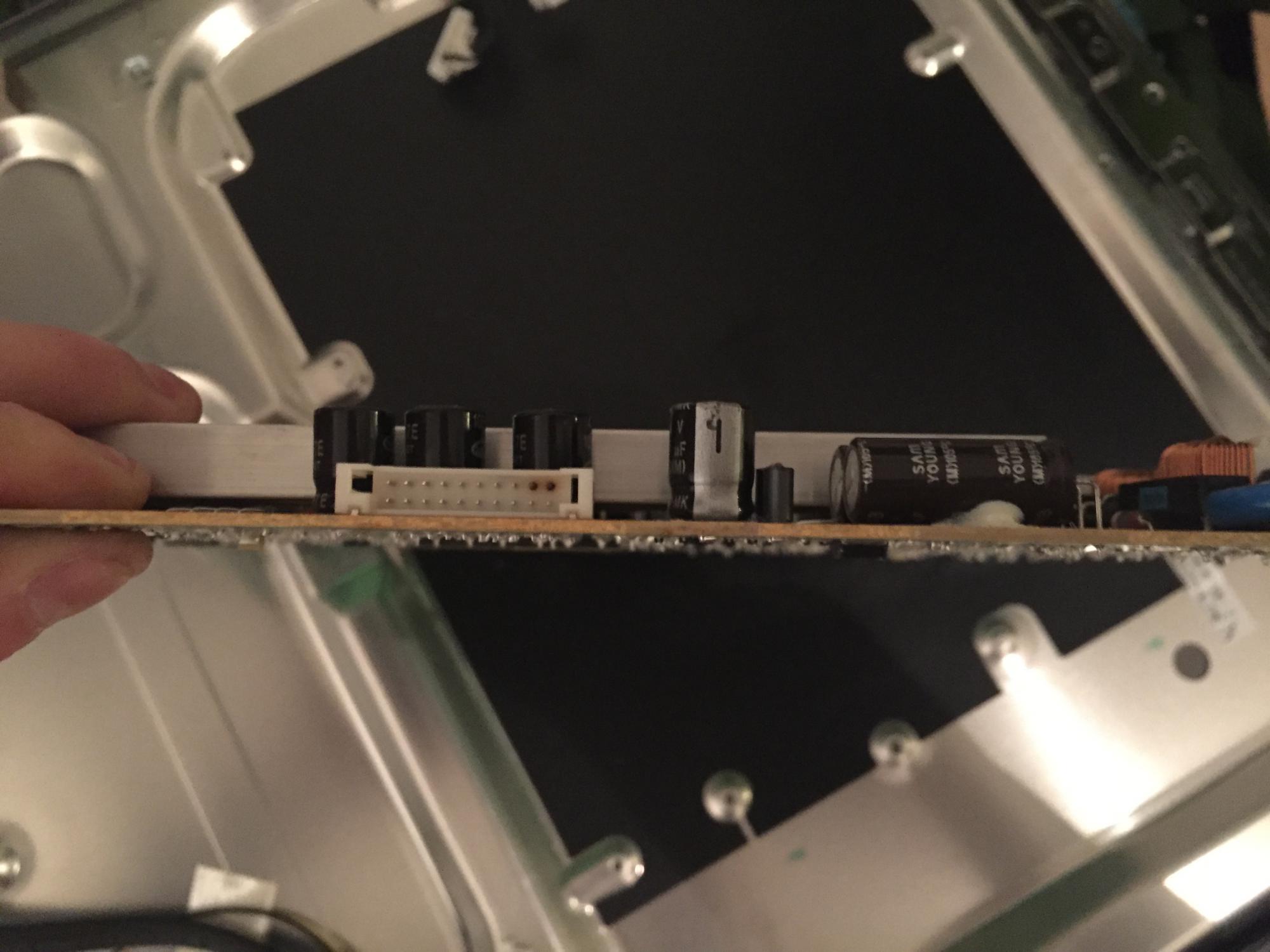

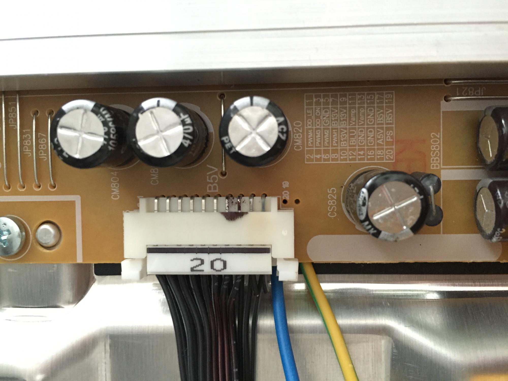

                Yes of course!

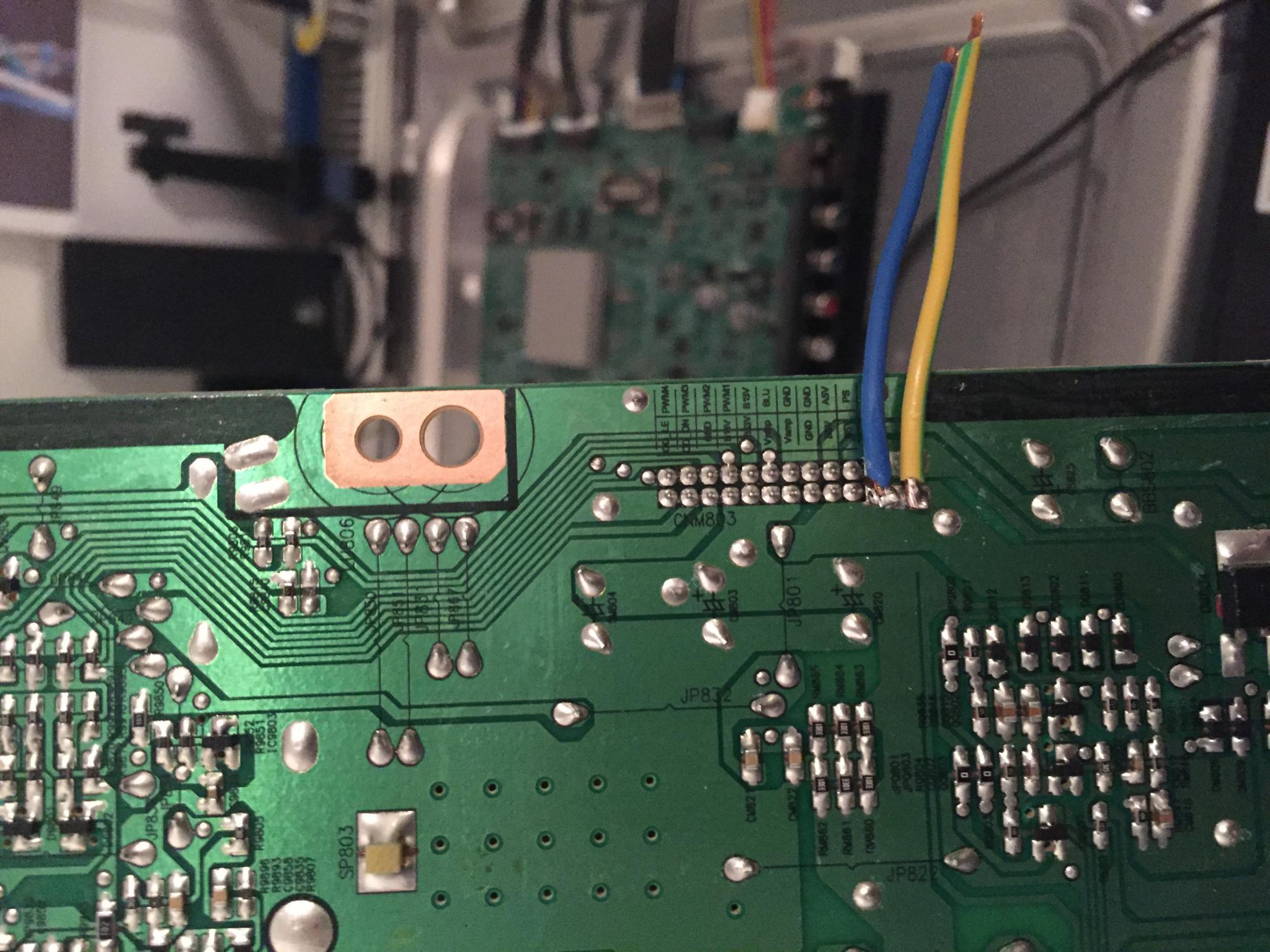

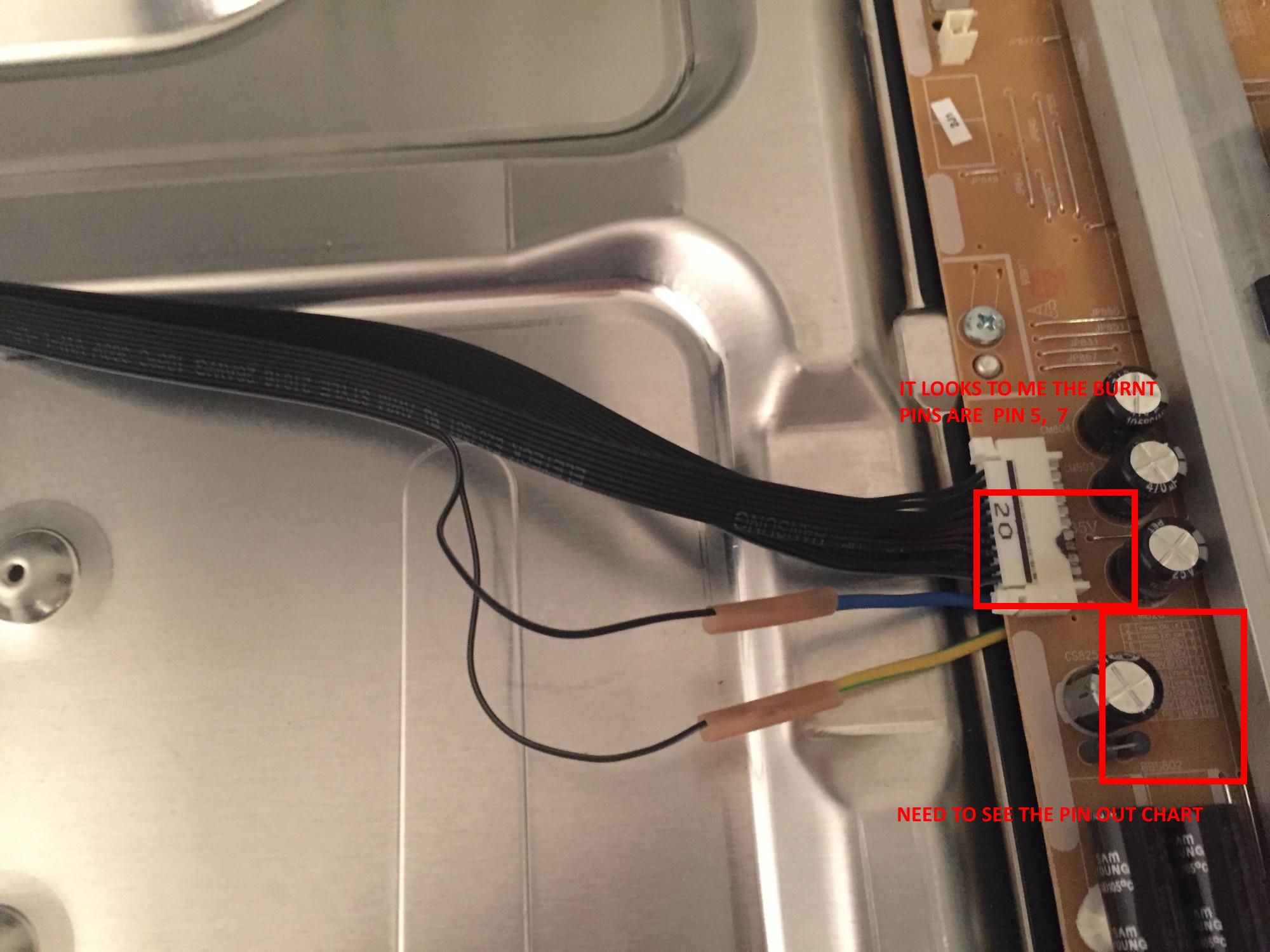

                  And this
                    In the first picture them pins look shorted together, resolder them or check for continuity.
                      Can you pull the connector so we can see which pins are burnt up?
                      Also the new wires are in the way and they do not look like they are for the burnt out pins.
                      Straight shot pictures of the whole top and bottom sides of the power supply board?
                        I have attached the cables to two free pads on the same traces as the burnt out pins. There is no short so the failure is another place. Besides i Can measure a voltage switching between 0 and 5 volts on the mainboard at the right pins.

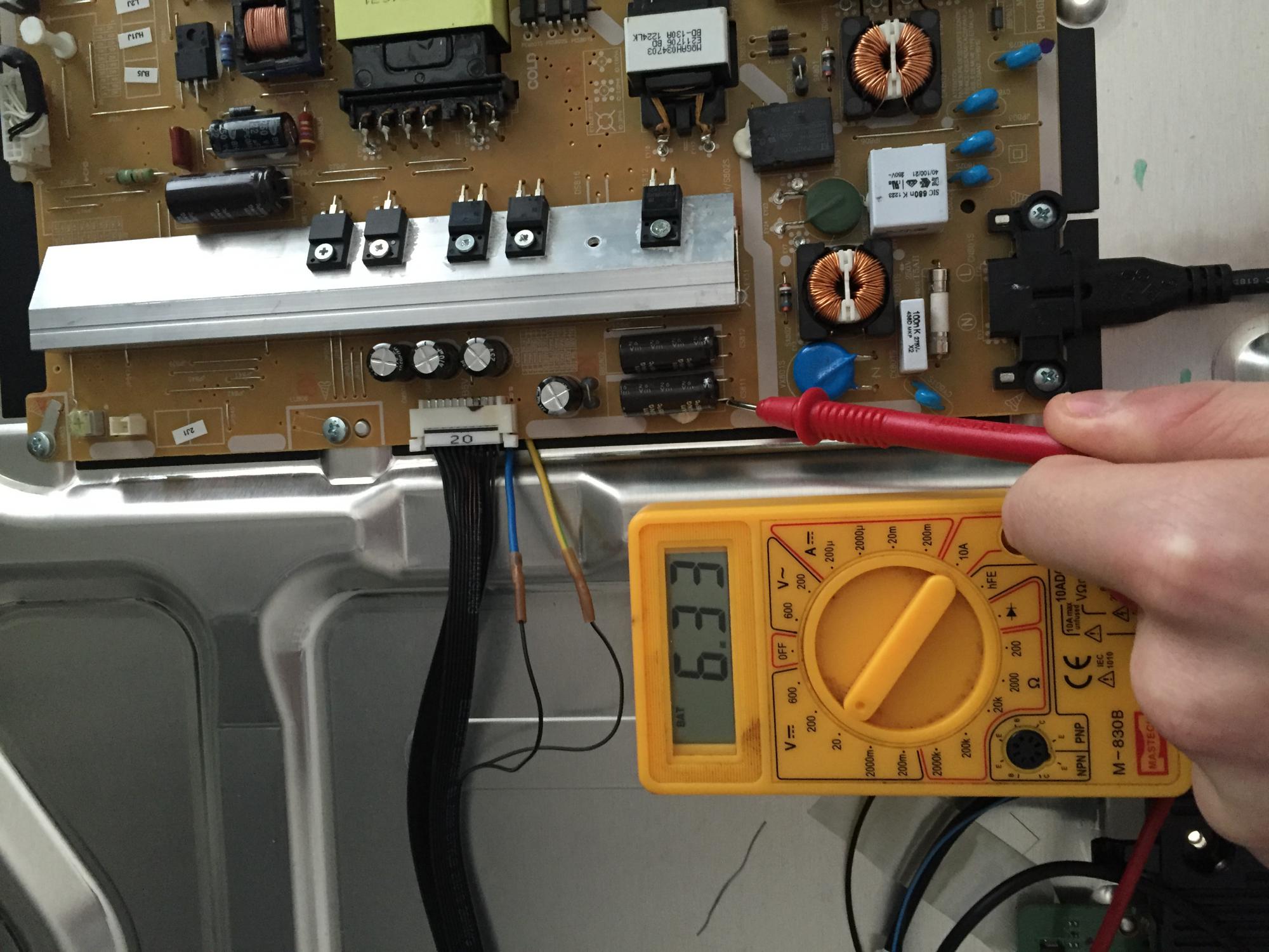

                          On the 5V pins i Can measure 6V in High State. I Can also measure a constant 6 V on the 5v condensator. Se picture. What Can cause this?
                            Here i measure the voltage
                              Never mind last picture. Meter was running low and showing odds voltages. I measure 5.3V on the 5V pin and 12.75V on the 13V pin
