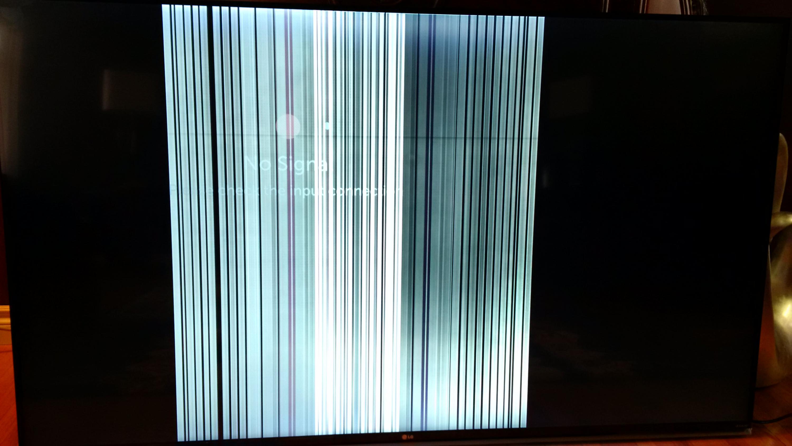

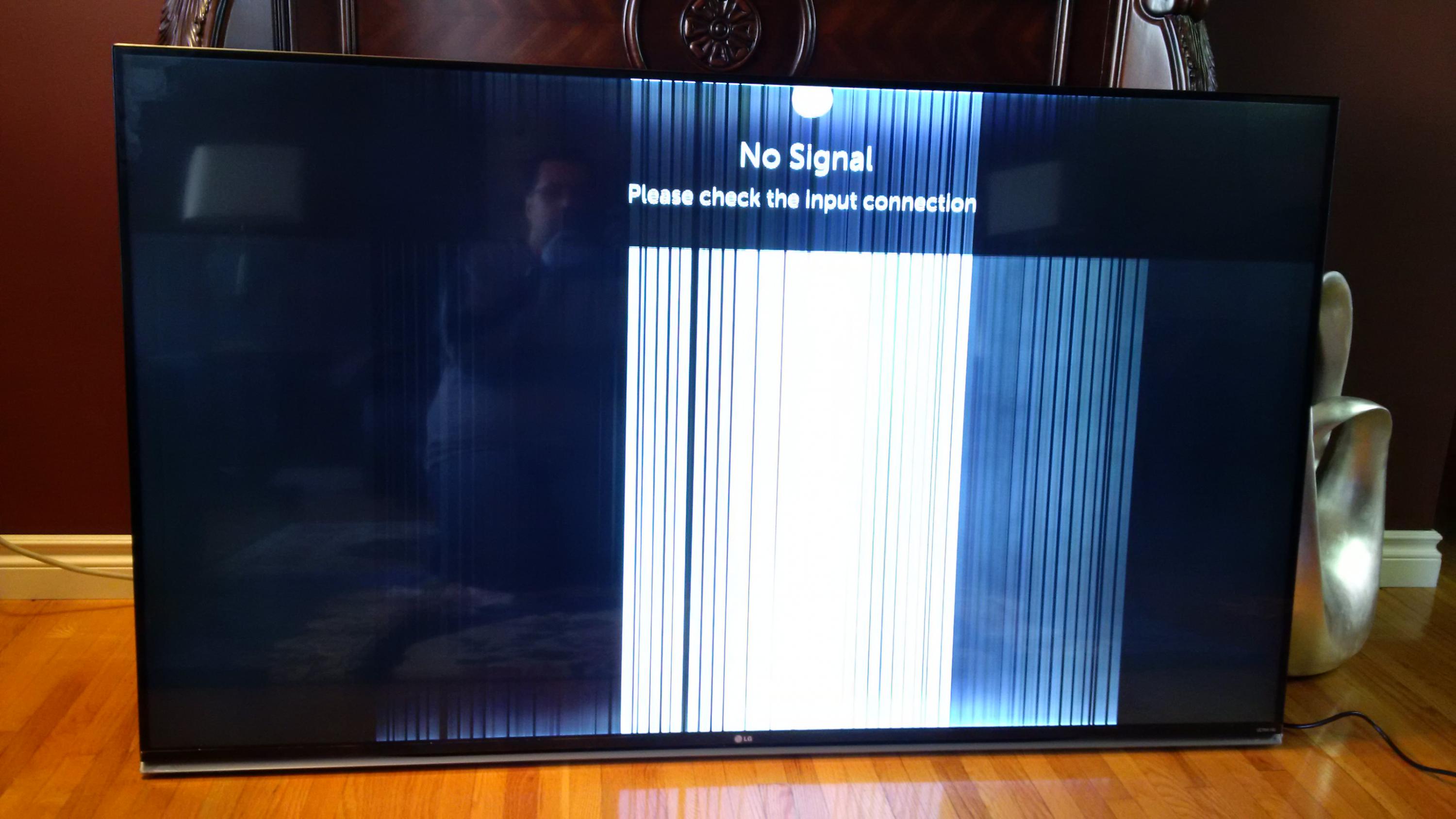

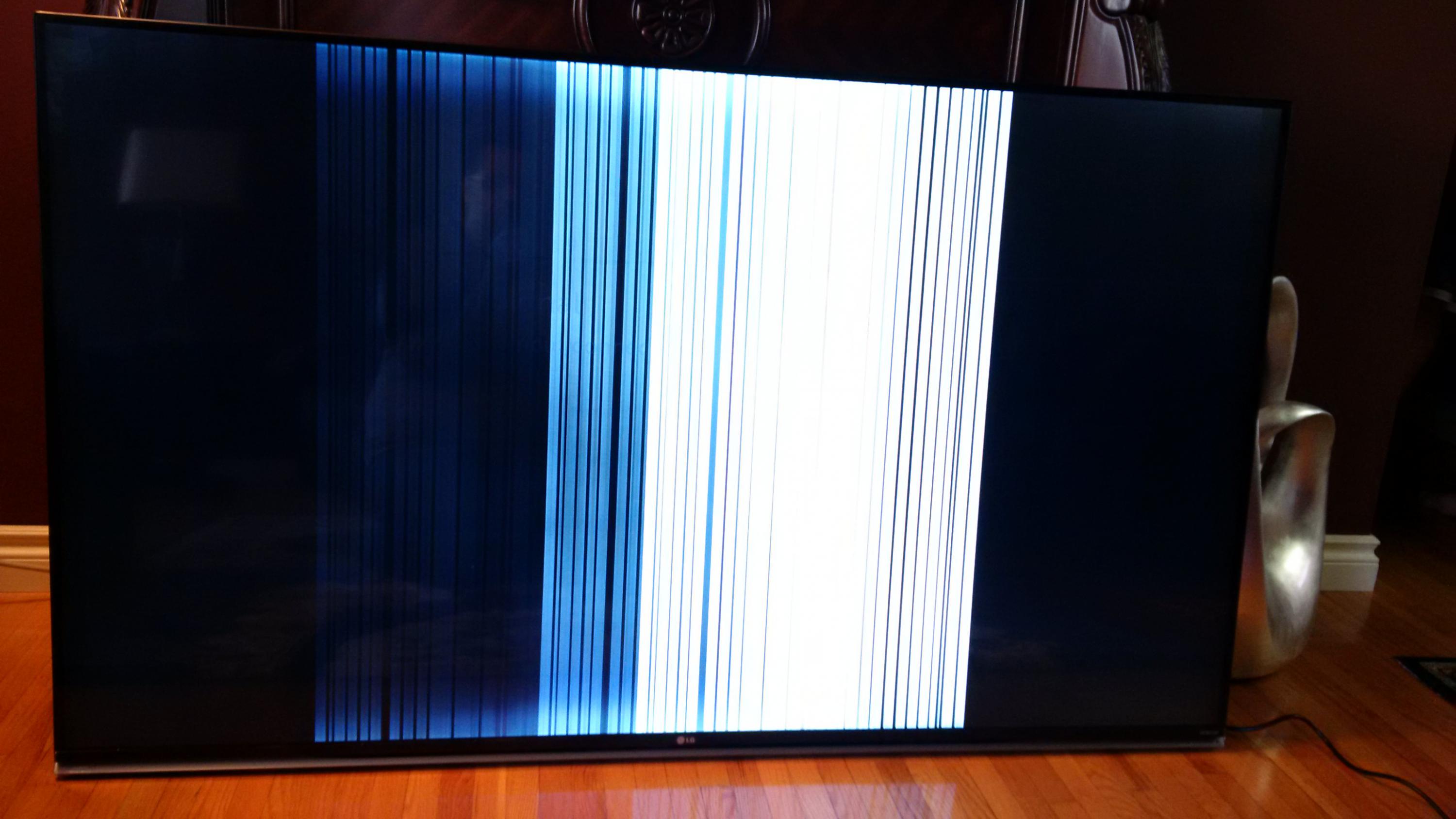

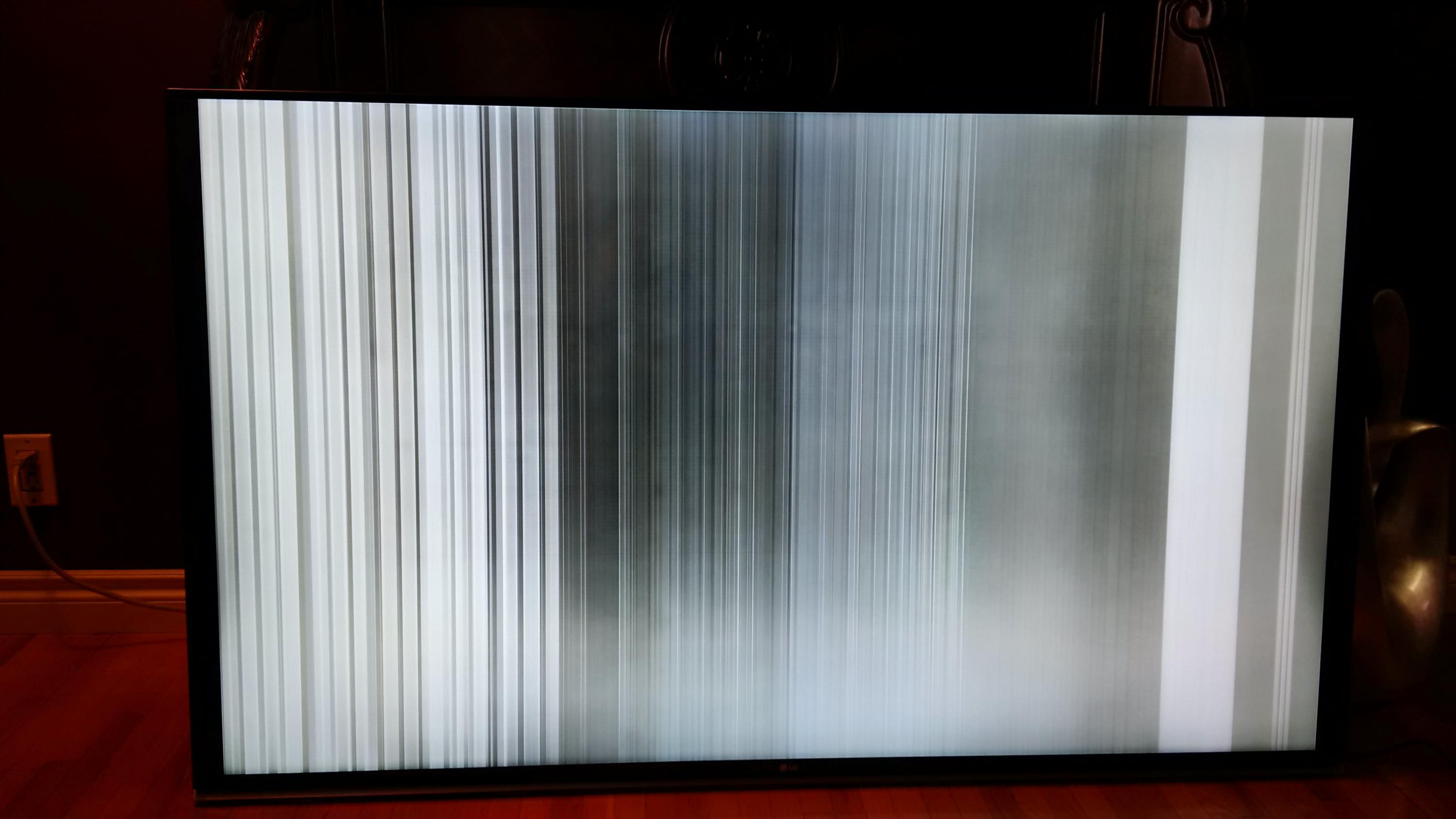

    LG 65UF8500 4K 3D LED Problem Tom66 or anyone else please help

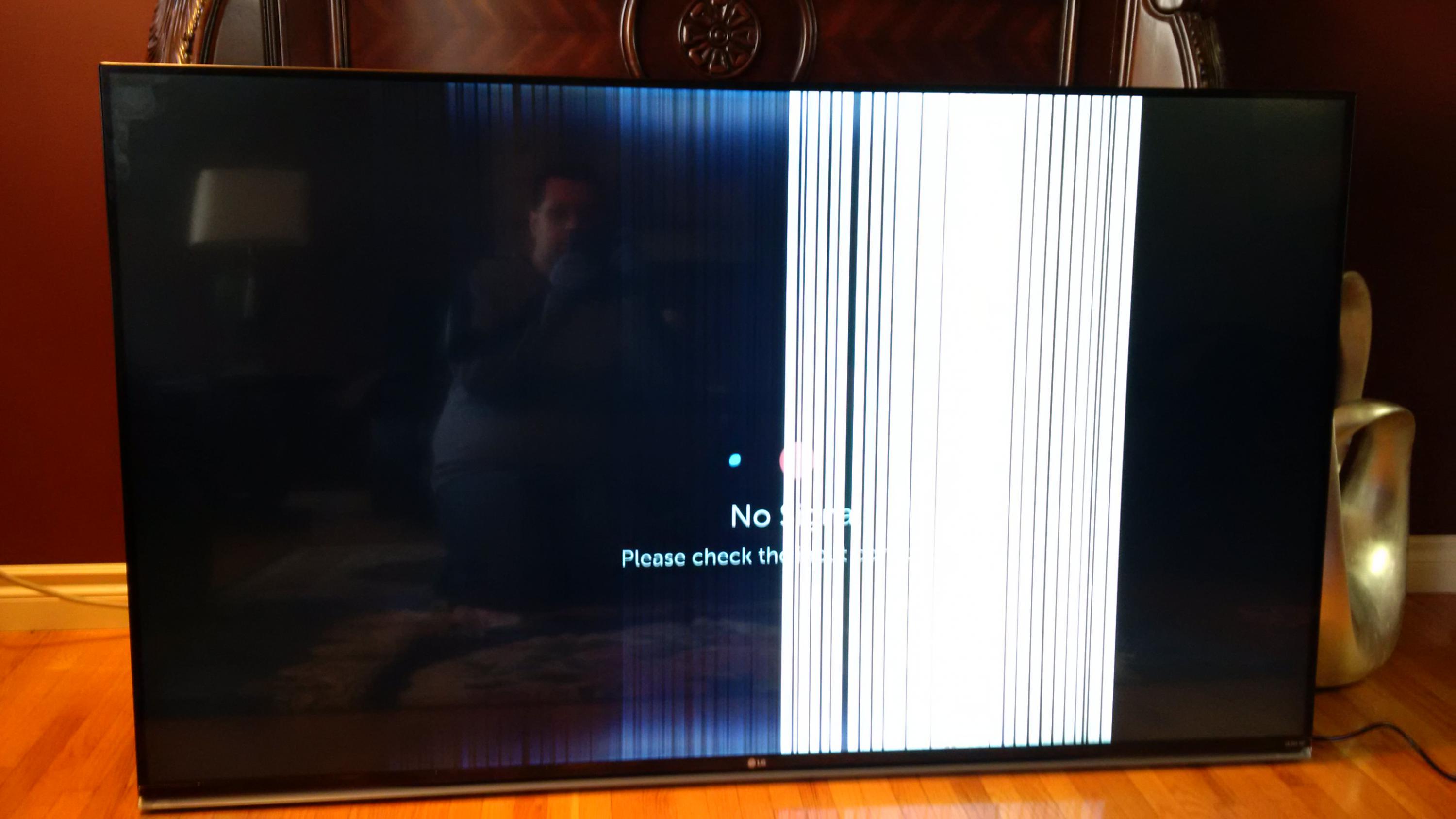

    When turning it on sometimes the picture is ok then after some time of it running all the lines start to slowly appear till the whole screen is full of the white lines. This happens with nothing plugged into the set so with no sources. While this is happening the TV still responds to remote and button commands. the lines change positions and also sometimes move. Trying to figure out if this is a Panel, TCON or Mainboard issue any ideas anyone? screenshots attached.
  • freakaftr8
    • Oct 2012
    • 3743
    Re: LG 65UF8500 4K 3D LED Problem Tom66 or anyone else please help
    This is looking like a fault in the panel. The fact that the lines slowly show up tells me that a tab fault is occurring in accordance to the heat that it takes for them and the led strips to light up.
    Also have a look at your tcon board. Try to reseat all cables. Could be a bad connection on one of the LVDS cables going into the tcon.
    Is there still a warranty on this tv?

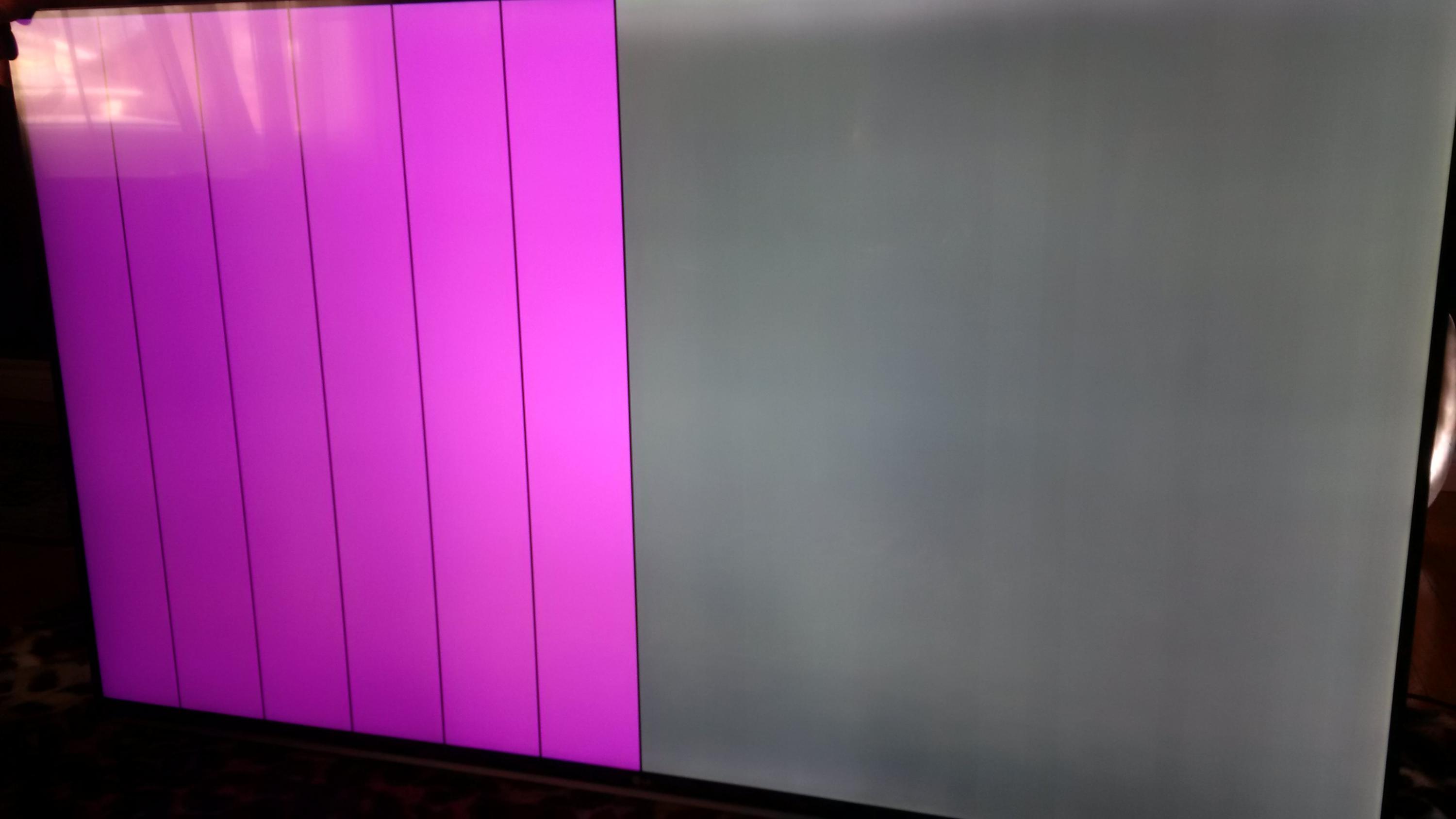

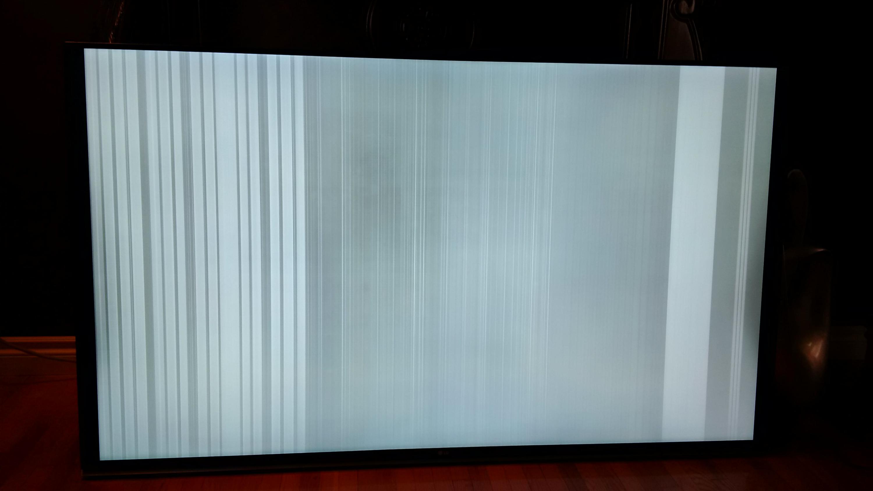

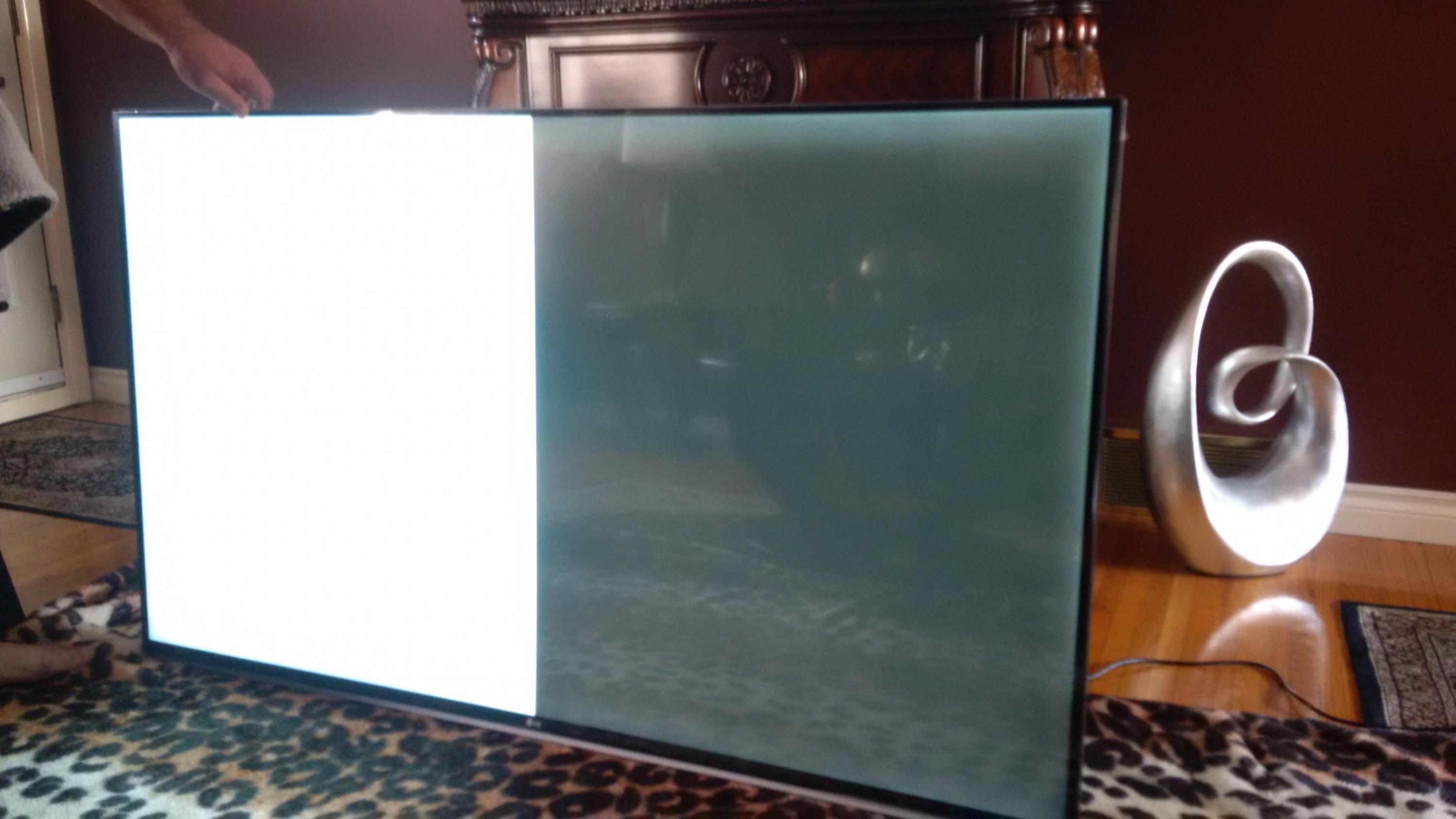

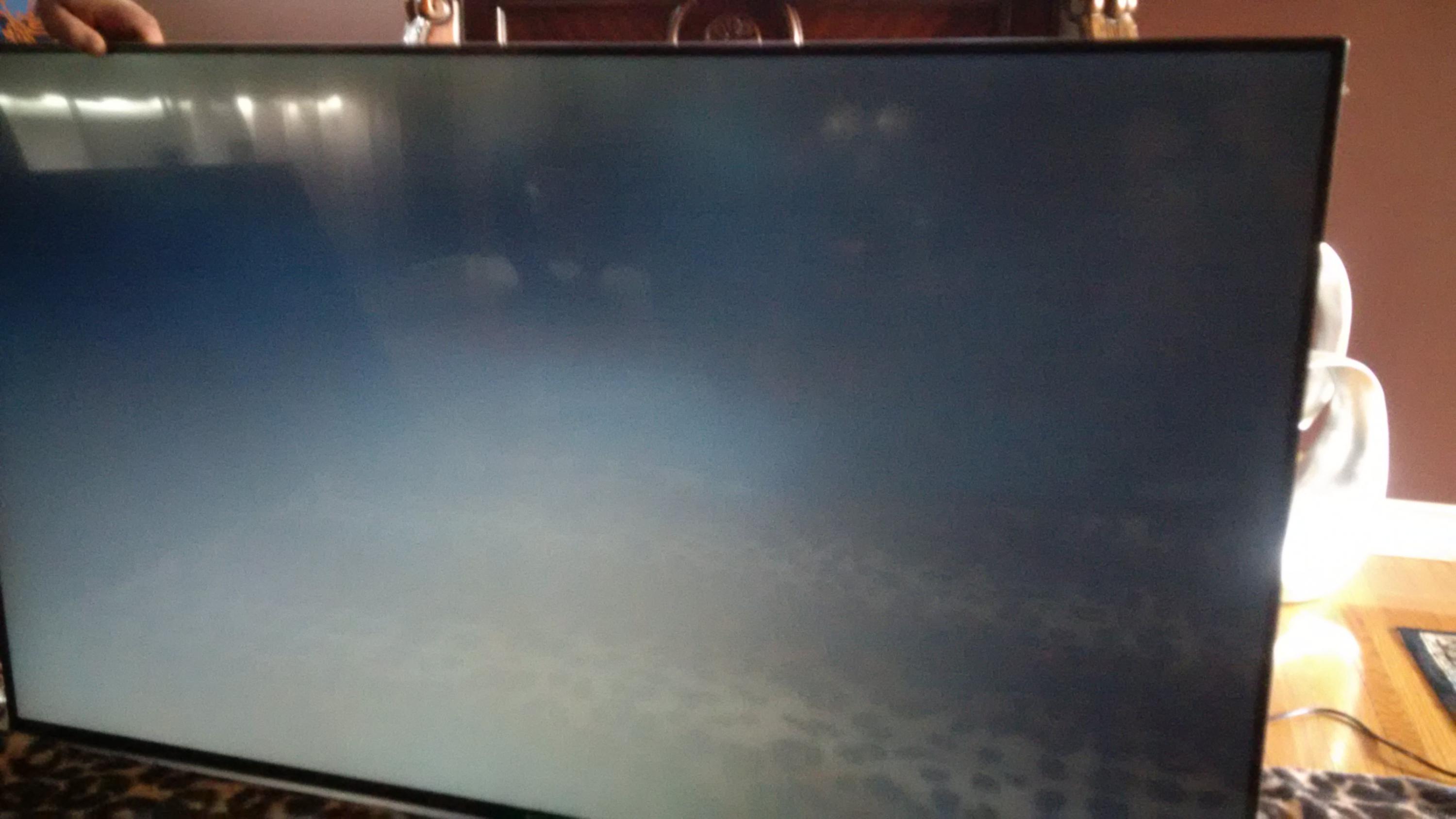

                Sorry guys for the late reply I just got busy finally got around to trying the suggestion any how here are the pictures of the results...
                the first picture with pink bands on the left is looking at the screen with right hand side disconnected
                second picture with the white on the left is looking at the screen with left side disconnected
                last picture is with both ribbons disconnected is just a complete black lit screen
                what do you guys think?
                  I would say Tab bond driver Ic failure, not fixable sorry see this before with similar artefacts. More Lcd junk failing.
                      Hi guys just wanted to let everyone in here know that I went ahead and ordered the TCON for this one and it fixed the issue. TV has been going for a few months now. Glad I took the chance because I was almost throwing away a $5,000 TV set over a $80 TCON board. I hope this info could help someone else with the same issue with this model that's why i'm posting the result.

                        • Nick's Tvs
                          • Jan 2014
                          • 621
                          Just saw this post,
                          LOOK AT HIS PICTURES THE MENU WAS UNAFFECTED BY THE LINES IN PICTURE 4. BAD TAB BONDING WOULD AFFECT THE MENU.
                          Menu unaffected = bad main or bad T-con
                          Bad LVDS in my experience usually affects the menu. Anyone have any experience with this they want to share?
