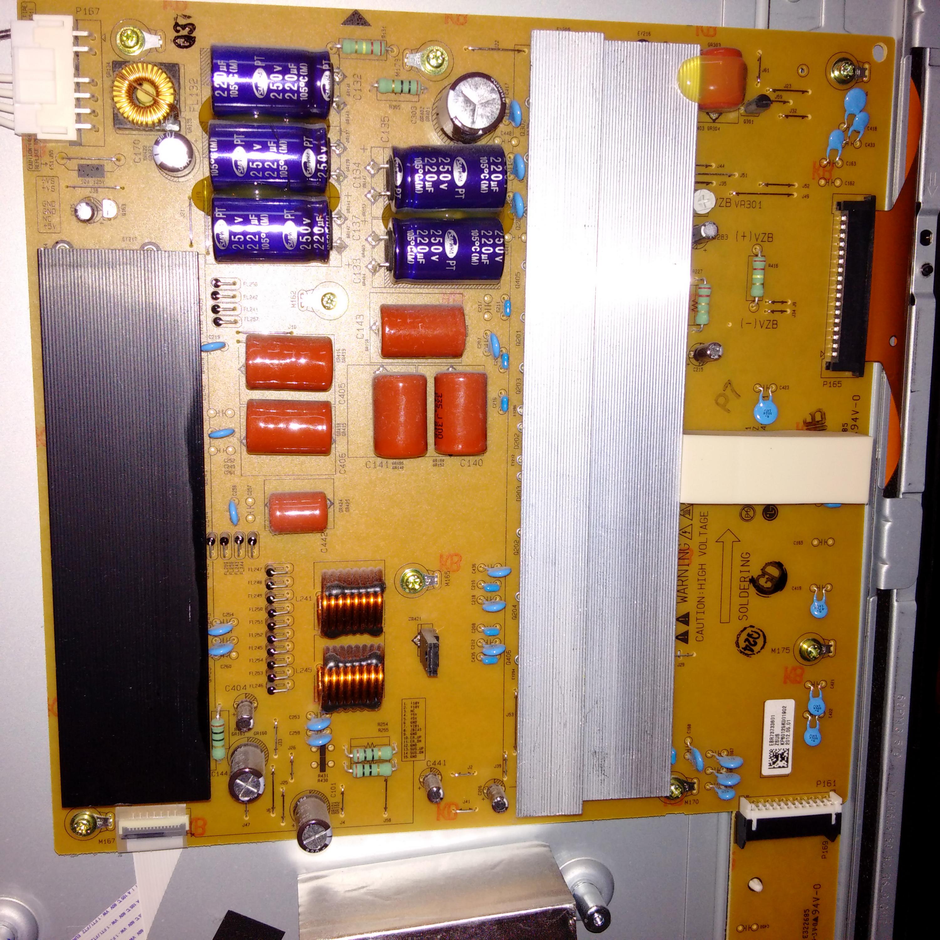

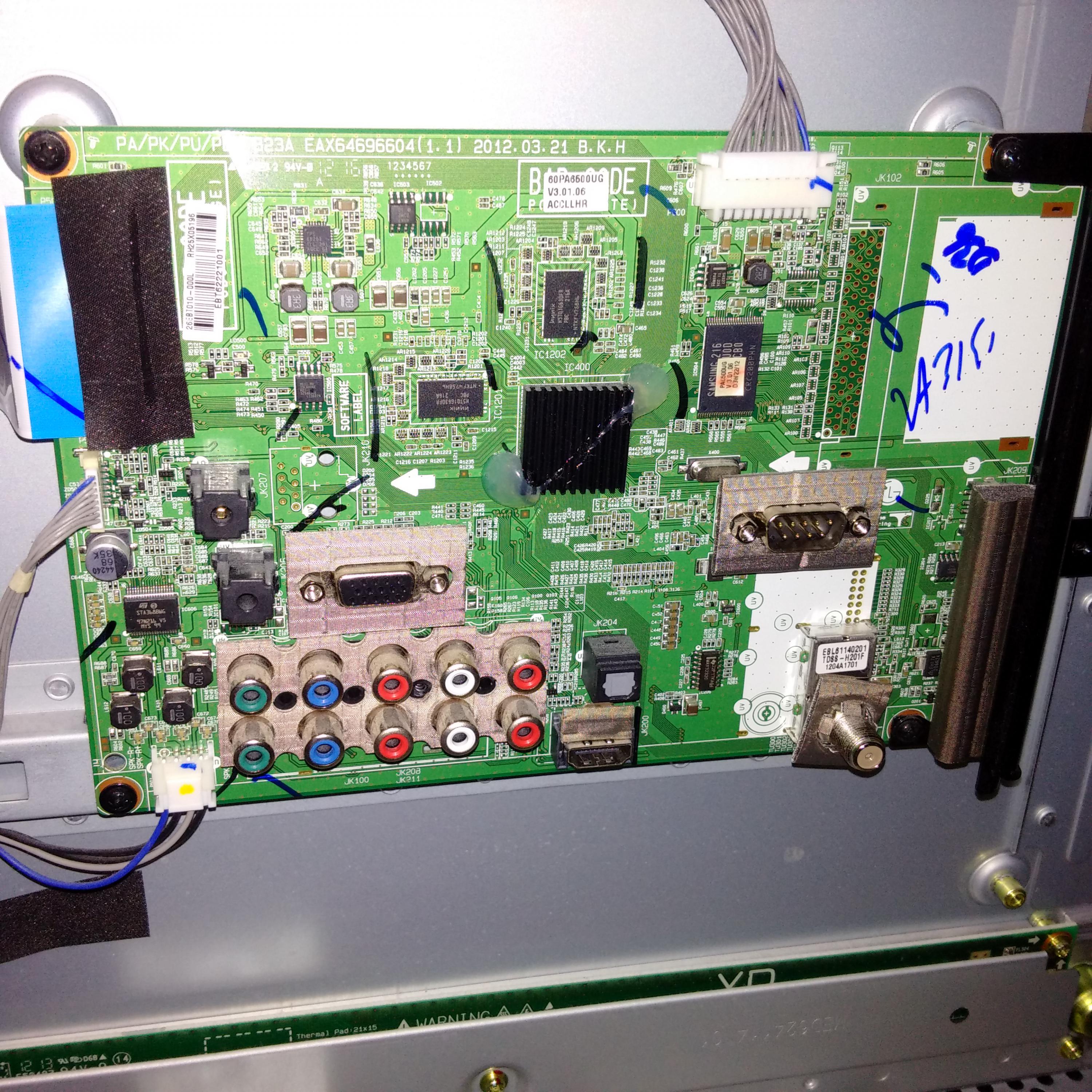

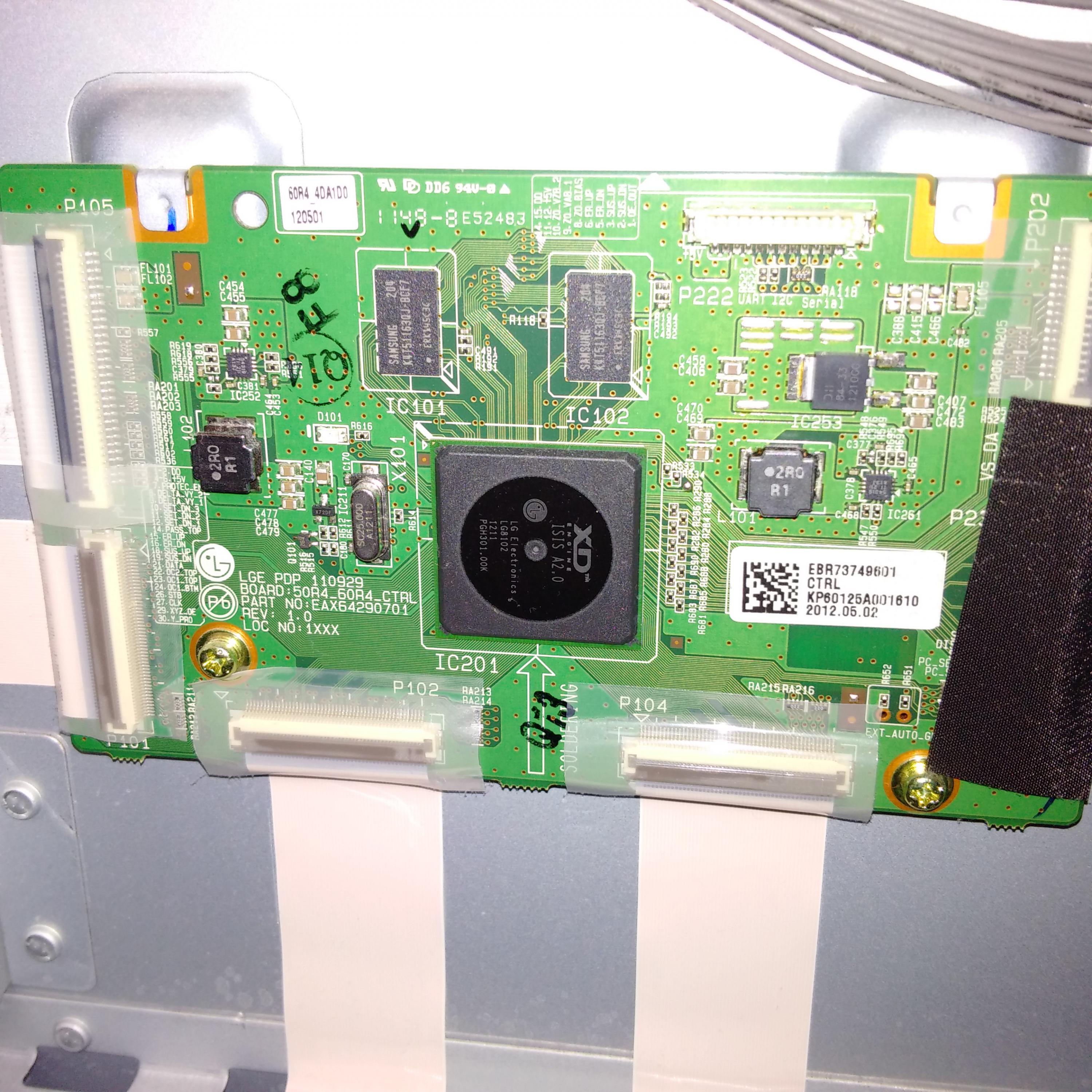

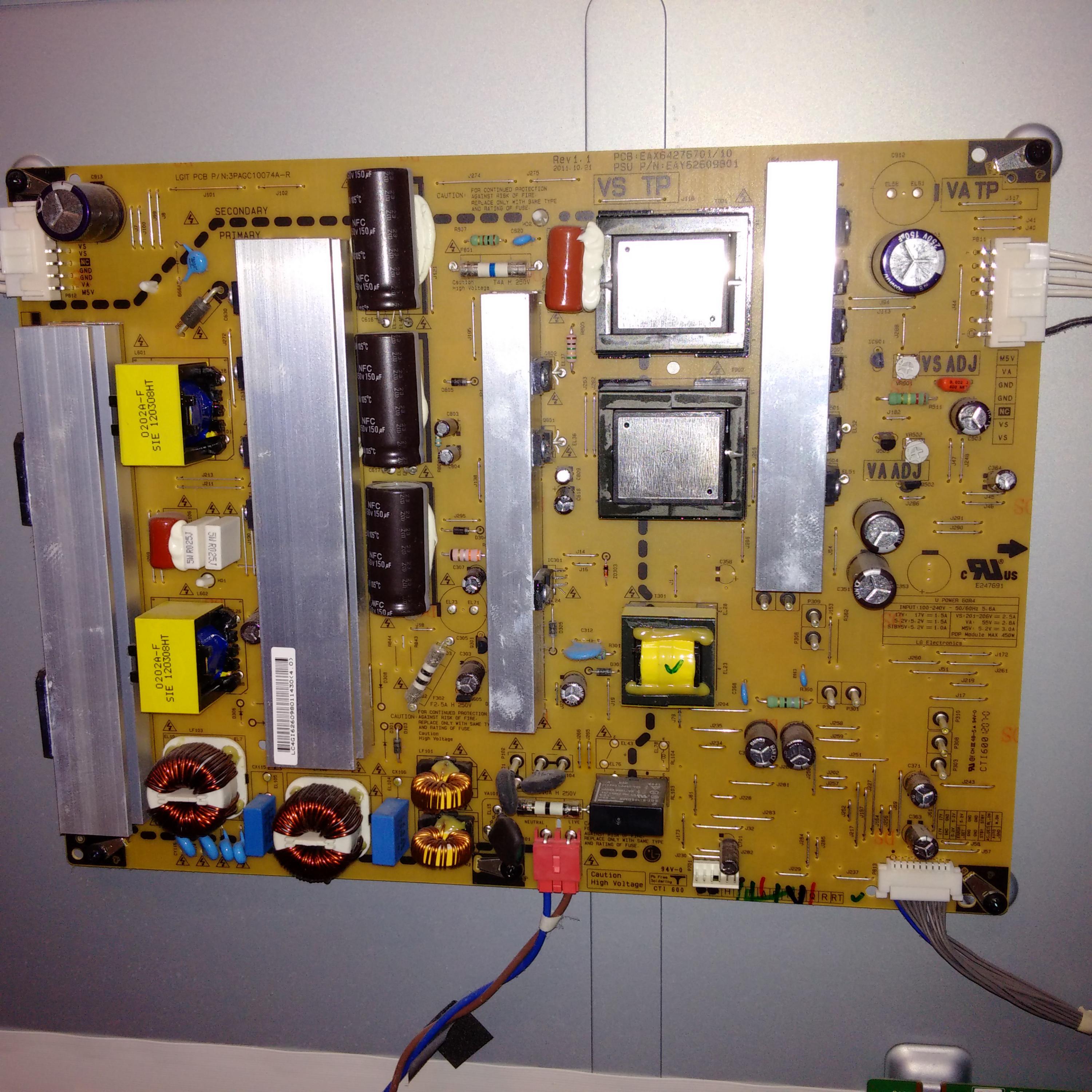

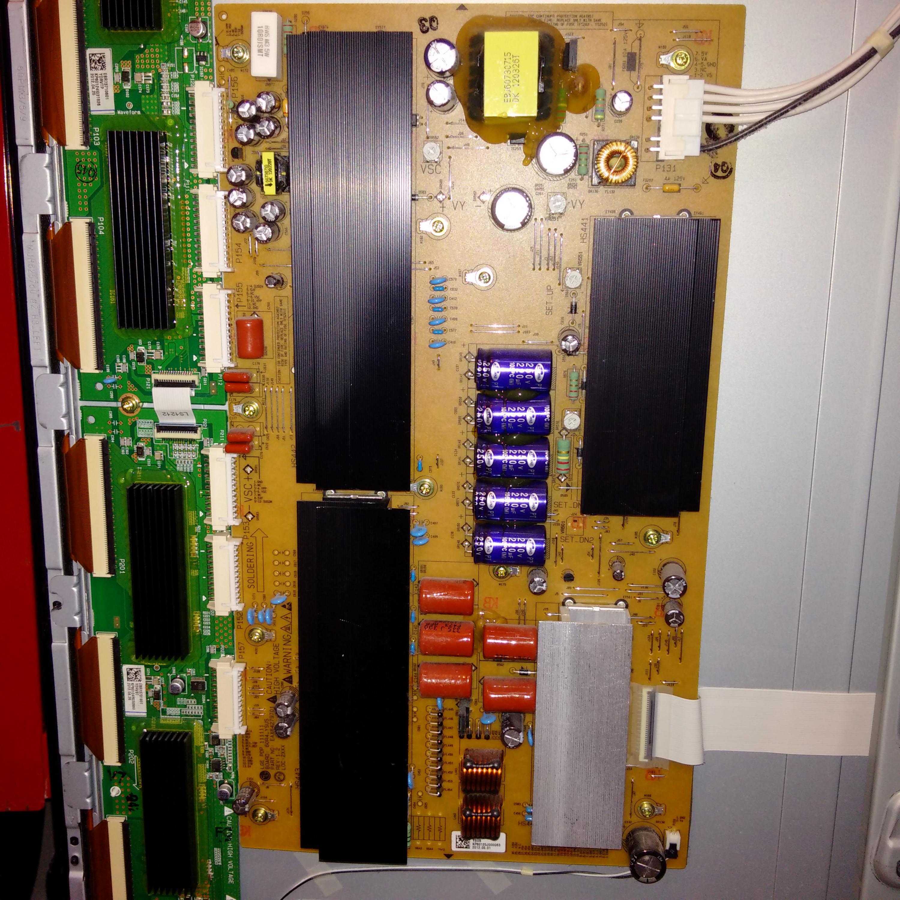

      Re: LG 60PA6500 image blanks after power on
      Here are pictures of the boards. I can find no visible problems.
      I'd appreciate some thoughts from someone with experience fixing plasmas.
                OK, on the CTRL board you can see a pair of holes on the bottom right hand of the board marked EXT AUTO GEN.
                Turn the TV power off (unplug the set)
                Place a wire link between these holes
                Disconnect the LVDS cable between the main board and control board
                Plug the TV in...do the test patterns cycle continuously?
                • Belgiangenius
                  • Nov 2015
                  • 9
                  YES!
                  I saw a number of solid primary colored screens cycle by, and also some with black/white/grey patterns scrolling through.
                  • Hamie
                    • Apr 2014
                    • 1383
                    You have a faulty main board.

                          So I hooked the main board back up to the CTRL board and the tv works fine now?
                            It's temporary. A problem going away on its own will come back just as easily. Probably a BGA soldering failure or failed flash memory
