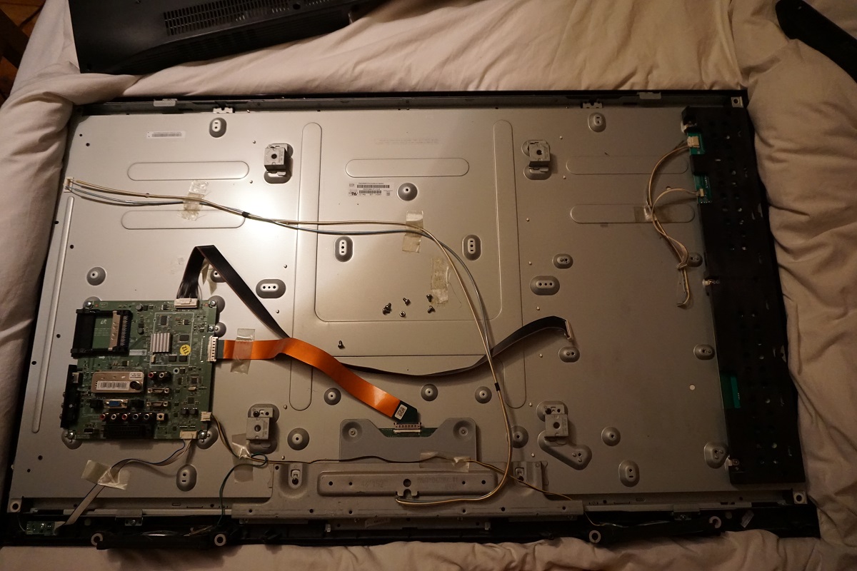

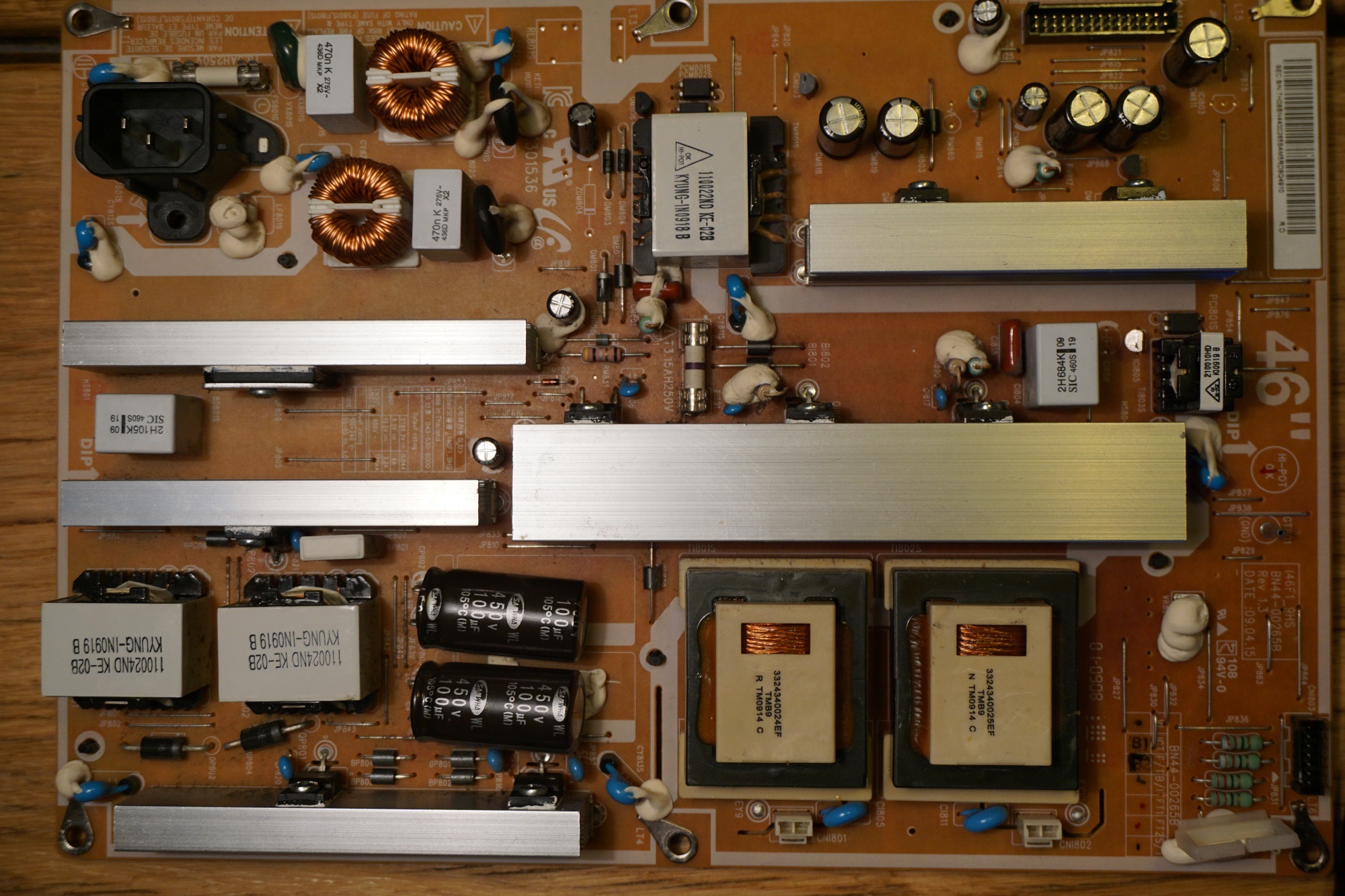

              Here are some photos - apologies that the cover is over the inverter board..

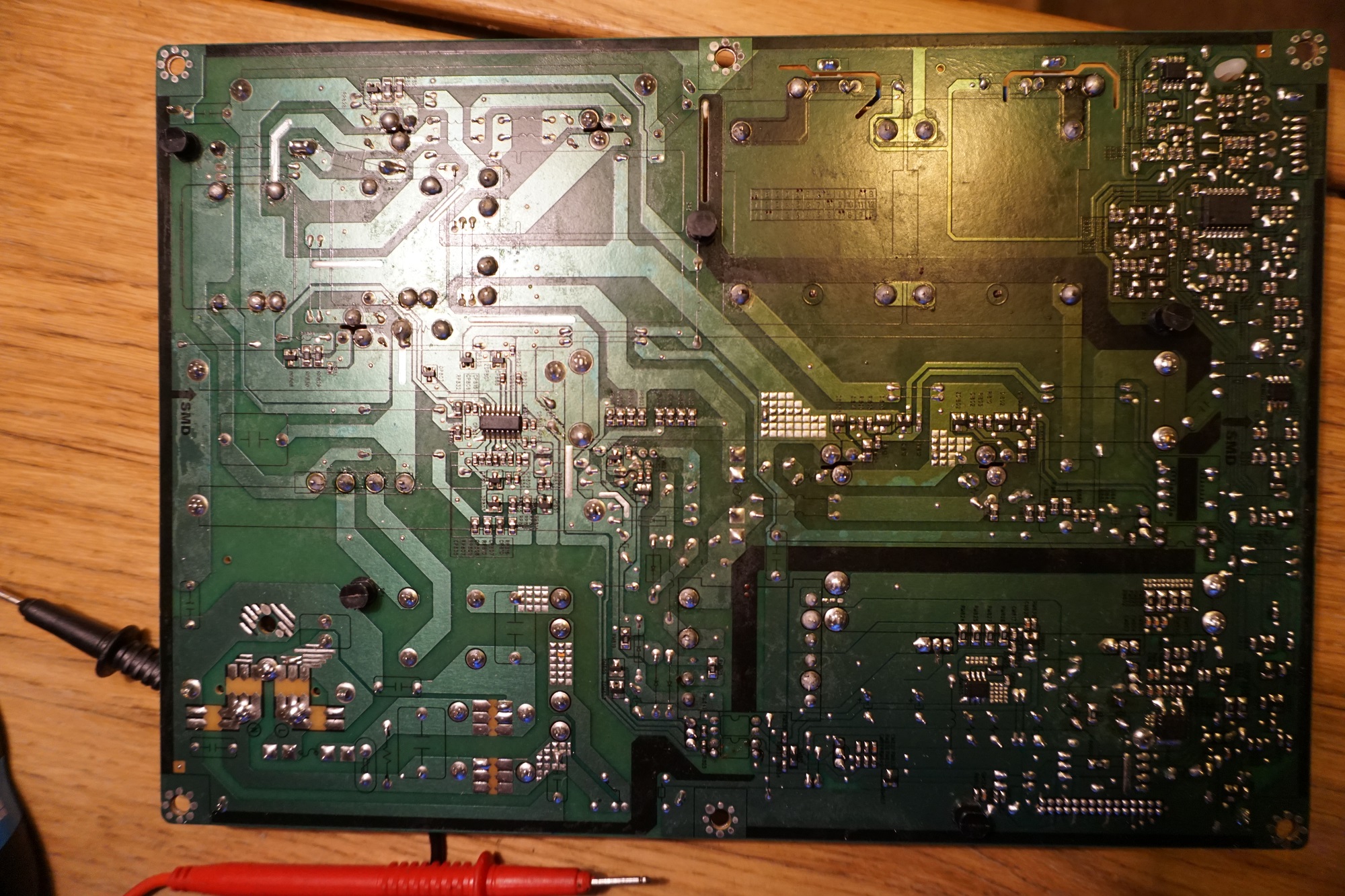

                Rear of the power board - can't quite tell from the photos but the underside of the transformers looks a little burnt and the whole board seems to be covered in something a little sticky?

                  I'd like to find out how to test the transformers but I can't find a schematic anywhere using those part numbers... TMB9 TM0914C and the long one across the top/s 3324340025ef 3324340024ef

                    That long board connected to the lamp is not inverter board, that is the balancer board. You have power supply/inverter board combo.
                    You need to check the LD (Lamp detect) pin on the power supply board, normal condition will be about 11VDC, not normal will be below 10VDC which may mean one of the lamp did not stay conduct which makes sense when you turn the backlghts level too low for the bad lamp (bad lamp connection) to stay conduct, it will only take one bad lamp to make the circuit to go into protection mode. It can also be the high Voltage is too low for the lamps to stay conduct.
