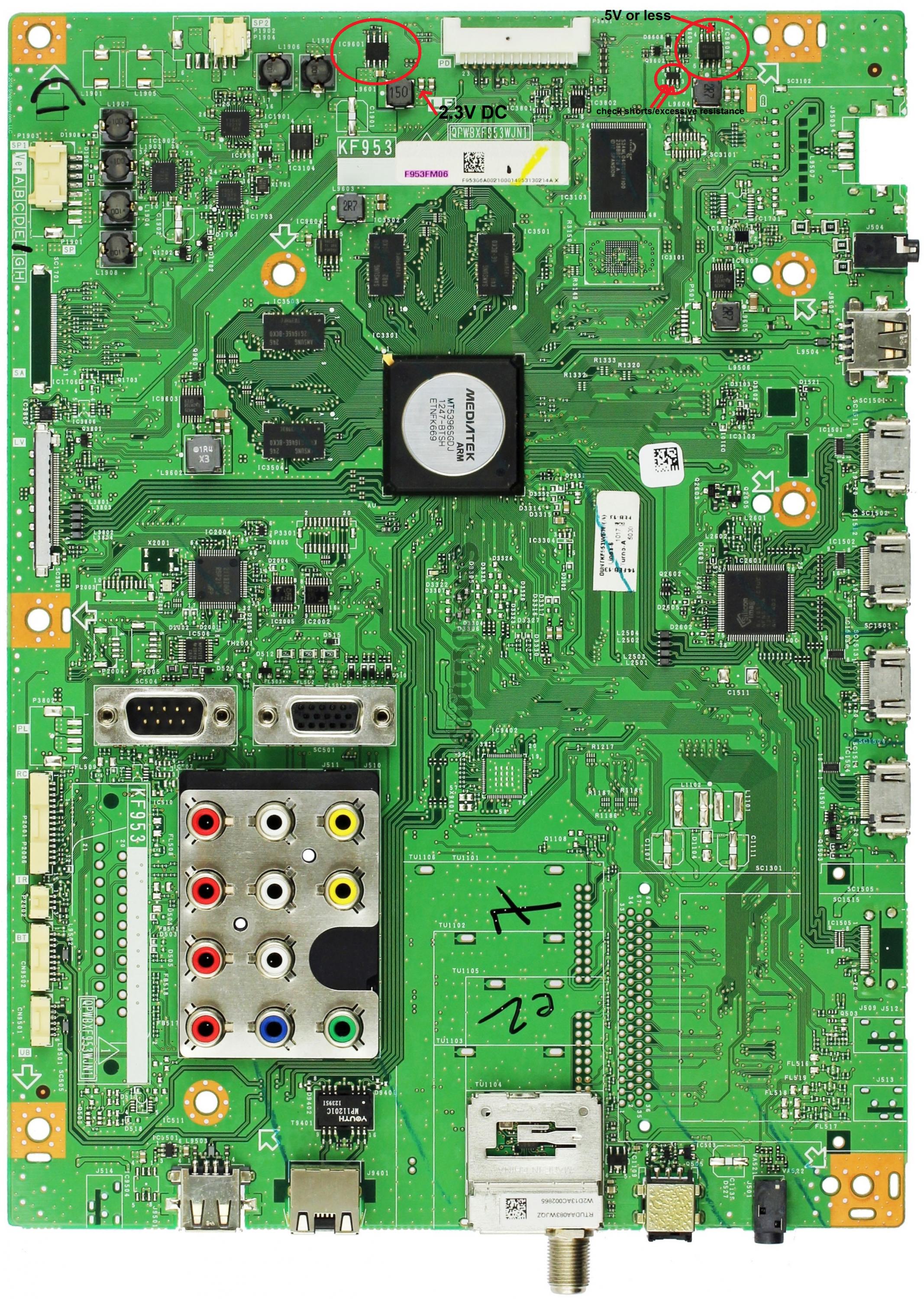

                    Found this thread looking for the answer before i began my 2 long 3 short blink error. the 3.3V comes from IC 9606 on the main board. I had about 1.4v on the output but that wasnt my issue. Sharps schematics are less than helpful so manually tracing everything back, i found my 2.3V regulator to be bad. its IC 9601. This 2.3V buck regulator feeds a switching IC on the back of the board at Q9604. Without the 2.3V supply it will never switch this transistor and pull pin 2 LOW on IC9606(your 3.3V buck regulator) Start by checking pin 2 on this IC and if it is above .5v then go check out IC 9601 and see if 2.3V is missing from there. its late, im sorry if some of this is incoherent but there is your solution, those ICs. also i replaced IC9605 because it had a bit of resistance on pins 1 and 2(about 2kohms) so did this for good measure.
