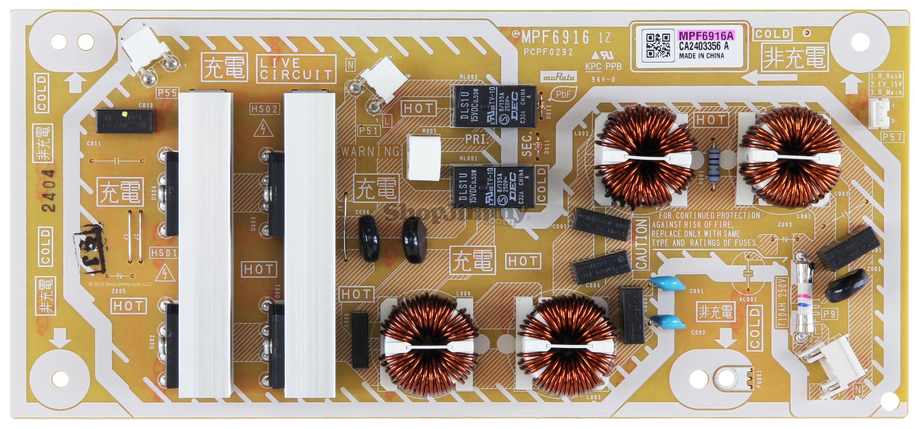

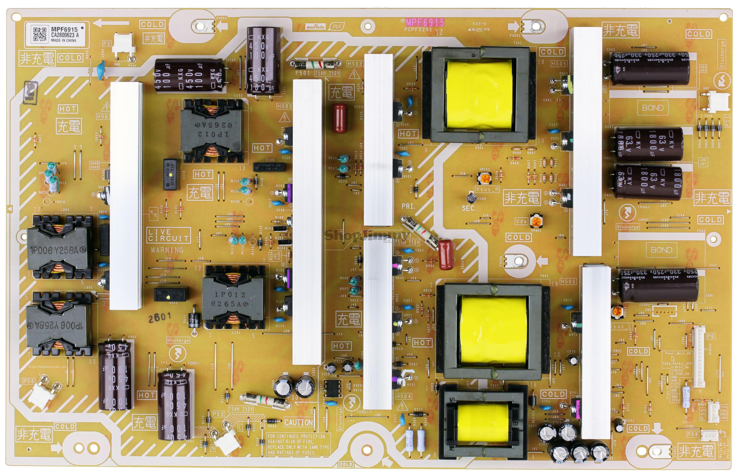

      There are two power boards: Main and sub as shown at shopjimmy:
      http://www.shopjimmy.com/catalogsear.../?q=TC-P65VT60
      Pictures provided by SHOPJIMMY.

                The shopjimmy PCBs that budm uploaded have four 450V capacitors, two for each of the Vsus_L and Vsus_R supplies. Would that be one capacitor as the primary mains filter and the second for the APFC? If so, then ISTM that these US (?) boards are designed for 120V/240V operation.

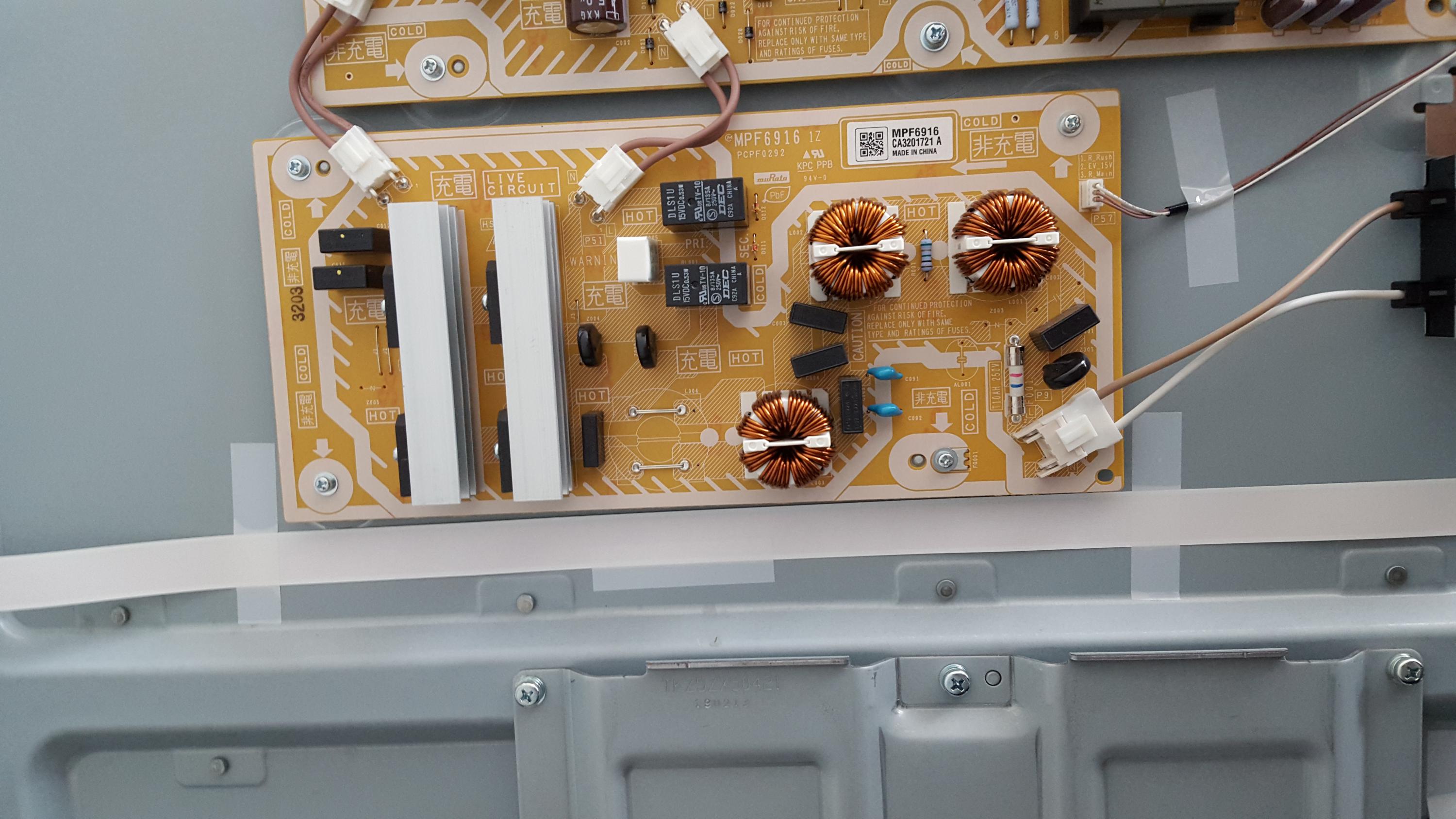

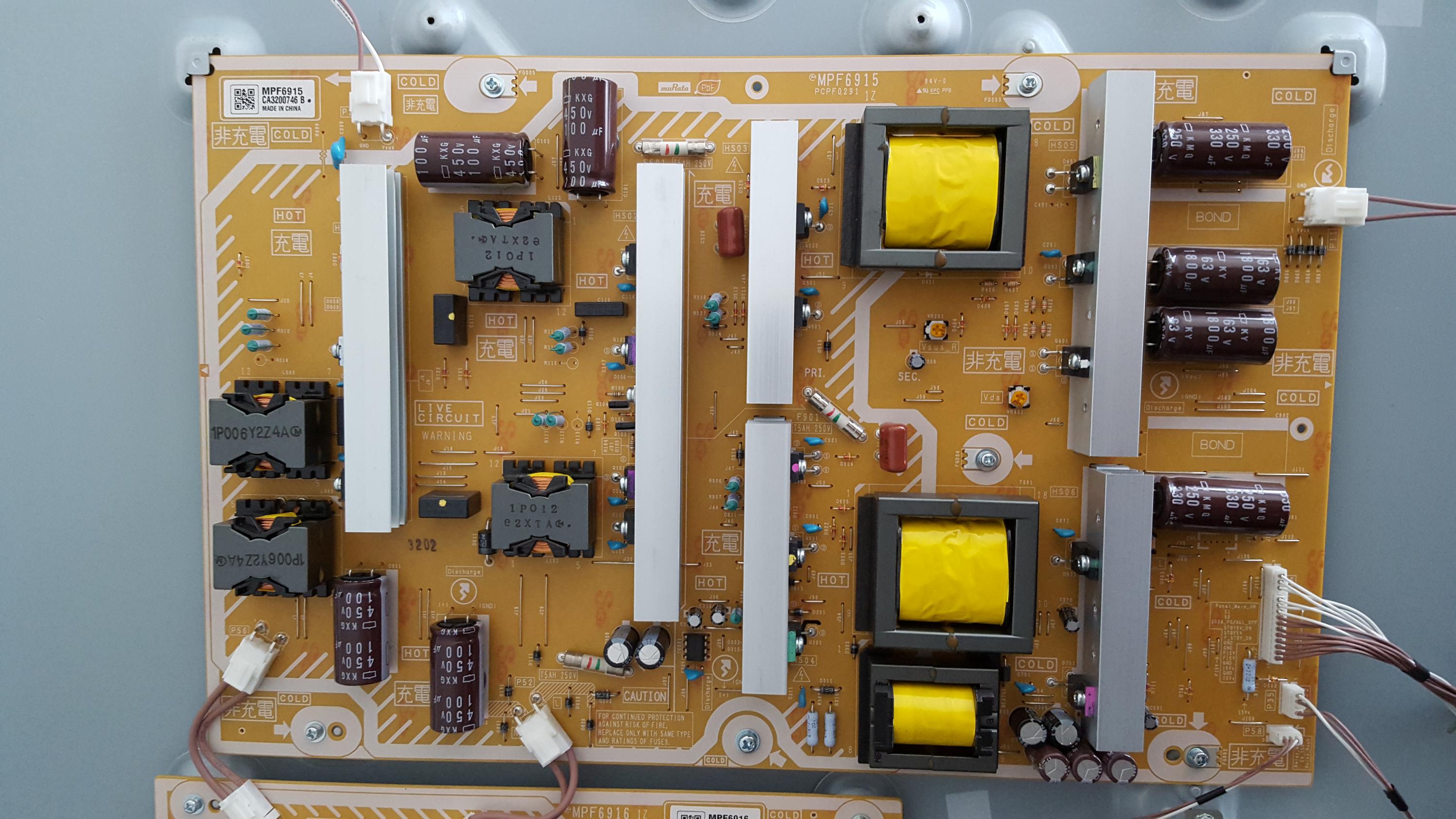

                        Alright... I've got some images now that show the boards as installed in a bit more detail. I've also gained a new appreciation for just how sharp unfinished sheet metal is--ouch.
                        The Sub-P board is a MPF6916 instead of a MPF6916A as shown in the Jimmy's part shots. It looks like the fuses are rated the same on both boards. As far as I can tell, there are two major differences:
                        1. The "coil" on L004 is missing in my board while it's on Jimmy's
                        2. There is a second "black box" at the far left of the board on my board, but not on Jimmy's
                        My board also has a different secondary identifier (CA3201721A vs. CA2403356A) but I'm assuming this may just be a serial or manufacturing tracker.
                        The main P boards are the same model number (MPF6915), but again the serials are different (CA3200746B vs. CA2600623A). These two boards appear very similar, such that I couldn't pick out any immediate differences. Some of the labels on the surface of the large black coil elements on the left of the board are different, but I'm assuming the leading portions that are the same are model numbers while the later numbers are manufacturing times or locations.
                        Assuming this is true, it looks like swapping the MPF6916 board for a MPF6916A board may be successful, as there are only three connections between it and the P board. Or, does the missing coil and extra "black box" not matter and this is actually a switching power supply natively?

                          That "black box" appears to be a 450V capacitor. Can you tell if the two capacitors are connected in parallel?
                          The L004 coil is part of the EMI filter. I often see these parts linked out to save a few pennies.
                          I can't see any reason why your TV couldn't run directly from 120VAC. I'd hate to be wrong, though.

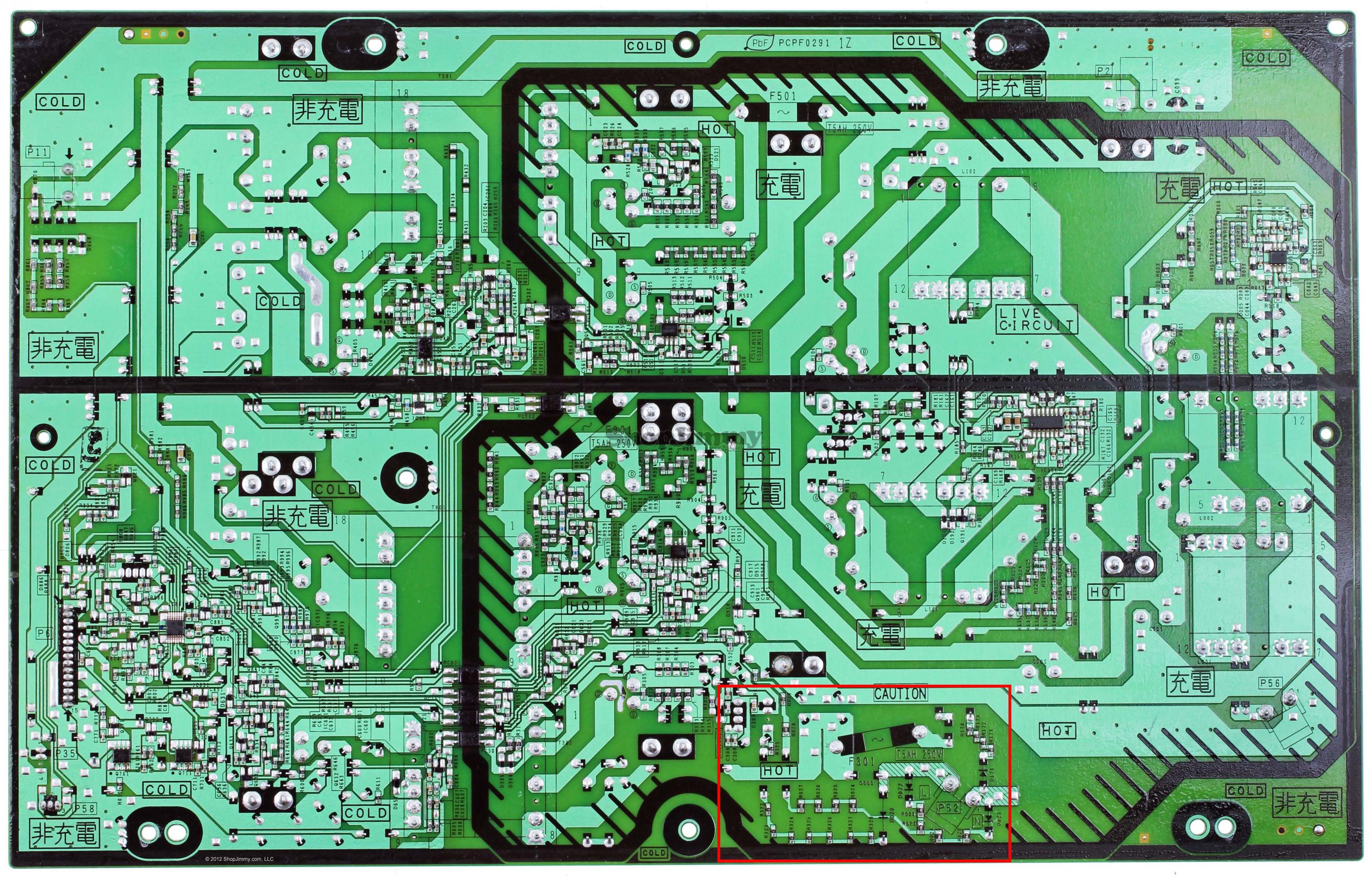

                              Look at those resistors on the bottom side of the main power supply board, there are rectifiers and resistors which are fed by the LINE and NEUTRAL so those resistors may not be the same values as used in the 230V version.
                              There are so many details that you must pay attentions to.

                                  As a wise man once said, he who hesitates has a reckless disregard for the health of his television set. On a hunch, supported by fzabkar's assumption, I decided to bite the bullet and just plug it into 120V mains power. Surely the worst that could happen would be that a fuse on the sub-P board blows (doing its job as a power entry point to protect the P board), right?
                                  As it turns out, the TV seems perfectly happy on 120V power despite the one fewer coil and extra capacitor. Success!
                                  I have no technical idea why they wouldn't label the unit as being able to handle switching power, other than to discourage circumvention of regional restrictions.
                                  For all those Google bots out there, the TC-P65VT60A can handle 120V power natively without need for a transformer or power board swap out. Makes me feel a little bit silly for dealing with that transformer buzz for the better part of a year!
